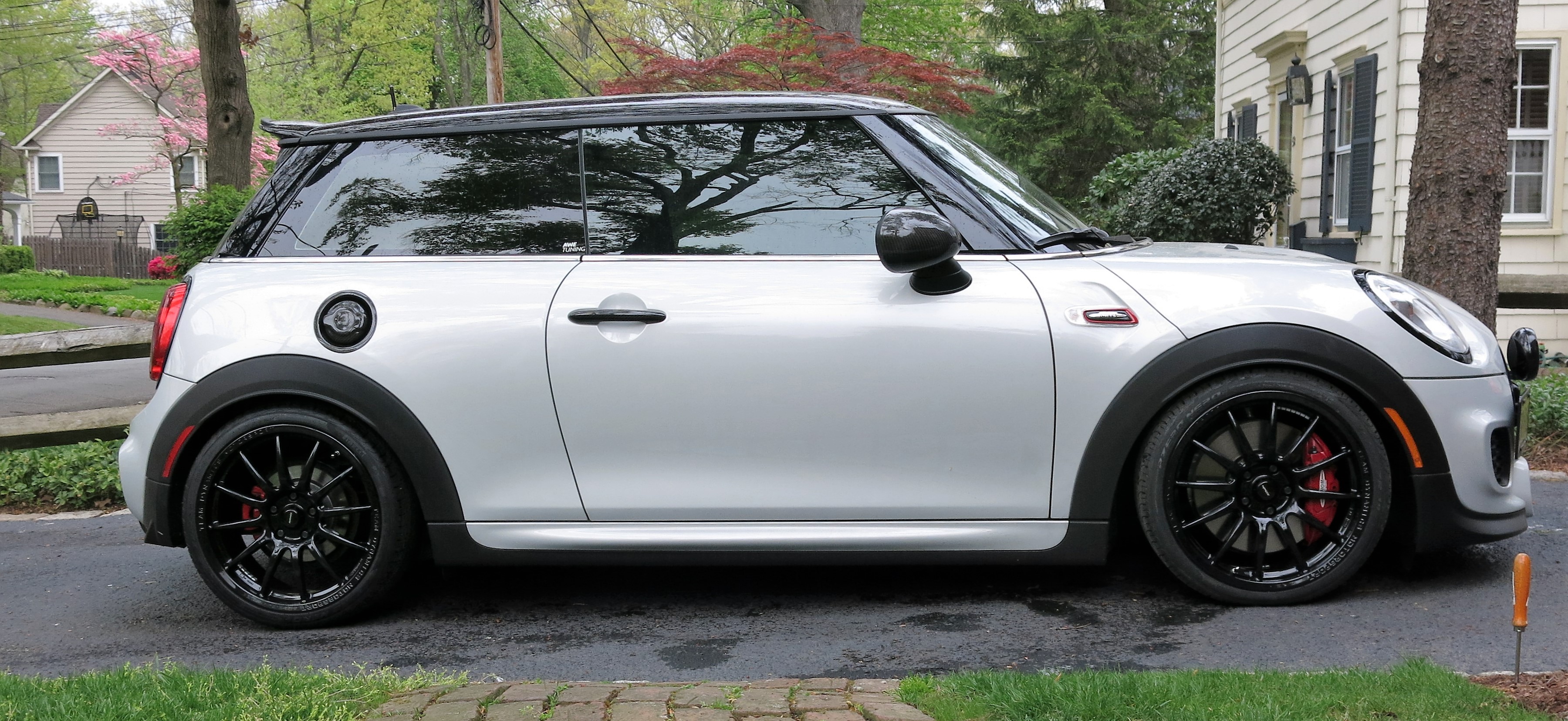

Joined: Aug 2015
Posts: 405
225-35-18 Pirelli on 18x8's
Easy fitment-no issues
thanks man. 35 series though...damn. that would get destroyed in NYC.
i would do 225/40's...but you did just help me figure out that i COULD do it.
btw, i have a non-JCW f56 S...i just got on this thread cuz i will eventually get the BBK so this is the better thread to pay attention to.
No not true on the 35 series tires. See pic.
The sidewall is only slightly lees than the oem.
Love the look! What ET again on your wheels? 45?

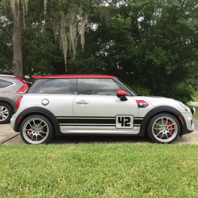

Enkei Racing PF01
I'm considering buying the Enkei PF01's for my JCW. Does anyone one know where I can find a set of black ones? Apparently they are available by special order from Enkei but that means some place has to buy 40. Tirerack won't bite on the 40. All they carry is the sliver.
UPDATE - Photoshopped silver ones onto my car and they looked kinda good. They will either pop and I'll say "hell yeah" or they will be off to powder coat shop. Will report findings......
Update 2 Here is my mini with Enkei 18X8 PF01's with Pilot Sport 215's. Suspension is stock at the moment. Zero issues with brake clearance. Not crazy about the silver as I suspected. It just looks to "cute" now. Will probably powder coat to something dark.

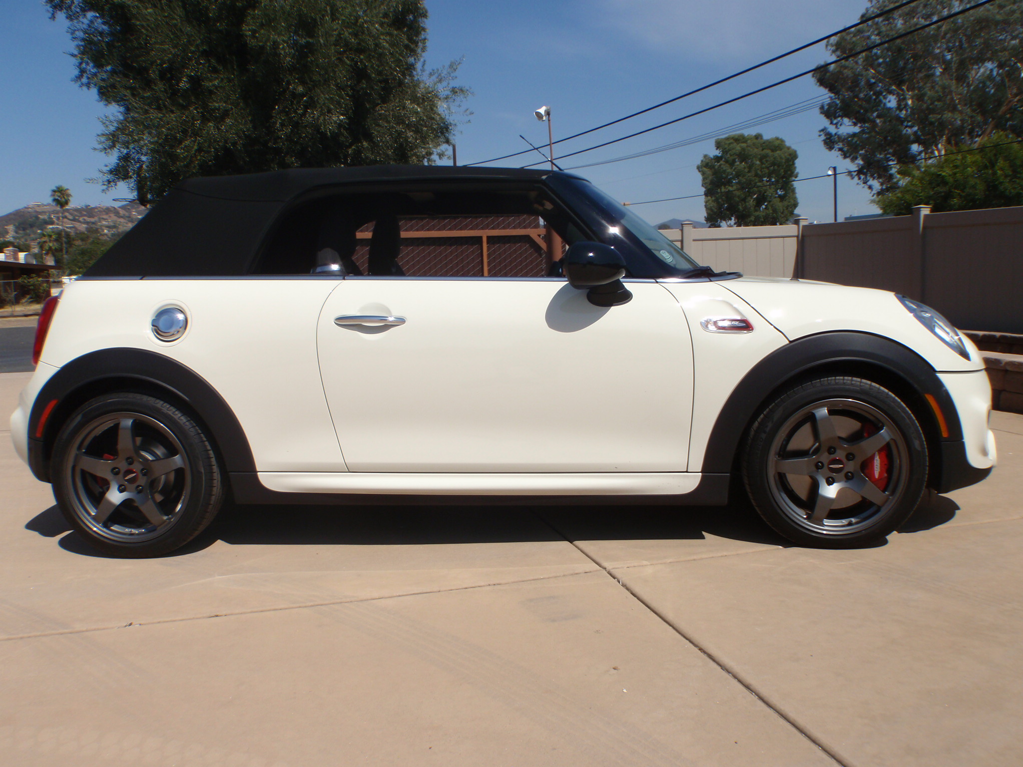

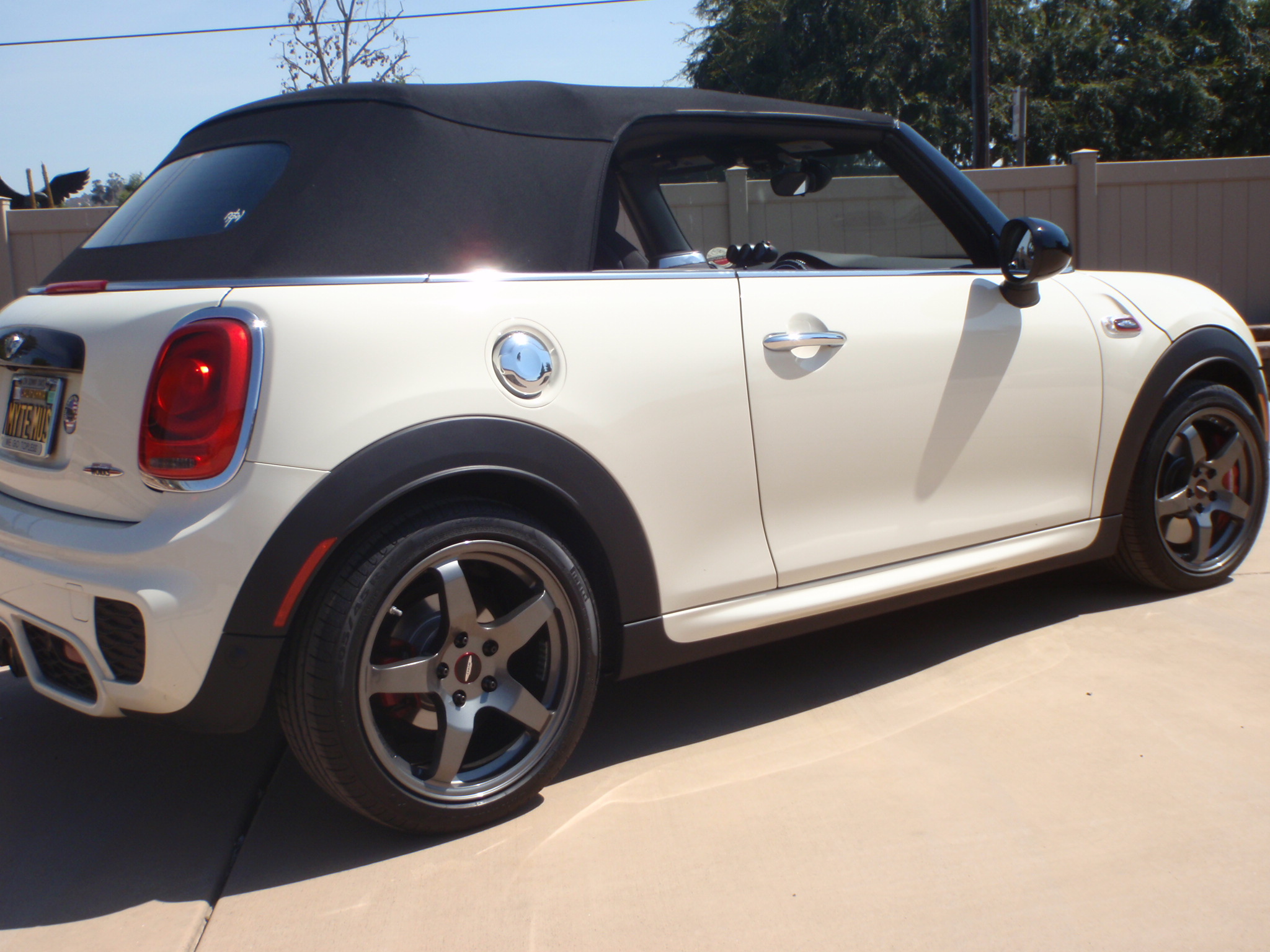

I just installed a set of NM Engineering 17" wheels on a new JCW convertible and everything fit fine. There was no problem clearing the big brakes and no wheel spacers were needed.
Near as I can tell they also increased the car's total track by 1.5 inches (3/4" each side) and removed 32lbs of un-sprung weight..... YES 32 LBS TOTAL!...... 8 LBS PER WHEEL over the stock 17" JCW wheel!
I would have liked to change over to non-runflats at the same time but since my tires were still new I just swapped they over to the new wheels (now I wish I had done that too). As you would expect, the lighter wheel mass made for a noticeably more responsive car.
