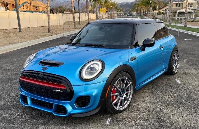

Another clearer view of the colour combo
BBS LM 18" 8J ET45, clears the JCW Brakes (just) and running on 215/40/18 Bridgestone Re-71RS.
Man.....this is CLEAN!
When you say these wheels "just" clear the brakes, how many MM are we talking?
I can't seem to find these wheels in this configuration anywhere. Is there a part number for these I could reference?
Appreciate the help!
Old Jan 5, 2023 | 08:35 AM
  #612
F56-JCDub's Avatar
F56-JCDub
Joined: May 2017
Posts: 622
Likes: 135
Those are the LM430 part which is listed on the BBS Japan website under the 18" tab: https://bbs-japan.co.jp/en/products/1142/
TYPE SIZE INSET H/P.C.D
LM430 18×8.0 45 5/112.0

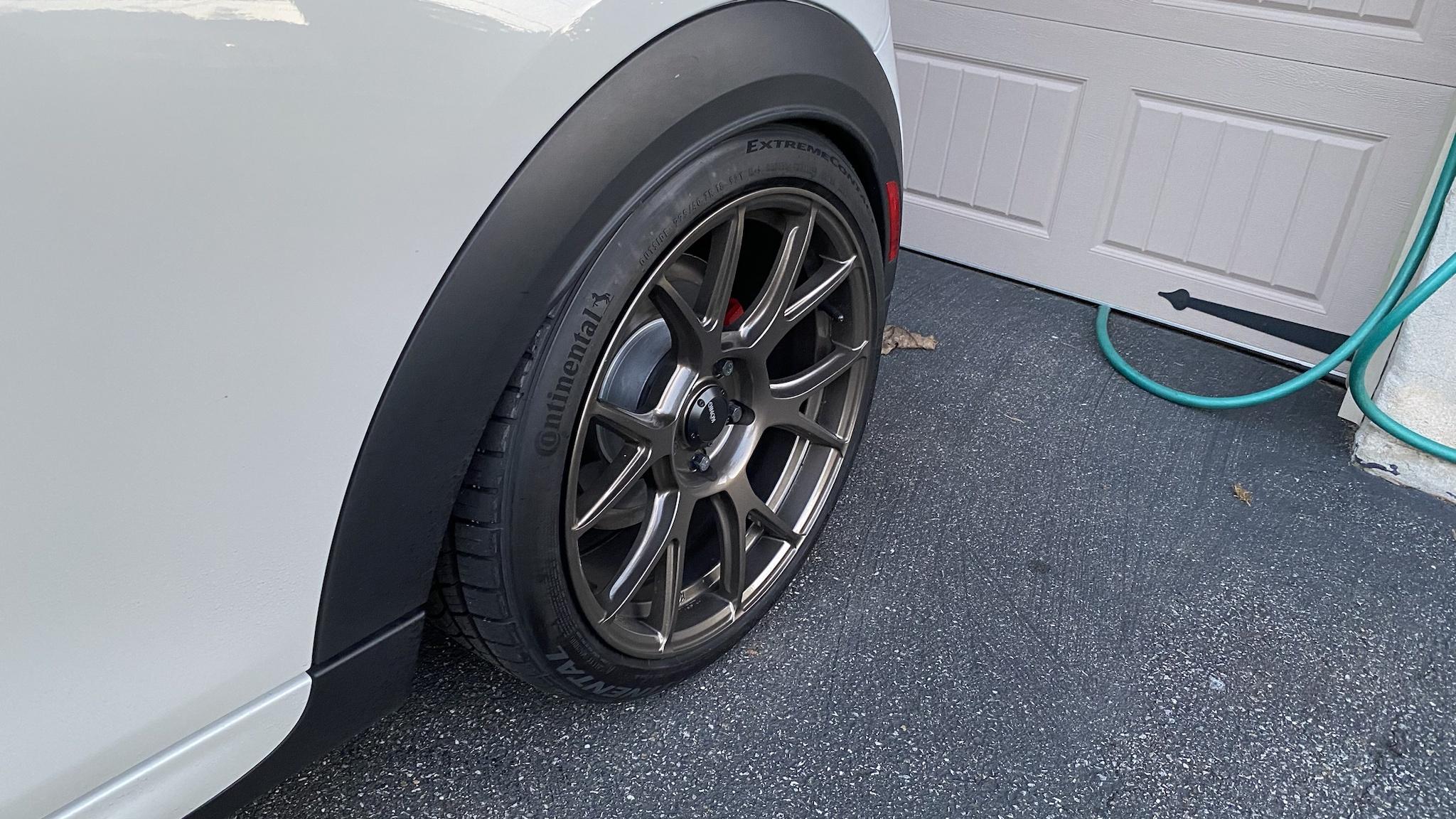

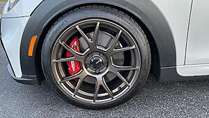

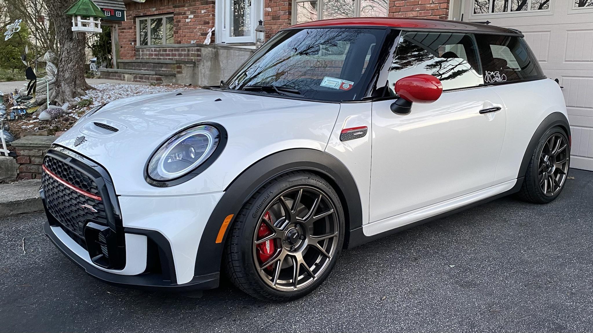

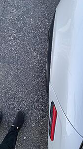

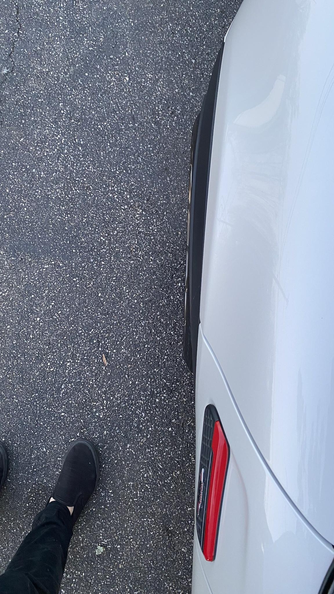

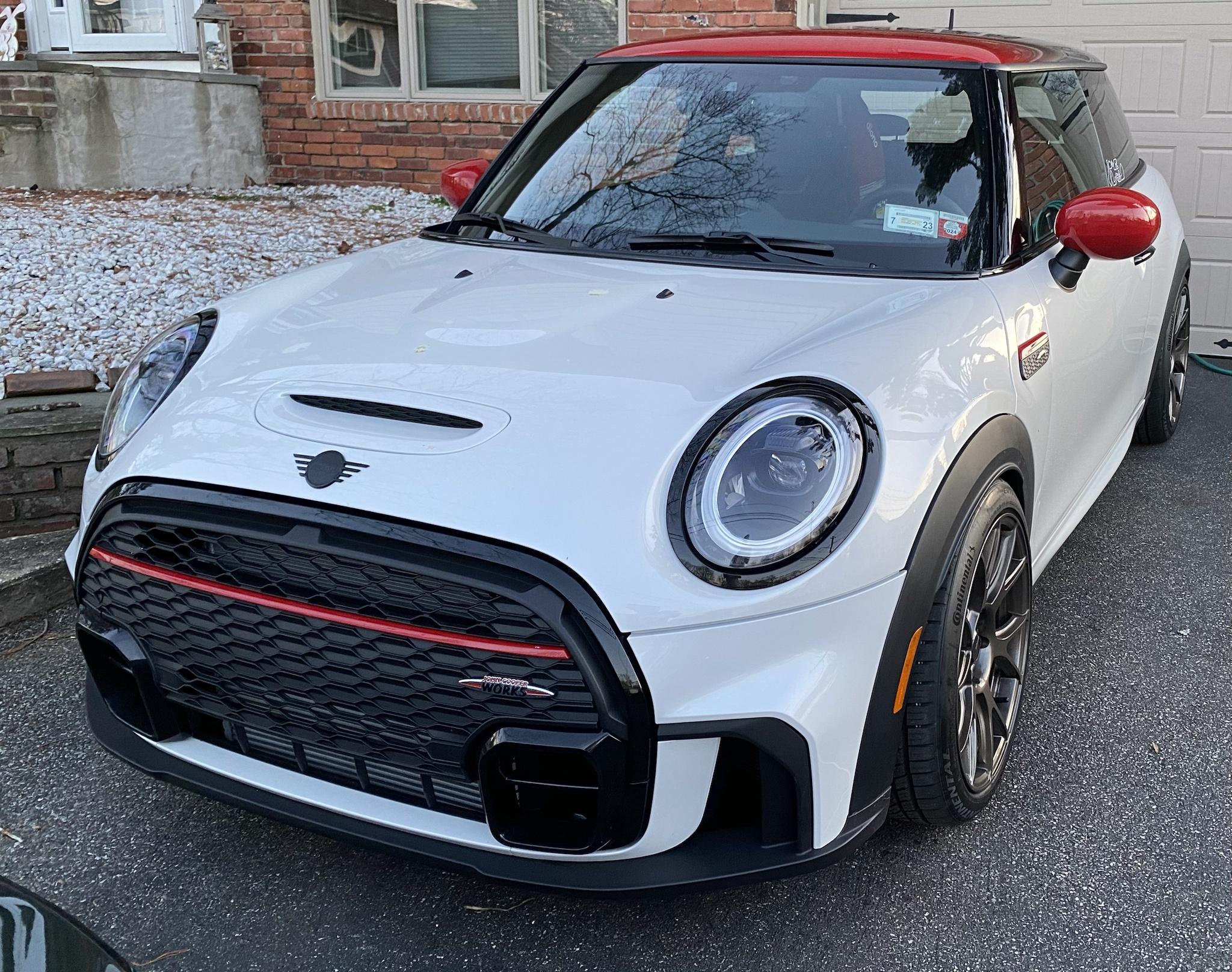

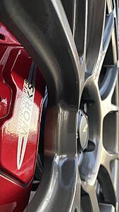

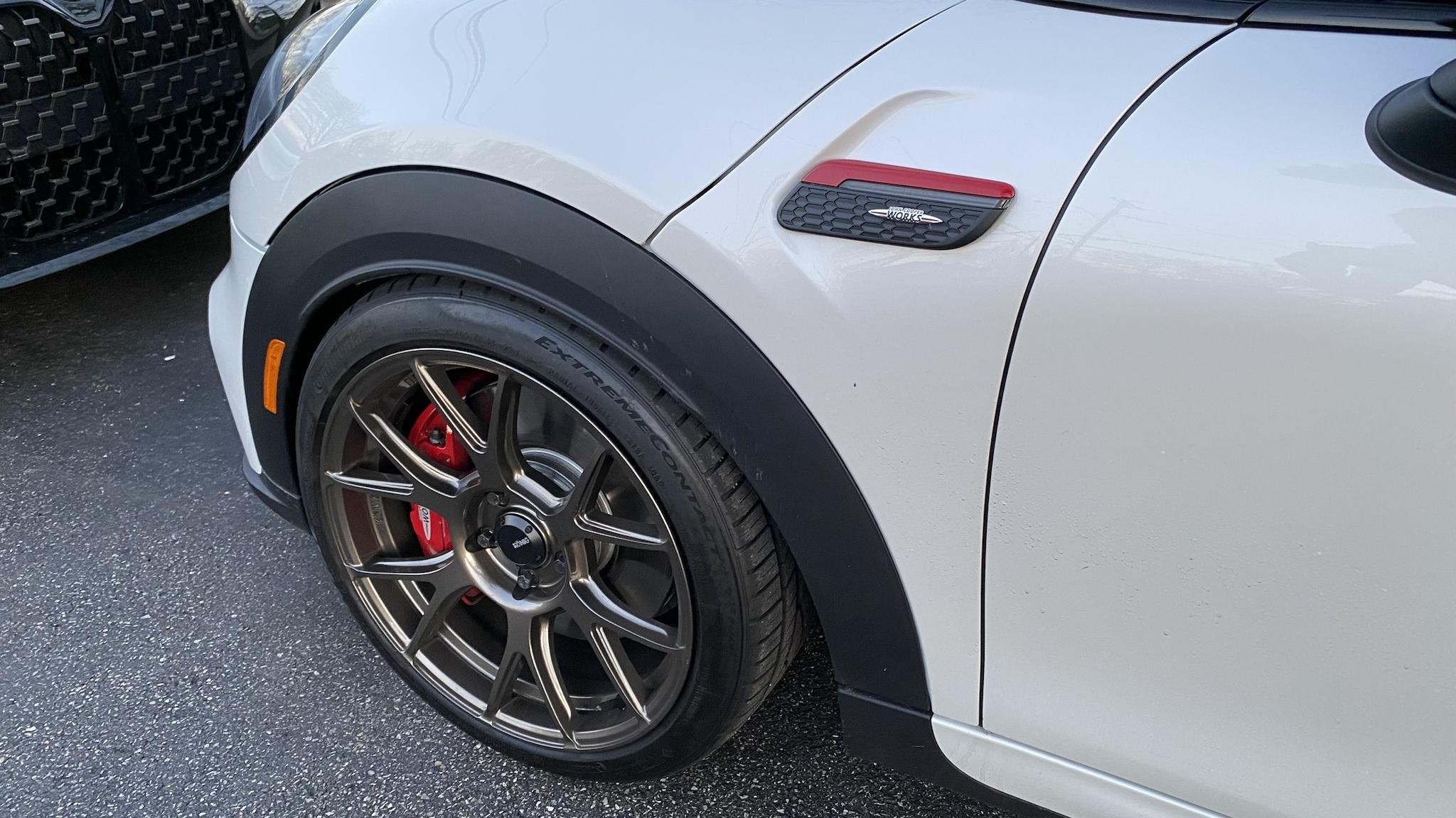

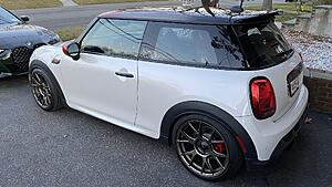

Just got my new wheels sorted, they needed a bit more work to get the fitment right then I expected but I think the end result was worth it.
18x8.5" +43 König Ampliforms
225/40r18 Continental DWS 06 Plus tires front and rear
10mm spacer in the front, no spacer in the rear
Silver project camber plates to add 1.5 degrees of additional camber up front so they don't poke out from under the fenders
The car is lowered on NM springs
No rubbing on this set up and it clears the front caliper by about 2.5mm.

The above car is sexy
