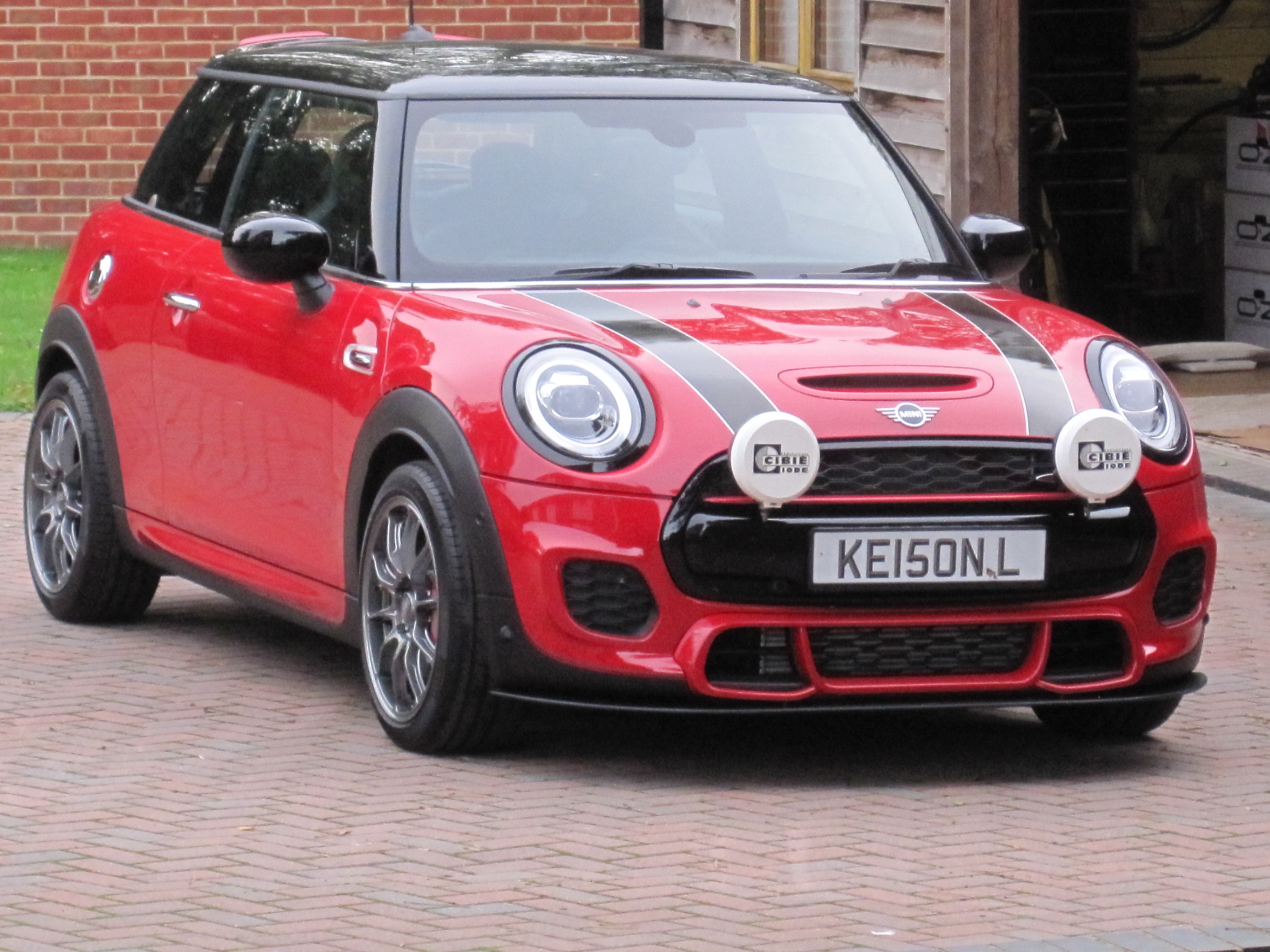

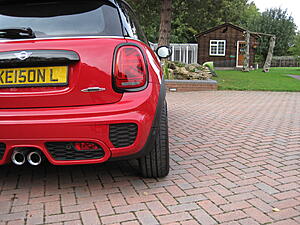

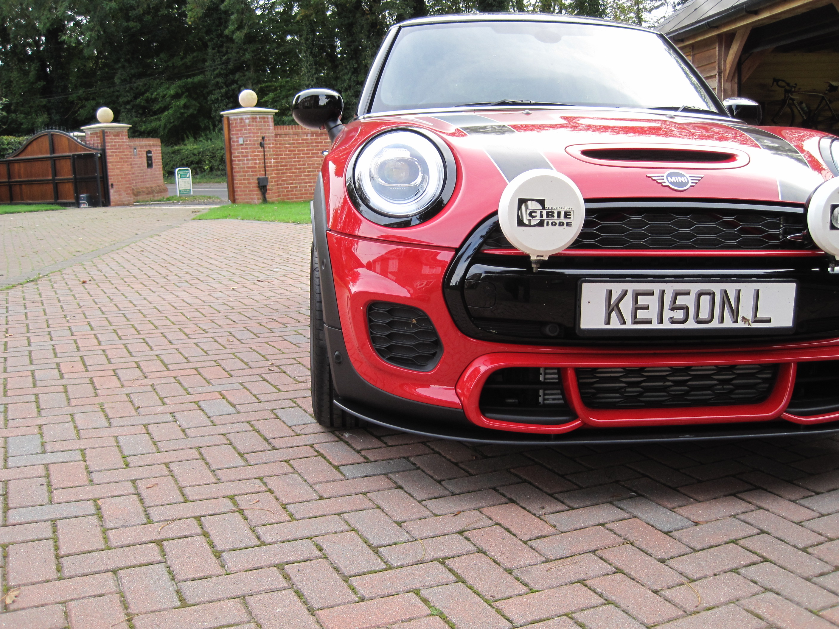

Oz Hyper GT HLT Star Graphite
Finally settled on the Oz Hyper GTs for my JCW which have saved about 3kgs per corner of unsprung weight (total reduction was 11.58kgs). Replaced the standard 17 x 7.0 JCW Black Track Spokes (Code 2HY) which weigh between 11.02 and 11.15kgs each with the Oz 17 x 7.5. As I hate spacers and wanted an even fill of the arches front and rear, I used two different offsets ET41 at the front (weighing 8.02 and 8.08kgs) and ET35 at the rear (8.31 and 8.33kgs plus 20 grams each for each hub ring - only needed on the ET35).
The wheel bolts are quite heavy so will look to get some titanium replacements along with centre caps with JCW logo and red outline as per the originals (which are too small for the Oz wheels).
The ET41 clear the brakes by about the same margin as the Track Spokes, but give a little more strut clearance (the original Track Spokes are quite close. Drives well with them, just a little more self centring. Running standard ride height and Active Suspension.
Attached Thumbnails JCW Aftermarket Wheels-20201001_7706.jpg   JCW Aftermarket Wheels-20201001_7699.jpg   JCW Aftermarket Wheels-20201001_7700.jpg
