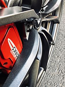

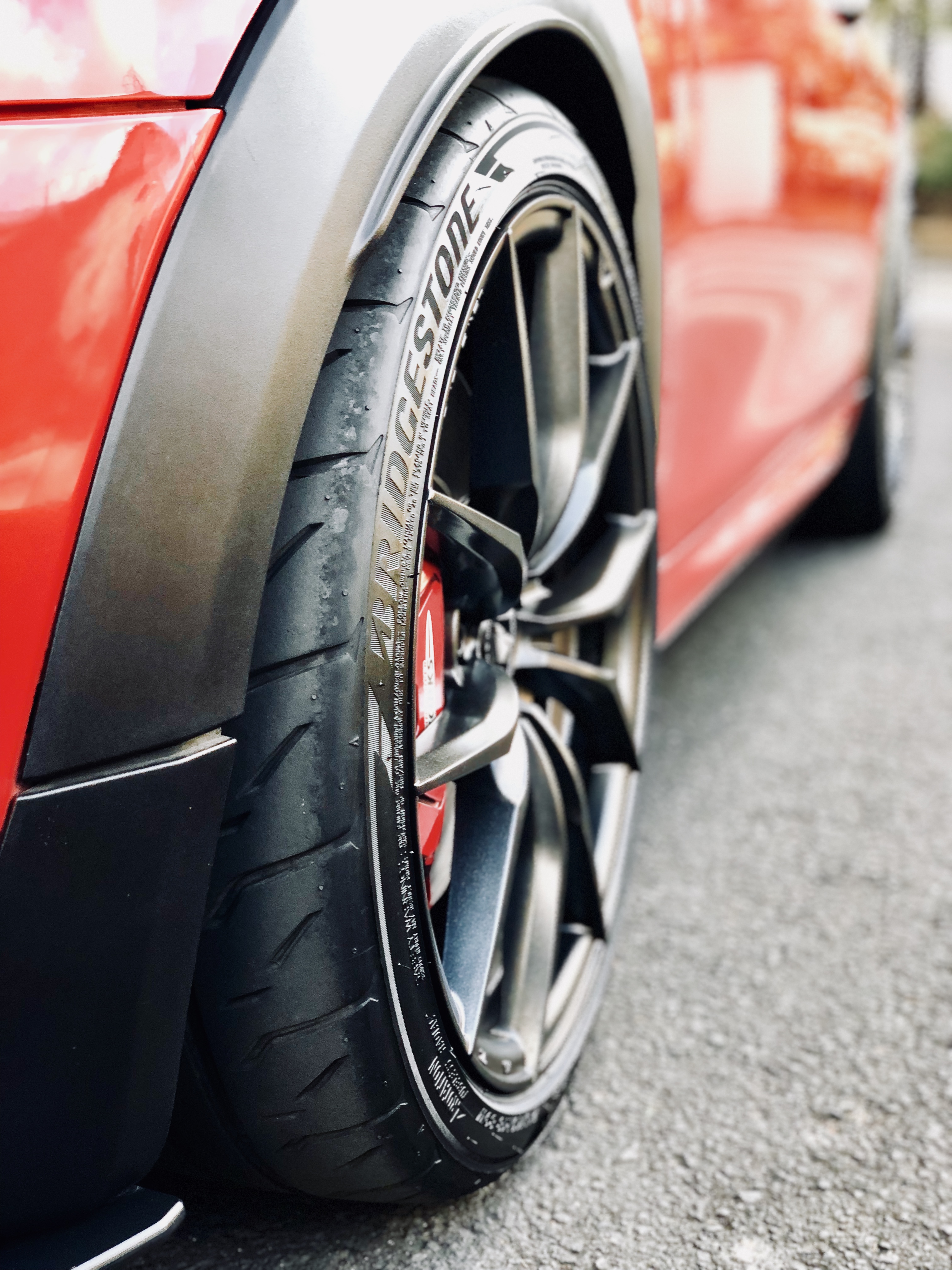

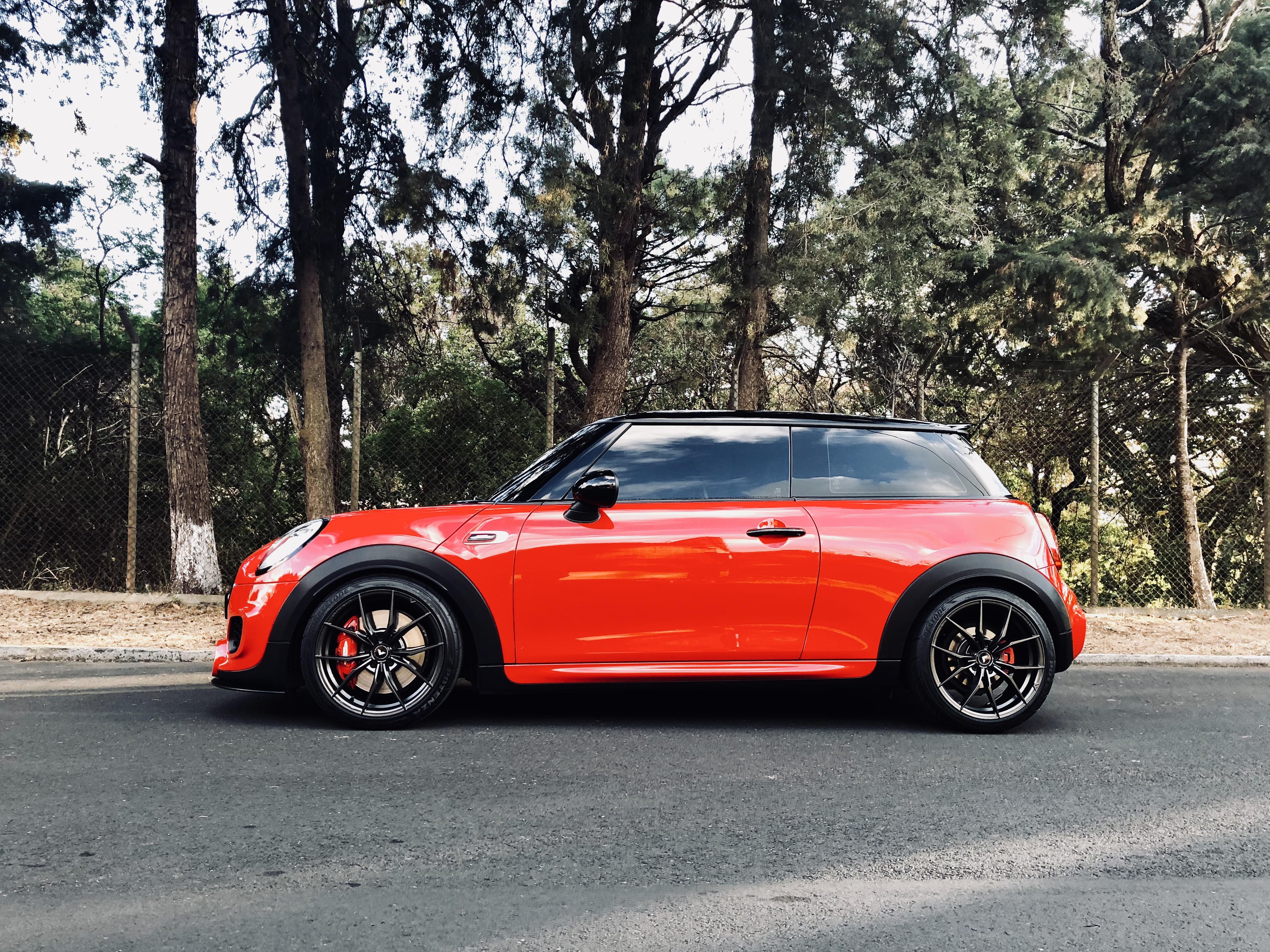

Vorsteiner V-FF 108 18x8 +45 5x112 66.5CB Carbon Graphite
Barely fits, I'll add a 3mm spacer just to give brakes clearance. Since I usually track the car, I'm afraid that if brakes get too hot they can expand and hit the wheels.
Attached Thumbnails JCW Aftermarket Wheels-img_6272.jpg   JCW Aftermarket Wheels-img_6273.jpg   JCW Aftermarket Wheels-img_6275.jpg   JCW Aftermarket Wheels-img_6282.jpg

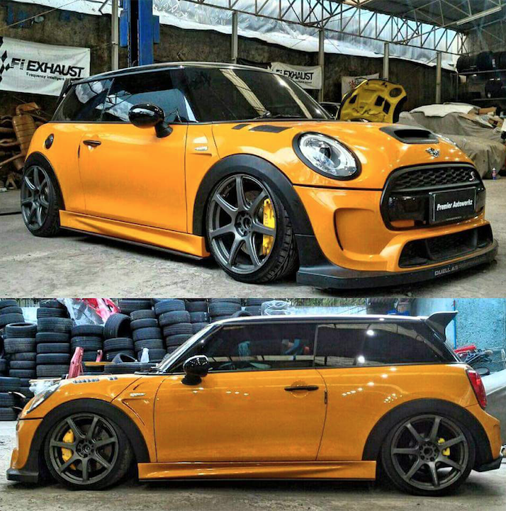

Rays ZE40 Time Attack Edition, 18 8.5J ET43. Tyres are Potenza RE-71R 225/40/18. No spacer or anything to clear the JCW BBK.
If you are running stock fender flare, you will need to trim the inside of the it. You can see a tutorial video on NM Engineering's Youtube channel.
And my car has wide fender kit
