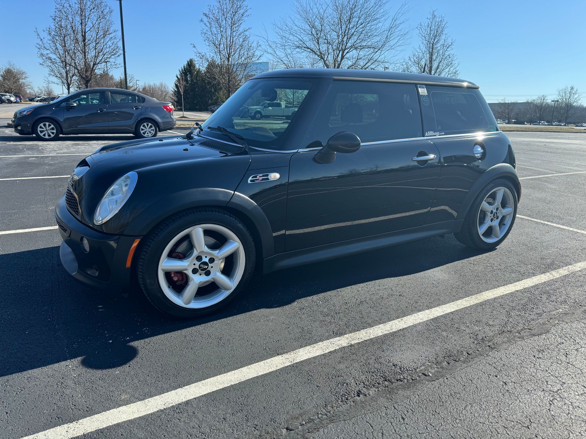

Past couple of weekends consisted of Poor man JCW upgrade on the brakes, thanks MiniManAdam for the calipers, new r56s rotors and yellow stuff pads. Replaced passenger side axle as well. Leaks fixed again, for now. Once temps warm up, those brembo stickers are coming off and repainting all calipers so they match.
