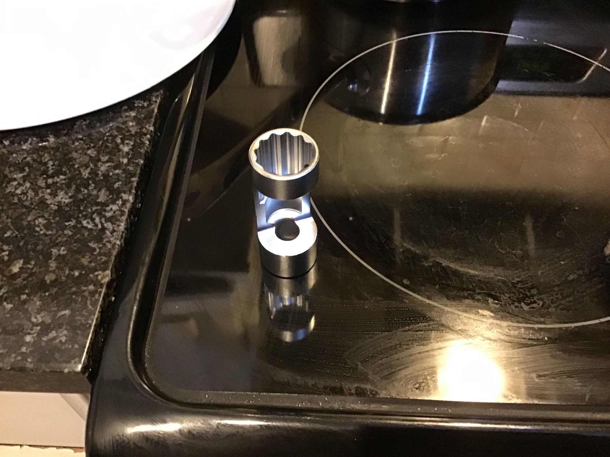

However and as unfortunate as it is; the Bilstein B14 top securing nut is 22mm (7/8") and the access hole on the top of the Saachs bearing plate is not much larger..
The crescent/crowfoot style won't fit in the hole to reach the nut. My sparkplug socket would be/fits perfect in the hole but it's shy at only 21mm and won't fit the nut.
Since the local autoparts store didn't have any 22mm sparkplug sockets; I bought and tried an 7/8" O2 sensor socket instead...but unfortunately, the same deal = the circumference of the O2 sockets I tried were too thick to fit in the access hole of the top bearing plate..
I think a combination of a crowfoot and a sparkplug socket would be a means to an end without acquiring more tools than I really want/have to store.
OR worse case - I Dremel out the access hole wider...but then my dust cap won't fit.
knitz's tool set shown - seems like it would be real convenient to have for anything that these little cars might throw at you.
I'm a stickler for torque values. So I'm still inclined to find a tool that will work along with my torque wrench.

Yeah, as I was looking at that set, I was trying to think about how to adapt my torque wrench to it.

A bit involved but this larger socket might work with a 20mm crow foot wrench on the torque wrench end. Hard to say if it would stand up to 54 ft. lbs. without twisting.

I do find it hard to believe that there are no pass through torque wrenches available (that I could find) on the market?

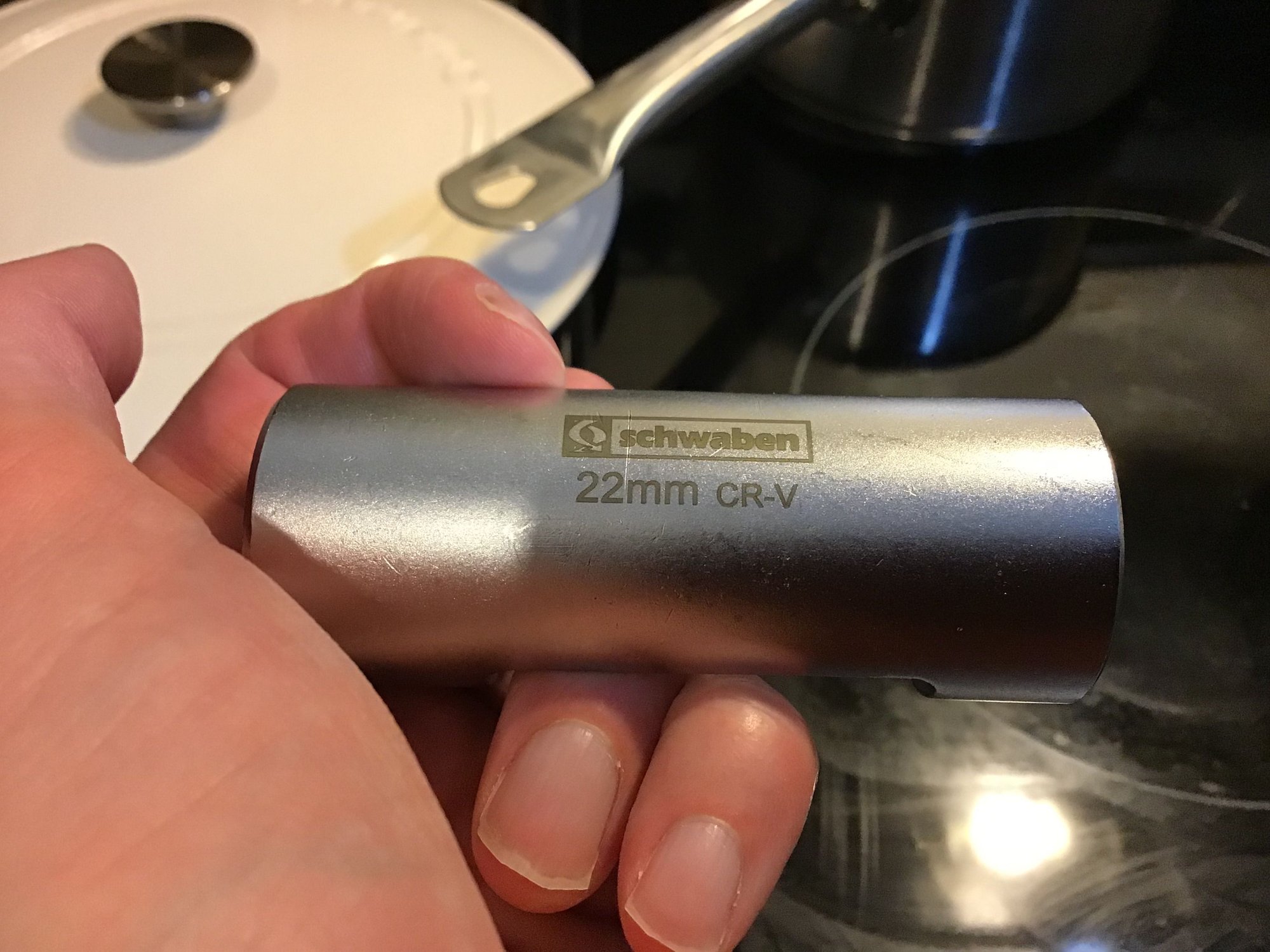

Yeah, the shaft isn’t actually connected to anything. It’s somewhat similar to the mountain bike forks I’ve rebuilt. Or hydraulic cylinders in general. That said, I got my yellows as tight as I could and then banged them on the rest of the way with an impact, but I took care not to spin the shaft and waste all the seals (please, Koni, I did my best. Also, however many years and still no issues). The yellows have an adjuster at the top, so there’s no good way to hold them in place.
Schwaben sells a special 22 mm 1/2” drive socket for VAG struts. I have one in my toolbox for when I finally get around to pulling apart my Audi’s front end. Maybe it would work for Minis (or at least the B14s) as well?

That 22mm Schwaben looks pretty promising.
I'll have to source it. Just hope it's not too expensive and will fit the hole in the top bearing plate.

BTW: I found the 22mm schwaben strut nut socket on eBay for a fairly reasonable price. Thanks @deepgrey

I had just now thought to measure the OD of the socket (30 mm), but it seems you beat me to it. Glad you found the one for a decent price.
