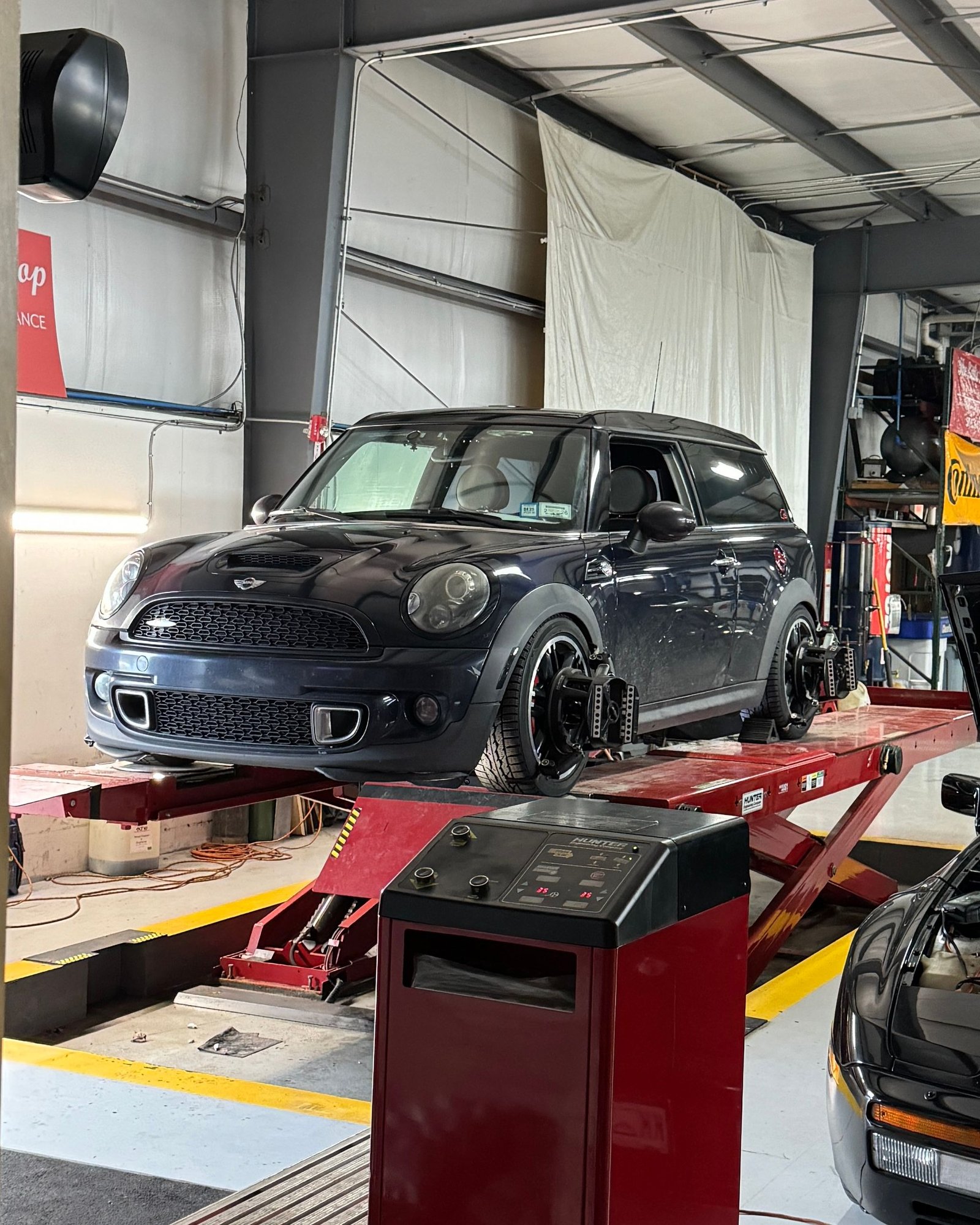

New York State safety and emissions inspection - Passed! Forth year in a row with stage 2 tune and cat-less down pipe, in an emissions state, no less.
Also got an alignment check, and new alternator belt.
Thanks to The Little Speed Shop!
Your Clubbie looks awesome!
'Love the look of the lowered stance w/those wheels.
How do you like the Bilsteins after having them over a year or so?
Thanks!
I love the way the car looks and handles on these. However, I think the combination of firm dampers, stiffer springs, and soft snow tires don’t particularly work well on the car. I’ll be getting the summer tires back on by the weekend, and I can’t wait.

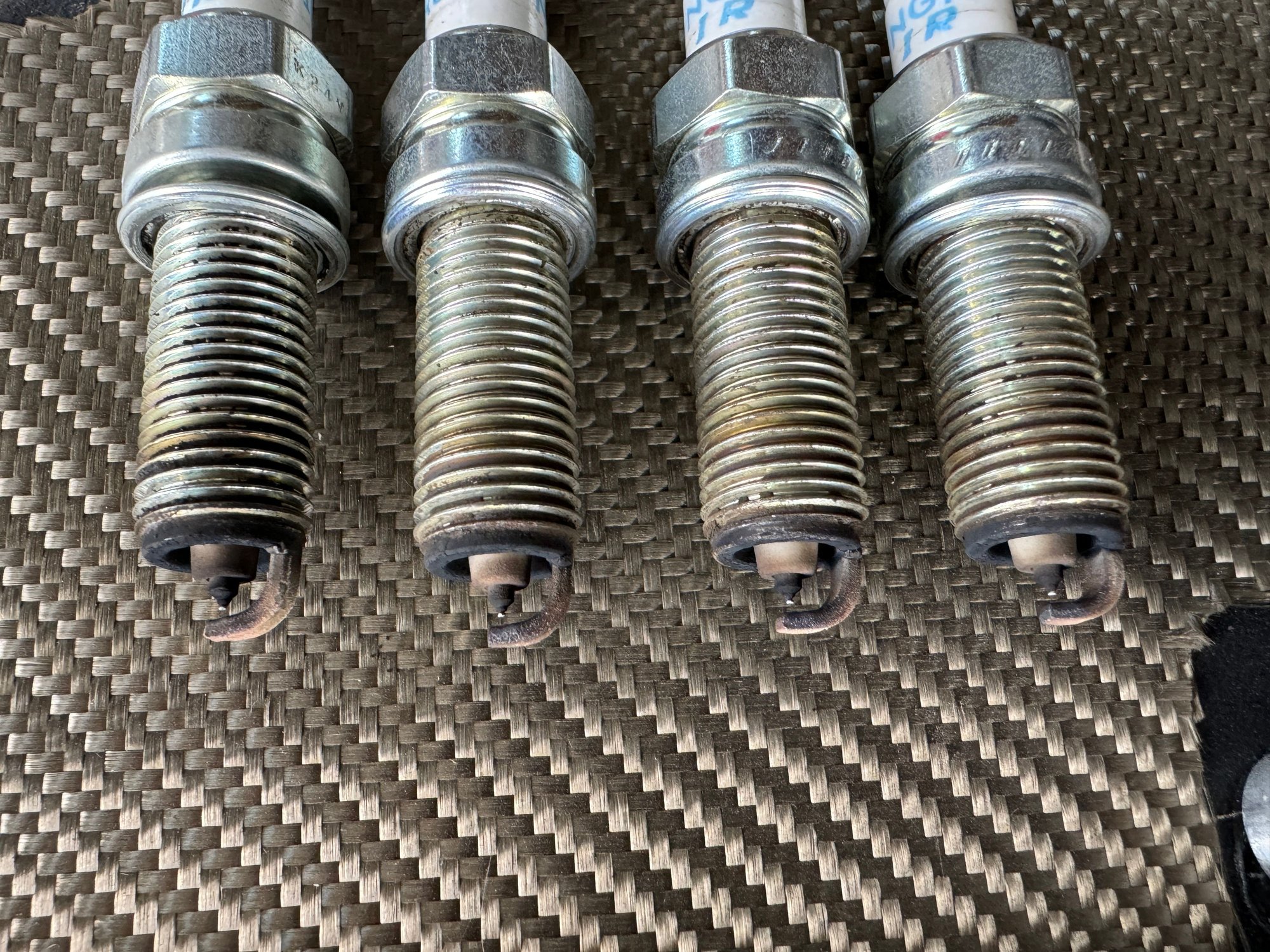

I’ve been busy lately…
This morning, changed the plugs, scoped the pistons while I had the plug holes open, and swapped to summer tires. Failed to mention before my inspection I changed pads and rotors all around too.
Long shot… Any one know if there is a way to scope the intake valves without removing the intake manifold?

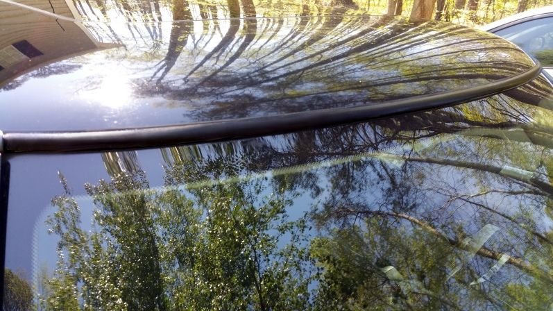

I never would have thought that driving my MIni in the city almost seemed quieter than driving around on country roads.
Granted, when I live in metropolis my daily commute was about 25mi roundtrip. Due to congestion and heavy traffic, my Mini barely ever saw speeds over 65mph for short sprints at a time.
Now, everything out here is wide spread where civilization (as I've come to know it) can be quite a commute driving rural back roads @ an avg posted speed of 55mph.
Most times there's never even another car in sight for miles while driving down some of these roads.
That's when my Mini revealed some noises I could never hear in the city.
  • Thus far I discovered, fixed/replaced one growling passenger side wheel bearing. I'll try and replace the driver side tomorrow for a matching pair.
  • tightened up the rear drop links that started to clunk,
  • a slight rattle in the dash/glovebox (never rattled until recently),
  • and a bowed driver side window which was enough to cause some irritating wind noise, fogging and a bit of a draft.
