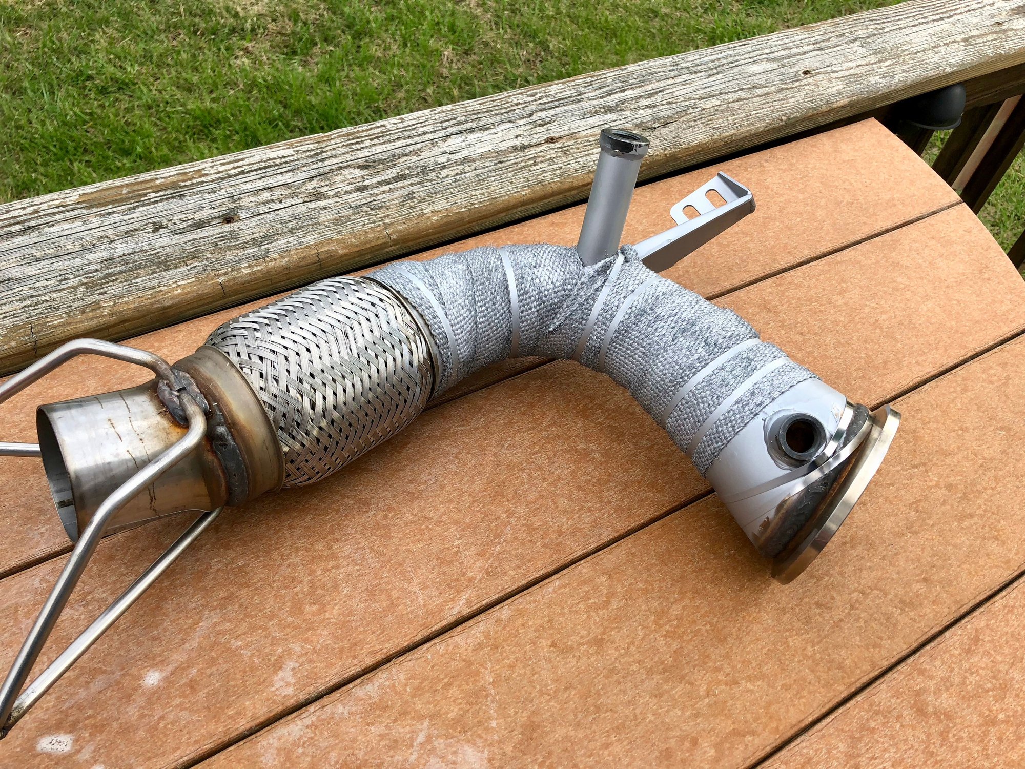

I'm in dire need for a downpipe so I can get it tuned. As far as price vs functionality, Milltek or Marios? Anyone wrap their downpipes?
I went with Milltek, because all the reviews said it fit without having to modify anything, and I know a couple guys that had already installed them on their cars.. I wrapped it with header wrap and put several coats of header paint over that. Still fit like a champ, and with a little trial and error the heat shields went back on too. I'm not saying it's better than Mario's, just relating my experience.
Do you have a model number or link? Is it catless

Catless. I bought from Outmotoring, who is just one of our forum sponsors. I'm sure it's available from many of our sponsors. When I need maintenance or mod parts I do my best to support our sponsors. This is the link I used, but I would suggest you check several sources to find the deal that is best for you.
https://www.outmotoring.com/milltek-...2021-gen3.html
If you enter this description on Amazon you should see the wrap kit I ordered.
Design Engineering 010331 Motorcycle Exhaust Pipe Wrap Kit with Hi-Temp Silicone Coating Spray - Tan Wrap / Aluminum Spray

Thank you! This is exactly what I'm looking for

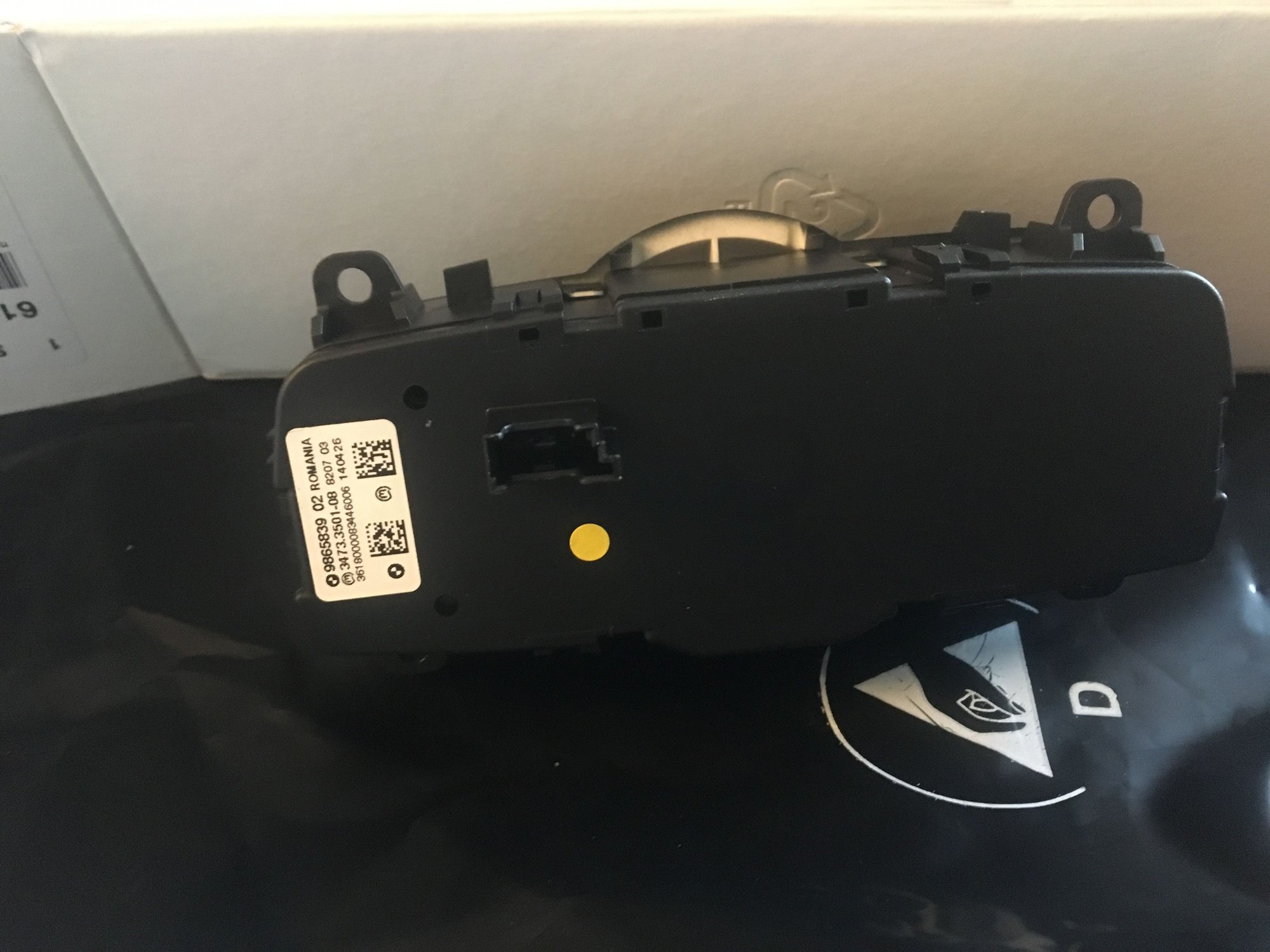

Rear Fog Lights
Wow! That was the easiest mod I ever did. Replaced light switch and activated 2019 F55 Rear Fogs lights (bulbs and wiring already there!) Euro Rear fog switch 61 31 9 865 845 (Thank you ECS Tuning!) Panel simply pulled out and switch was held in by fasteners (no screws), clicked new switch in and replaced wires. Everything except the rear fogs worked after replacing switch. As I had to code ECU with BimmerCode iphone app ($31) and a bluetooth OBDLinkMX+ adapter.
I found coding Originally Posted by TVPostSound (thank you!)
Coded: In Expect Mode....in the "Body Control Module" [No idea what that link is?]
Activate Rear Fog Lights:
3068 NSL_Verbaut = Verbaut
(Note nebelschlussleuchte = NSL= Rear Fog Lights)
Code first, the cycle ignition, then restart Bimmercode for the below options
to show up. This was scariest part as it cycles thru with alerts--but afterwards it is all OK).
Activate Rear Fog Lights feature for lighting switch:
3064 Mapping_Nebelschlussl_L_output = nsl_l
3064 Mapping_Nebelschlussl_L_Function = nebelschlusslicht
3064 Mapping_Nebelschlussl_R_output = nsl_r
3064 Mapping_Nebelschlussl_R_Function = Nebelschlusslicht
Every time you recode after doing rear fogs, you WILL get a dash warning about lighting errors.
cycle the ignition, it will go away, the warning after coding is because the VO has not been coded.
It will not persist after that.
This link was helpful.
file:///C:/Users/toddt/Downloads/BMW...3%20series.pdf
Rear fog light turn on!
Back of switch
Old switch, with blank button for rear fog light
Rear fog on!
Replaced switch
fog light switch. No screws--just pull trim fasteners and clip switch out and replace.

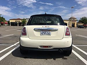

Debadged the rear. I might order different emblems to cover the holes, but it’s got stickers over them for right now.
Attached Thumbnails What did you do to your mini today?-f4ee60e4-059b-4eb4-a93a-db8bb3cda2ec.jpeg

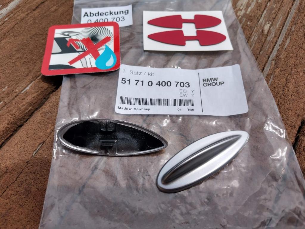

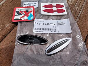

Originally Posted by OCR
Took the silly wing off the roof of my R53.
I was prepared to put round plastic plugs into the single hold down holes in the top of the deck.
But NOoo...they had to put big slots, for adjustments I guess.
I thought these cars were built to higher tolerances than to need big (about, .63") long slots in the deck. Not sure what I'm gonna do now...putting the wing back on is not one of my choices.
Mike
Yeah, MINI used to sell little fin thingies for when the JCW wing was installed:
The Orranje G-Wing comes with oblong sticky thingies too:
There's some discussion of the various wings starting here:
https://www.northamericanmotoring.co...ml#post4480638
I had also started a thread inquiring about the R50 spoiler:
https://www.northamericanmotoring.co...king-info.html
One of the more subtle wings may be to your liking for a cleaner look as I suppose it was an aesthetic decision on your part to remove the S wing?

Thanks for posting...
Also, I am surprised you can do actual coding with that app. Do you know if those are the same codings use in the NCS Expert?
