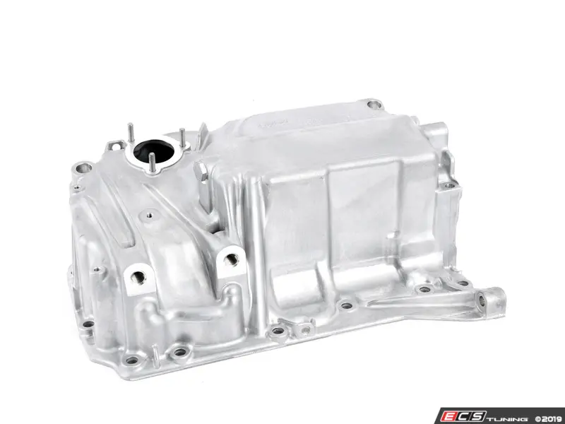

Yep we have seen some pans have issues.
Now we have these: https://www.ecstuning.com/b-bremmen-...1138590017~br/ and https://www.ecstuning.com/b-bremmen-...138611689~brp/

You guys have heard about this? Oy! Good to know.
What is the difference between these two Bremmen listings/parts (other than price of course)?
Old Sep 20, 2024 | 06:15 AM
Posts: 36,762
Likes: 2,551
The are cast of the oem molds. I have seen them bremmen ones in person and the castings look good, much better then OEM. I think the Genuine ones have a bad cast job based on comparison of other years and models. Like it looks for crack in the cast cracks.
Gotcha — and it looks like the diff between your two listings is for the Bx6/Bx8 vs Bx6C/Bx8C? Am I sorting that correctly?
Old Sep 30, 2024 | 06:06 AM
Posts: 36,762
Likes: 2,551
Yep just the two engine types.
