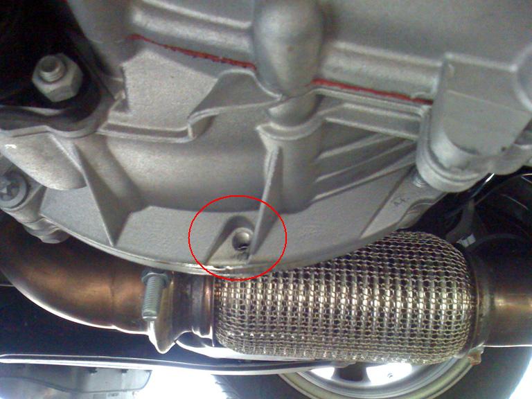

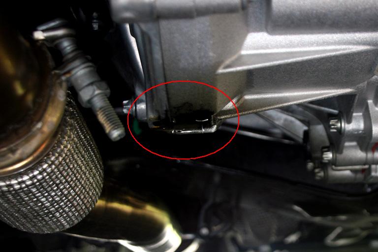

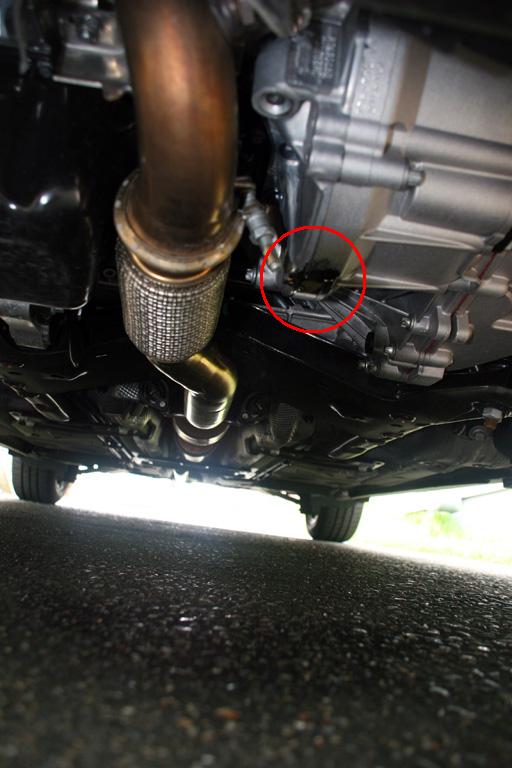

After noticing an oil spot in the garage, I have found a leak in what I believe is the engine seal between the transmission and engine. I also think that there might be a missing fastener between the two (see the third picture). Maybe this is causing the leak?
After taking the first two pictures, I wiped the area clean. The rag definitely smelled of engine oil and was dark brown. After 24 hours, there was already a new drop forming (3rd picture).
Can someone confirm or deny my suspicions? I'm a total rookie when it comes to this stuff and before I head to the dealer I'd like to hear what others think.
Thanks.
Attached Thumbnails Clubman S oil leak @ 1800 miles!-oil_1.jpg   Clubman S oil leak @ 1800 miles!-oil_2.jpg   Clubman S oil leak @ 1800 miles!-oil_3.jpg

Ok I tried to get under to see if a bolt goes there , but I'm to old ! But it should not be leaking bring it in .
Old Apr 7, 2008 | 09:12 PM
Xray'dit_Mini's Avatar
Xray'dit_Mini
Joined: Apr 2007
Posts: 271
From: Camas, WA
I had the EXACT same issue with my 2007 MCS! From day one it leaked. I just thought it was Cosmiline melting off the engine. It kept doing it for weeks so I took it in. Turned out it was the rear main seal that was leaking.
the "missing bolt", according to my MA, isn't actually missing. there isn't supposed to be one there for whatever reason.
Thanks.
Definitely looks like the rear main seal is leaking. Not good .

It was the rear main seal. Plus, the dealer replaced the input shaft seal while they were at it.
