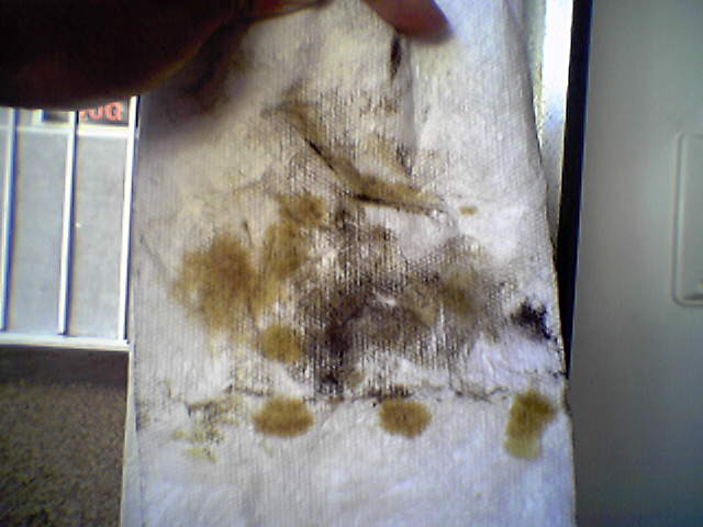

10/03 mcs oil leak
found this just yesterday while trying to change oil...oh yeah and the damn plug is nicely stipped now as it's waayy too tight.
that first pic is the paper towel and the oil drips that it soaked up...there were 3-4 bolts, all in a row, that had varying degrees of drops oil built up.
the third pic may actually show some of the size of the drop. haven't noticed any oil drops where i park my mini.
but i shall definitely be taking her in to servicing. maybe i can get a free oil change at the same time, as i just passed 36k. and have the service guys install the fumoto drain plug instead of that damn oil plug.

Old Feb 12, 2006 | 01:04 PM
kbseto's Avatar
kbseto
Joined: May 2003
Posts: 861
From: hawaii
and one last pic showing some of the spreading?
