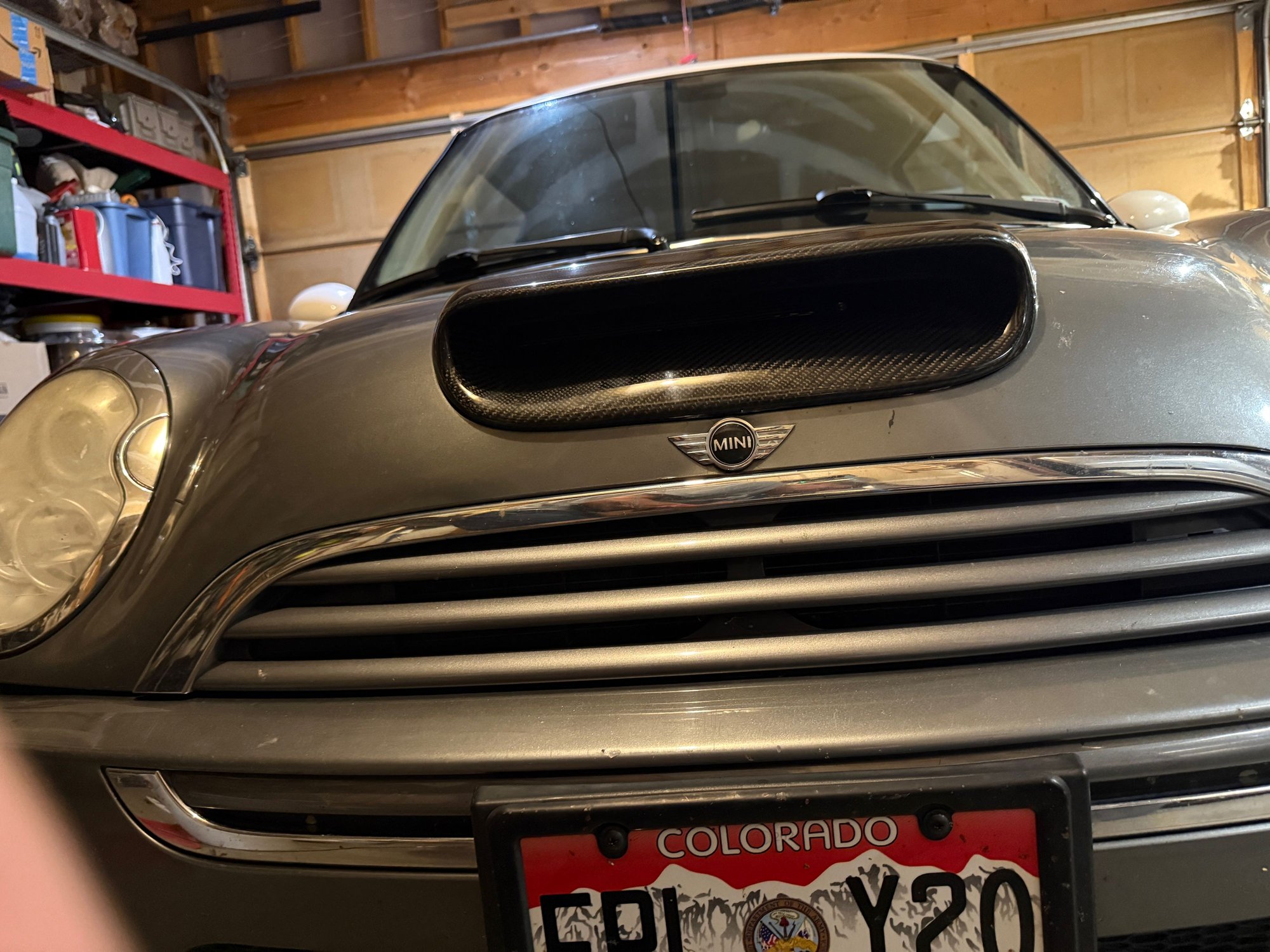

Here's a few photos of the new family member from the day we brought him home. Introducing Otto.
This thread will be the journey of building and upgrading a 20 year old MCS. Oh, and I paid $4k for the car.

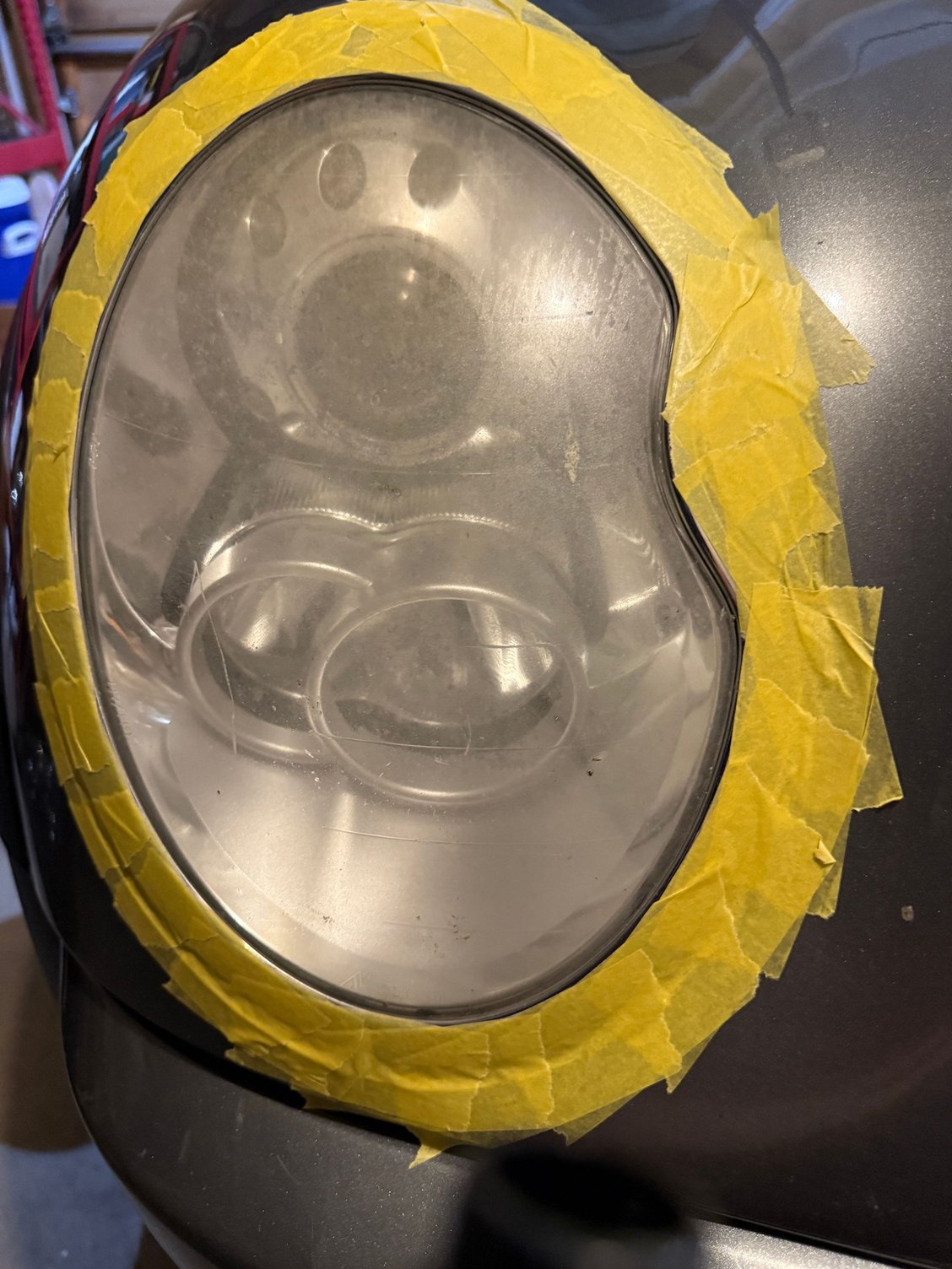

Found a cracked fog light the other day, but that's an easy fix. Lamp still works, but it'll suffer a bit in the rain.
If there's time, I'll R&R it before the trip. I'd also like to polish the headlight lenses before the trip, but Otto will be out of my hands for more than a week after I get the suspension done. It'll be tight timing.

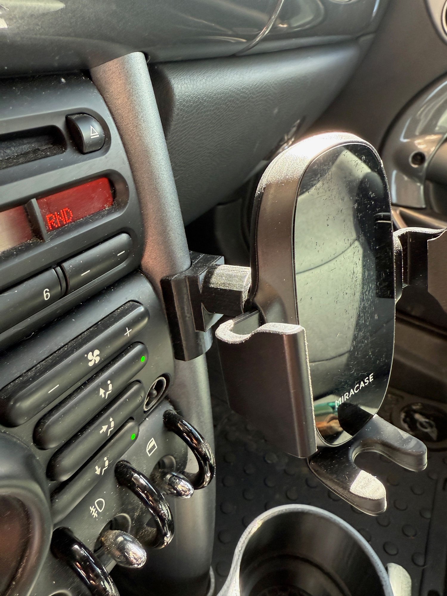

Added a few convenience items.
Now that Colorado has the mandatory hands free law, I added a phone holder. Of course the Mini R53 cup holders sort of suck, I added some double cup holders. Both came from an online seller - but the phone holder was only the mount, not the phone holder itself, so I used an old phone holder that has a screw on mount. It's pretty solid too.
Added the GROM cable to have music from my phone (SiriusXM mainly) from the rear hatch area connector and I wired it up to the front seats. Didn't connect it under the dash yet, but may ultimately do that too. SiriusXM is clear on the HK stereo and sounds great. The nav doesn't display anything when the GROM is in use (no titles from the phone) but it does switch the display to the map/stats for a second or three before it goes back to the GROM (display) screen. Not the best, but works great for now. I don't plan on changing out the nav or the HK stereo any time soon. I really wish the car had the Chrono Pack option instead of nav, but that's the lemons. The GROM cable has me making lemonade.

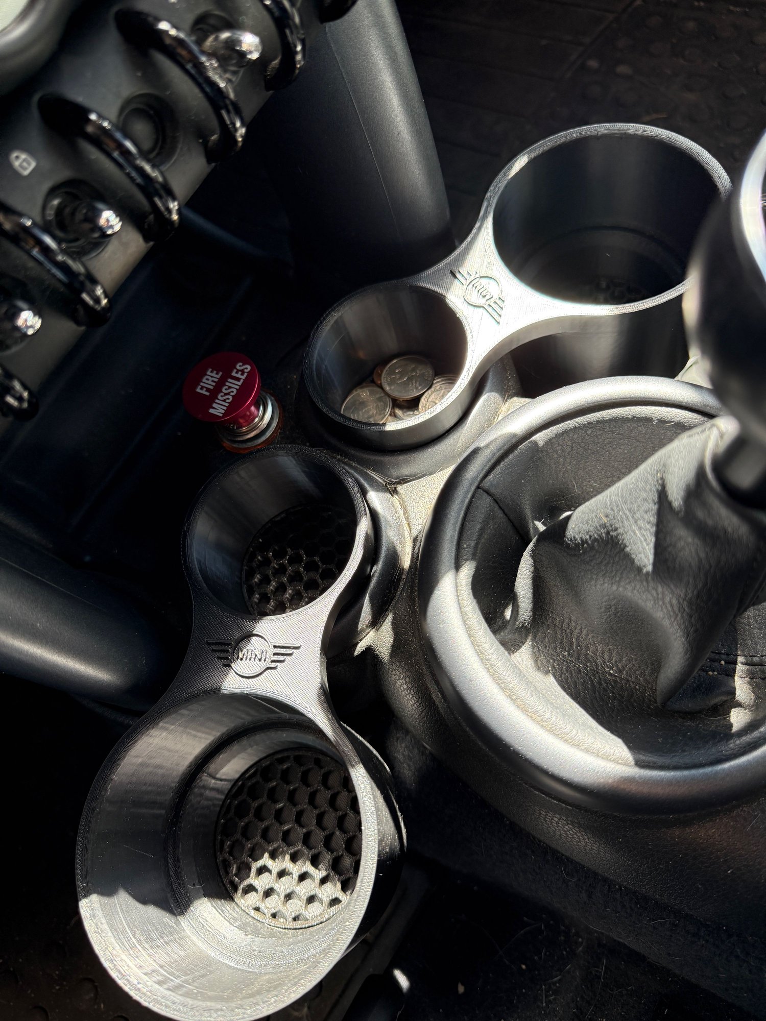

Love those cup holders. Nice touch.

Found both the cup holders and the phone mount on Etsy.
https://www.etsy.com/listing/1740145...1%3A1740145444
https://www.etsy.com/listing/1789248...9%3A1789248577

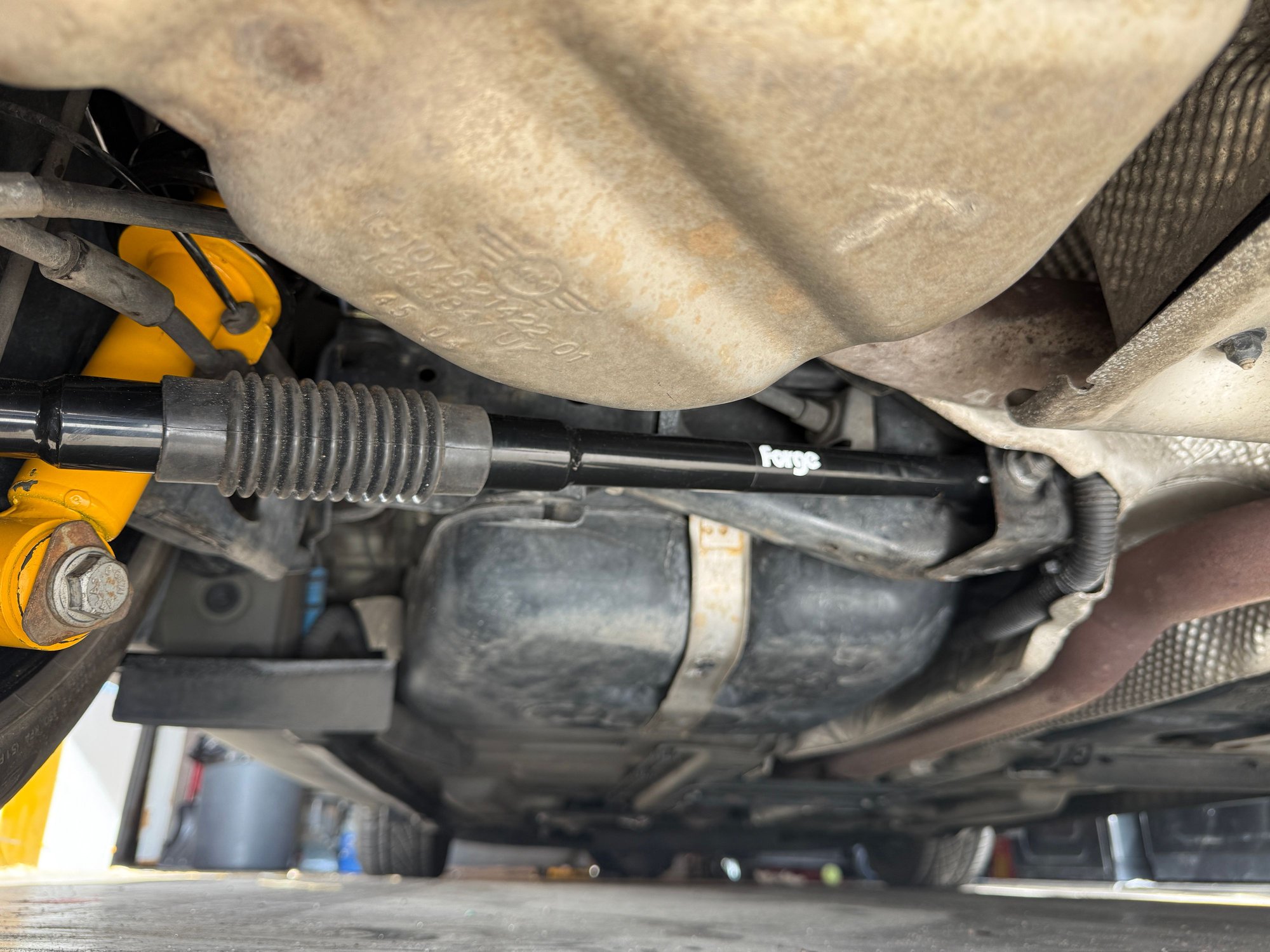

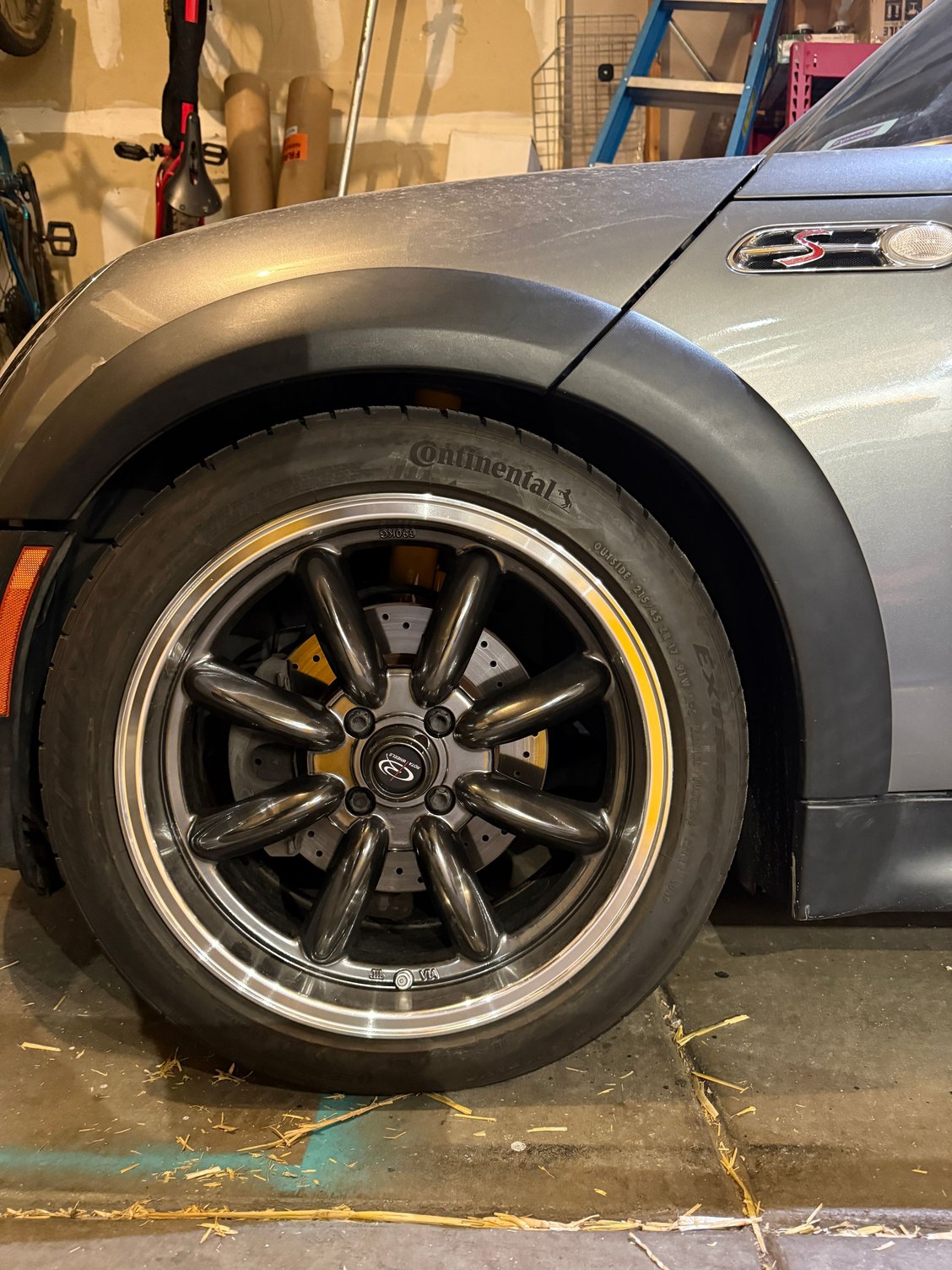

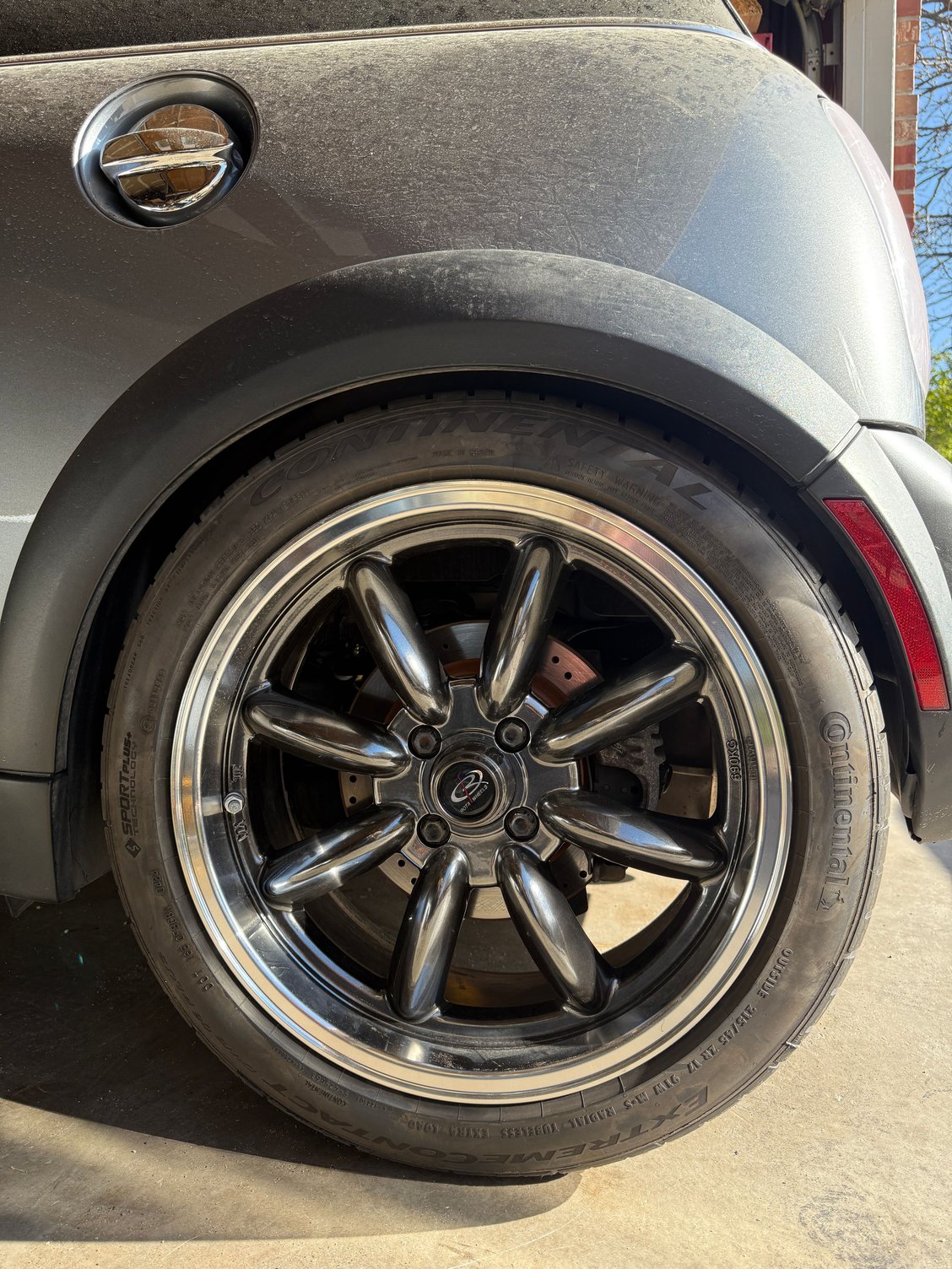

Koni Yellows, 19mm RSB and Forge adjustable arms installed yesterday.
I adjusted the arms to the same length as the fixed arms so that should be good enough to drive up to Todd's for the rest of the work. Todd will have an alignment done after the front suspension work anyway.
Took a quick drive around a few blocks to settle the suspension and check the ride quality. Ride is firm(er), but not bad. FWIW, I adjusted the fronts to +25% or one half turn towards firm and the rears at 50% or one full turn towards firm (rebound dampening). Two full turns are available on Koni Yellows and I'm sure that I will muck around with it more after all the other work is done on the front bushings and all the hoses replaced.
Big thanks to the various posts around rear Koni shock assembly (thank you NAM search function!). The beveled/relieved side of the thick washer/stop goes towards the C-clip wire (from the top of the shock or hat side of the shock - so the C-clip and the beveled side goes towards the ground, not towards the sky) and yes it does snap over the end - and also yes, the hats do need to be drilled out to fit over the shock rod.
Had a heck of a time installing the top nut though. Went to O'Reily's to buy a spring compressor. Used some hand clamps on the springs for the front, but it didn't work on the rears.
Here's the rear photo after the quick drive. Definitely lower! (Pardon the dirty Mini though).

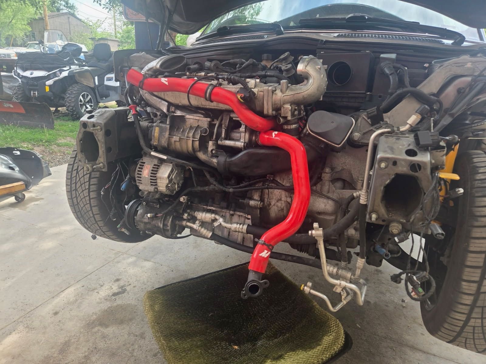

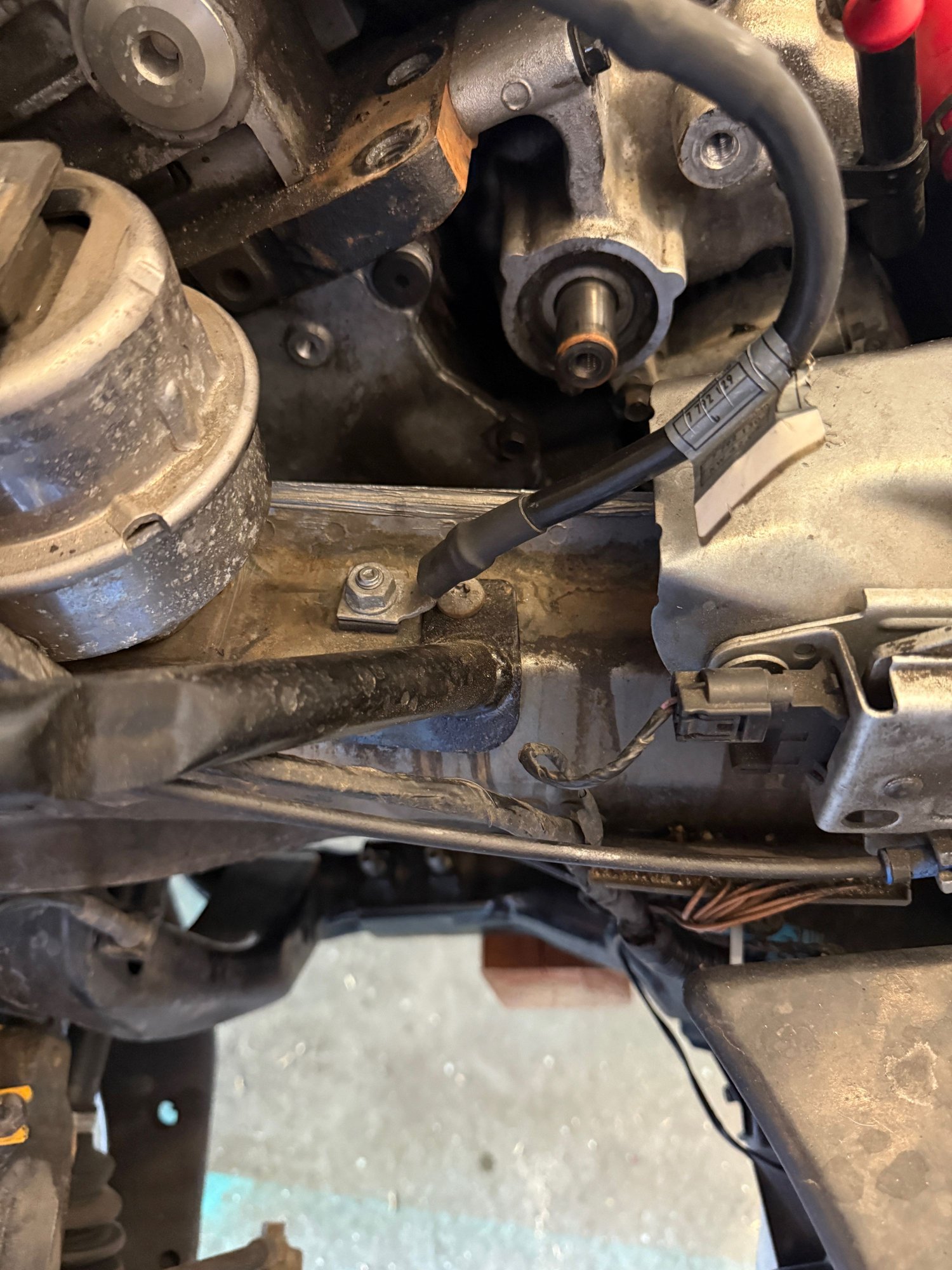

The photo above was approximately the mid-point of the rebuild. All of the coolant hoses were replaced, along with a new aluminum coolant tank, and we started on the bushing replacements by lowering the subframe. Thank goodness Todd has a large vehicle lift and a few transmission carts.
Torn bushings were a bear to get out but finally did it. Pressed the new ones in and all was good. While the subframe was down, the rebuilt passenger side CV was put in. Turns out there are some differences between generations of CVs. Bought one, wouldn't go in, bought a second (thinking the first one was mismarked) and it still wouldn't slip fit. ended up rebuilding the original - which added another day. The original obviously installed easily and all is good. Then went on the power steering hoses and we took the subframe down to the local car wash to degrease the subframe from all the grease at the torn CV boot.
On Wednesday morning while we were waiting for the CV (and before the planned long trip), I put in the new fog lights (originals were cracked) because I had some time. By Wednesday afternoon, the subframe was off, control arms were removed and the new power steering lines were routed.
Thursday had the new control arm bushings installed, everything was reattached and we took it for an alignment. After the alignment, the car's front grill bumper facia and tubes were reinstalled. Todd and the guys took Otto for a shake down drive to ensure no leaks (there weren't). After multiple heat and cool down cycles, everyone claimed the car was good to go.

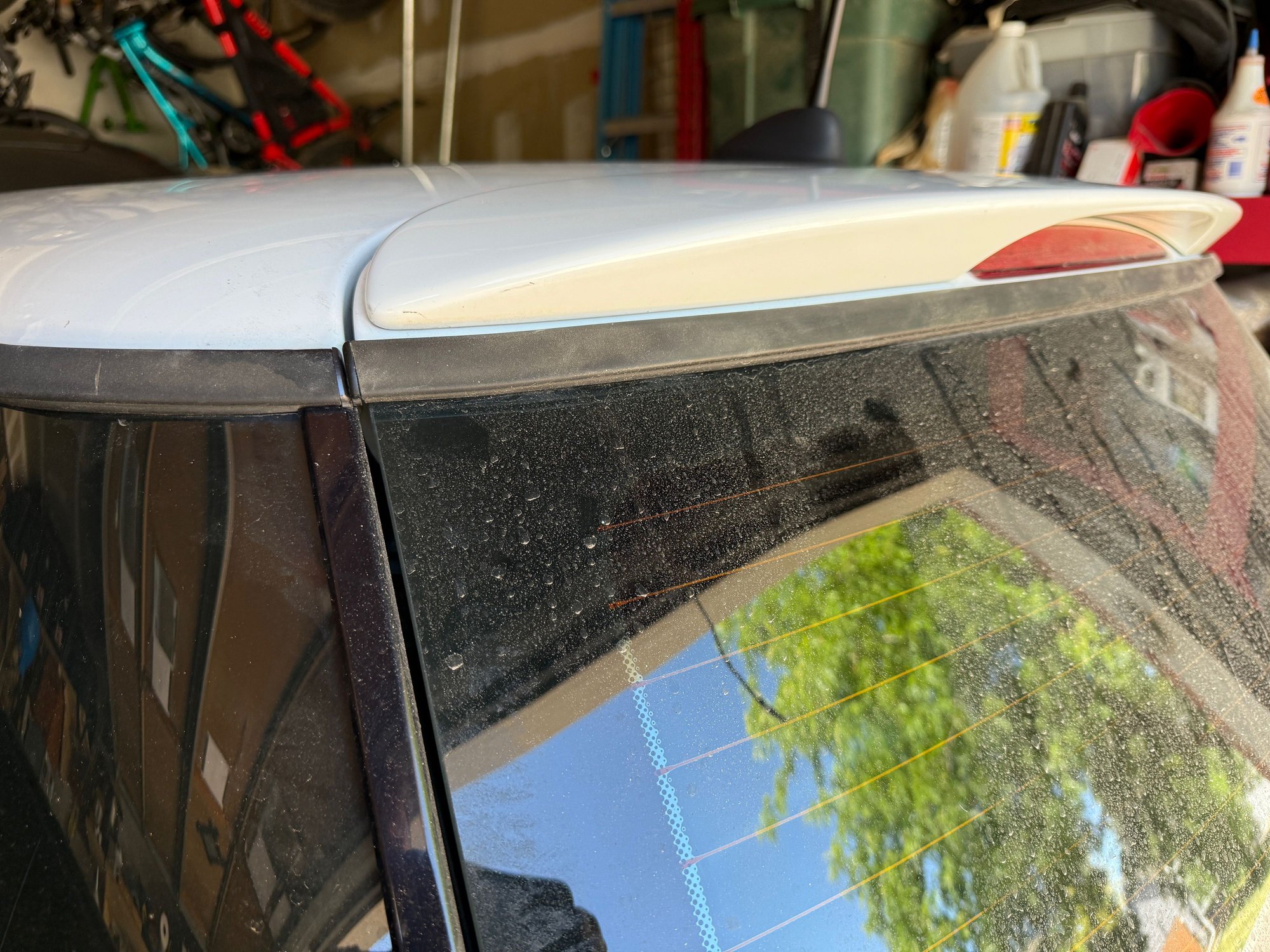

On the Tuesday after we returned on Thursday night, I took the car to a local PDR guy to do the hood (I said there were ~5 dime sized hail dings on the hood - he circled ~45 dings. It took hime 2 days to do the hood, but it looks great.
Now the bad news. It turns out there is a very small crease below the Mini logo on the front of the hood. It's not really noticeable but it is definitely there if you look. He did his best to get it straight, but it's not the best. Now I've started looking for a new hood, but pickings are scarce for those in good shape - and I really don't want to respray the car. Also under consideration is a carbon fiber hood. Started researching carbon hood vendors and from what I've gathered, carbon quality varies widely. Seibon will likely be the choice if I go that direction. I still need to make some phone calls to discuss with the vendors, but that decision will be made in July or so.

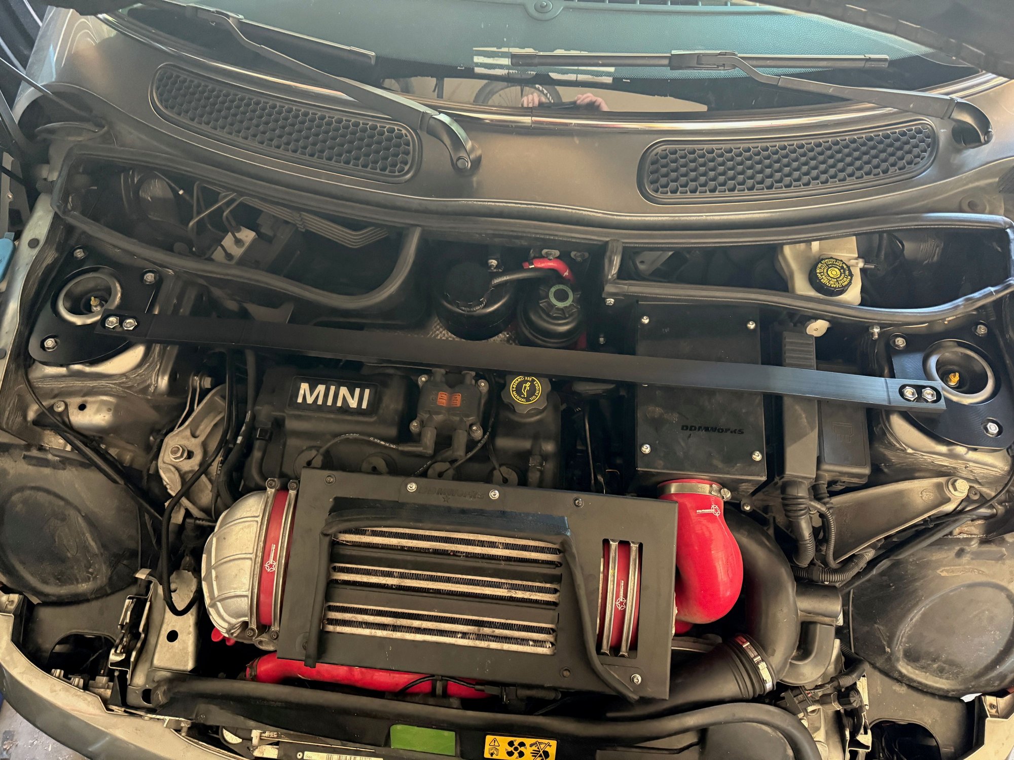

Today (6/19) more WMW parts arrive - front tower strut brace w/tower caps. Also arriving is the 15% pully, new plug wires, new colder plugs and a new ignition module. From eBay today is a new to me (used) Mini Cooper spoiler in white. FWIW, the prior one that I bought has one of the attachment bolts that is buggered up and while I tried to JB Weld in in, I'd feel better with one in sturdy condition - so I bought another. Both the front strut brace and the spoiler should be installed later today.

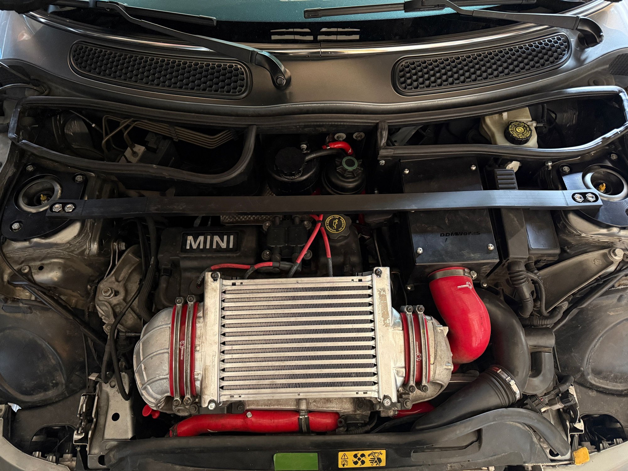

The WMW strut tower brace installed and the replacement spoiler is on. All good for today. Tomorrow is the new pulley, plugs, ignition module and new belt. (Hopefully!)

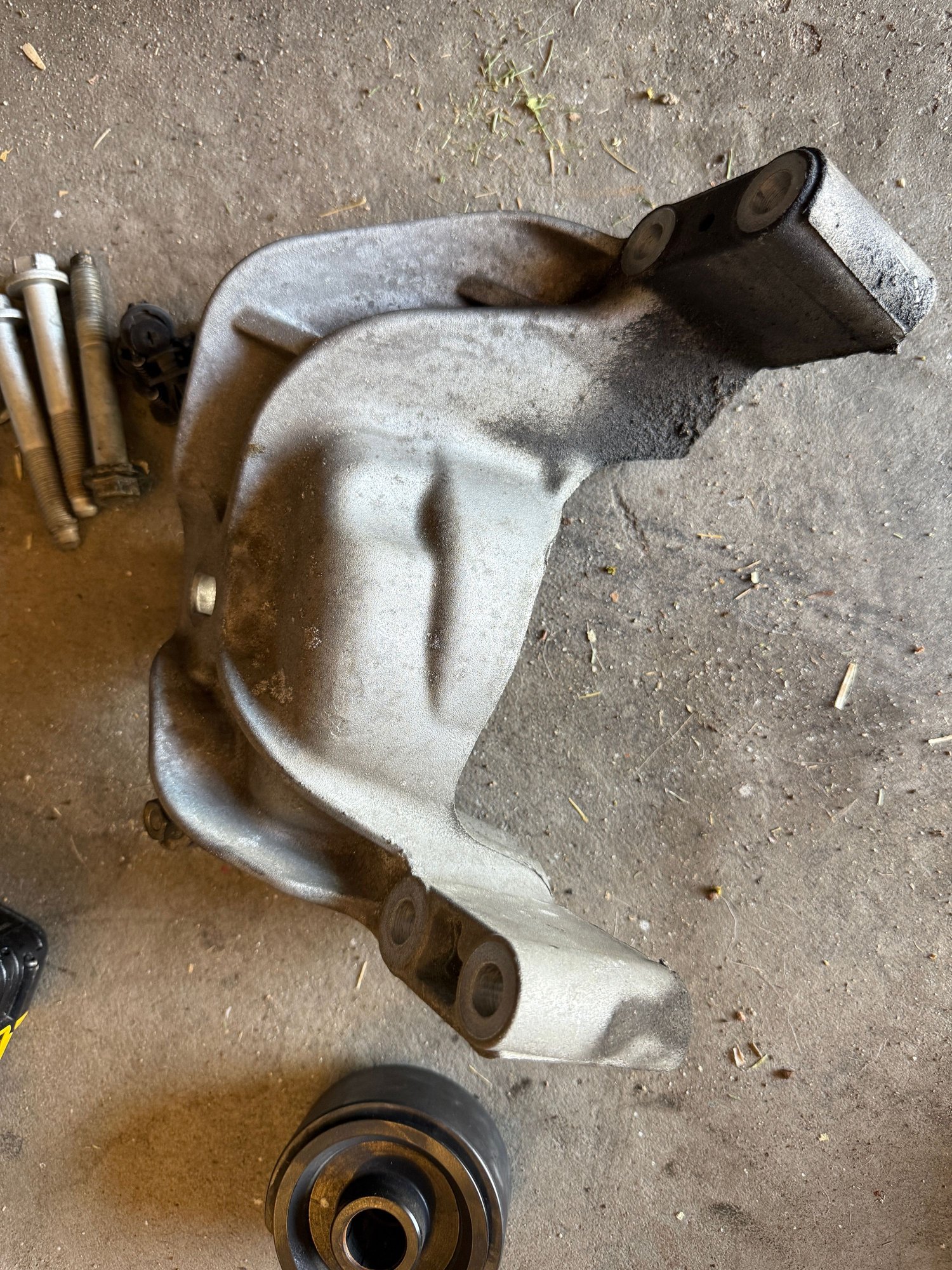

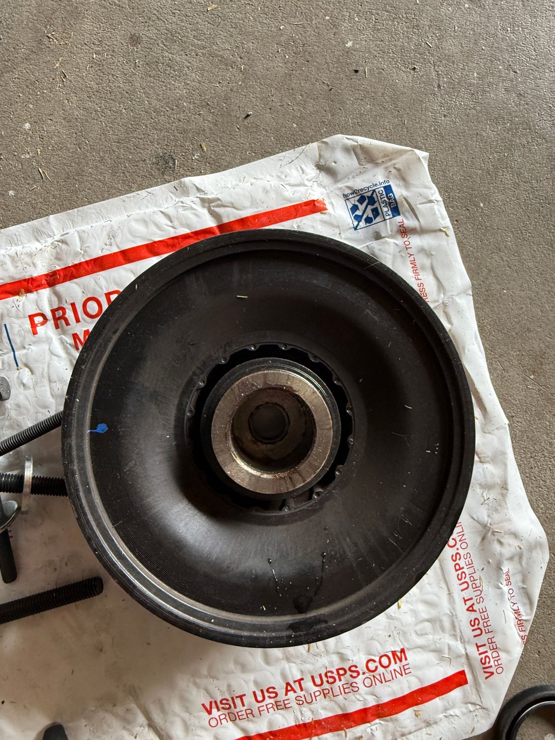

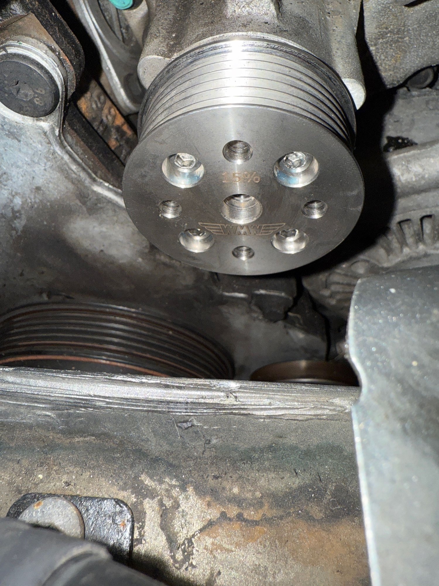

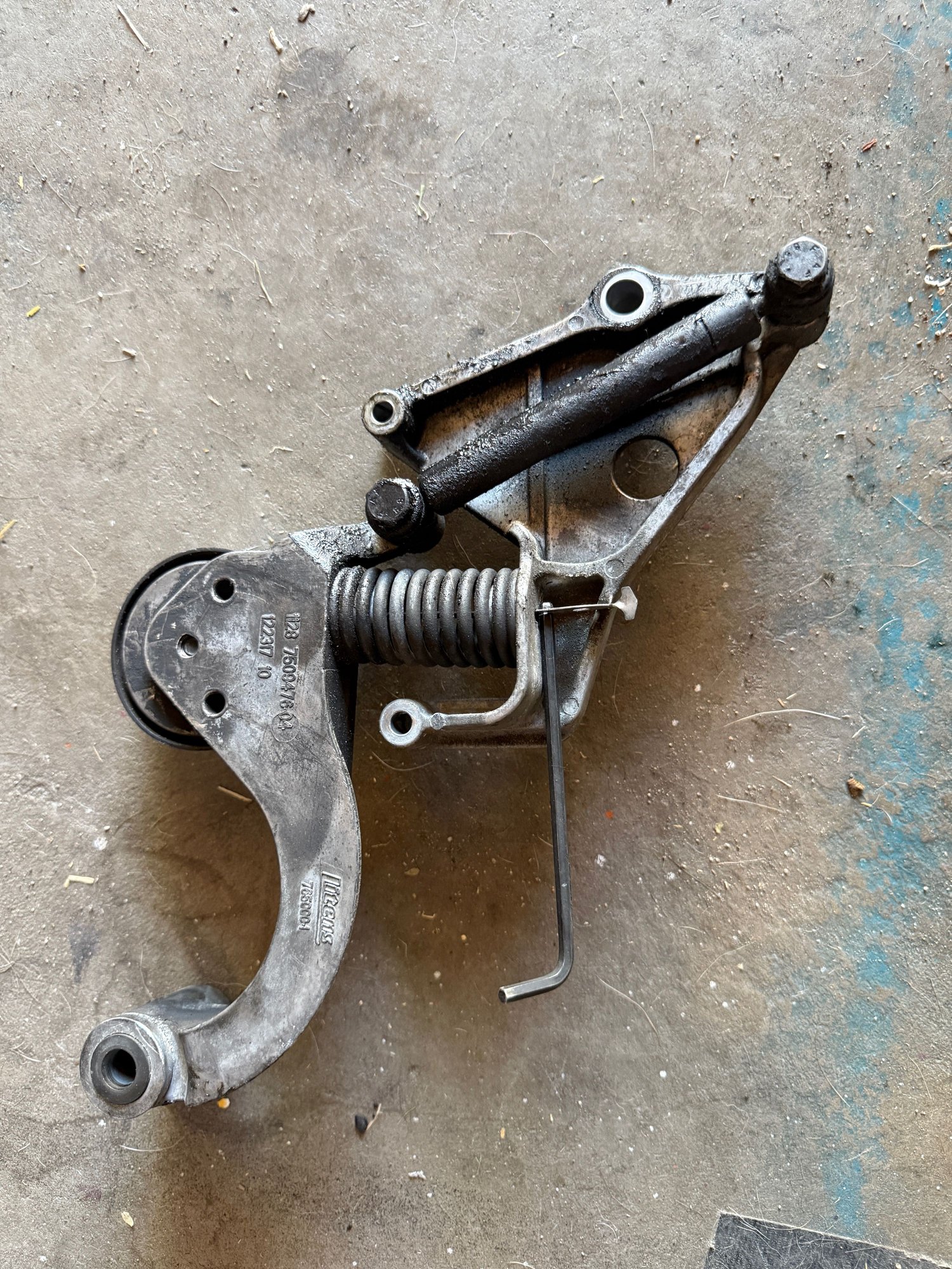

The pulley install went fairly easy thanks to the video prep (thank you ModMini!).
One item that sort of bugs me is the lack of a torque spec on the pulley screws from WMW. I did some research and didn't really come up with anything definitive but they're in, the pulley doesn't slip, so I think I'm good(?).
(And) Through the magic of the Internet - the pulley is installed!
While the subframe and steering rack were cleaned at the car wash doing the bushing and hose install, the mid section of the motor didn't really get much cleaning at all.
So I took the opportunity to clean quite a bit too. Man when a CV boot goes, grease gets everywhere - sort of like sand in your bathing suit when at the beach.
So back together it went and new WMW ignition module, plug wires and plugs were installed.
Fairly easy job if you follow ModMini's advice. My install wasn't flawless, but still went pretty well. If I had to do it again, it'd be faster and less mistakes.

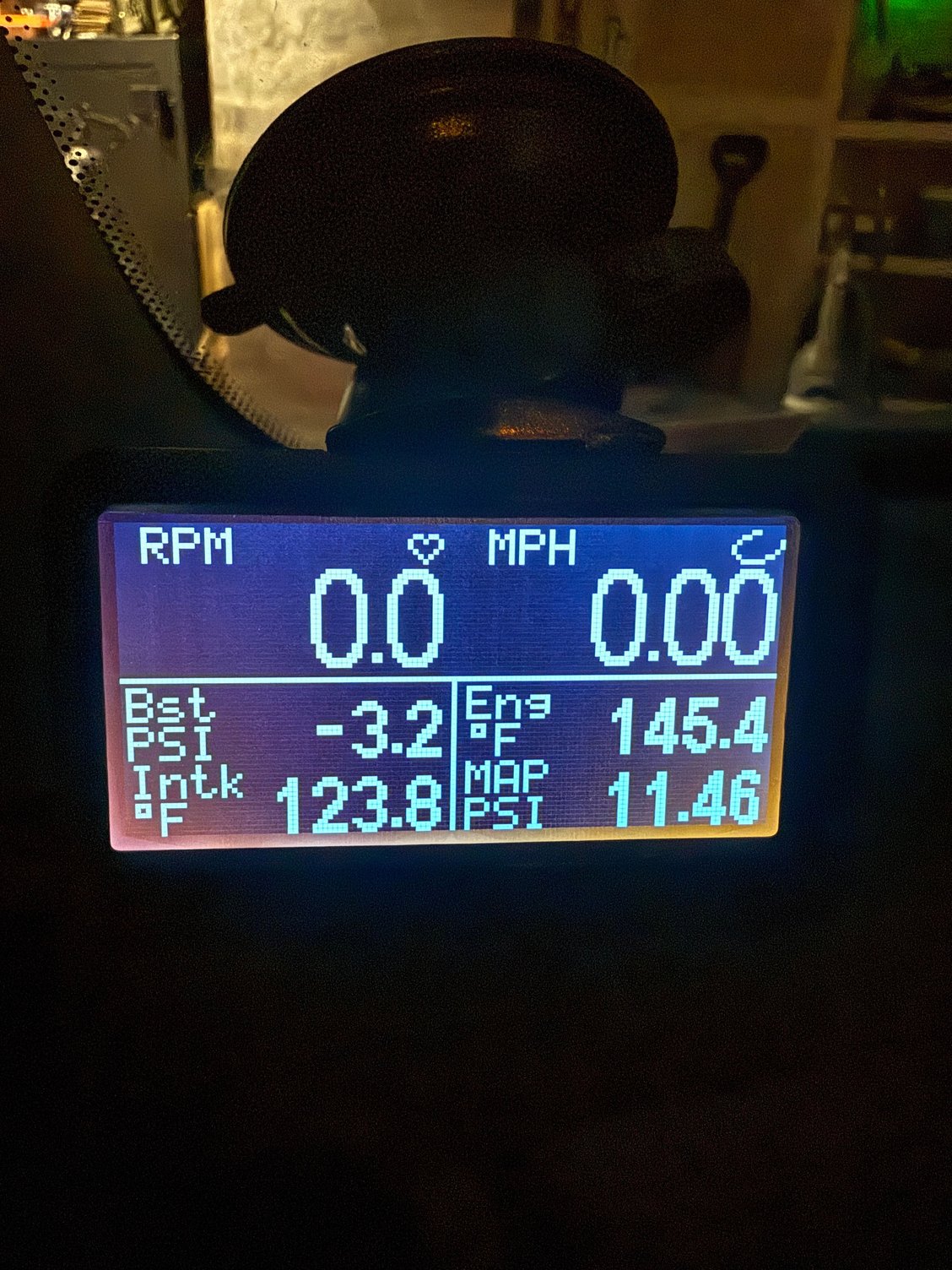

It's been a couple of days since the pulley install and I thought I'd post my butt dyno results.
First, I personally don't feel anything different with the WMW front strut bar and tower defenders installed. The car still handles great but is it different with the front strut tower brace installed? Not really. IMHO, what I do feel is a sense of relief that the strut towers are better protected. That alone is work the price of admission. I also don't think that I'd only install the strut tower defenders and not the cross brace - it does tie things together more and I'm sure as the car ages, it'll keep it tighter - so more protection than anything? Either way, I'm glad it's installed.
When I installed the new plugs, wires and ignition module, I noticed that two of the ignition module terminals were corroded and rusty. Does the ignition module and wires add HP - unlikely, so more of a maintenance item that just needed to be replaced.
With the stock pulley, the car had power. It also took a bit for the supercharger whine to be engaged. With the 15% pulley, the car is definitely a bit faster and the supercharger whine is engaged much earlier (at lower RPM). I think with the 15%, the engine just makes more power everywhere. Once I get the exhaust done I'll get it tuned and we'll see what the dyno says. Right now, I think it is brakes time - maybe August will have a R56 brake upgrade landing at my door.

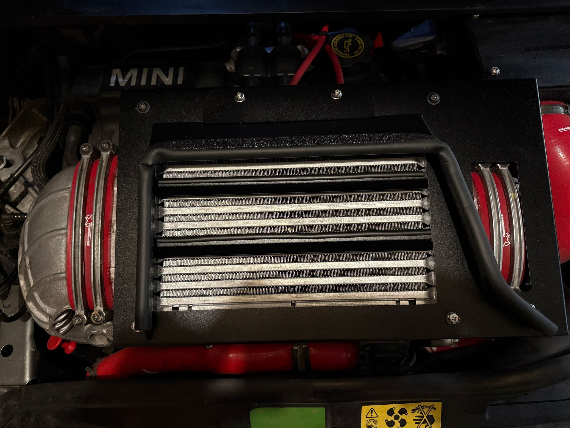

Anyway, I ordered and installed both a Mini GP1 intercooler and 380cc injectors. I also ordered a black DDM GP intercooler cover/diverter but it hasn't arrived yet. At the time of the install, I reset all of the driving adaptations to give the ECU a fresh start on learning how I drive. I can feel the HP increase of 380cc injectors throughout the rev range and Otto accelerates far more quickly than it did previously. Yes, the computer "learned" the new injectors after I reset the adaptations. It did run a bit rough for the couple of miles - then smoothed out great. Idles fine now too.

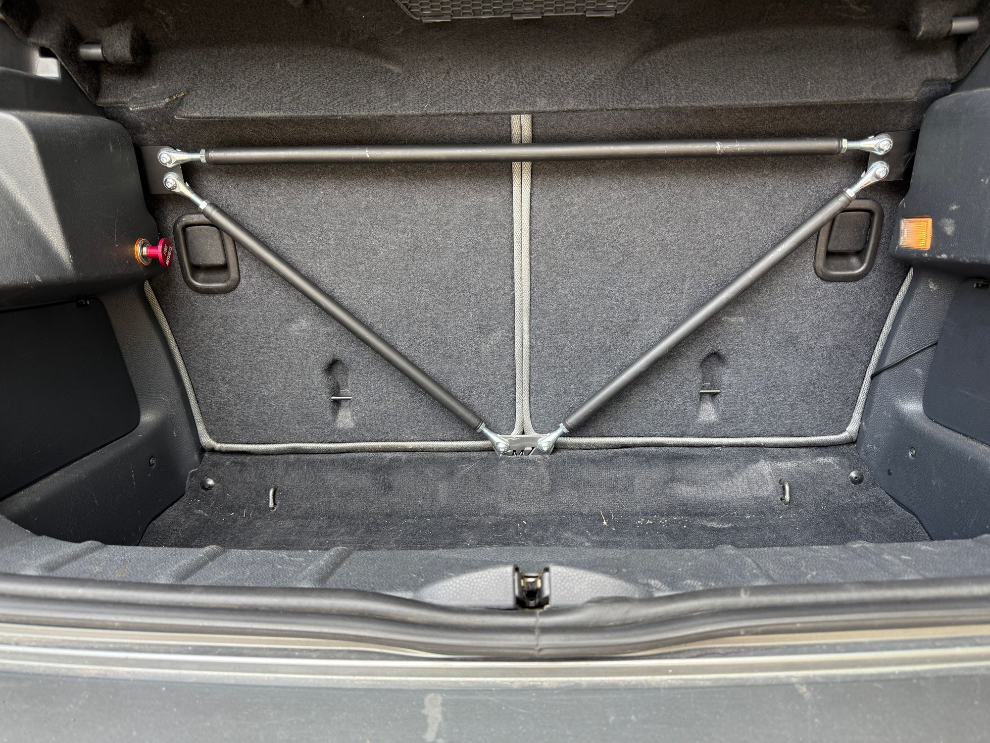

I also received and installed the M7 rear brace. The cool part is that quite a few squeaks and creaks went away with the WMW front strut brace. All of them have gone away with the installation of the M7. Otto really drives like a new (old) car. I do like that it is triangulated in the rear design with 3 hard attachment points instead of the versions that only attach behind the seats. The M7 rear under brace has yet to arrive and don't have an ETA yet.

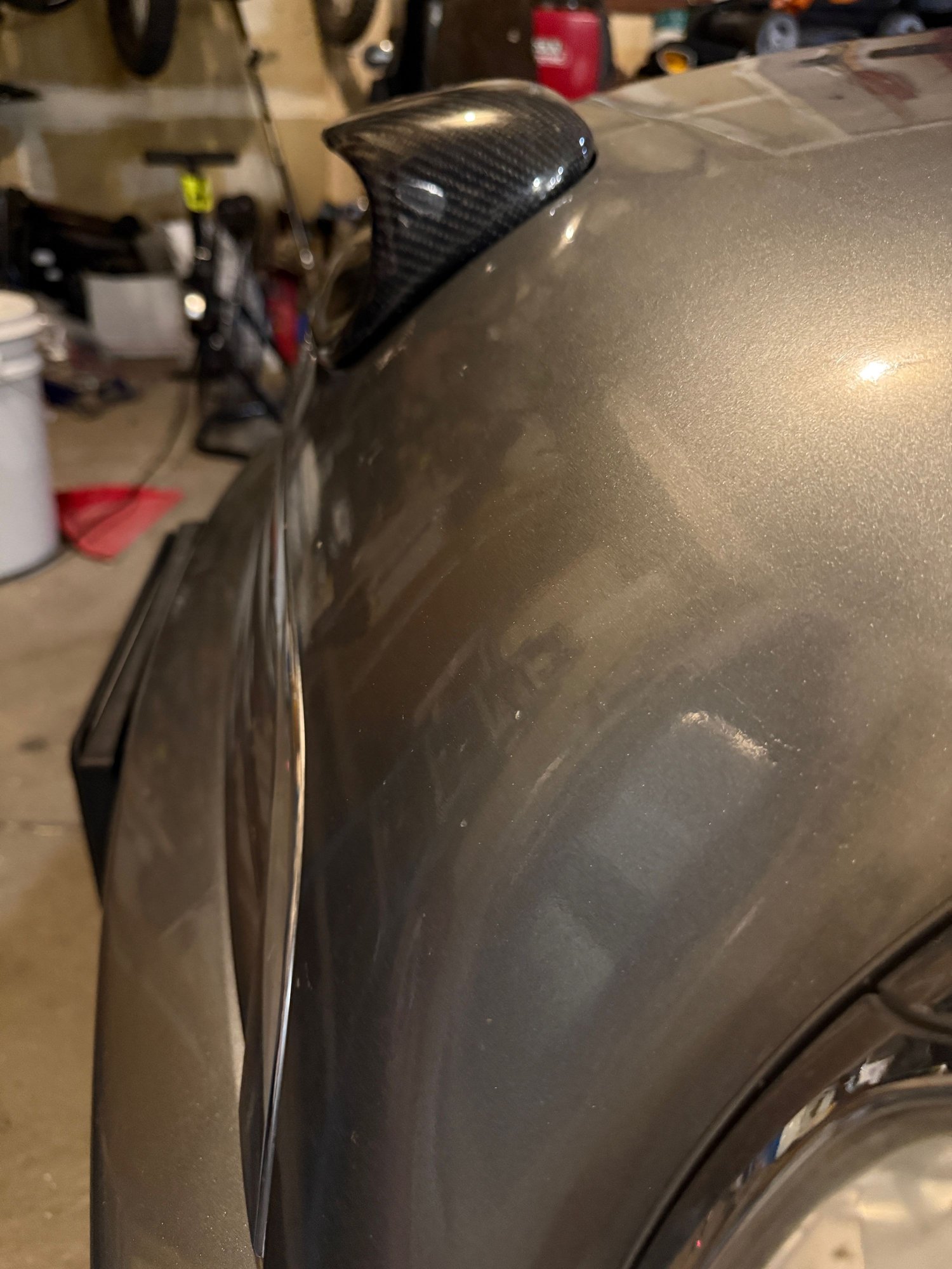

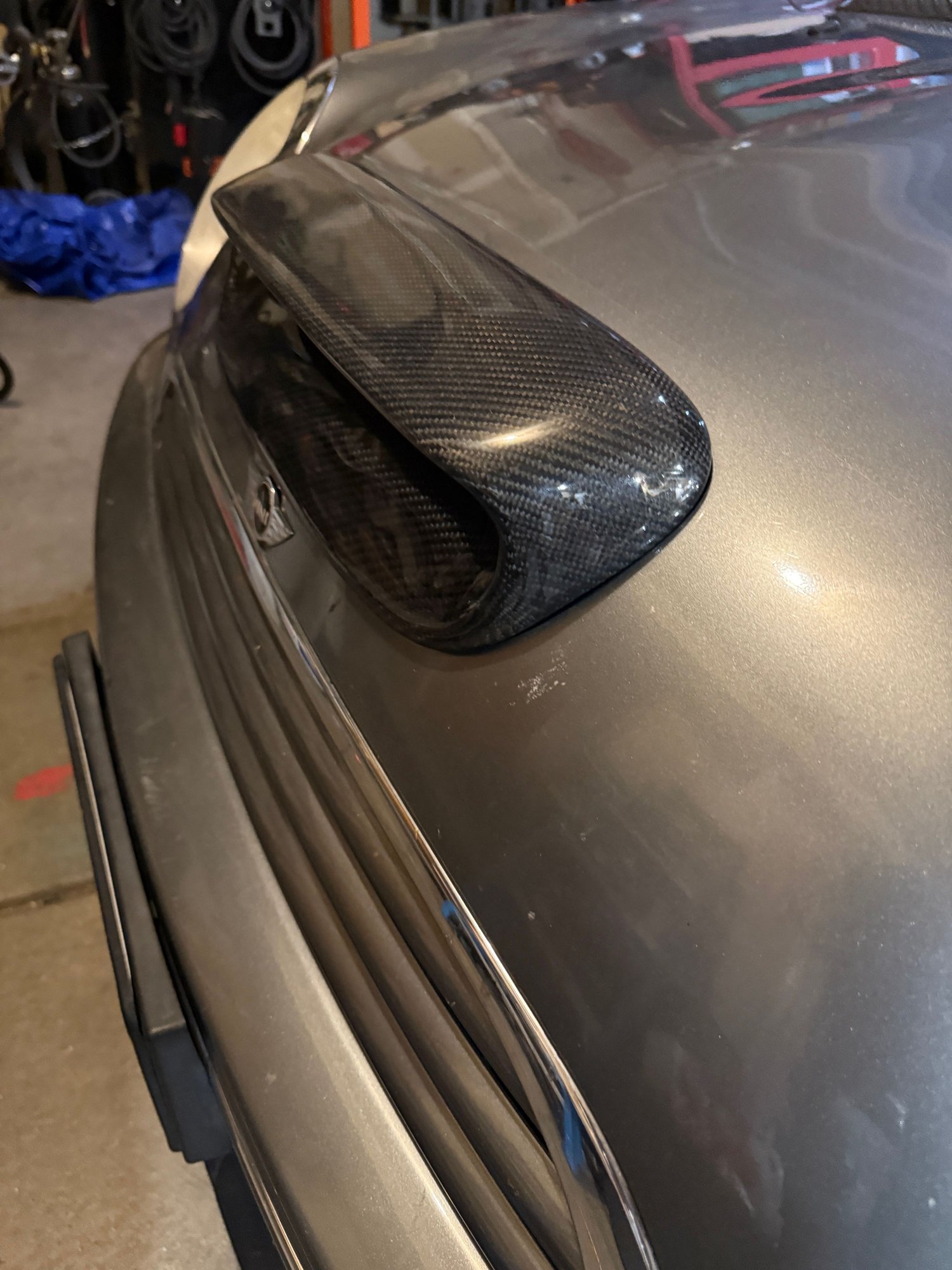

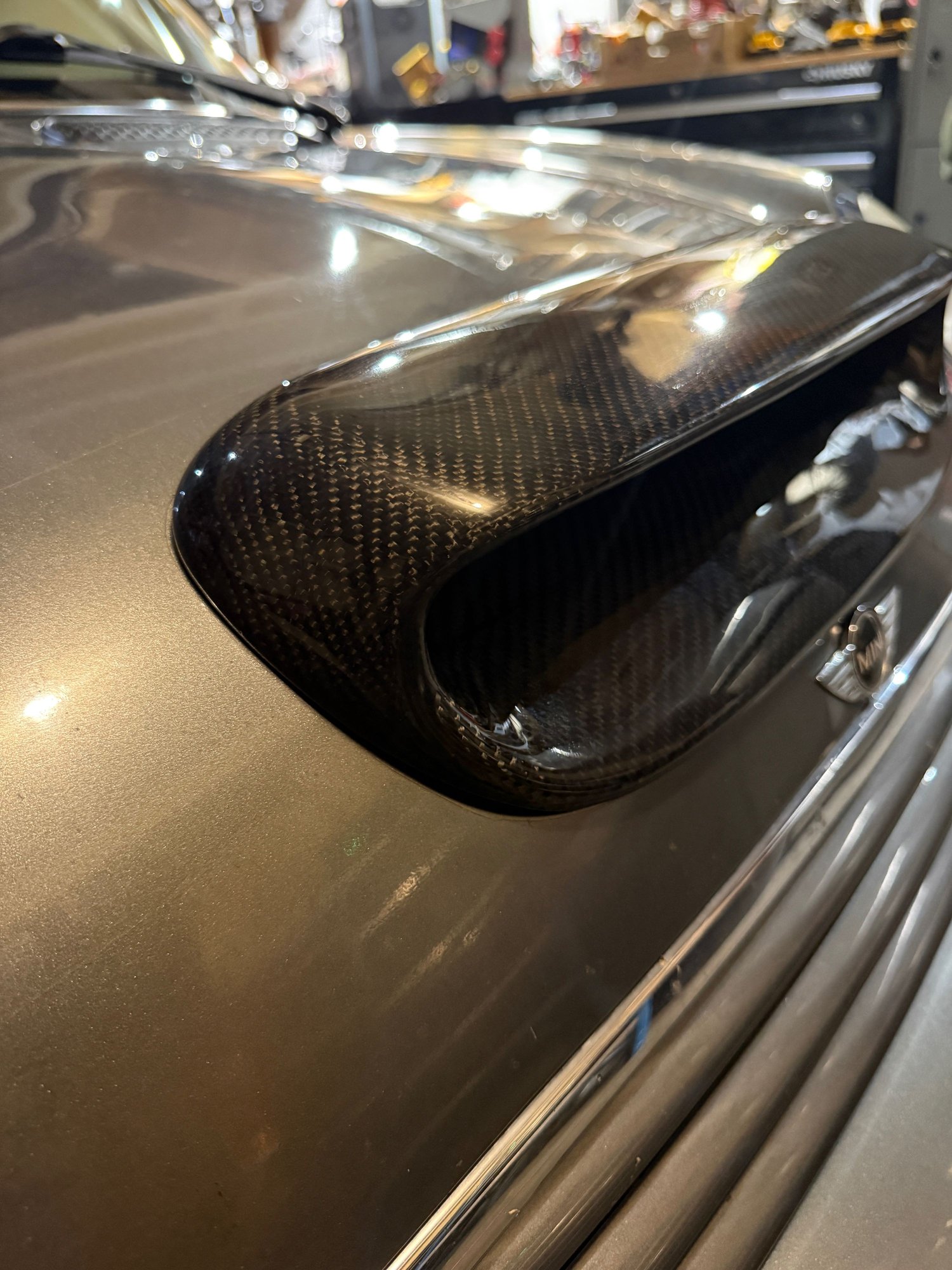

As for the rear GP wing that I wanted to install. Oranje changed their configuration on the carbon fiber wings they sell online. Many options are now no longer available - plain white (my top color) isn't available, nor are the red wing adjusters.
So, I went a different route. I found a guy in Germany that makes his own parts - and the parts are TUV approved. That means they aren't junk and are actually very good quality. He was a pleasure to work with and the Mini GP wing is on its way. Currently it's leaving NYC after import inspection and should be here next week.

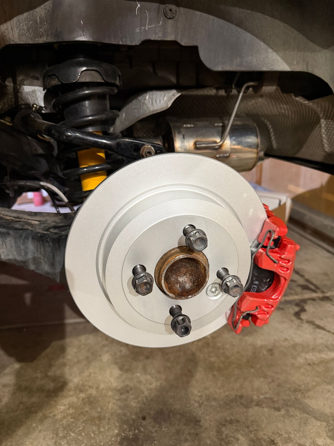

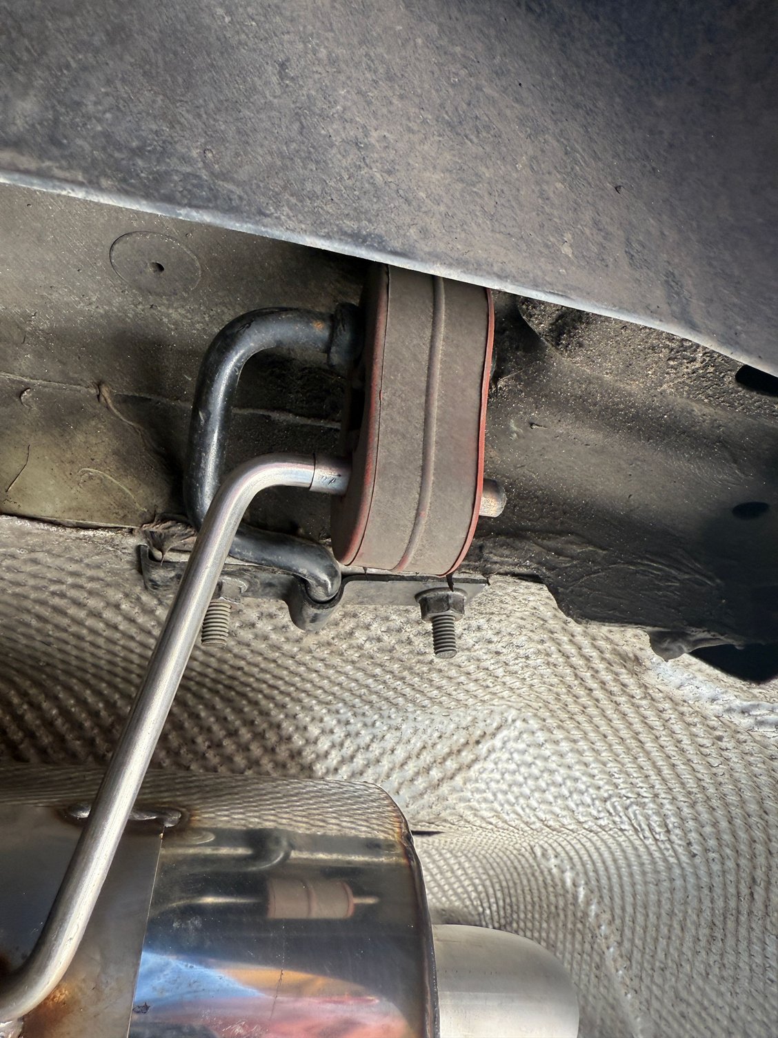

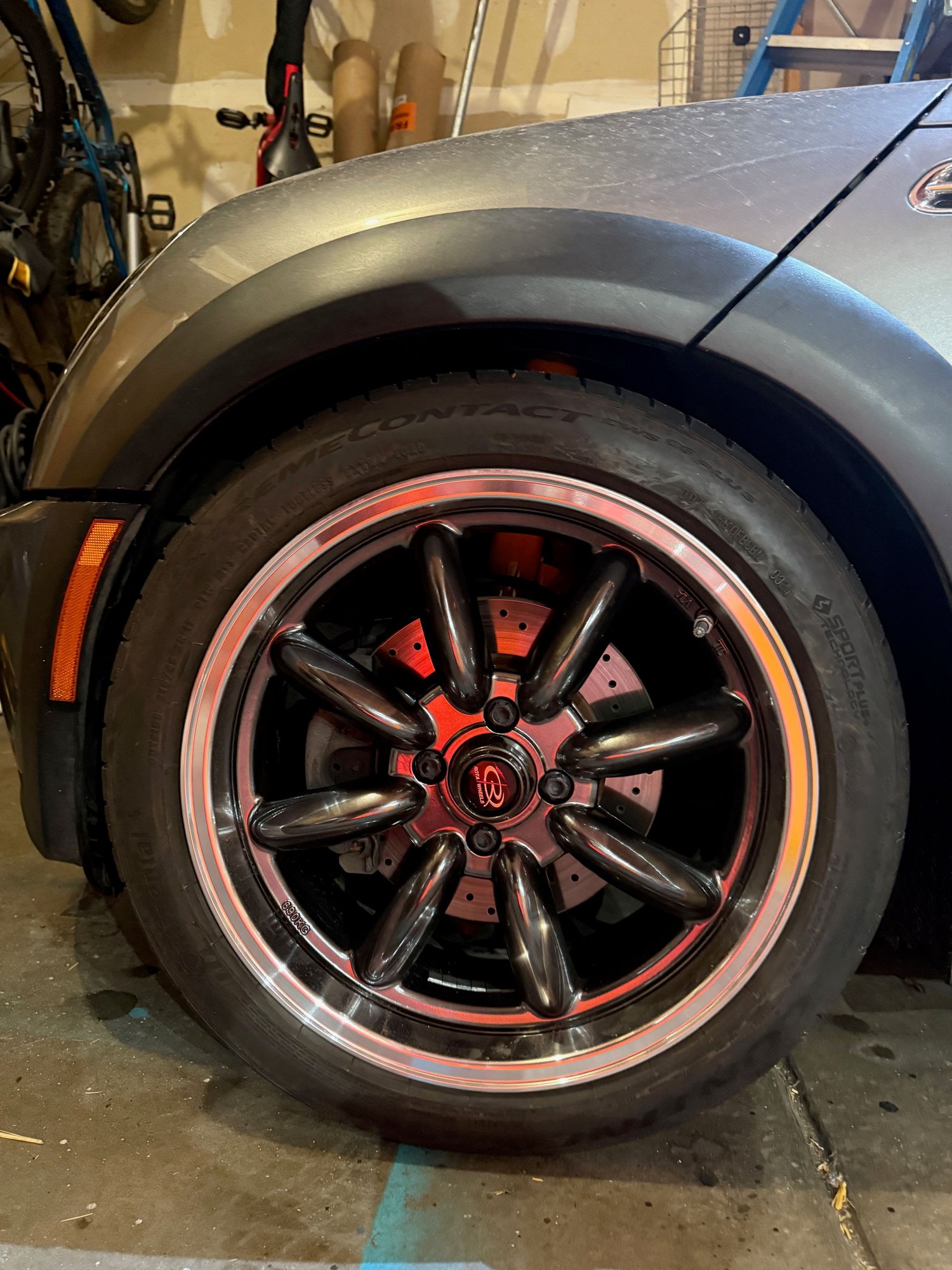

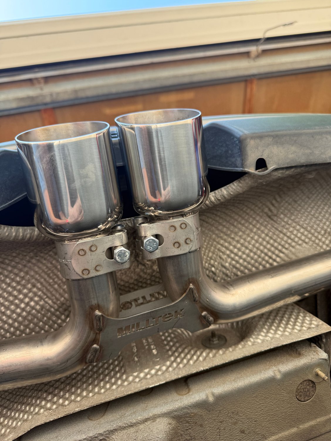

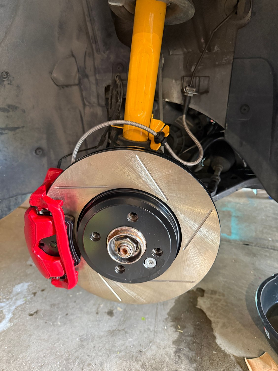

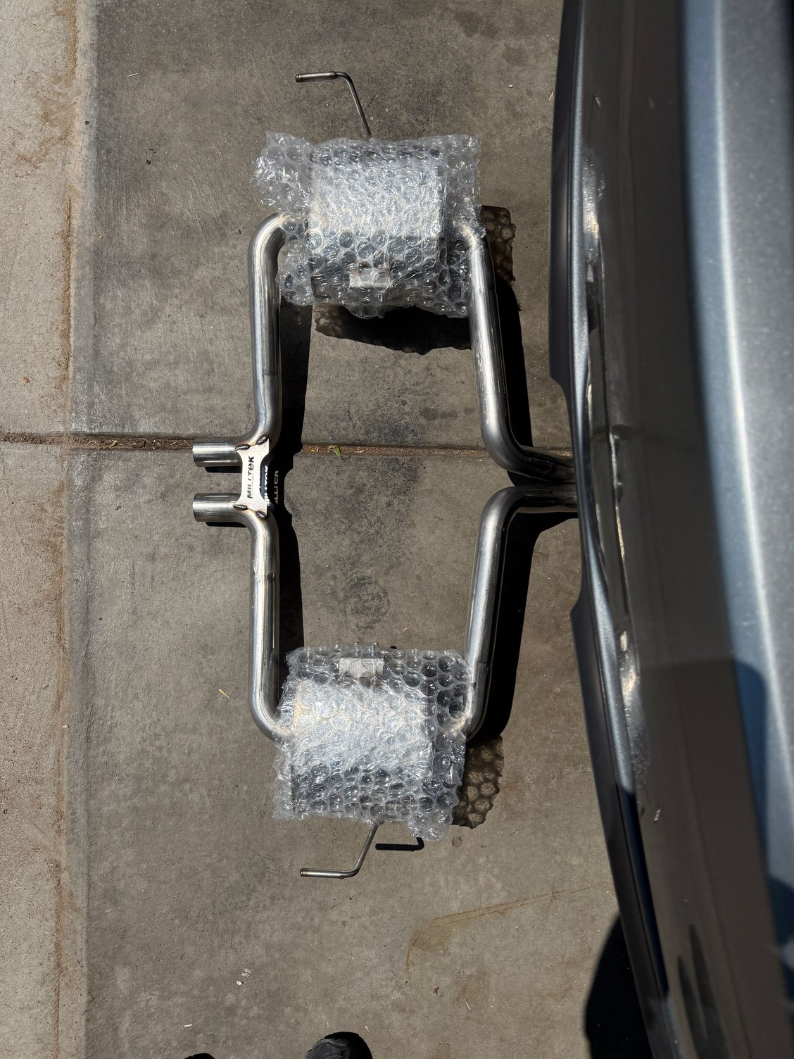

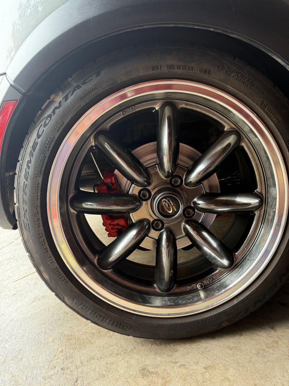

I also placed a rather large WMW order the other day. New R56 brake kit (Akibono ceramic pads (Euro spec pads), rotors, calipers and braided SS lines) for the front, Akibono pads, new rotors and SS lines for the rear. Grooved for the fronts and plain faces for the rear. I went with Akibono pads for now and will look at higher performance pads in the future. I'm still researching pads and didn't want to wait to order all the parts. Akibono's are better than stock and may not do so well on the track, but it'll get me through for a bit. Also in the order is the Milltek SS exhaust system and a new 2% overdrive ATI crank dampener and new crank bolts and seal.
I plan on doing all the work myself, so I ordered some Motul 600 brake fluid, EZ bleeders from Pelican. I also ordered red caliper paint for the existing rear brakes, as well as a brake bleeding kit both from Amazon. At the same time as the paint and the bleeder kit I ordered a PDR (painless dent repair) kit, so I'll be getting my feet wet there too.
I'll be sure take photos of the exhaust, brake and wing install in the next post. Brakes and exhaust may be here this weekend, so they'll live in the garage for a week or so because I won't have time to work on Otto this weekend.

nice work. that rear M7 brace. How is that tied down? Welded in?
Old Jul 14, 2025 | 12:11 PM
JH-Evergreen's Avatar
JH-Evergreen
Joined: May 2021
Posts: 82
Likes: 91
From: Denver Metro
It's bolt-in and it is super solid.
The top two points have you remove the rear upper seat holding brackets (two bolts each side and reassemble with the M7 plates. Note it does move the top of the rear seats ~1/2" forward (towards the front seats).
The bottom bracket has three holes - the middle hole is a re-used from a central bolt for the rear seats. Two additional self tapping bolts are screwed in on either side of the middle bolt. I sliced my carpet about 1.5" in order to make it look right.
Slide the end keepers of each shaft into the brackets and tighten loosely with the included bolts. Once everything is connected, tighten up the bolts . Top bar is brought up tight, then the two bottom bars are tightened. Wash rinse repeat until they're rotated tight. Final tighten all the bolts.
Install took ,me longer to get the tools together then to actually do the install itself. M7 says 30 minutes and total for me was ~15 or so total.

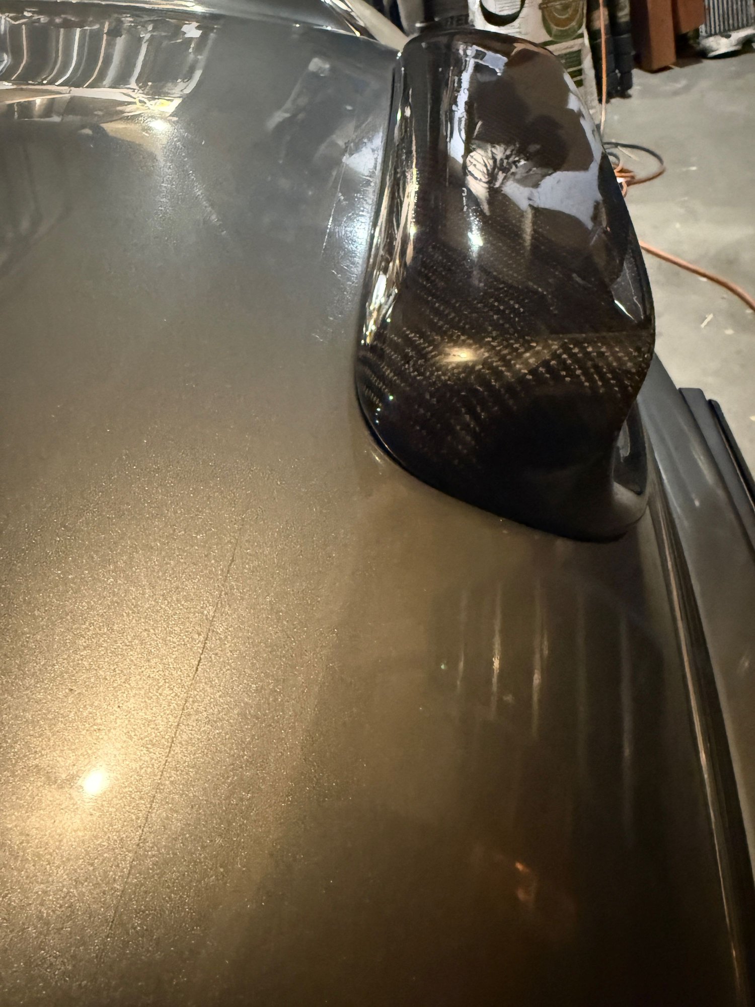

Carbon Scoop, GP Wing and Brakes
Carbon scoop arrived - great condition, fits well, looks great!
Here are some photos from different angles. Finish is flawless, though I didn't wipe it well prior to the photos.
Now the bad news, 8 days in transit from Aurora (CO) to Castle Rock (CO). Flipping USPS. Anyway, the GP wing isn't here yet.

Clutch Slave Cylinder and ATI Super Damper install
Well, of the best laid plans of mice and men...
It turns out that as I prepped for the brake install, I realized that my daughter had left in my truck. She flew into town for her Ultra Marathon (50 Km run) and borrowed my truck while she is in town - and she left our house to visit high school and college friends only to return today. (And) It seems that most of the tools I needed for the brake install were in my tool bag in the truck. So, no brakes. Yet.
I did have time to replace the clutch slave cylinder. Twice. Mod Mini has a great video on replacing and bleeding the clutch slave cylinder. He used plumbers bands and two long screws/nuts/washers to make a jig to compress the cylinder when installing and bleeding the cylinder. I fab'd up a similar jig, but hillbilly style and it worked great. The only problem that I had was when I went to release my jig. Seems it really isn't advisable to have the system under ~15 pounds of pressure when you release the jig. Brake fluid squirted everywhere - and one cylinder seal is now toast. So off I went to O'Reilly's for another one - had to drive ~40 miles to get it (thank you Paul, my '13 Mini that just continues to run flawlessly!). Anyway, second time around the installation went fine. I'll try to re-bleed the cylinder again to see if there are any additional bubbles in the the cylinder- and get just a bit more clutch pressure in there too. Anyway, did the install Saturday and on Sunday, we put some miles on the car. Much easier to get into first gear, so definitely needed to replace the clutch slave cylinder.
Since I didn't know the age of the harmonic balancer, I had already planned on replacing it. So today (Monday) I replaced the old harmonic balancer (rubber mounted version) with the ATI Super Damper 2% overdrive version. Install was super simple - no problems or anything. I did also order a new crank seal, but behind the harmonic balancer was actually clean as a whistle, so I didn't bother - and I have a spare, should I ever need to install another.
Below is a pic of the old damper after removal and the ATI installed. Did a quick drive to check everything, and all is good.
Is it smoother, seems to be a bit smoother at idle, so yes. Are there more horses? Maybe. Heck, I can't tell. 🤣 But I do think it was a good move to change it, less to worry about in the future.

Milltek Exhaust Install - and more on the brakes, lights, clutch and LSD

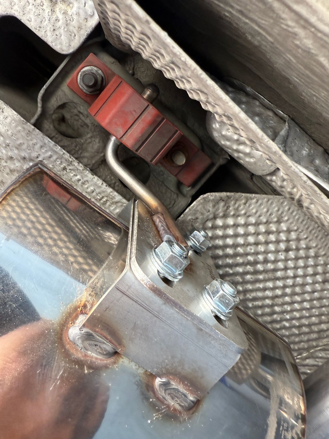

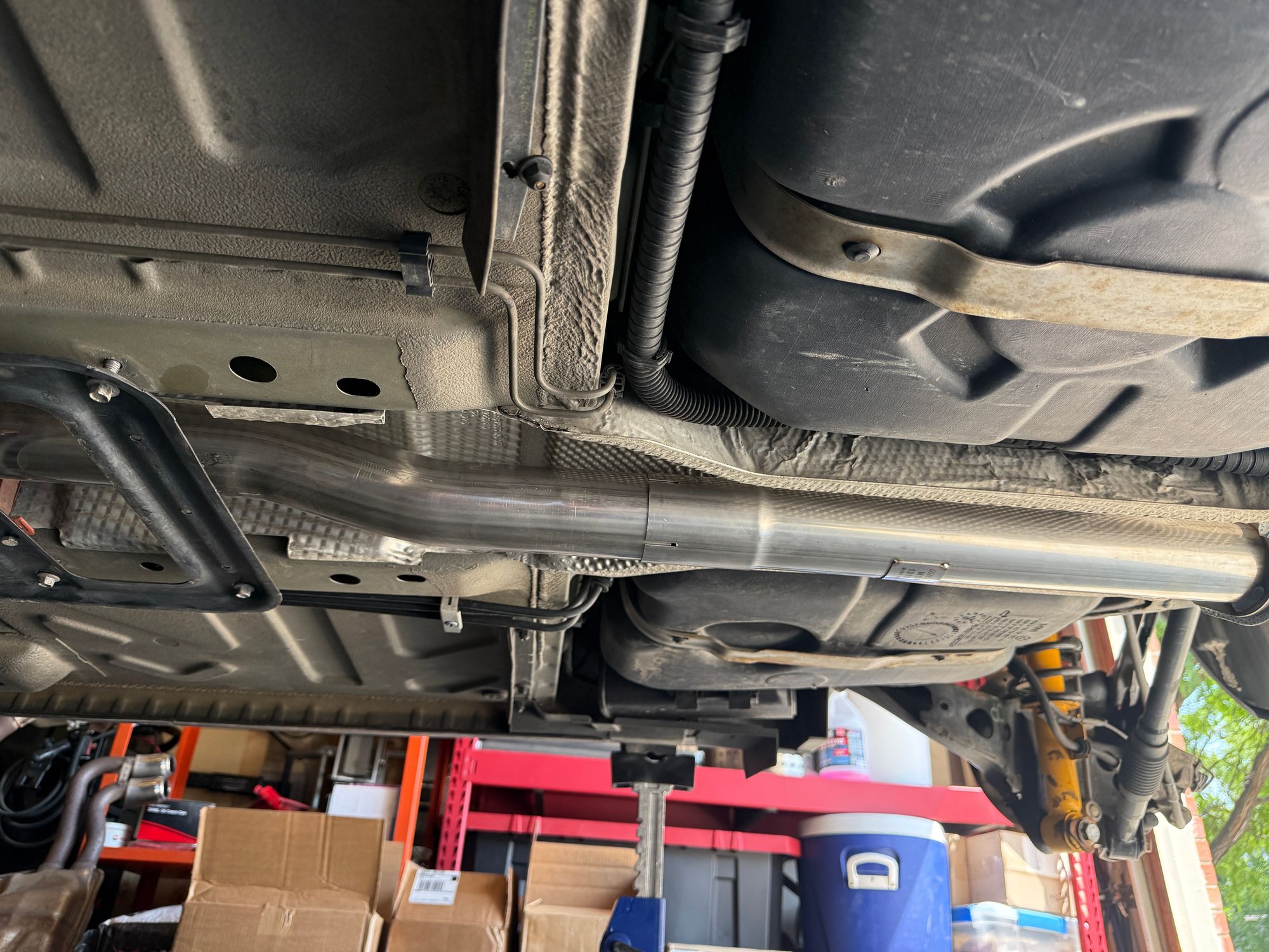

Received the new resonated Milltek exhaust today. Since I knew it was arriving Friday and Otto was already on jack stands, I sprayed WD-40 on the exhaust bolts on Wednesday, and removed the old exhaust on Thursday.
Everything arrived in pristine condition and everything on the manifest was actually in the box - and nothing extra. The box was packed well so nothing would bang against each other as it traveled FedEx. Thanks again WMW for finding a solution to the delay - and covering the expedited shipping!
Since Otto is still on jack stands awaiting the brakes (I need a tool that arrives on Sunday), I decided to proceed. Yes, I "could" have worked on parts of the brakes, but I really can't install anything until this Sunday.
Since the old exhaust was already removed, the total install time was easily less than an hour. Everything bolted right up too.
Here's the handiwork.
Last in, but first shown.  Almost too pretty to hide.

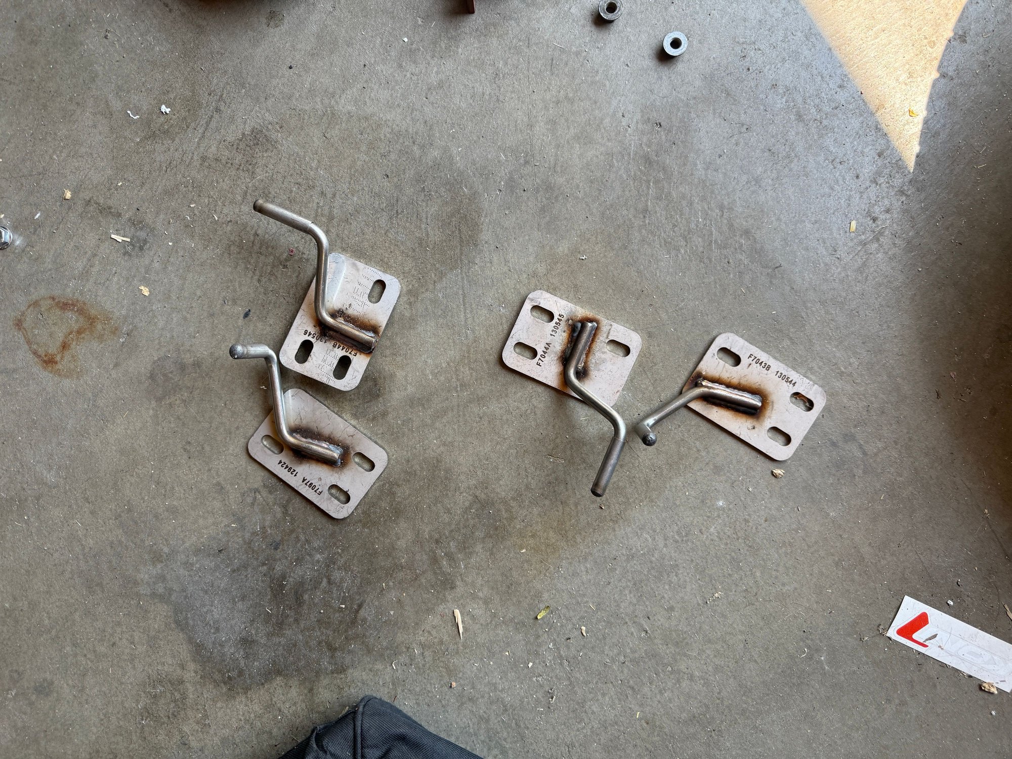

Two different sets of rear section hangers.  Youll only use one set and have one set left over.
Two different sets of rear section hangers. You'll only use one set and have one set left over.
Yes, the pipe does sweep down on the resonator section.  It wont fit otherwise.
Yes, the pipe does sweep down on the resonator section. It won't fit otherwise. (Pic is without the clamp - yes it was installed!)
When you install, be sure the welded on labels are facing down.
Rear outside hanger
Rear outside hanger
Rear inside hanger
Rear inside hanger

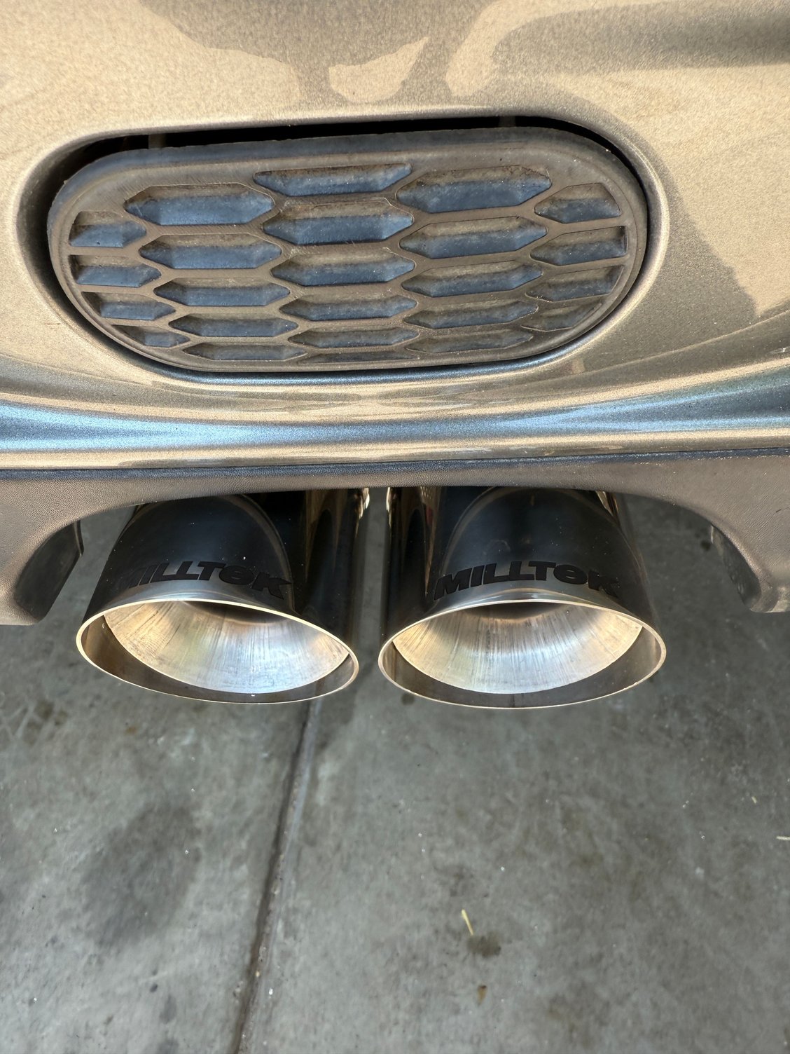

Exhaust tips mounted for easy change should I desire.

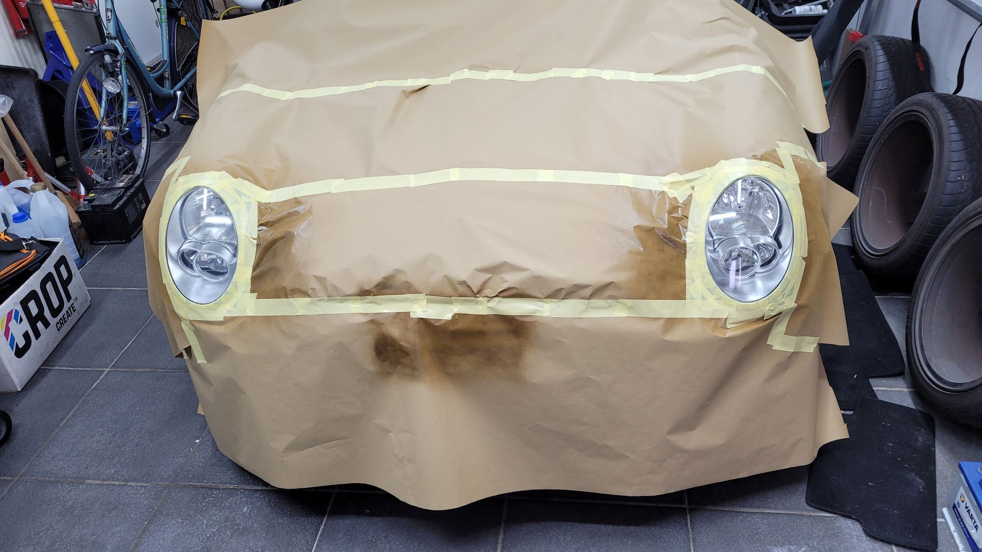

Oh, I bought a headlight restoration kit from Amazon that arrives on Sunday. Thought I'd tape up Otto's headlights to do that on Sunday too. I couldn't bring myself to buy new housings yet, so going to try this first. If it works, I'll have saved some cash. Kit was less than $20 on Amazon. Here's the
link of the one that I bought. link of the one that I bought.
Best case scenario, I get more light and they last a few more years. worst case I blew $20.

About the headlights, it will work for a year. I have done this job 4 times now, 1 kit and 3 times with a 2k clear coat spray the only thing that works good is Spraymaxx 2 in 1 headlight clear coat. Other 2ks will react with the plastic lens and make spiderweb cracks.
This one I did last week:
Sand down using 600grid and spray 2 light and 1 heavy coat.

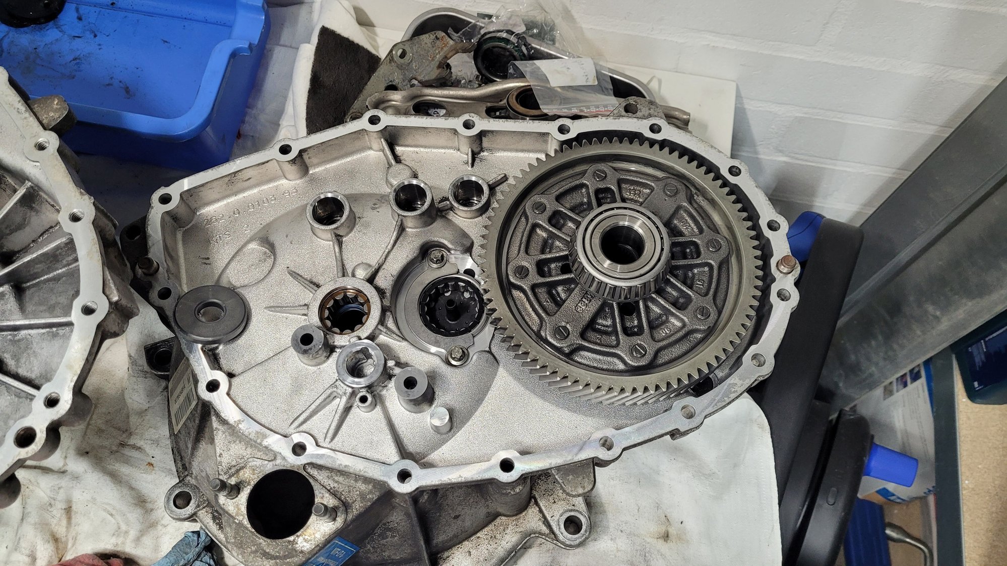

As for the LSD I believe this is a job you can do yourself, judging by this thread. It it just opening the bell housing and swap the diff and reseal it.
I've rebuild a 5 speed getrag once and its just a lot of (torx) bolts.
That's the diff which you can just pickup and swap.

@LukasH ~ Thanks for the heads up on the headlight kit. So far I’ve only cleaned and sanded them. Since I haven’t put on the ceramic coat yet, I’ll give the Spraymaxx kit a go first.

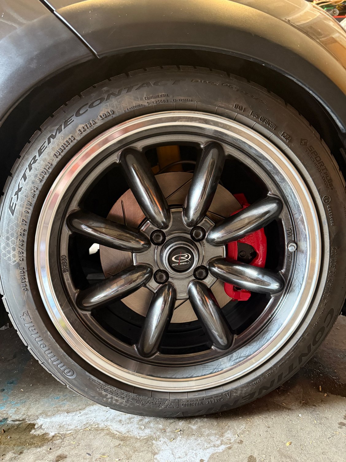

The brakes are finally done - well, I want to bleed them again after they cool offs, so maybe 95% done. While I'm at it, I'll bleed the clutch slave cylinder too.
I think they look pretty darn good for a first time complete retrofit of brakes for me.
Here they are installed:
And here they are with wheels:
Rear painted caliper
Front R56 Powder Coated caliper
I received the DDM GP1 Intercooler Cover, so I installed that too.
And, received/installed the UltraGauge, so that went in as well. Still awaiting the tach pod mount from the UK, but that should be here next week. I'm still figuring out the UltraGauge though.
And yes, I'm still trying to figure out exactly what gauges I want and where. I was looking to have all the vitals - especially oil pressure and oil temp. They may be in there, but I haven't found them yet...
I'll reach out to @adriancl to start the tune process on Monday. This weekend has me slammed again with family obligations. Fingers crossed for a tune next week.
Headlights remain an open item. I did sand them with the 2000 and 3000 grit pads that come in the ceramic kit. Now I need to decide whether I'm going to try the ceramic treatment first or use the Spraymaxx that should be here late on Sunday.
