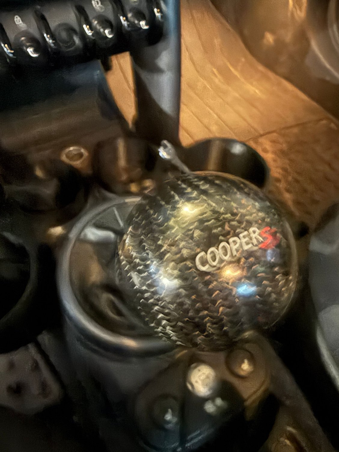

More progress!
Brakes are fully bled and so is the clutch slave cylinder. Clutch is much better now.
I've done 4 quick trips around a 3 mile or so loop to get the brakes hot - stopping to let them cool before doing it again. Paint is finally curing - first two loops the paint smelled god-awful. Third loop, smelled, but significantly less. Fourth loop was today and I really didn't smell anything. I'll take it easy for the next hundred miles or so to let the brakes bed in rather gently.
So with that done, I'm only awaiting the Bimmer Works dongle so I can get the tune next week. Plan is still to get the tune sometime next week before the LSD and clutch go in Otto.
But, some other trinkets arrived. Blackjack side scuttles, new rear taillights (the originals were fogged on the inside and though I tried to clean it, I don't think they come apart to clean them well), and a carbon fiber shift ****. First, the brake lights didn't come with nuts and the original nuts were too big. Also I lost both "wing" nuts down the fender, along with all the washers that came with the new scuttles. So off to Home Depot for new nuts and washers. Metric 3 for the scuttles and metric 4 for the taillights.
Getting the scuttle nuts/washers were less than a joy, but I got them everything installed - along with some blue loctite so they don't come loose.
Pics below.
Shifter **** was much easier. I used my own tie wrap though as the ones that came with the shifter **** were pretty cheap.
Finally, I totally cheapened out on the headlights. It's raining outside and I really didn't want to wait until Sunday for the Spraymaxx. I'll use that next time. Came out pretty good. Here's hoping it lasts. The good news is that it really only takes ~15 minutes to do the ceramic kit that I bought - not counting me waiting overnight waiting for them to fully dry. I can always do them again, Spraymaxx may last longer, but I'd need to tape off the whole front of the car just to spray the headlights. For now 15 minutes is a pretty low cost even if it only lasts six months or so.
Okay, that's it until the tune, so stay tuned.

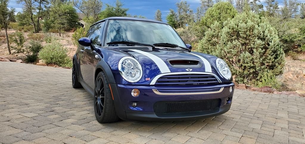

i just now caught up with the many stages of your projects now completed, which were quite interesting. Congrats! Many of those parallel mods done by the original PO or by myself while taming it from track-prepped to strictly streets and highways usage.
This comment in your post #10 (June 19) caught my eye, since mine too had a few very small dings at time of purchase:
Originally Posted by JH-Evergreen
< snip >
Now the bad news. It turns out there is a very small crease below the Mini logo on the front of the hood. It's not really noticeable but it is definitely there if you look. He did his best to get it straight, but it's not the best. Now I've started looking for a new hood, but pickings are scarce for those in good shape - and I really don't want to respray the car. Also under consideration is a carbon fiber hood. Started researching carbon hood vendors and from what I've gathered, carbon quality varies widely. Seibon will likely be the choice if I go that direction. I still need to make some phone calls to discuss with the vendors, but that decision will be made in July or so.
< snip >
I hired a PDR guy to come to my remote home location to address all those. Likewise, he found a few that I hadn't which his trained eyes and specialized reflective lighting. I wrongly figured one on the lower hood (near RH headlight bucket) would be a easy fix, which was small but had similarly stretch-creased the metal. He worked on that with various tools which improved but didn't completely eliminate the blem. At that point, we discussed whether to continue with risk of cracking the paint and introducing moisture (future rust) or stop at that point. I chose the latter. With that being the only remaining blem on the car and with original pristine paint, I figured; "if can't make it go away - hide it" (now at 9.5k total miles). I used an inexpensive "dome style" gel applique that contoured to the shape of the hood area. I think that made-in-USA eBay seller still lists them but I have a few extras...

@MCS4FUN
Your Mini above looks great! I thought about OZ Ultraleggera style (thin spoke) wheels, but wanted the wheels a bit old school styled, and went with Rota RBs. I originally bought the Rotas for Paul the '13 MC, but they definitely look better on Otto. For Paul, I'm thinking of Enkei RPF1s in 17s and silver so I can use the Continental DWS' the I already bought.
Otto still has more than a few small dings! Thank you Colorado hail storms. :(
The roof probably has 15-20 and they're all small. The body has its share of parking lot dings too. With me buying the Expert PDR kit (it may be an expert, but I haven't dipped that toe yet), I'll try it after our Germany trip. There are a few that should be pretty easy. I'll try my hand at those first, then pay through the nose to get all of them fixed (over time). It is important to get them all fixed eventually and in all likelihood, I'll end up replacing the hood at some point too. Whether that be steel or carbon fiber, I don't know. Right now I'm leaning towards CF, but that may change.
So what is this "inexpensive dome style" gel appliqué that you write about? A link would be appreciated or at least a photo of the appliqué would help. BTW, I just noticed that my rear Mini logo had become somewhat detached. I re-glued it with some trim glue, but it's in sort of sad shape, so I may look to replace that one too.

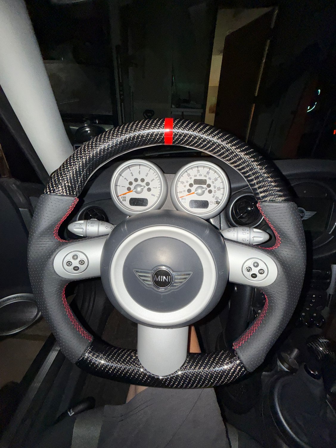

It's a good news - bad news day.
I applied for and received my SCCA license waiver today, good for the rest of 2025 (like there are a bunch of events left!) but it will get me into track days at High Plains Raceway (HPR).
My carbon fiber and leather steering wheel showed up and I got it installed today. It's comfy, looks great and has a red stripe (which adds HP, right?).
Now the bad news. I think (perhaps) that @adriancl may have been a bit too aggressive on the throttle position sensor for the go pedal (making the throttle more sensitive - sort of like the Sprint Booster that is installed on Paul my '13 MC). When driving it today I got a P1689 code - which was a new one for me in the Mini world and I had to look it up. It pretty much only happens when it is at WOT or on the edge of WOT, so I think it's definitely a tune issue.
Since I'm traveling tomorrow, I'm hoping to get the tune adjusted sometime before I take the car to Euro Works for the clutch/LSD install. If not, my weekend is fairly open and I can drop the car off on Monday if needed. Oh and I've already sent a message to Adrian, so we'll see what his response is when he wakes up (it's ~2a in his timezone). Still, the Mini is truly a hoot to drive now.
Tomorrow, Paul gets the driving duties, so no data on MPG either.
John

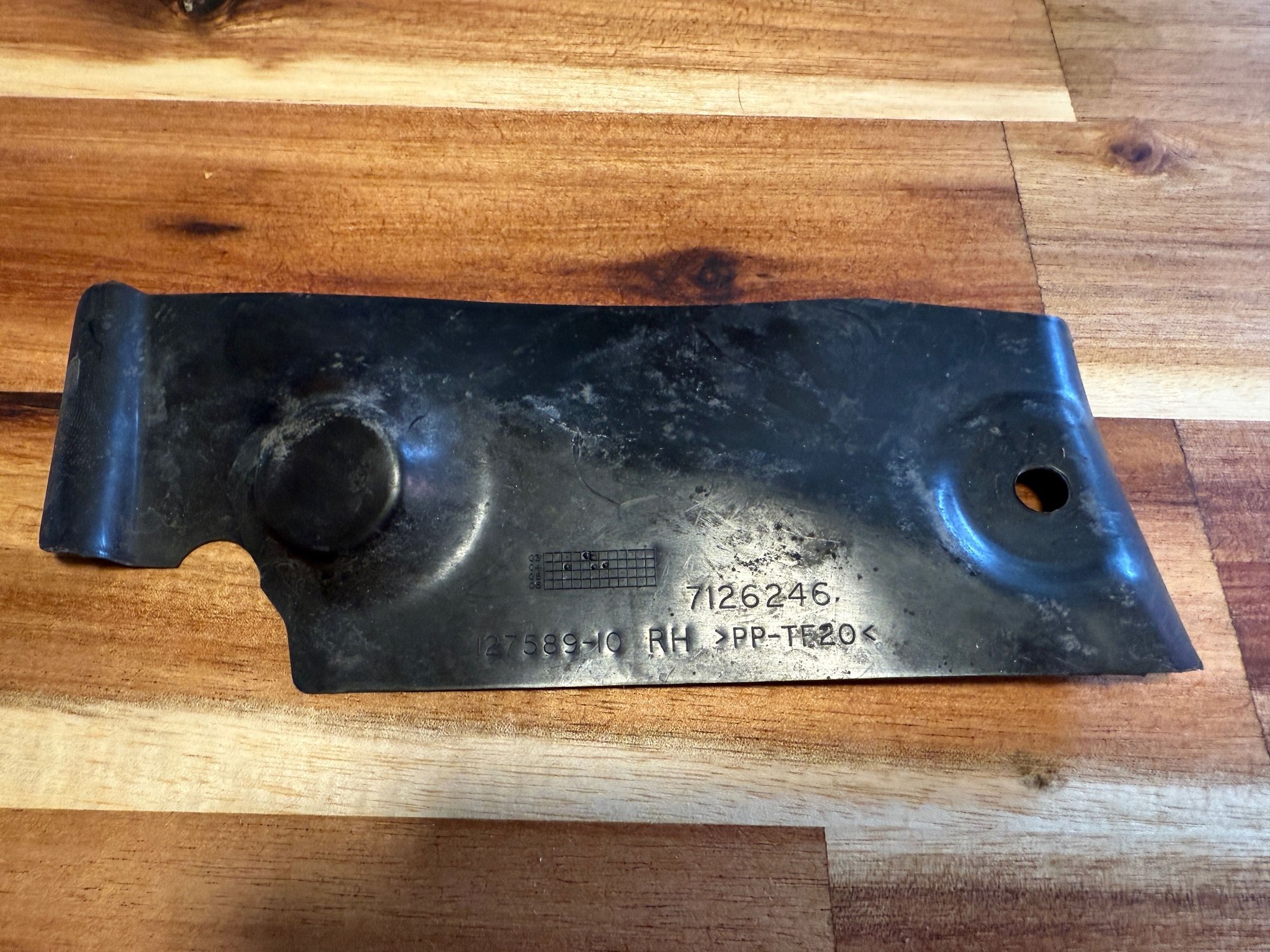

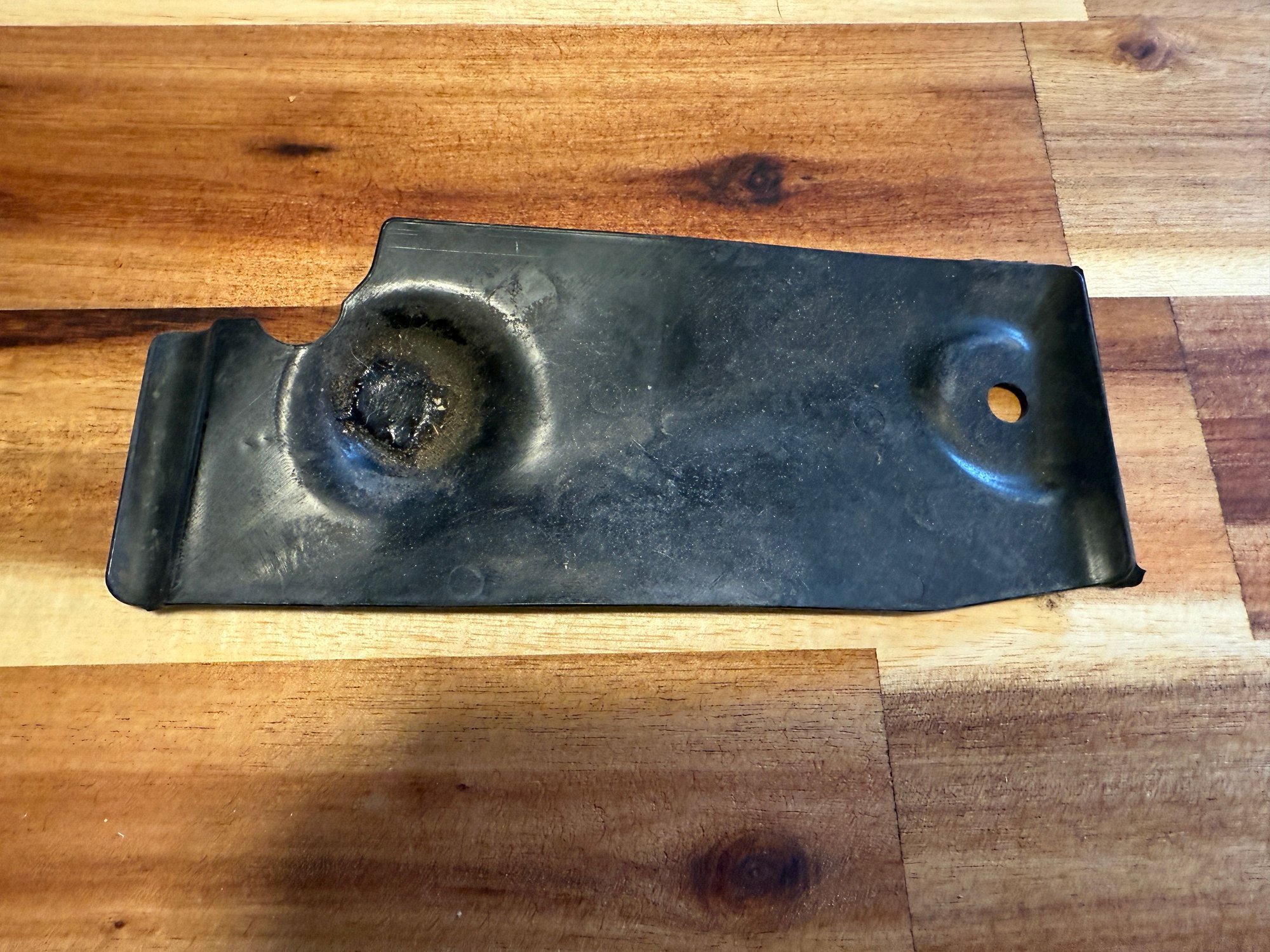

On another topic, while cleaning up the garage, I ran across this part laying on the bench. I'm pretty sure it came off of my R53, but for the life of me, I cannot fathom where it goes. Googling has it come up as a boot cylinder (gas shock) and the other numbers refer to the plastic it is made from. The edges are clean and it doesn't look like it is broken or part of something else - just one bolt hole. So far I've worked underneath the car for most recently the exhaust - so I'm assuming it's undercarriage related.
Any ideas?
Assuming this is the bottom side towards the ground.
Assuming this is the top side that covers something on the car.

No one has come back with what the above photo is from or where it goes, so I'll hold on to the part for now. Maybe I'll figure it out when I'm taking the Mini apart again.
