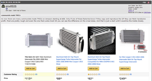

Originally Posted by Eddie07S
I read through that review. A lot of good work. And impressive that he was able to get data on so many different setups.
It is a bit surprising that the GP IC didn’t perform better as it is basically a stock IC with more cooling capability. However, with the way the data is presented the results are hard to interpret and a bit misleading given that the performances of ICs are being evaluated at different levels of boost and ambient temperatures. I think it would have been more meaningful to have seen the data as the delta between ambient temperature and final IAT, and then that delta divided by the amount of boost. This would normalize the data for ambient temperature and boost pressure. This may have something that shows up in the discussion following the writeup, but I didn’t go through it all.
Agreed about the testing method, leaves a bit to be desired, but interesting nonetheless.
Went back also to read the concurrent NAM thread which was started same date of Jan. 18th 2018...
https://www.northamericanmotoring.co...lloy-tmic.html
...and,
got a little sad
because I greatly miss the presence of @pnwR53S around this place.
