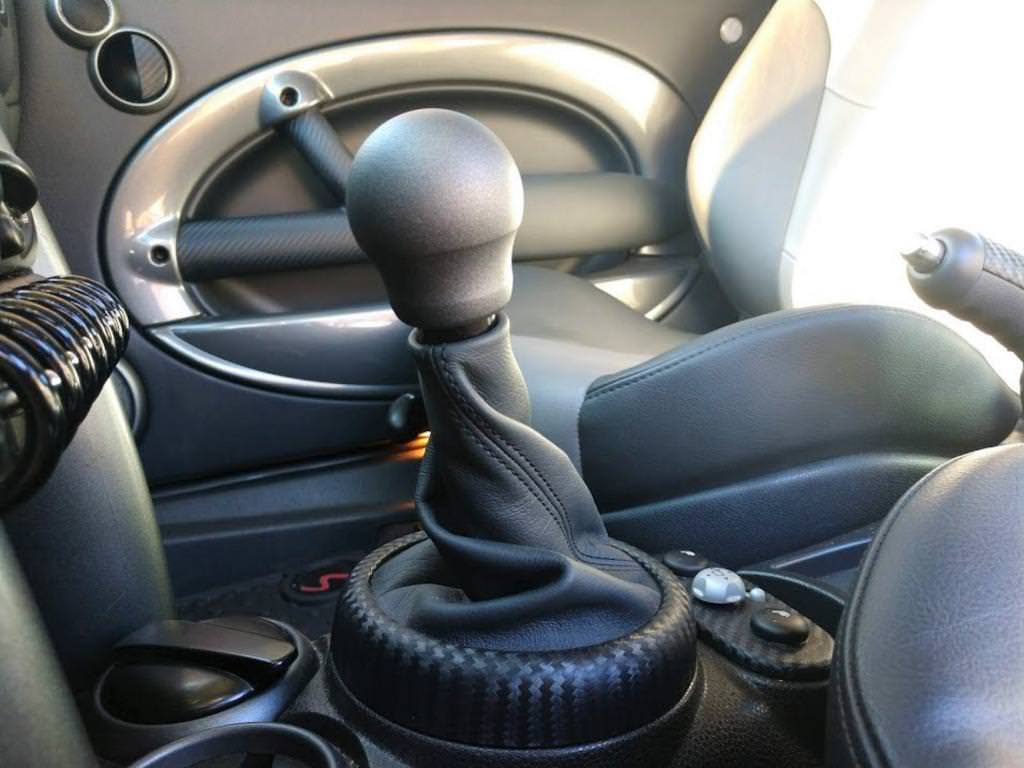

If you don't find one and end up looking for a newly manufactured shiftknob, consider the Raceseng stuff --- although yes, pricey for what-a-simple-thing-it-is, they deliver quality and I've been impressed with the two that I've had, bonus for me is that their graphite finish is a perfect match for anthracite interior:
That's the one I used to run, the Contour:
https://raceseng.com/contour-build-your-own
And it has a wonderful feel, weighted at 500g.
Recently changed out for their Hydro (544g) as pictured in my allover-everything thread.
