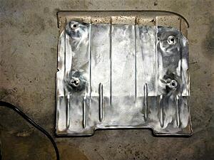

Taking a popcorn break right now too LOL got sidetracked by wanting to re-install bottom shift cover because I thought too much heat was coming up, but I had never popped my shift boot back in place either because I was fiddling with minor adjustments to the retainer and shifter height, so normally maybe any heat would normally be blocked by the boot.
So took off the heat shield and popped the bottom back on, when then test shifting with it on, I realized that I liked it a lot better bottomless LOL so, now have to decided to remain naked on the bottom and hope when shift boot is properly in place it will negate the little bit of heat I felt coming up.
Some sort of micro-dust had gotten on portions of the shifter, after just one week...
...but decided not to sweat it because plenty of people run them coverless and it ain't gonna be like devastating or anything.

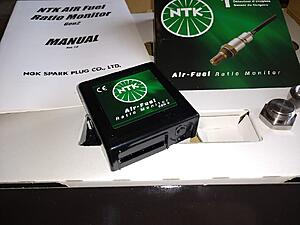

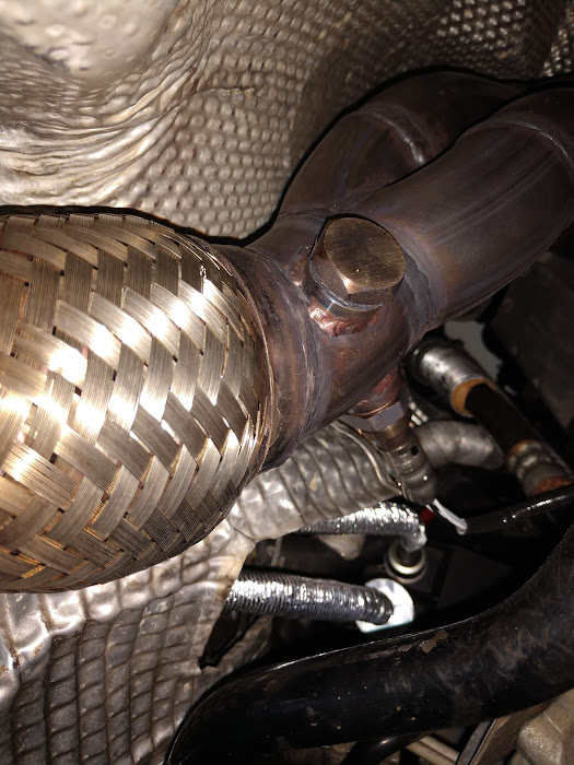

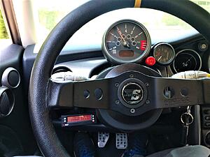

decided to also try and install an A/F ratio gauge since the Scorp header came with a bung already, which I just plugged when I put it on...
...I'm pretty dumb at computer stuff and don't even own a laptop. My brain isn't wired to comprehend mathematics either and it all gets scrambled up confusingly. Perhaps I should get with it because it'd be fantastic to do logging and get real-time information of what's happening and when it's happening, yes it appeals to me but simultaneously I'm a luddite simpleton who can barely grasp many of the parameters being numerically represented! LOL
So I went with something basic just to glance at and see how the A/F is doing.
NTK AFX
Will fiddle with it a bit longer this evening,

2) That NGK/NTK A/F kit adds a very desirable PID that I can't monitor with my OBDLink MX+ which does appeal, however no unused bung on my header and I'm not gonna mess with that either. The NTK is a spendy sucker too...

2) Yeah, I got it directly from NGK, at the time I bought they had 19 in stock and the price was $241 so looks like it went up recently by $9. This was yet another 'choice dilemma' for me and originally I was going to go old-skool with an Innovate analog gauge:

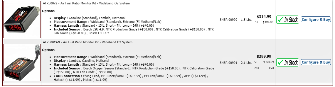

Changed my mind on that, then decided maybe best to go with something digital which would perhaps be easier to read at-a-glance,
the Ballenger units appealed to me...
https://www.bmotorsports.com/shop/index.php/cPath/103
...but they are pretty pricey too.
But anyways, hit a bump on installing the NTK because I couldn't find a good place to breach the firewall where I could fit the plug through easily, so will now put it on standby while I figure out how I want to go with routing the cable --- I don't consider it crucial at this juncture because I'm still on stock tune, but when I finally do get a tune, then I consider a decent wideband A/F gauge to be very important.

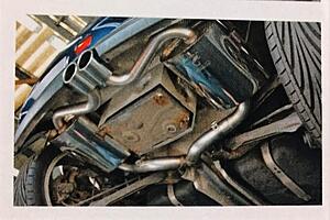

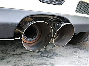

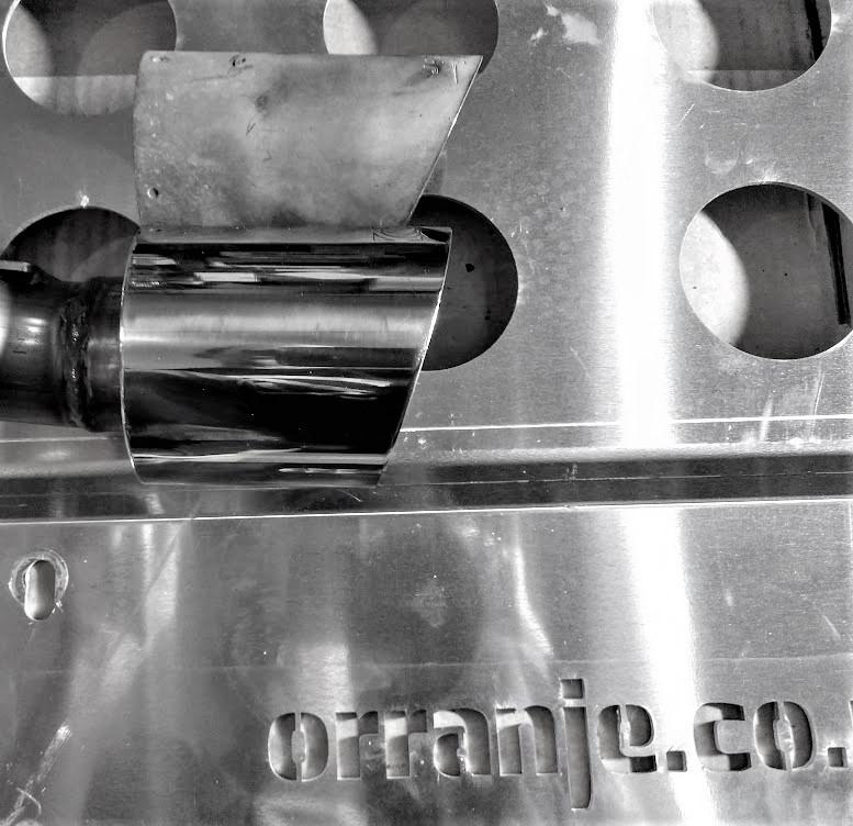

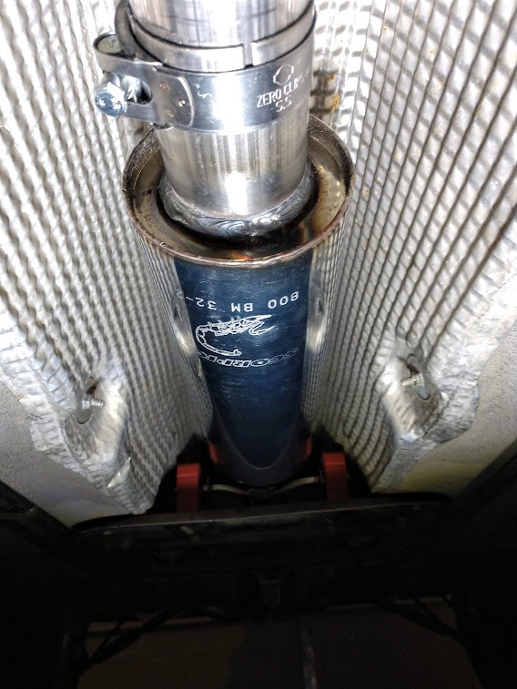

Some preliminary measurements:
Scorp resonator = roughly 99mm
Scorp midpipe = roughly 57mm
Milltek midpipe = roughly 64mm

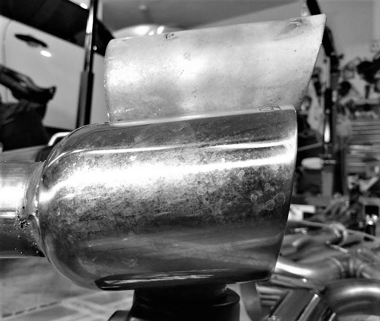

Also pulled out an old JCW tip that I had found at a junkyard in the interest of weighing it because they are kinda porky for just being tips.
Each weigh 0.88 lbs. so 1.76 lbs. for both.
I've always loved the way the JCW tips look, and the Scorp STW tips come pretty close to that vibe, although slightly less severe of an angle,
difficult to get a good pic so forgive this, but I tried to make it more legible by subtracting color:
The Milltek tips have a little less of a dramatic angle cut:

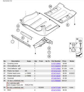

forgot to measure JCW resonator and it's actually larger than the Scorpion res --- although my calipers are actually too small to get super precise, measuring in the same manner that I did with the Scorp gets roughly 108mm.

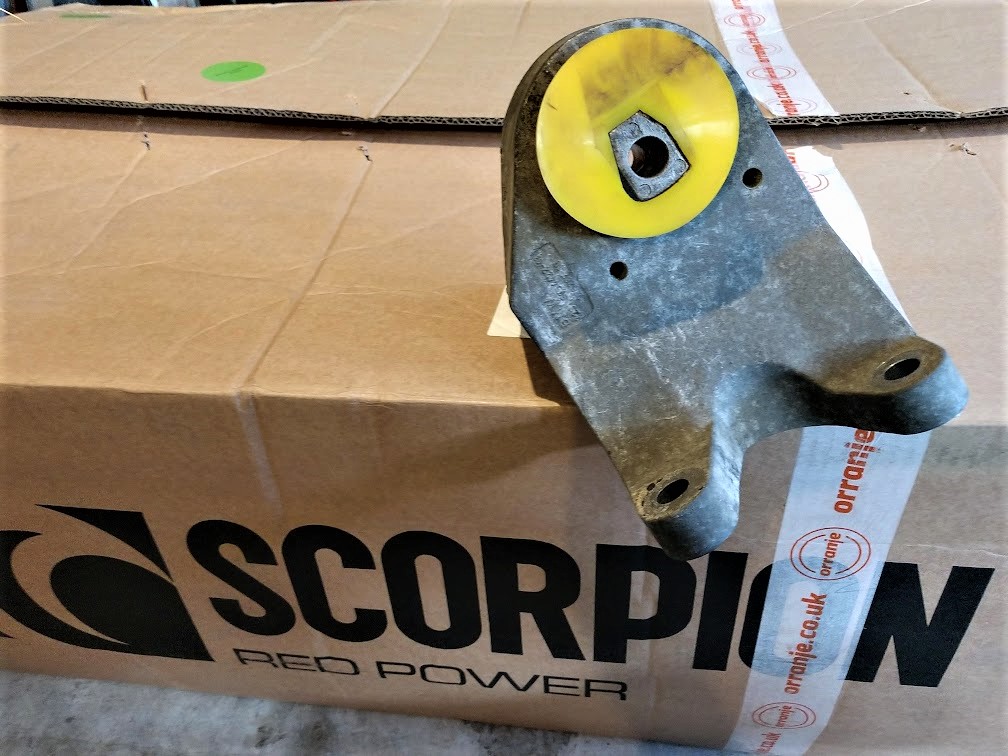

After not liking the shift-feel after re-installing bottom cover, remembered that long ago when I first got my car I had found an NM Eng. cover on ebay for cheap and even though I knew it wasn't designed for R53 went ahead and bought it because I thought that I'd be able to make it work, it was buried deep in the dungeon and had to dig it out. I like the design of it, adding a simple clean box extension utilizing a stock cover as foundation, but it wouldn't fit and had interference when trying to re-install heat shield, could probably modify/manipulate heat shield to conform for added space, but just decided to stay nudist.
Something I forgot to mention earlier as regards to shift-feel is that very recently I had changed my trans-mount to a Vibra-Technics version and it may have had a positive impact on feel as well.
https://www.vibra-technics.com/mini_...nt_gearbox_end
Before that I was using the Powerflex inserts which did help quite a bit as the original mount was sagging and worn pretty bad.

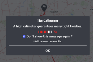

Doubt that I'd figure out "Lil T" as it's a bit cryptic and many thanks for selecting such an excellently well-written article to link to --- I greatly enjoyed reading it. Due to my deep interest in backroads I've read lots of motorcyclist reports regarding rides but they're not usually so eloquent or awe-inspiring, and I also usually limit my readings to the southeast region just because that's where I prowl, so it's cool see other regions too, I now realize, even if they ain't gonna be on my menu any time soon.
The absolute best sat-nav that I've found was designed for motorcyclists and it has provided me with routes that I would have never likely traversed if left to my own resources --- my prior manual planning of interesting routes via google maps was time-consuming, difficult to follow in real time because I was using handwritten notes, and more times than once chose a road that looked legit on googmaps but turned out being an old dirt road which would require me to turn around and reset the entire thing LOL
CaliMoto never lets me down!
https://calimoto.com/en
Jealous of your old stomping grounds --- I'd say that you're a jammy bastard!

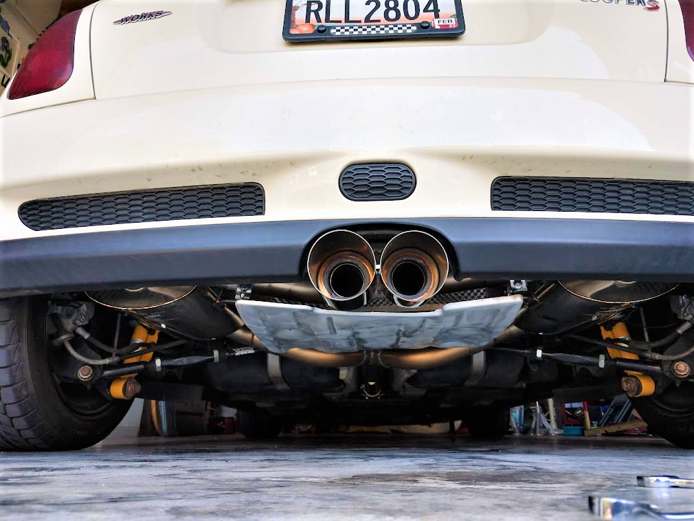

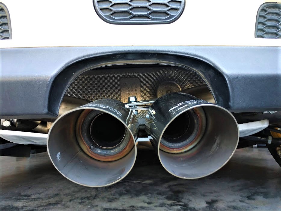

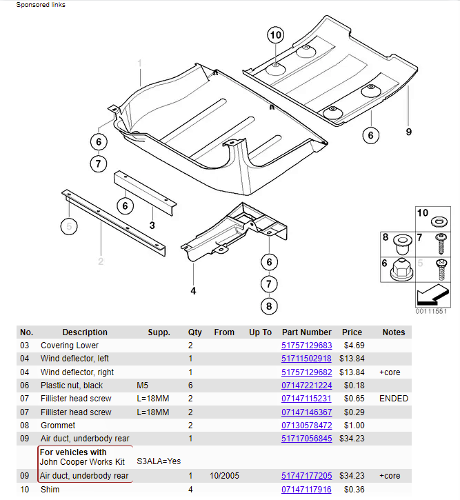

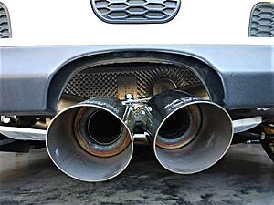

Got an early start today, everything all tightened up and ready for test drive later this morning.
Love the tips.
Clearance is no prob.

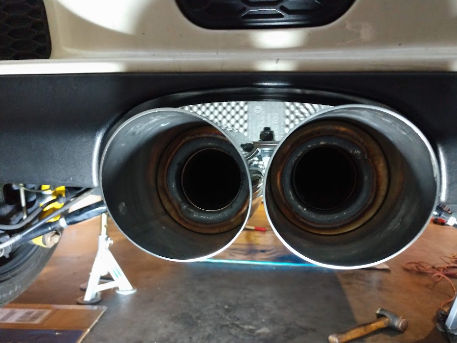

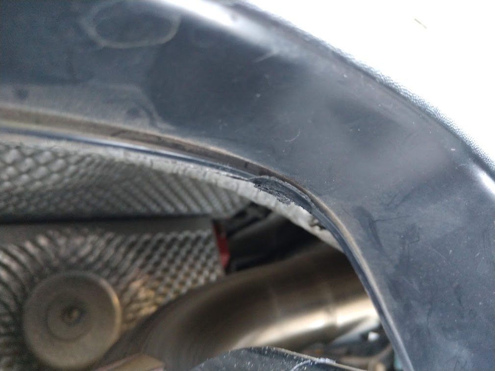

Did encounter an unexpected hiccup though, as is often the usual when I'm working on this damn car LOL when trying to re-fit the batterybox skidplate, it simply wouldn't fit --- it fit no probbo with the Milltek. Just something that I didn't take into account, and most people who install the Scorp, it seems, simply just delete it altogether...
...but I did not want to delete it.
I happen to like the way it looks! LOL
I'm sure also that it has some sort of actual purpose too.
Factory terminology refers to it as the "underbody rear air duct" -
Can anyone explain what it actually does?

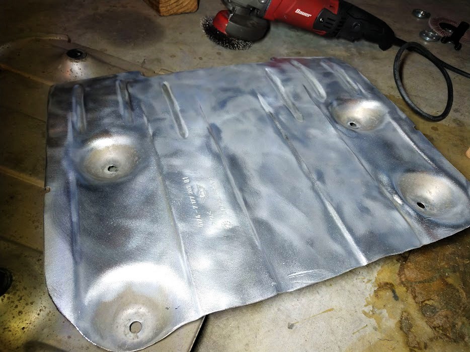

I had a spare laying around so broke out the angle grinder and cut it up custom to fit.
Amount of material removed can be seen when overlaid on top of another:
Quick polishing job was unsatisfactory though...
...so thanks to @BreckMini learned of a possible magic elixir which I just ordered and will test first on the plate to see how it does.

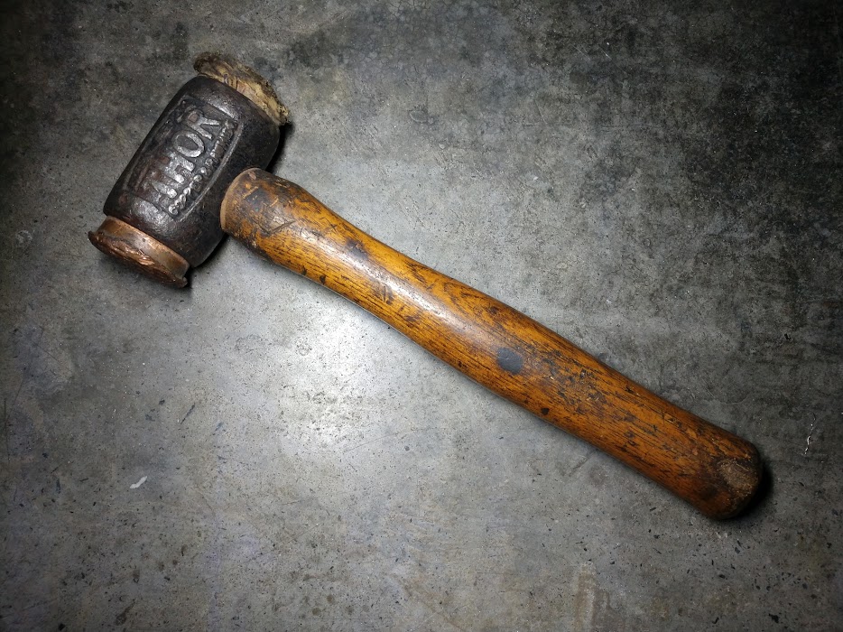

And to add,
in blurry background of one of my pics you may see a luverly Thor knockoff hammer,
so here it is in its full glory:
I love that thing!

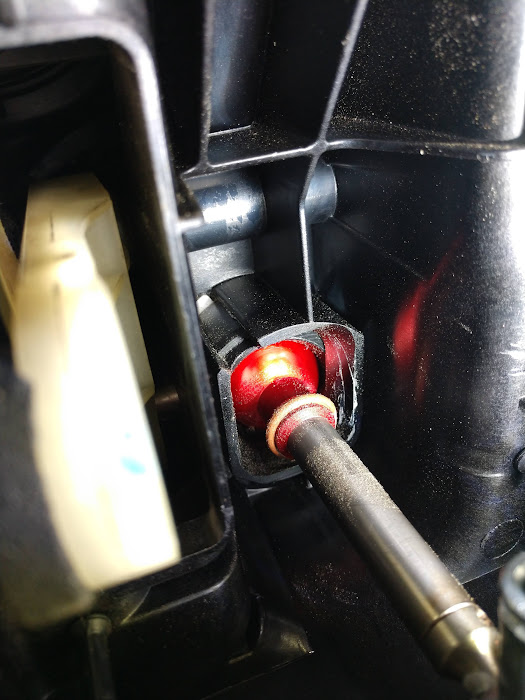

So,
slight delay of course because friggin' MINI! LOL no, not really the cars fault, my own carelessness actually --- when doing my safety inspection making sure everything was tight n' right, noticed a greasy smear on the floor and it turns out that somehow I had gotten a big dollop of nickel anti-seize on the back of my head all in my hair LOL okay, take a shower and shampoo...
...then,
since I had removed the euro shelf in anticipation of running the cable for the A/F gauge (which ultimately got put on standby to be installed at a later date),, had to put it back in place and it was just being a nasty bugbear pain-in-the-patoolie-hole, inevitable I guess because just earlier this morning I was offering advice regarding it, to pause, chill, breathe deeply, and be patient:
https://www.northamericanmotoring.co...ml#post4621585
...but was having a difficult time myself because it was being stubborn and hesitant to go back into place and I was yankin' my hair out and wanted to beat the damn thing like a red-headed stepchild! LOL
Finally got it back together.
I do love it despite the twiddly fitting, because it provides good home for my ScanGauge:
No, not an ideal location due to requiring a glance down, but I didn't want it to clutter dashtop, although line-of-sight would be better in a perfect world.

Minor note:
after inspection noticed that one of the tips had made contact enough so as to melt a bit of the trim --- thought I had it dialed in proper, but I guess the system "settled" after being driven.
Thankfully not a massive melt. Let it cool down, then dropped the tips to re-adjust, now will drive again on a bumpy road, then inspect again.

Okay,
think I got it sorted.
My problem was that I didn't tighten the tip pipe clamps enough, so this time gave them mad tights,
think it'll be secure now, but will keep on eye on it.
