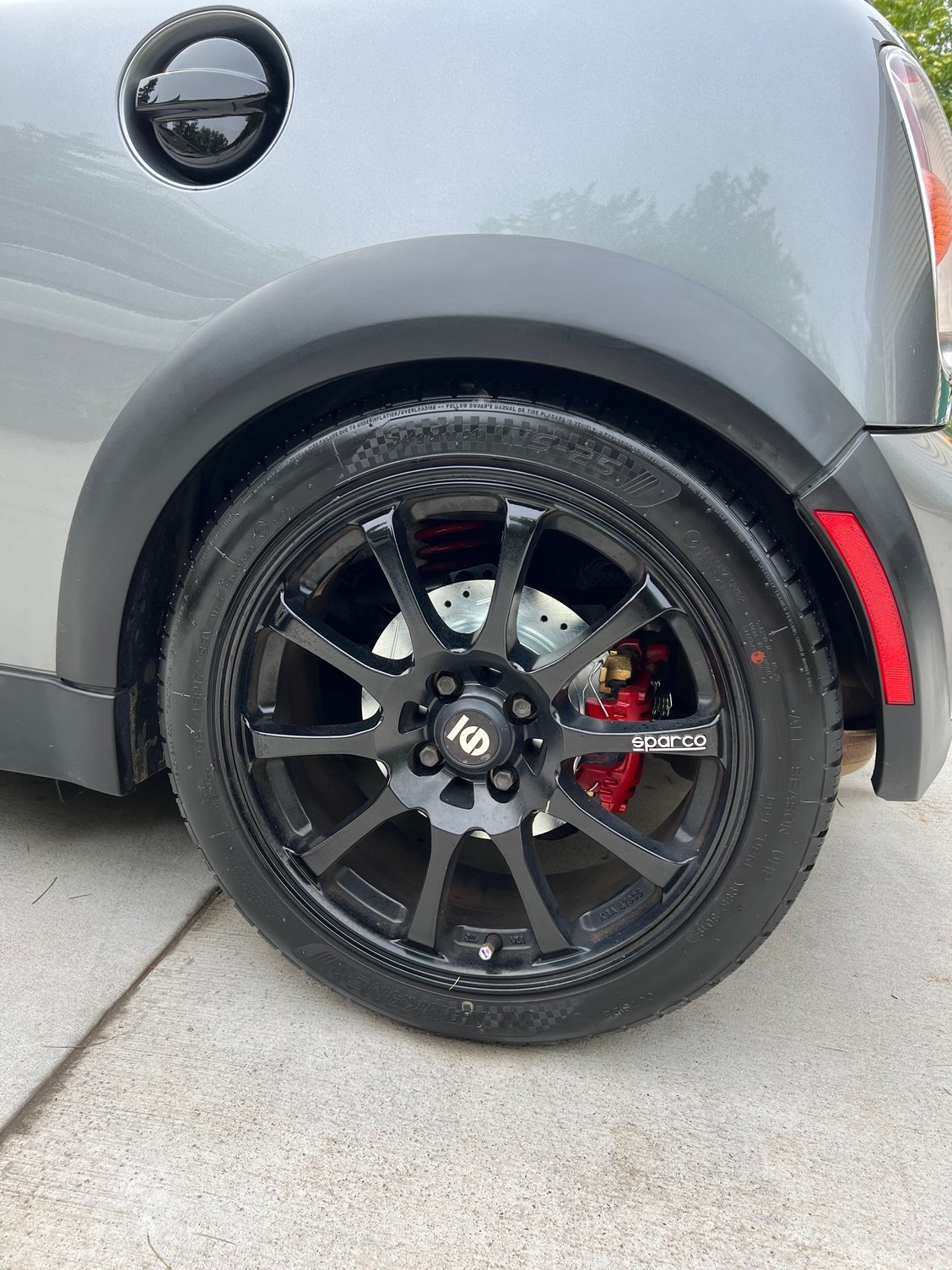

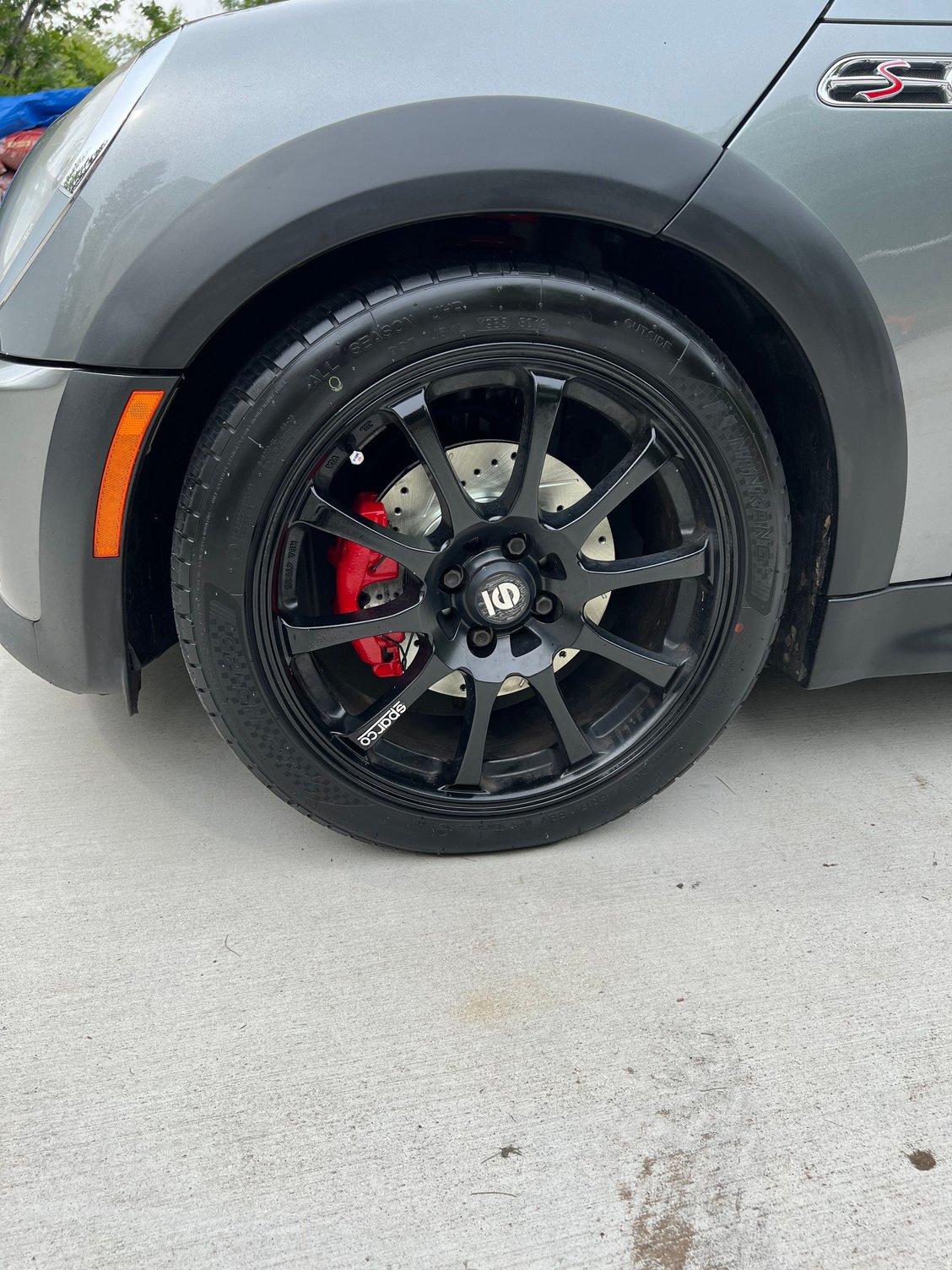

Currently all four corners have the brakes removed for replacements. Painting and baking the new rear calipers red to match the new red fronts. Drilled and slotted rotors all the way around. Have the following upgrades to tackle once I get home the next time:

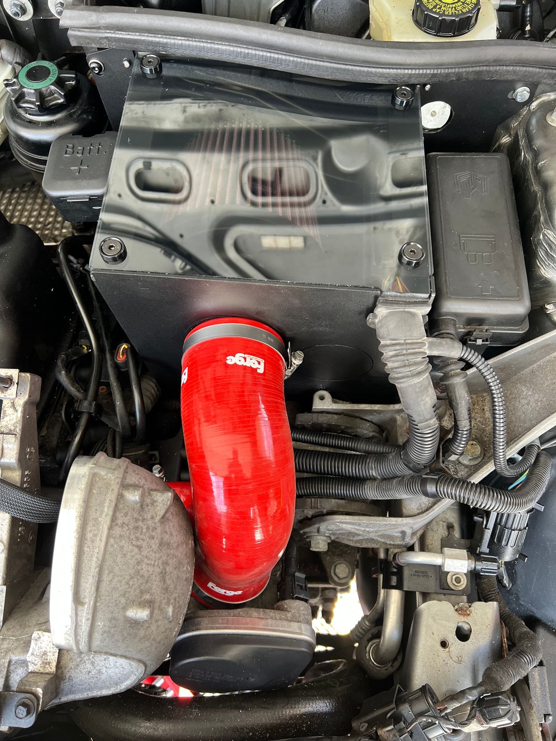

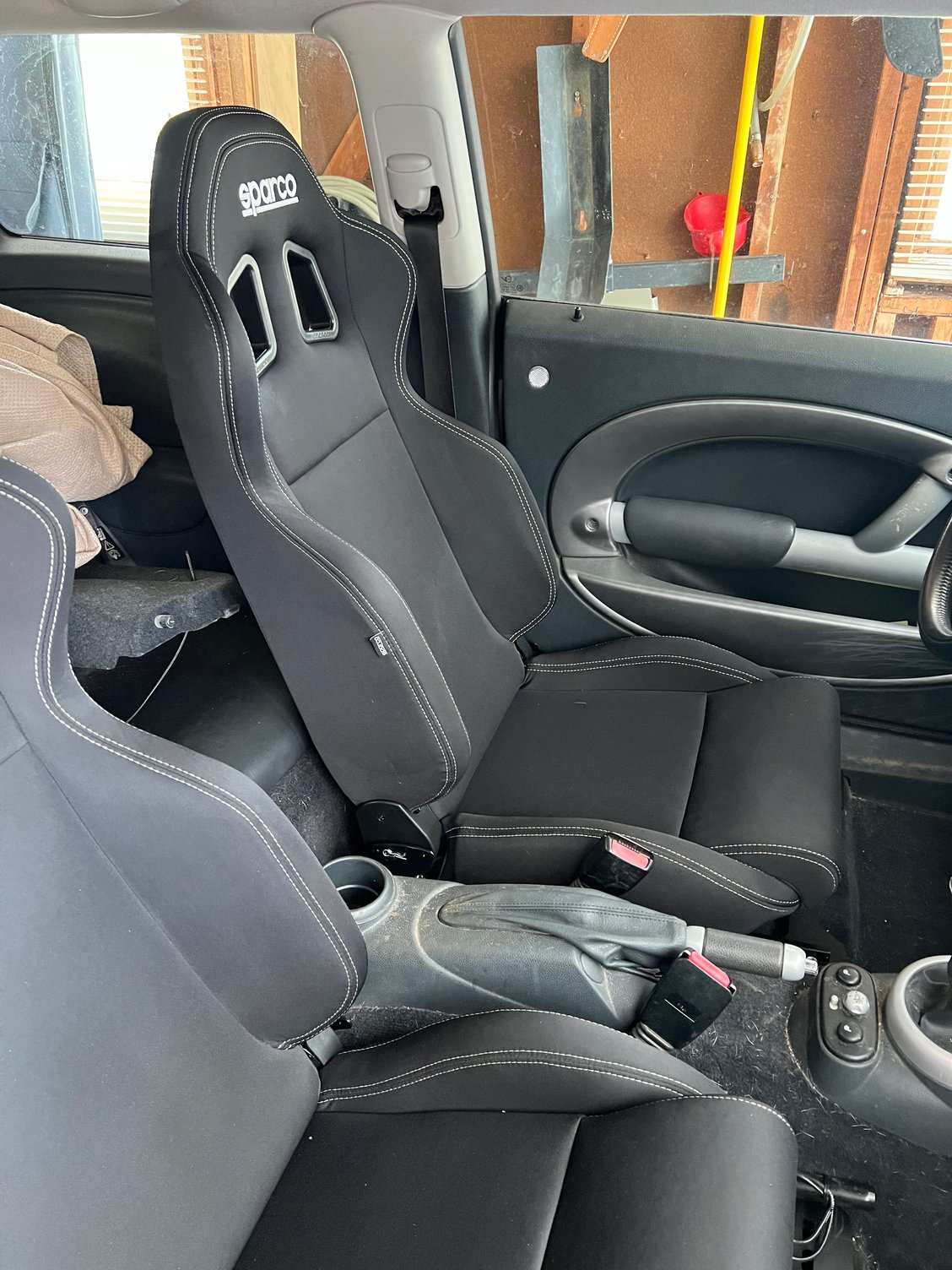

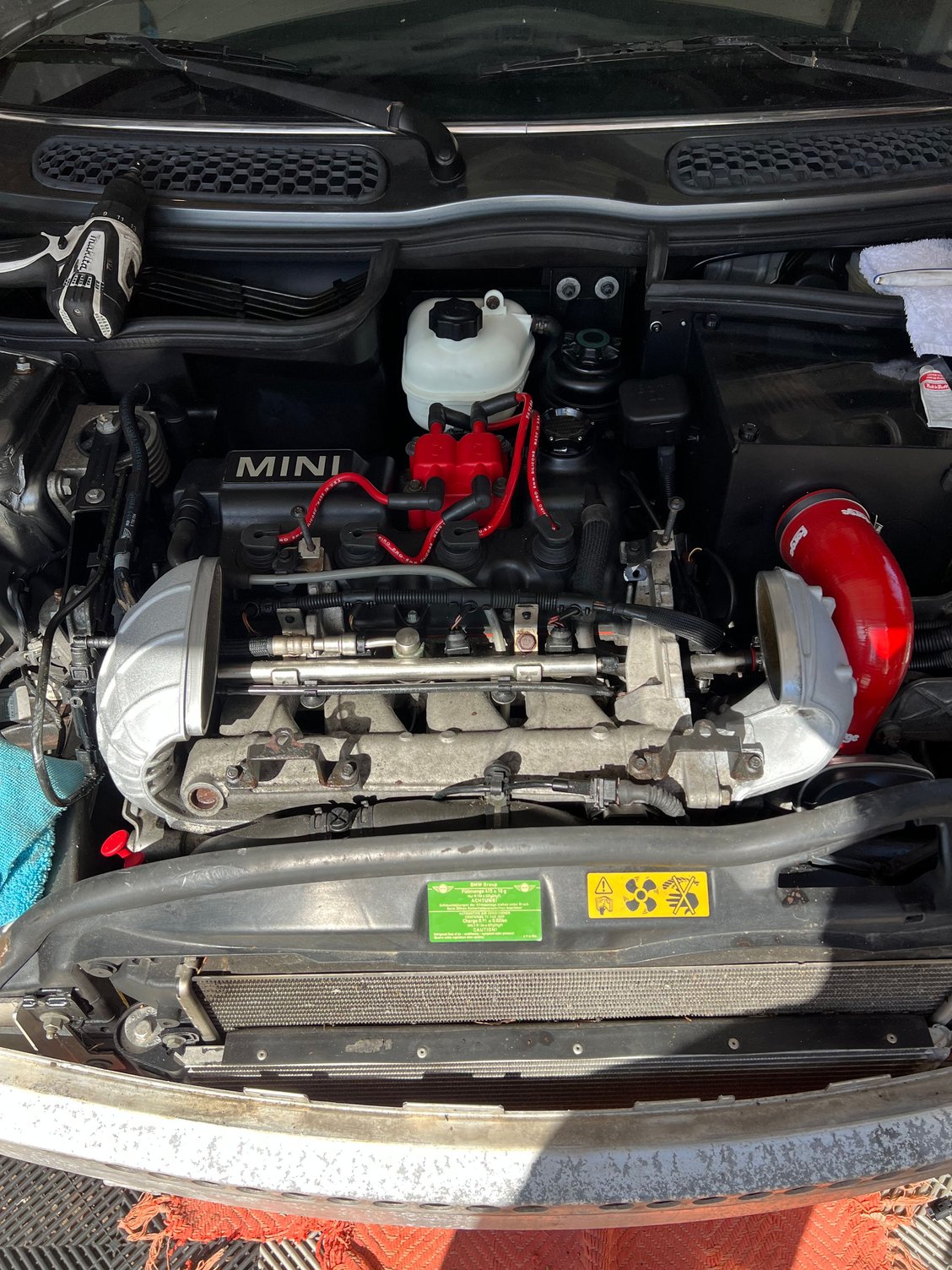

Just a bit of work today. Slower than I would have liked, but ran into a few snags. First one was a striped transmission fill plug. Was able to get it out with a little persuasion and a chisel. Second was the nice valve cover bolts that were rusted and deteriorating. Had to use a 7mm socket. Pounded that on and was able to get them all out. Ordered a new set along with a new transmission drain plug and fill plug. Cravenspeed CAI on. Partially mounted the new seats which was a total PITA. Needed to do some fab work to get the seatbelt latching mechanism to fit. New radiator overflow bottle mounted. Overall not a total waste of a day.

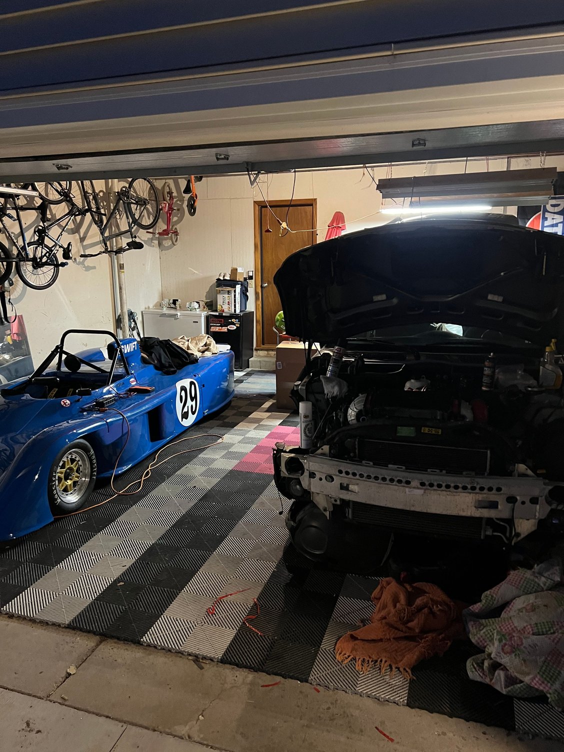

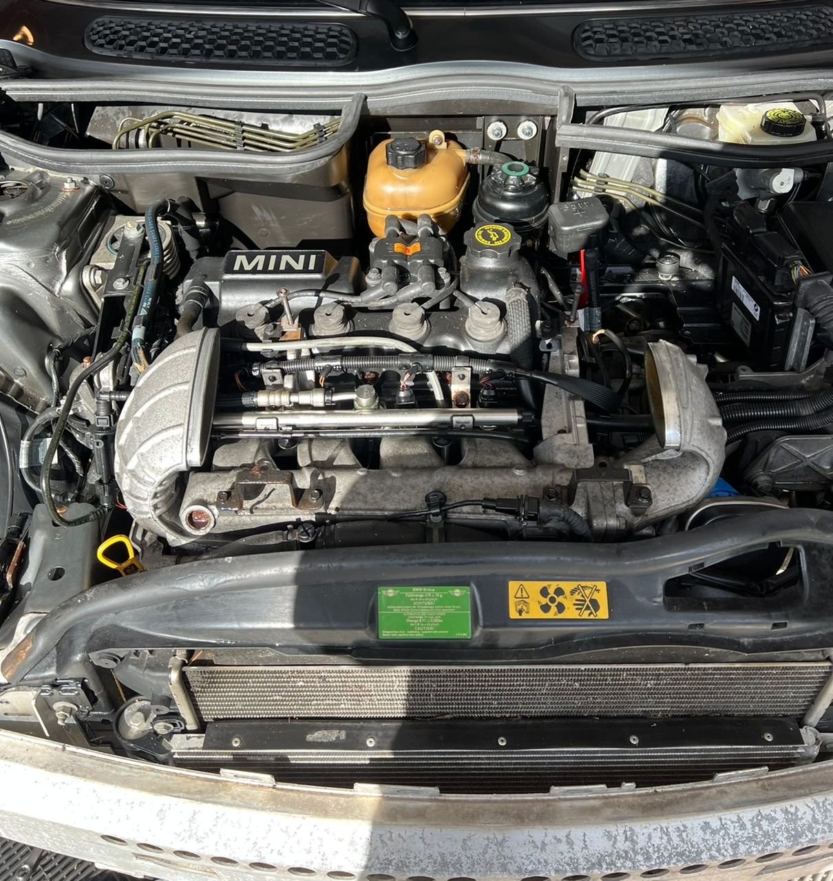

Not too much to report but did get the new valve cover gasket on. Removed some badges and tightened down the new air scoop that needed to be replaced. Spent most of the day working on the race car.
Ordered some Raceland Coilovers which should be in early this coming week. Still deciding on whether or not to order a new set of wheels and tires. Maybe I'll decide this week.

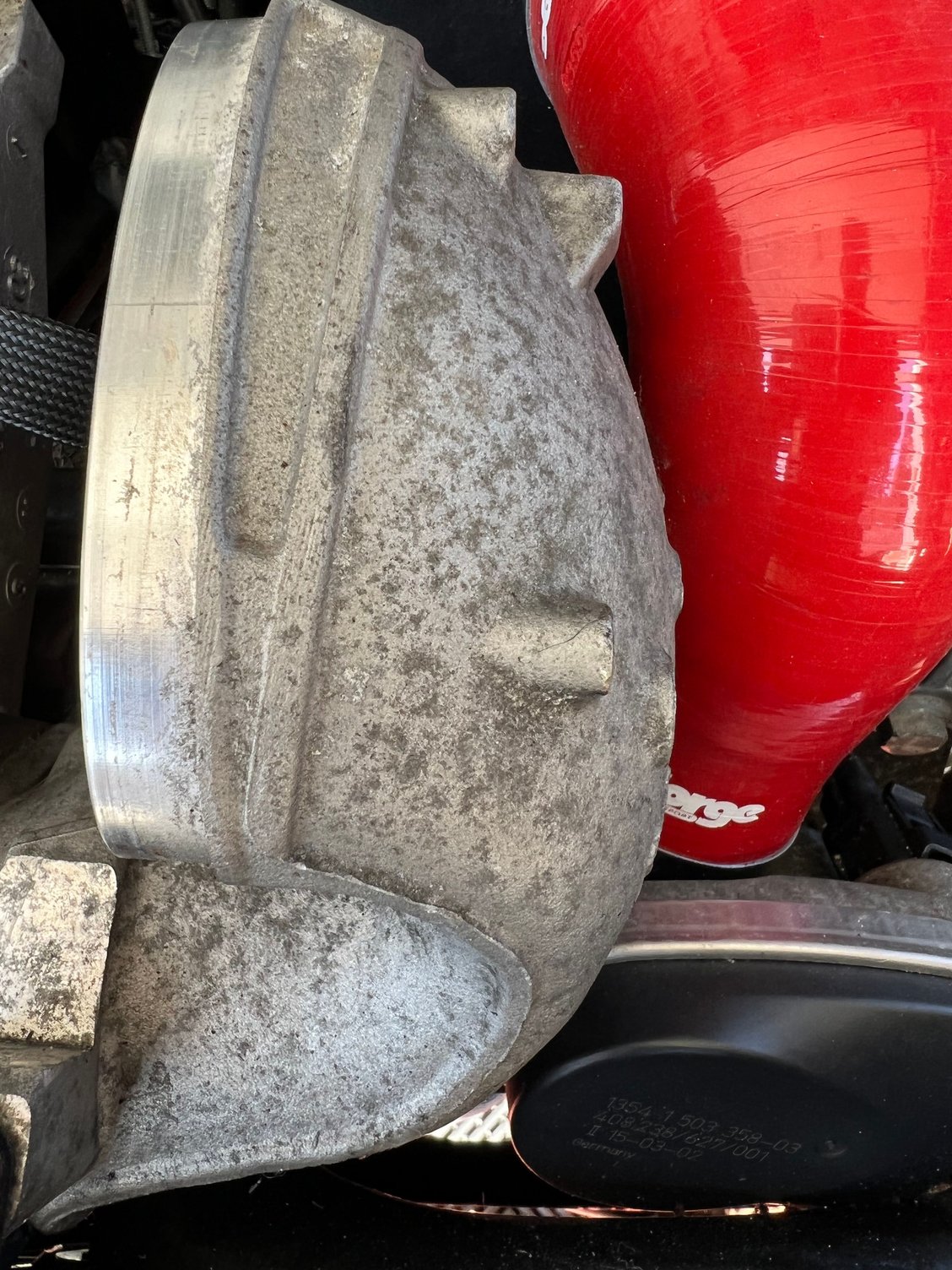

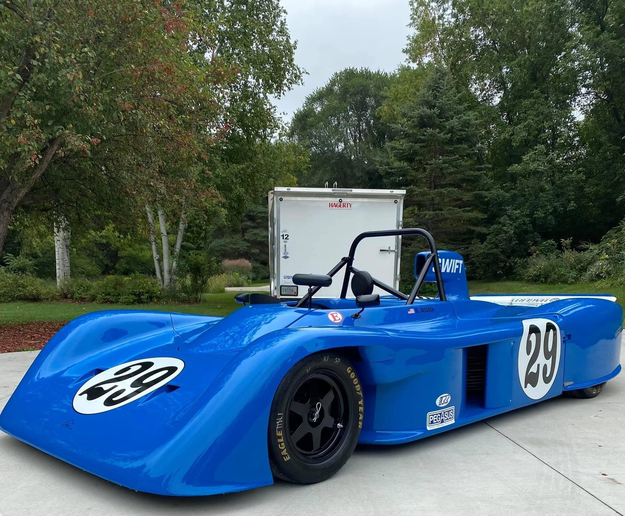

Is that a DB5 with Jongbloed’s?
Also, what did you do to that supercharger horn to get it looking so good?
Old May 8, 2022 | 04:45 AM
BreckMini's Avatar
BreckMini
Joined: Oct 2005
Posts: 27
Likes: 15
From: Cedarburg, WI

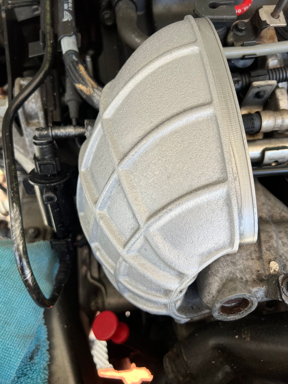

DB2 with Jongbloeds. Different wheels on the below pic.
I found this amazing product when I did a restoration on BMW R/90 awhile back. RubNBuff.

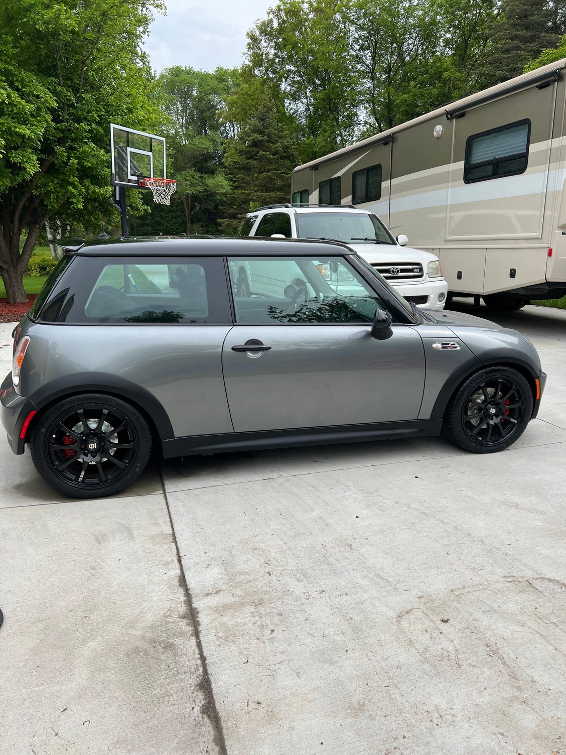

Almost road worthy again. I didn't have help to bleed the brakes so I have to wait until tomorrow.
