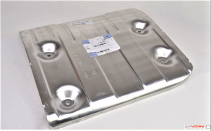

Thanks.
I was just curious.
My junkyard spare has a date code of 2006 and stamped with Lydall France.
Was just curious if they're still made in France.
Biggest image I could find was from OutMotoring and you can just see LYDALL,
but unsure of production date?

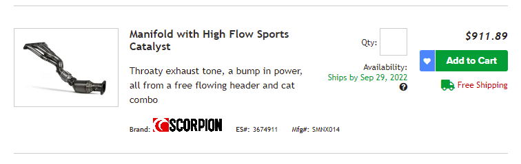

100% agreed about the importance of sound
Running a Scorpion header, so it's nice to have a complete system from them,
found it on ebay:
https://www.northamericanmotoring.co...ml#post4572156
Even since then the price has continued to rise,
cost of precious metals + inflation I guess?
Current price at ECS:
Now that my exhaust is sorted got my whine groove back!

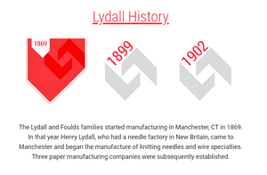

That is interesting indeed,
thanks for the share.
2002 production Made in Germany, although the same manufacturer.
Interestingly, Lydall is a US-based company (I've never heard of them before)
info snippet:
Company History:
Lydall, Inc. designs and produces specialty engineered products that withstand heat, reduce noise, and act as filters for a variety of industrial applications. The bulk of Lydall's business is derived from the automotive industry, for which the company makes heat shields, thermal and acoustical barriers, and insulation products. The company's two largest customers are automobile manufacturers DaimlerChrysler AG and Ford Motor Company. Lydall's products also are used in other industrial applications, such as in furnaces and kilns, and as filtration devices in industrial settings. More than one-third of the company's annual revenue is derived from overseas sales. Lydall operates three manufacturing facilities in Europe and maintains sales offices in Asia. Domestically, the company owns production plants in New Hampshire, New York, Connecticut, Virginia, North Carolina, Florida, and Pennsylvania. Through Lydall Transport Ltd., the company provides trucking and logistics services throughout the United States and Canada.

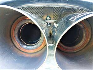

In other news,
I'm totally lovin' the Scorpion!

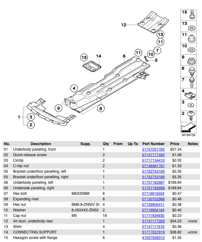

All this diffuser talk also reminded me of the GP undertrays.
I've always wanted to get them and just today went ahead and placed an order with my favorite dealer.
https://www.bmwpartsworldwide.com/
Came in at right under $300 shipped.
Very often I feel like I'm absolutely crazy for spending so much money on this damn car, but it's been the most fun sort of insanity I've ever had!
Ordered it complete with all the entire fittings.
L panel
51757182687
R panel
51757182688
rear L bracket
51752753165
rear R bracket
51752753166
various fasteners
07119904164 x 2
07119915034 x 6
51711934930 x 18
07146981767 x 2
07129905411 x 4
07130702966 x 8
Amazingly those undertrays were actually in stock at the US warehouse which I didn't expect, so they should get here quickly, but I'm in no rush to install and will wait until I finally get to the exterior pretty-up portion of my project which will include adding the aero side skirts + front bumper, amongst other stuff.
I wanted the R53 GP undertrays because they fit right up, but if you're interested in them yet constrained by budgetary concern, then you can fit up the R56 undertrays with minor modification and they'll essentially be the same thing, if you can find them used then it'll be even a lower price point.
A good post here on NAM relating to using the R56 panels for R53:
https://www.northamericanmotoring.co...ml#post2651627
And,
of course it could be done quite simply with aluminum panels or something similar as well in DIY fashion and cost investment would be minimal.

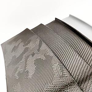

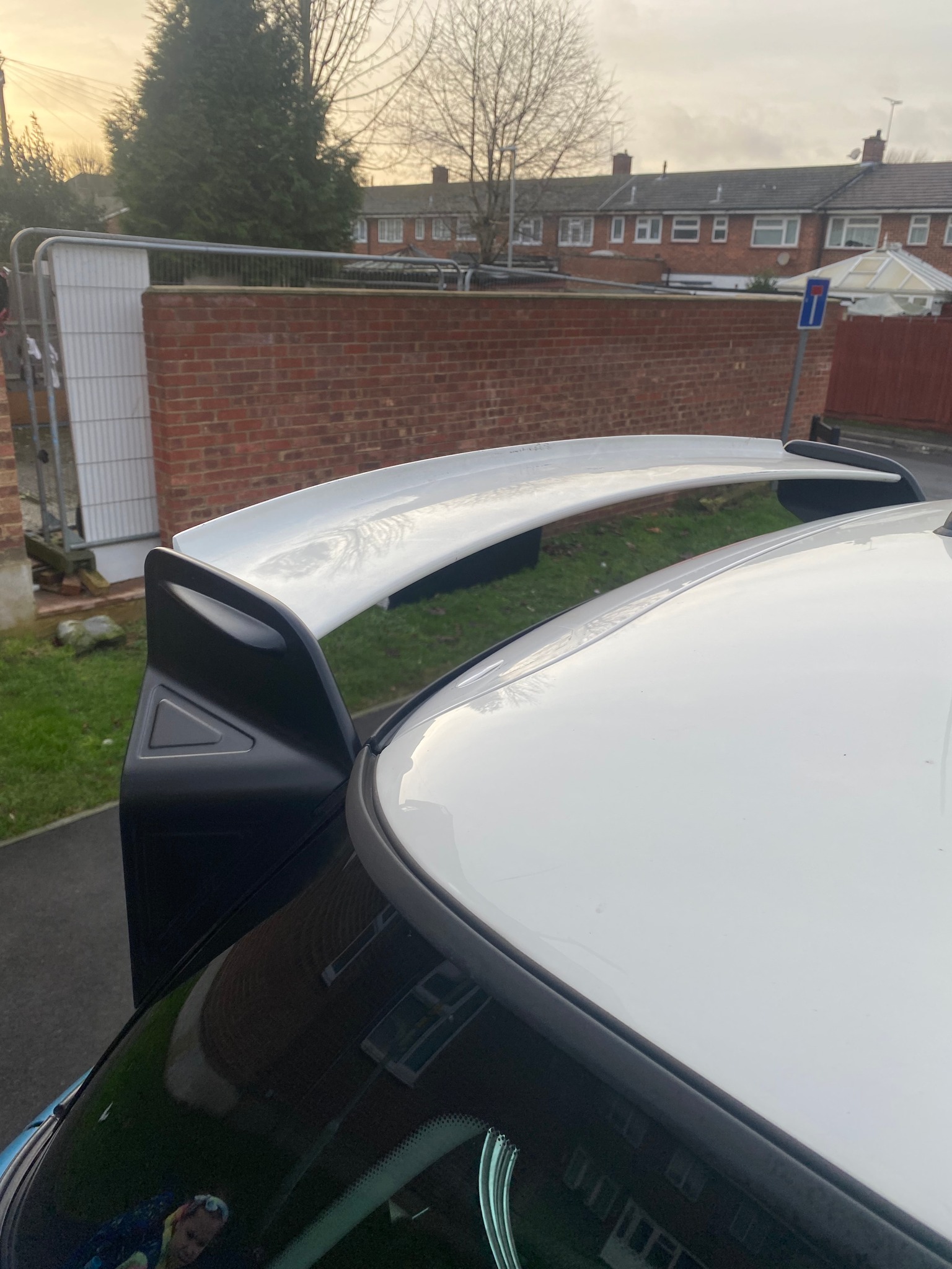

More aero talk.
Recently ordered a G-Wing blade in the Gurney Tab version from Orranje...
https://orranje.co.uk/product/orranje-g-wing-spoiler
...must've got the last one in primer because it now shows as awaiting stock.
A couple of pics that I saw of one installed:

Couldn't I just add one of those 69¢ ebay add-ons and tape it on my flat blade?
Yeah I could, but didn't want to go that route.
Pretty neat how the Gurney Flap works, it's also sometimes referred to as 'duck tail' or my favorite, a 'wickerbill'.
Solid info,
here:
https://www.formula1-dictionary.net/gurney_flap.html
Quoted excerpt:
""Crude as it looks, it serves essentially the same purpose as the complex flaps on an aircraft wing. It increases lift on aircraft or, in racing car case, downforce. Wind tunnel test showed 30 percent downforce increase with a very small drag penalty in some extreme cases. These results could not be reproduced in all cases, and in fact, in some conditions the G-flap does give rise to a drag penalty.
Birth of the gurney flap, in Dan Gurney's own words, was a classic example of necessity being the mother of invention. It happened in 1971 while his AAR (All American Racing) team was testing its new USAC car at Phoenix, prior to the season's first race there. The car was too slow and everyone knew it. Towards the end of the third and last day of testing, driver Bobby Unser challenged 'the boss' to come up with a solution, and Gurney suggested the flap. Dr. Bob Liebeck of McDonnell Douglas was participating in this test. You may have seen his name in many aerodynamic textbooks, since he is a leading, renowned person in the aerodynamic field. He told Gurney that he thought flap would not work at that time. Gurney has seen the success Richie Ginther had had experimenting with spoilers on Ferrari sport scars and wondered what would happen if a small spoiler was fitted along a wing's trailing edge.
In 45 minutes or so, the first Gurney Flap was fabricated and attached to the car's rear wing, and Unser went out again. Within a couple of laps it was clear he was circulating no faster than before and everyone in the pit assumed the flap was a failure. But when Unser came in he called Gurney over and quietly asked him whether anyone was around to spy on what they were doing. Once Gurney had confirmed they were alone, Unser told him the rear was now so well planted that the car was understeering badly, and that was the reason for poor lap times. All they needed to do was restore the aerodynamic balance by adding more front-end downforce and the car would be transformed...
...Gurney, meanwhile, got access to a McDonnell Douglas old wind tunnel in which he can test it. Measurements on the test wing showed that fitting the Gurney Flap affected pressure across the wing's entire upper and lower surface, increasing lift (or downforce) and reducing flow separation on the wing's suction side. Gurney placed the patenting of the device in the hands of McDonnell Douglas and, for some years after, AAR cars used to carry 'Pat Pend' scripts on their wings.
This shape is very contradictory because it runs in opposite direction to most aerodynamic devices which are smoothly shaped and sharply ended. Especially for wing profiles, it seems to destroy all carefully calculated sensitive shapes.
The device basically operates by increasing pressure on the pressure side of the wing, decreasing pressure on the suction side, and helping the boundary layer flow stay attached all the way to the trailing edge on the suction side of the airfoil. At the same time, a long wake downstream of the flap containing a pair of counter-rotating vortices can delay or eliminate the flow separation near the trailing edge on the upper surface (aircraft wing) or lower surface (racing car wing). Correspondingly, the total suction on the airfoil is increased."

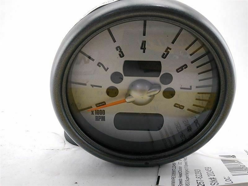

Re the anthracite tach quoted above.
They were only offered in USA if the Seven option was chosen, and in many cases the owner would spec for chrome-line so that would supersede the anthracite.
As a result, it's quite difficult to find them.
All I wanted was the trim ring and buying a whole brand new tach just for that would be insane, so I kept an eye out and eventually got lucky.
I have 2 of them, and both came from England.
I've only seen 1 on offer from a USA seller:
But it had a pretty big blemish, although hard to detect in their lousy pix,
upon lightening it was more clearly visible:
I tossed them a lowball offer which they did not accept and I didn't buy it.

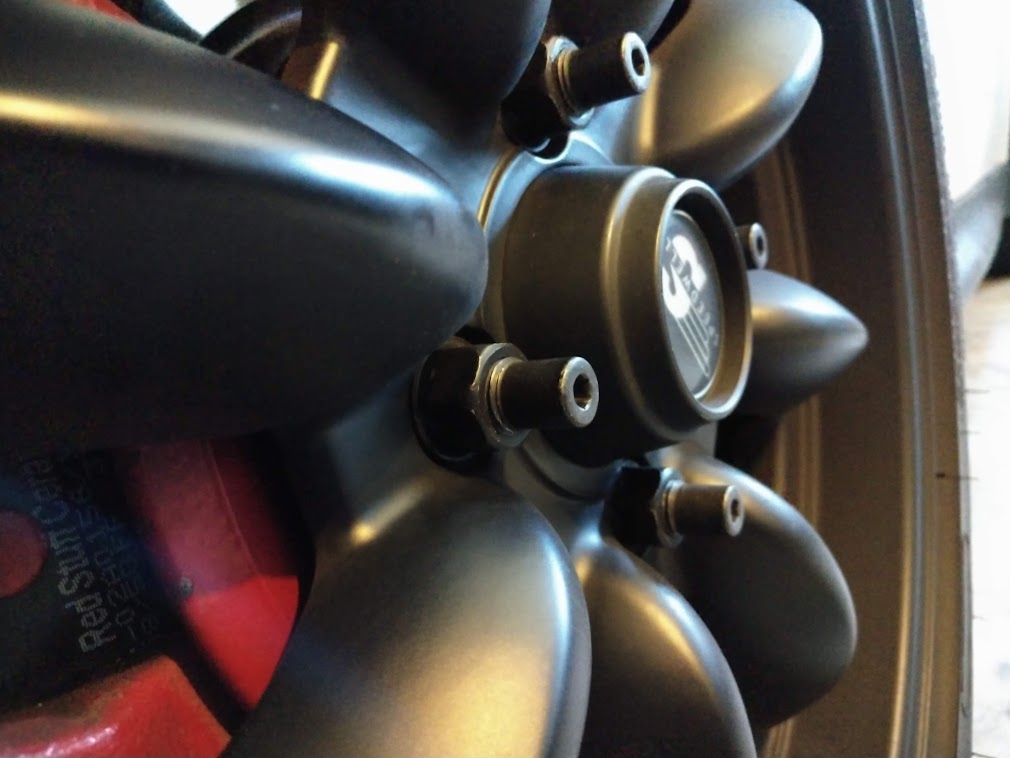

and one more thing, finally got rid of the cheapie M14x1.25 to M12x1.5 conversion studs which looked lousy like this:
And installed straight M14's which I was iffy on as to having ordered correct length, was paranoid they might be too long, was super glad to see they fit just right!
1.25mm pitch sux tho because fancy cool lugnuts are impossible to find, but I'm satisfied with the oldschool acorns even if they ain't theft-proof
