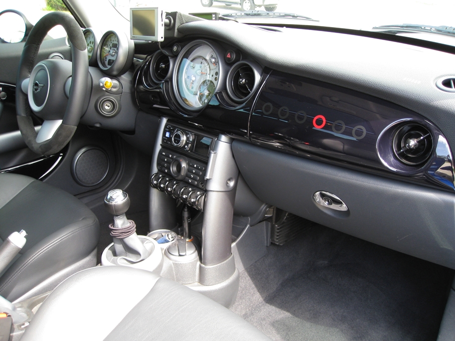

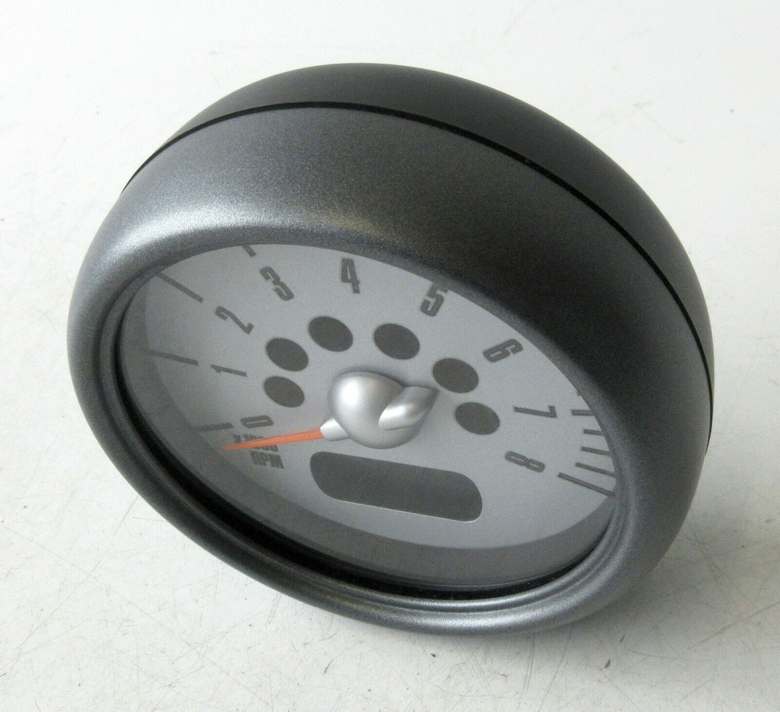

Yes,
quite a necrobump here!
This thread is older than my car which was built 9/06.
I never knew this option existed until recently seeing a rev-counter with anthracite ring listed on ebay, it was in England for a buy-it-now price including shipping for $65. Although I wanted it I paused because that's quite expensive for just a trim ring LOL but I noticed that it sold within 3 days.
The trim ring isn't available by itself sadly, you must buy the entire instrument.
Brand new units are still available,
but they are expensive:
https://www.ecstuning.com/b-genuine-...n/62116966527/
Once it was on my radar, I added it to my watch list and waited --- a couple weeks later one popped up for $40 shipped so I got it, but it still hasn't arrived because it's coming from the UK.
Apparently, in the USA, these only came fitted to cars with the 7 interior option and even then some owners chose chromeline trim.
https://www.northamericanmotoring.co...-interior.html
Mini One Sevens overseas got them, but curious if the 7's were the only ones that ever did?
Whatever the case may be, they seem to be somewhat rare.
Some images I found online:
Anthracite Tach w/ anthracite dash??-sjrncsh.png
Anthracite Tach w/ anthracite dash??-nbaydyc.jpg
Anthracite Tach w/ anthracite dash??-lby3js7.jpg
Anthracite Tach w/ anthracite dash??-jdkejwo.jpg
Anthracite Tach w/ anthracite dash??-rlcn9hp.jpg

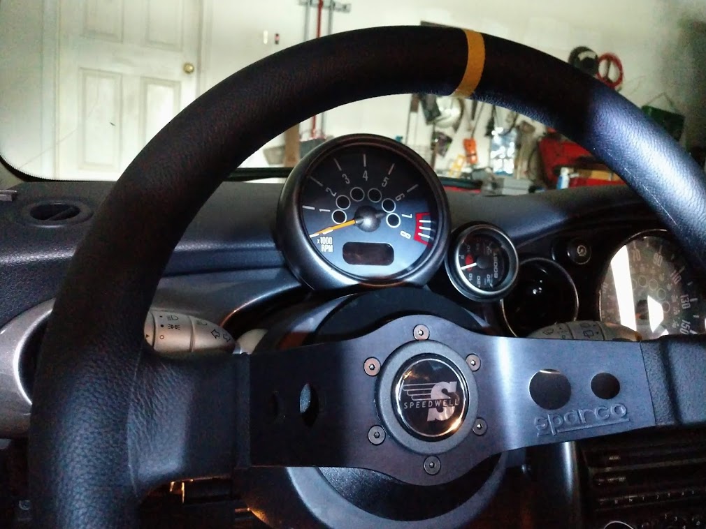

Finally got around to installing the anthracite tach & speedo rings.
I'm so glad to get rid of the chrome that was originally fitted as the shiny glare from light/sun was both annoying and a distraction.
Went ahead and added the GP replica gauge faces as well. Painted the needle buttons anthracite but not an exact match, close enough though.
Also finally installed boost gauge too.
Anthracite Tach w/ anthracite dash??-hoybzpm.jpg
Anthracite Tach w/ anthracite dash??-vyqvvst.jpg
Anthracite Tach w/ anthracite dash??-hfprlwb.jpg
Plus a nice Sparco steering wheel of my favorite type. I never did like the chunky fat feel of the stock wheel.
Anthracite Tach w/ anthracite dash??-akloljv.jpg

may I plz ask what steering wheel adapter you used ?
Old Jun 25, 2020 | 04:59 PM
Oldboy Speedwell's Avatar
Oldboy Speedwell
Joined: Nov 2017
Posts: 1,950
Likes: 813
From: NW Georgia, USA
I used an ebay special china cheapie very similar to this one:
https://www.ebay.com/itm/184138233758
The one I got looked slightly different on the backside though and required modification to retain blinker cancel function which was a j-b welded stack of the right sized washers LOL horn functions too, and used 3.9 ohm resistors to eliminate airbag dingdong light.
That particular design is a knock-off of the NRG hubs:
http://www.getnrg.com/index.php?rout...product_id=695
I may add quick release in the future, but for now it's just solid mount.
