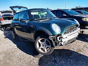

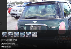

but that morning I got an alert from LKQ for a new arrival down in Largo:
I was like WOW! full aero kit fresh on the yard!
It was a 5 hour drive and I thought it was likely gonna get grabbed quick, but YOLO y'know I decided to go for it --- woke up at 3:30 AM and had a blast night driving on a very isolated hwy 98 but got more crowded as the sun came up and off the forgotten coast.
Got to Largo P-A-P at 8:30 and waited for the opening, got in finally and dashed back to the spot -
LOL
Oh well!
I got there the very next morning but it was already gone gone gone.
My drive home ended up being a long long 13hr trip!

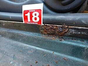

I love junkyards and since I travel for work I get to visit a good number of them all over the southeast.
LKQ P-Y-P is my fave because of the pictures, otherwise at other boneyards just going in blind with a sparse descrip of year or whatever but sometimes that pays off with a nice surprise.
I also always like looking at door sill seams too and in my sampling it seems at least 85% of them are rusted
--- the car in Largo was rusted:
