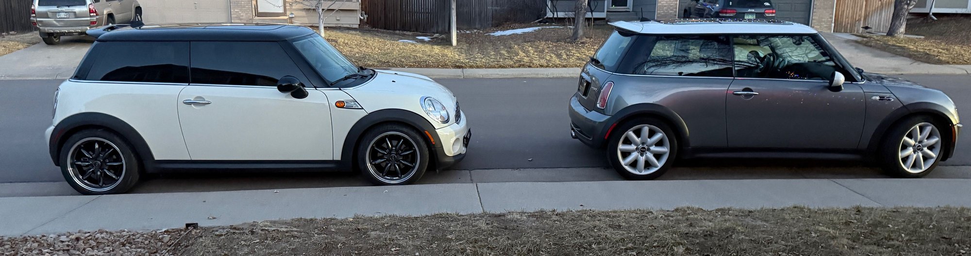

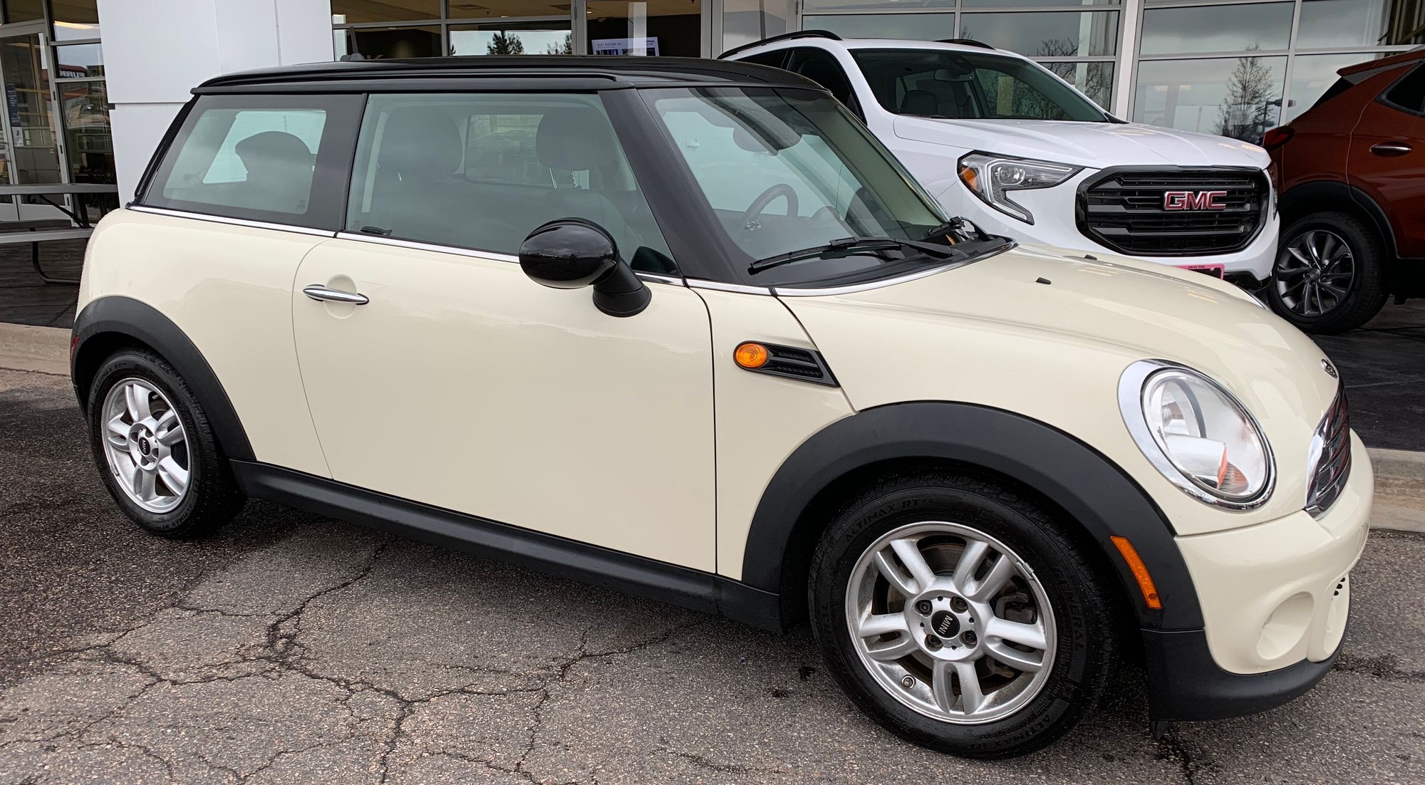

I’ve attached pics of the R the day I sold her, and of the MC the day I picked him up. I know cars (for guys) are often female, but after driving the MC for a day, I decided that his name is Paul (from the movie “Paul the Alien”).
I think the name suits the car fine and the GF agrees wholeheartedly!

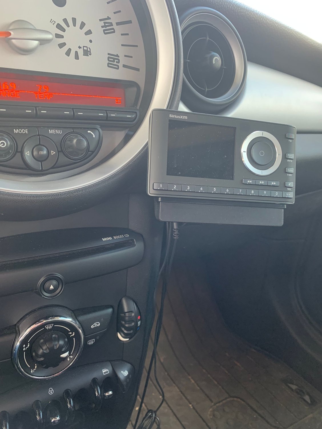

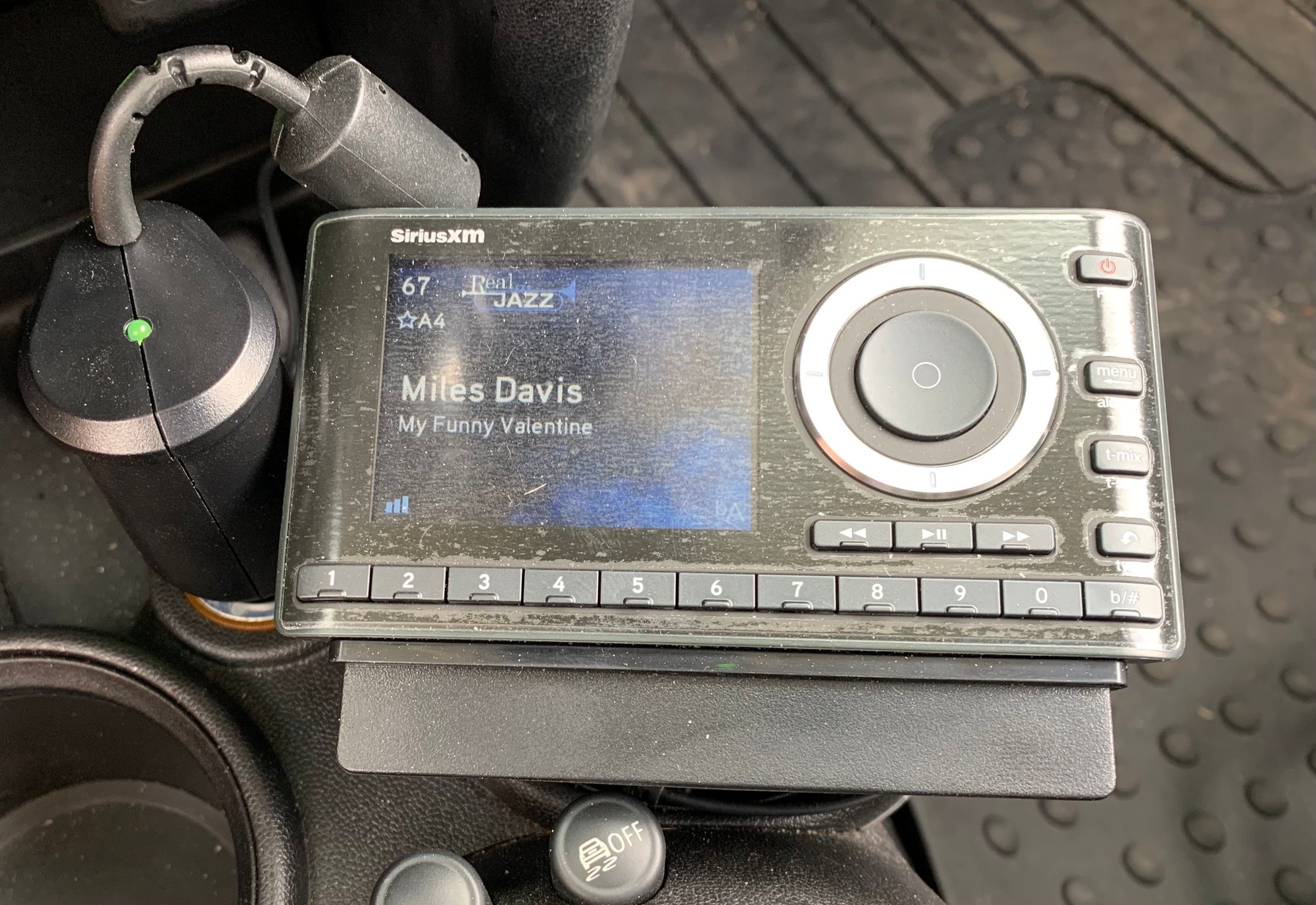

Cobbled together the SiriusXM Onyx in the car today. Pink SMB connector was in the passenger footwell, though I couldn’t get to it with just the fuse door removed. I ended up pulling the footwell trim about halfway along the bottom door sill.
Whole thing took about 5 minutes for the antenna, Another 5 minutes to set it in the passenger cup holder. ~10 minutes for the activation code to be received and the radio could switch channels.
Here’s the first mod on the list completed! Final install will happen when I receive the Angled Proclip. Regretfully it’ll be a bit as it’s currently out of stock at Proclips. I’ll not pull of the clear protection sticker until I get the Proclip and installation is final.

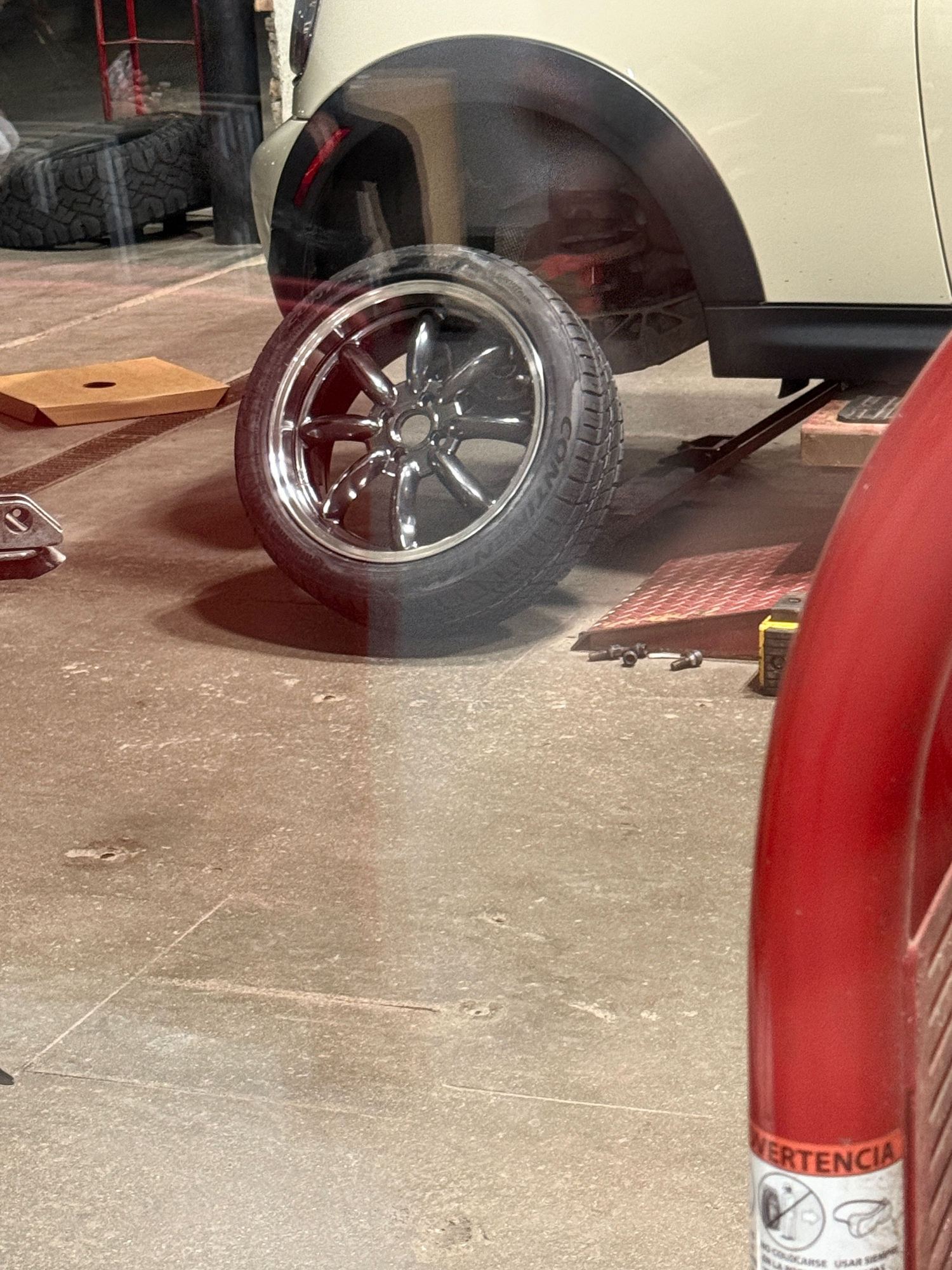

Next (same day) my friends Todd, Tim and I installed Alta 22mm rear sway bar. Shocks were replaced pretty recently (but not upgraded with premium components), so I’ll pass on shocks for the moment. Maybe I’ll get the TSW springs next month or wait and get the shocks/spring to install at the same time. We’ll see what the budget looks like in June/July.
RSB Install went pretty easy. Some of the hardware wasn’t the same as listed on the install instructions. Primarily it was the rear subframe bolts were reverse torx head bolts - but the tools were on hand so no biggie.
After the install and many thanks to some very great people for a job well done, I took the Mini up the canyons for a quick test. WOW! On the middle setting, the rear turns in nicely now. Curves with awkward camber no longer upsets the car either. It feels much more planted through tight S or switchback curves too. I do feel the road bumps a bit more than I did before, but it’s just a bit firmer in back than before the new sway bar install
With the new RSB, I can feel the stock tires rolling on the sidewall in fast sharp corners. Wider rims/tires are the plan, but nothing radical - just better handling when driving towards the limit.

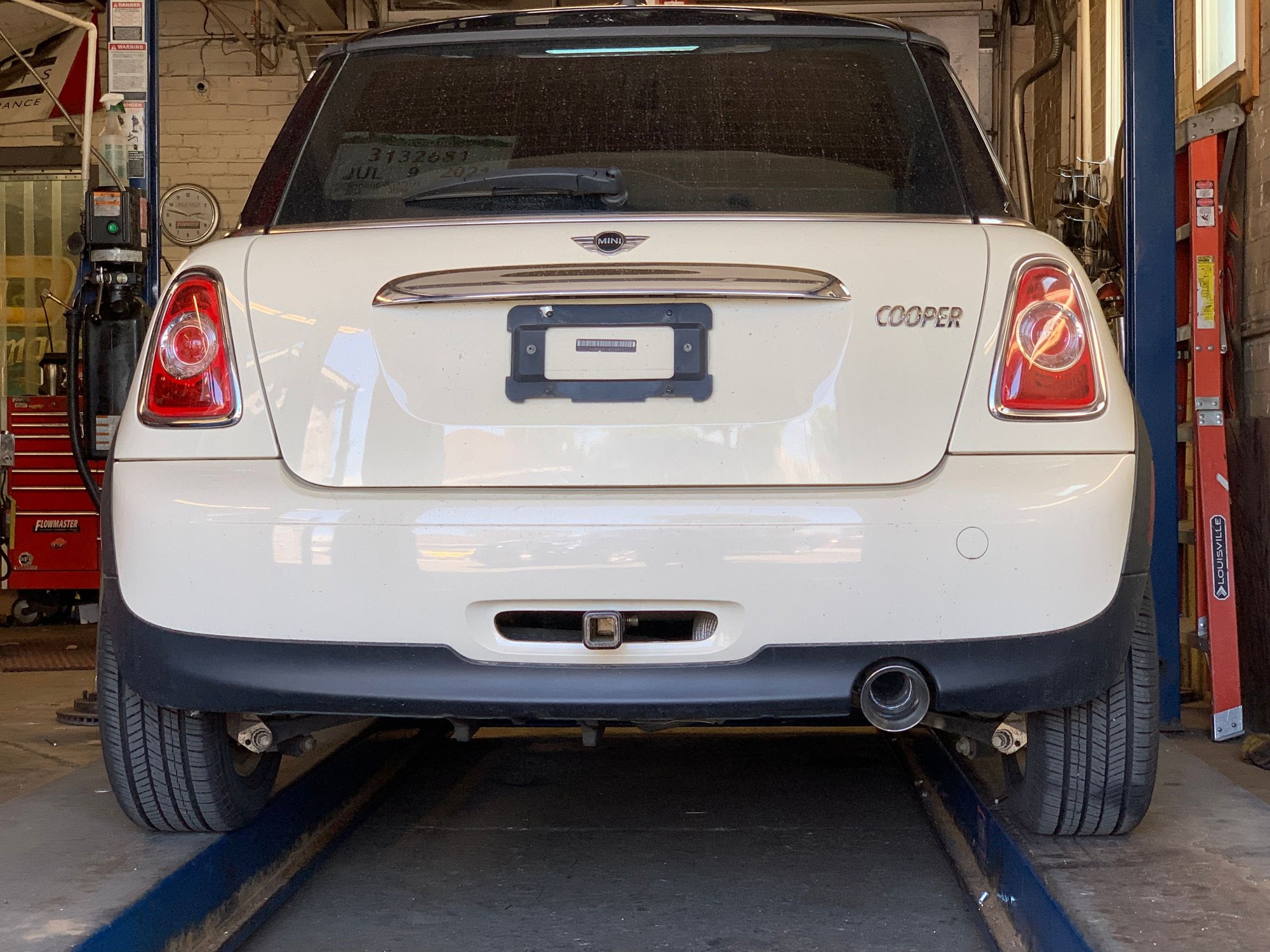

Today, I did the exhaust at BDM (Metro Denver muffler shop). Talked with Ron yesterday, explained what I was after - more volume, free flow, deep tone and no raspy tones - I suggested a Magnaflow & 3” pipes. He suggested a resonator back set of 3” tubes, a Flowmaster DBX (laminar flow muffler , more info here:
) and a 4” double wall polished tip.
BDM totally delivered!
Here’s Paul coming off the lift. And for $300 out the door, I couldn’t have asked for more! Sound is deep and is exactly what I was looking for - and no drone either - just deep, great sound. Engine does rev a bit easier, and has just a hint of burbles on deceleration, but my calibrated butt dyno says, no power was really added.

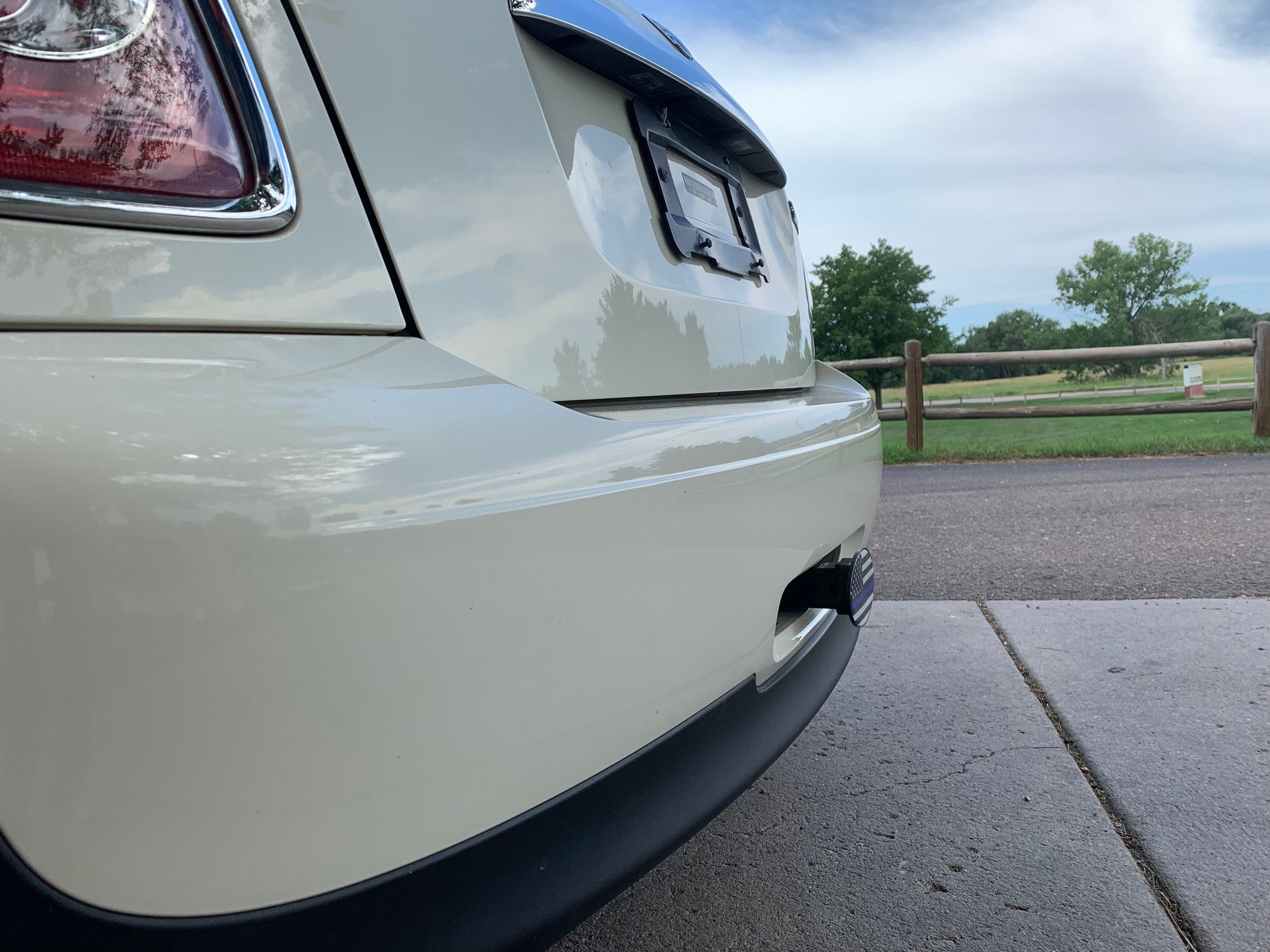

Today, I also received the Brophy hitch extender. It’s shorter than the Curt, 1UP and most of the others I found. With the Outmotoring hitch, the end of the receiver is just outward of the bumper cover. My Mini no longer has a (mini) tail! All good…

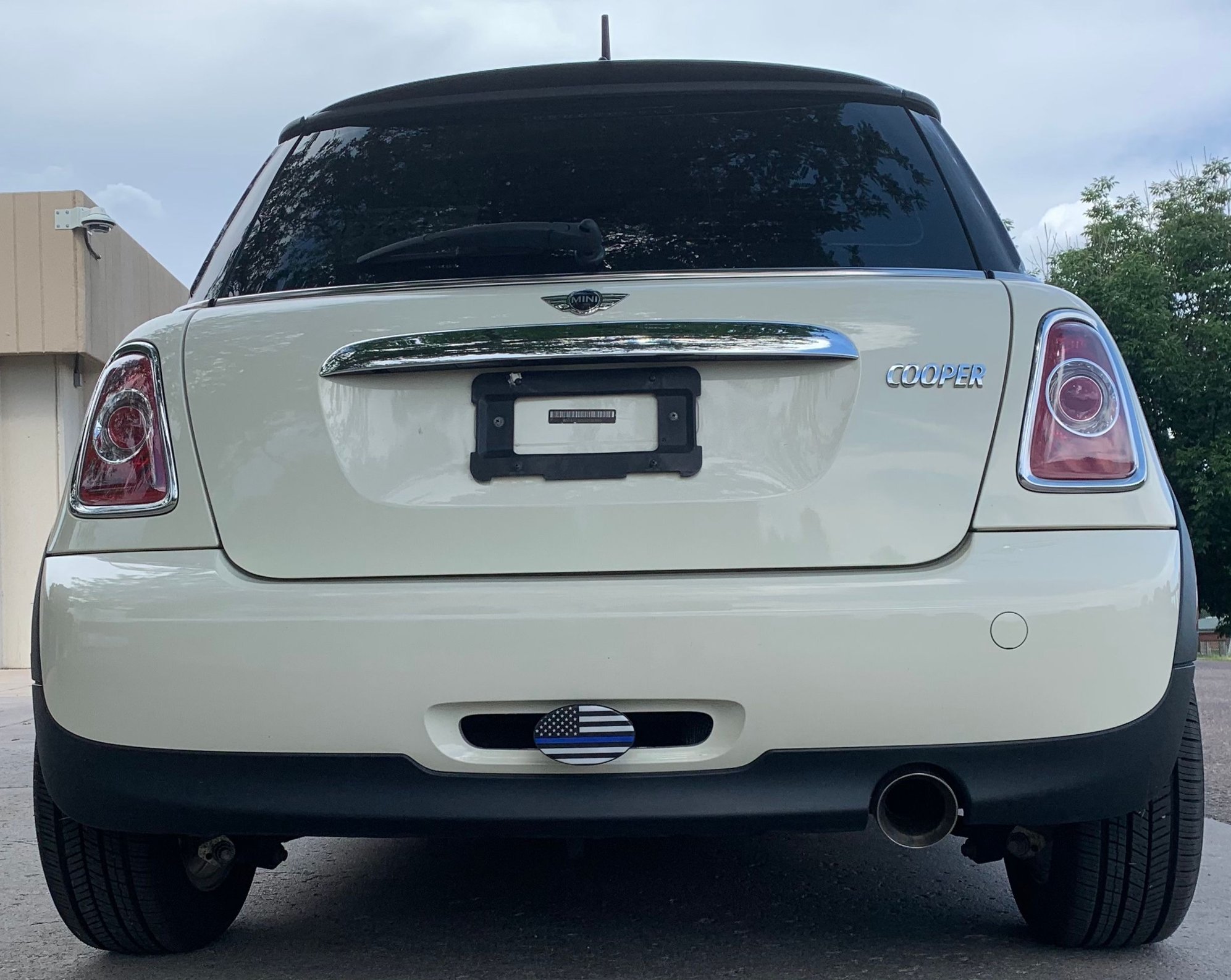

Here is Paul again with the Yokohama 195x60R15’s, the new tint and the new black upper slat grill.
And the new scuttles.
A better shot of the new/shorter hitch extension. It actually tucks up to the bumper cover nicely.
A better view of the rear & exhaust.

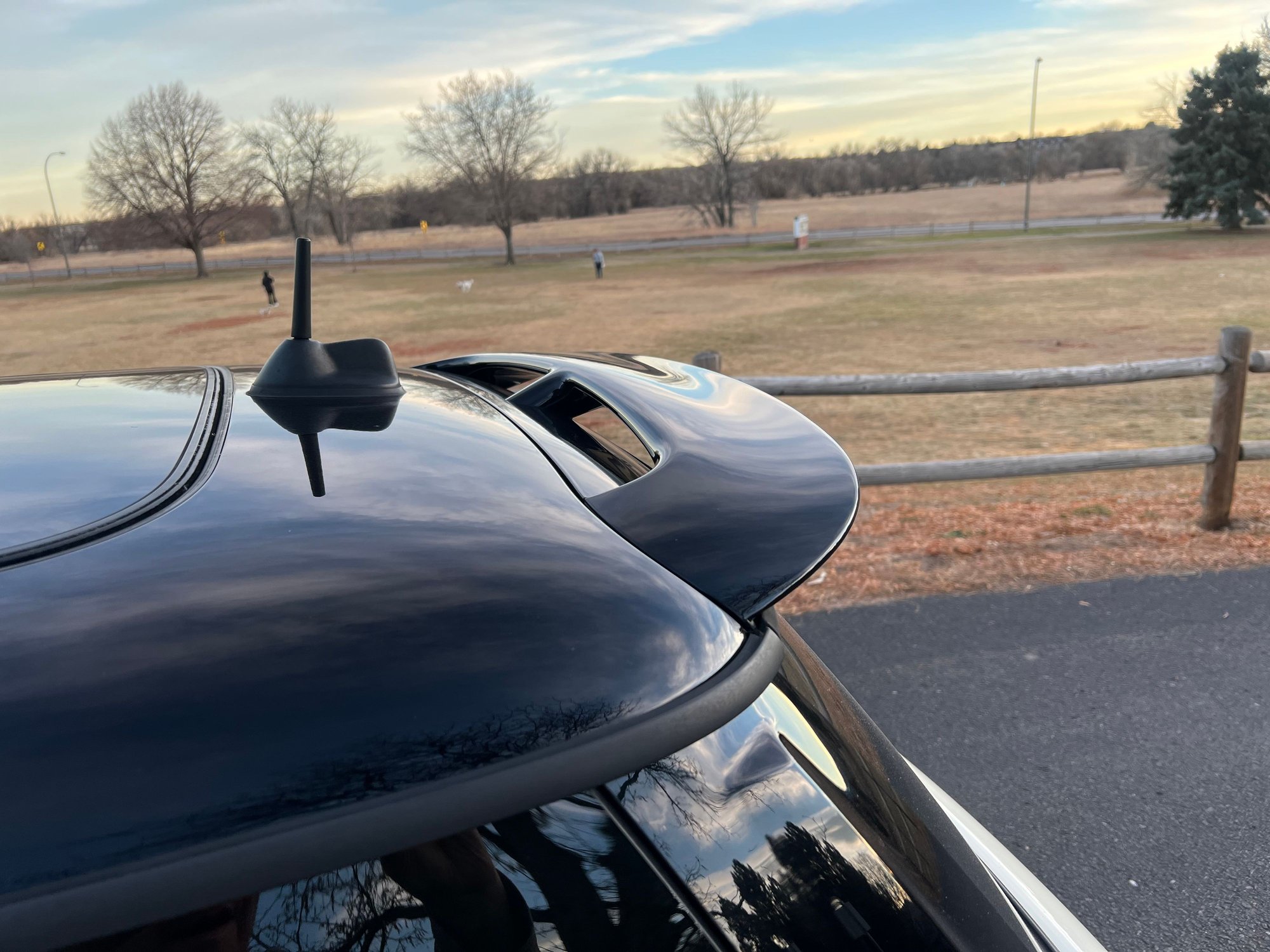

Added a MCS wing to the car yesterday. I think I like it!
Another shot of shot of the wing. But the real item is the missing rear wiper. Wiper delete added!
At the same time, i added a flashing rear brake light. It’s already saved the back of my car from inattentive drivers. Set it to 6 blinks all the time.

Oh and I finally wired in the Sirius Onyx in correctly, so no more dangling wires.

Well, I finally did it - Paul has new shoes.
I debated long an hard around new wheels and tires. Should I go 16's and have a bit more comfort or go 17's and a bit more performance. Well, I went with 17's Rota RB in Hyper Silver (Thanks Dan!) and 215/45/17 Continental DWS 06+'s.
Wheels arrived well packed and in perfect condition. Discount Tire struggled a bit with the center caps, but eventually all was good. Also, my original wheel lock lug bolts were too short, so I bought new bolts from Discount Tire at the time of the install.
I'm still not lowered as the roads around here still $uck with potholes, cracks and divots out of the asphalt.
Here's what I notice - 17's definitely have more grip. Ride is bumpier over cracks. Tire/wheel combo grips like the dickens in the twisties. 24.6" diameter 215'a raise first gear a bit so I need to use a little more clutch than before. Acceleration is a little slower, but not overly so. Everything fits with no rubs or scuffs. Corners that I couldn't take at speed with the 195's I can take now. Keeping speed is a bit easier too. Climbs in the Colorado foothills I can still do in 6th gear and I rarely ever down shift at speed. I'm sure the higher mountains, I'd be shifting more.
If you folks remember I installed FSD's a couple/few years ago. I'm now at ~137k miles, so only ~25k more than when I bought the Mini used.
So, if I had to do it again, would I go with 17's or 16'a? Really it is a toss up, but if the car was lowered ~1", I'd go 16's. If it was an S, it'd be 17's. My car? I'm totally happy with the 17's and the way they perform. I usually drive alone anyway and I don't mind the increased bit of bumps from a smaller sidewall. 235/40's are a bit shorter in overall diameter and I don't lose much sidewall, so I may do those next - but it will be several years before it will be time to replace the 215's. For now, Paul is still a keeper and I'm still a happy camper...

Well, I finally did it. I bought another Mini. 2005 MCS, manual, bone stock with 78k miles. We're a 2x Mini family.
We're keeping Paul (2013 Cooper) and welcoming Otto to the family.
I've since put Paul's new wheel tire combo on Otto and I'll be searching for some different wheels for Paul.
