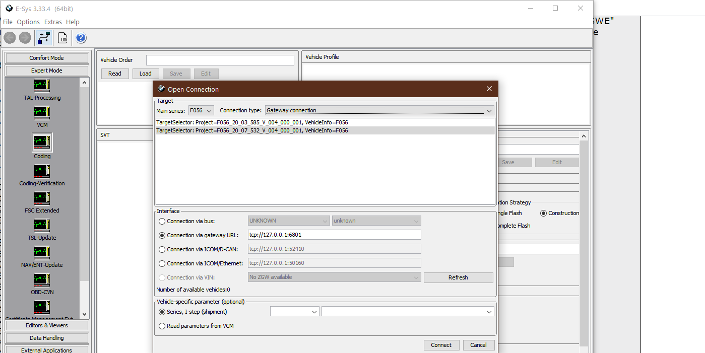

So which target selector do I choose???
Old Sep 11, 2020 | 10:46 PM
choose the top one, and select “connection via VIN” because if ya don’t it won’t work.

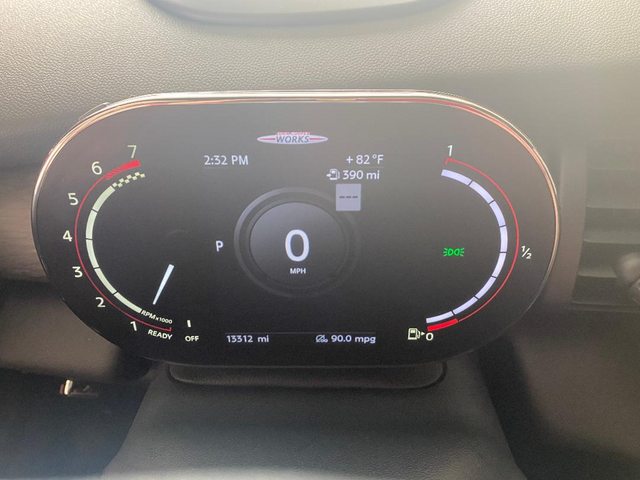

Successful install and coding
Took a pic this morning. Everything works as it should.

Thank you everyone for helping me figure this out. A little intimidating once you see all those lines of code pop up but I used to code my Audi, it's just been long time since I've done stuff like this. Kind of makes my HUD and Cravenspeed phone mount useless now. Logos popped up automatically for me.
I didn't do these steps:
23. Fire-Up ESYS (with ESYS launcher if you haven't used this originally to start ESYS)
24. Perform FDL coding as necessary on your HU to ensure that the following are set as below:
KOMBI_CIC: set to kombi high
EXTERNER_MOST: set to aktiv
Are they necessary? What does that coding do? I never use the factory nav only CarPlay
