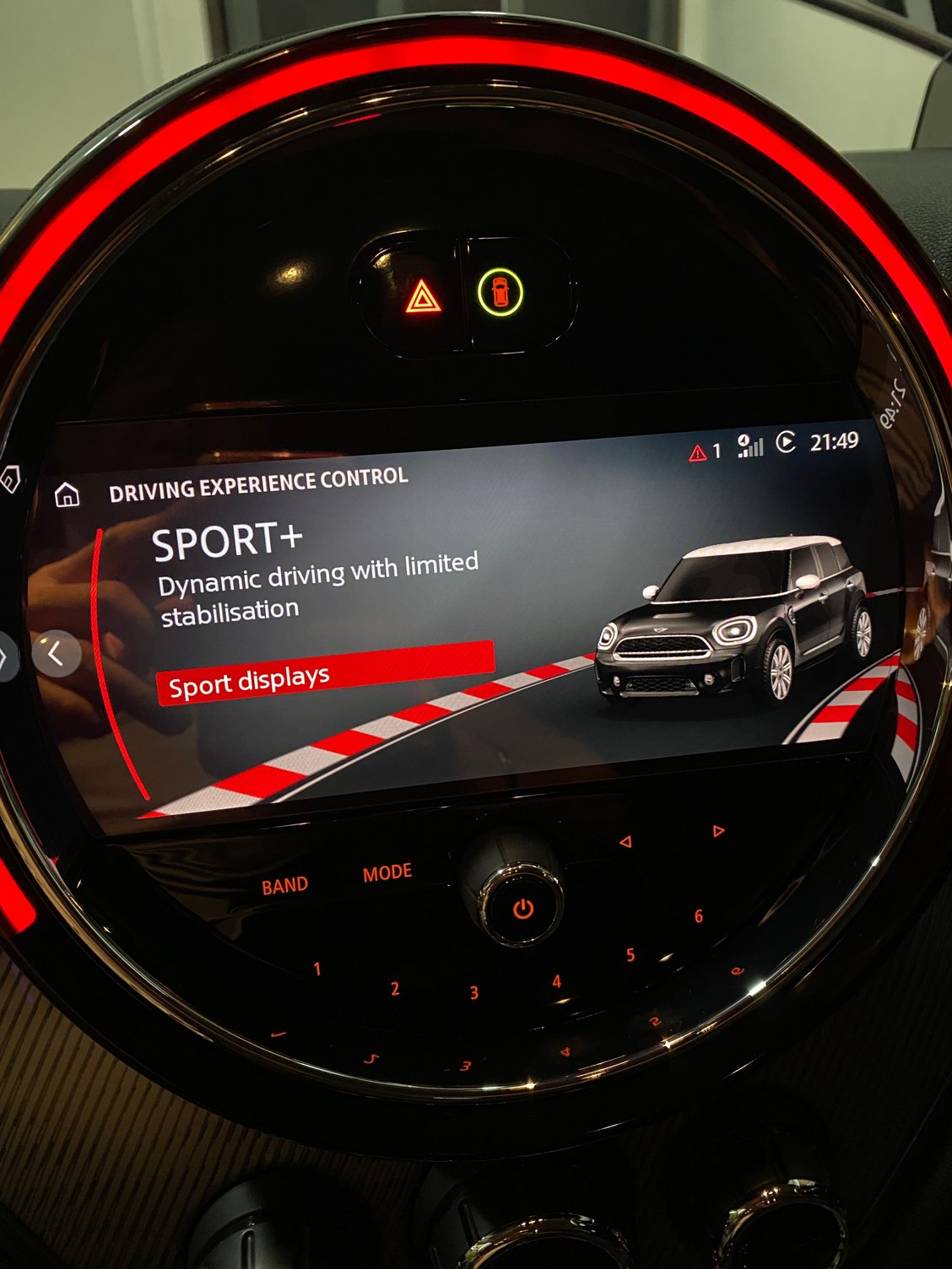

Greetings, I have a 2022 F60 and I’m trying my luck here to see if any of the coding experts here might know how to unlock Sports + display or configure driving mode views on the digital kombi. Unfortunately I can’t find any information on the net for this.
I’ve managed to code additional Sports+ mode selection at Bdc Body module but on the kombi it’s just showing the background for the Mid mode.
Been browsing and trying some parameters in Kombi but no luck so far. Thanks in advance for any pointers guys.
