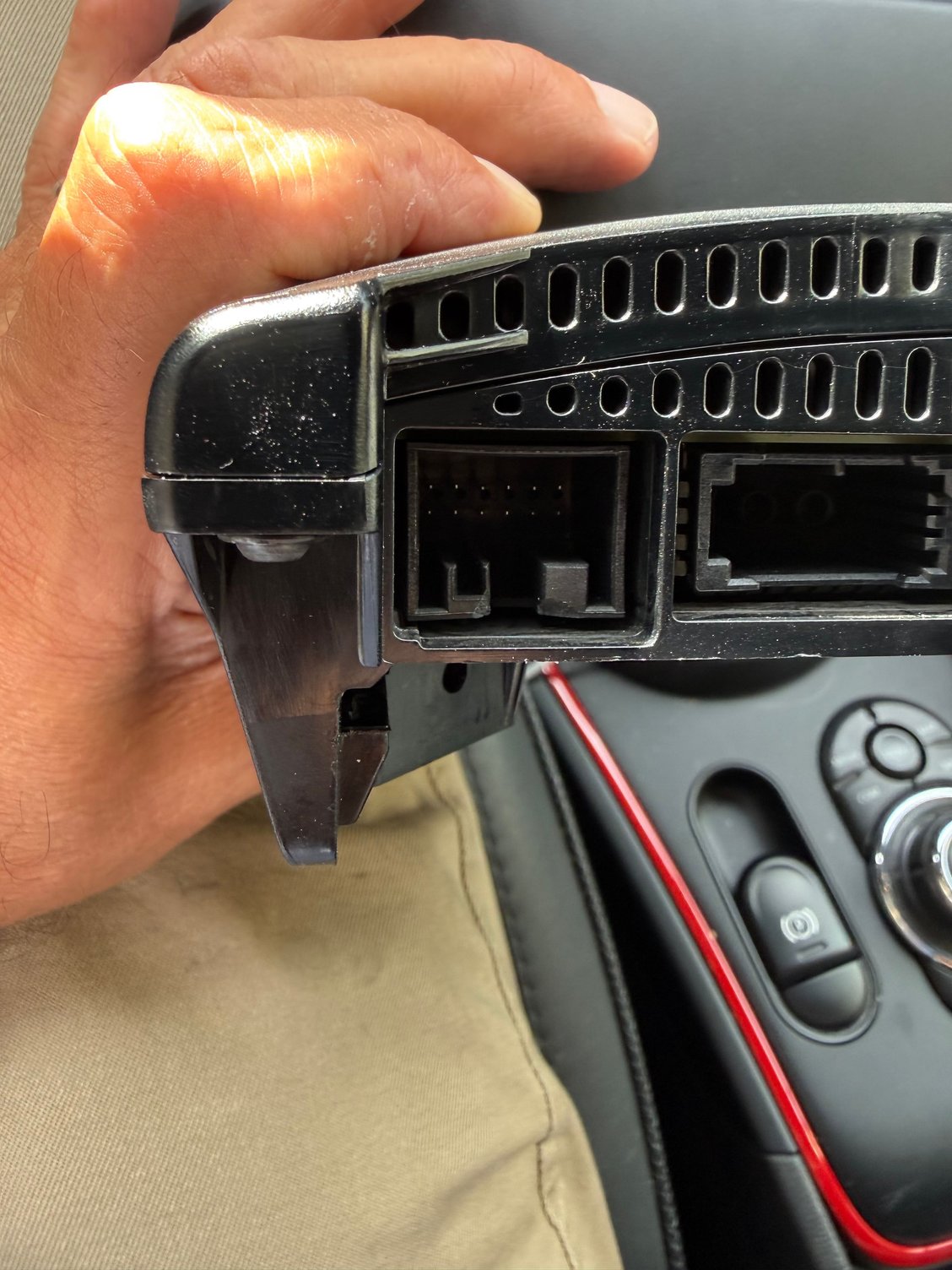

Hi everyone, I can't solve a problem with the 6WB Kombi, and despite reading the entire thread and trying every recommended solution, I can't figure it out.
Mini Countryman 2019, Entrynav2, HUD, Most present.
I installed the 6WB in 2021. I didn't code it, and I hadn't read anything yet. It worked flawlessly for two years, until it stopped turning on, went through the initial check, then turned off. It would only turn on for a couple of seconds with the start/stop function.
I haven't found anyone who could solve the problem, so I reinstalled the original Kombi. I think it's a 6WA.
If the 6WB is connected, I can't find the Kombi in the SVT; if I install the 6WA, I can. I changed the production date to 0320, I searched for DKOMBI without success, I checked the most connector and the active fiber is the one on the clip side. If I insert it, I see the return. The only strange thing I see is that when I check BDC_GW, the most doesn't seem to work and flexray doesn't activate. If I activate the trigger, the situation doesn't change. I don't know how to get out of this, any suggestions are appreciated!

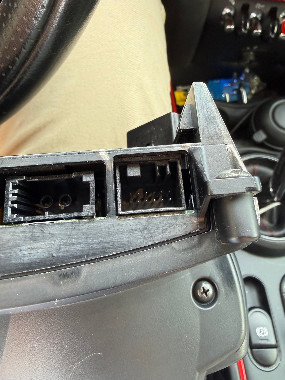

Old Sep 16, 2025 | 01:38 AM
  #365
Lalex112's Avatar
Lalex112
Joined: Sep 2025
Posts: 4
Originally Posted by sambir
so you used 6wb for 2 years without coding it??? So you have been driving the car with the kombi uncoded, full of errors.
first off all when the kombi is not coded it will run in standby mode, the fan wont work to cool it down when it is hot, etc etc…
If the car is equipped with an headup display and you DO NOT see the kombi anymore while it is connected this means it is probably defective. If you dont have a hud you need to do more to see the kombi in the svt tree.
I may have found something that could be causing the malfunction. Checking the connections, I realized that the electrical connector is located slightly differently. So much so that in the 6WB, the connector doesn't fully seat and doesn't engage. Do you think this could be the case?
Tweedbean
