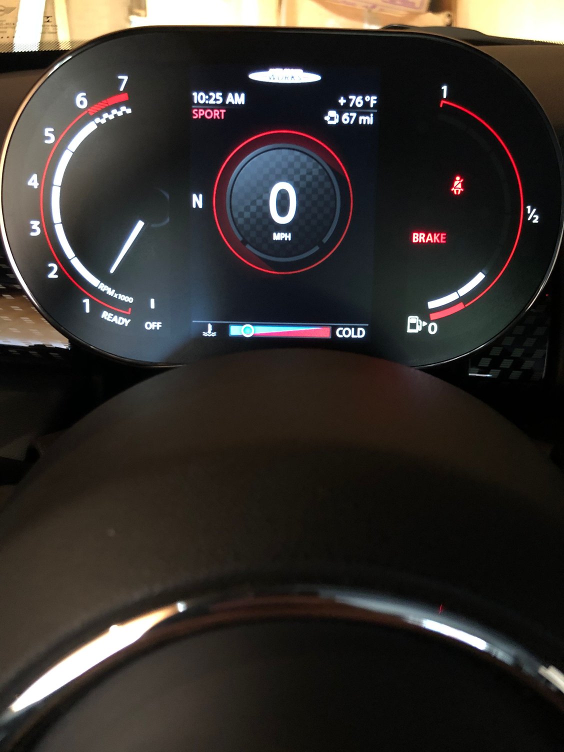

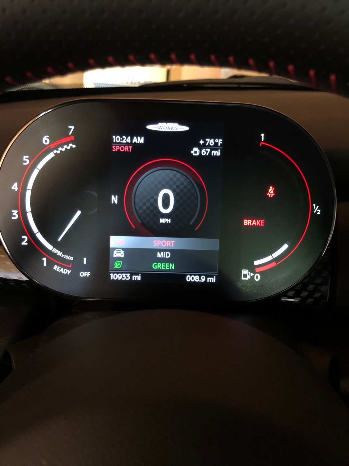

Old Aug 7, 2020 | 08:10 AM
sb2002's Avatar
sb2002
Joined: Mar 2017
Posts: 219
Likes: 59
I got ambitious and installed this on my 2017 F56 JCW.
Thanks to Ndal for the coding work. Everything seems to be working perfectly.
Old Aug 7, 2020 | 10:16 AM
Darbys2019MiniJCW's Avatar
Darbys2019MiniJCW
Joined: Apr 2019
Posts: 401
Likes: 243
From: New Braunfels, Texas
Just the fact that the TACH is visible is great...I will be doing this pretty soon for sure. Great Pics make it look great
