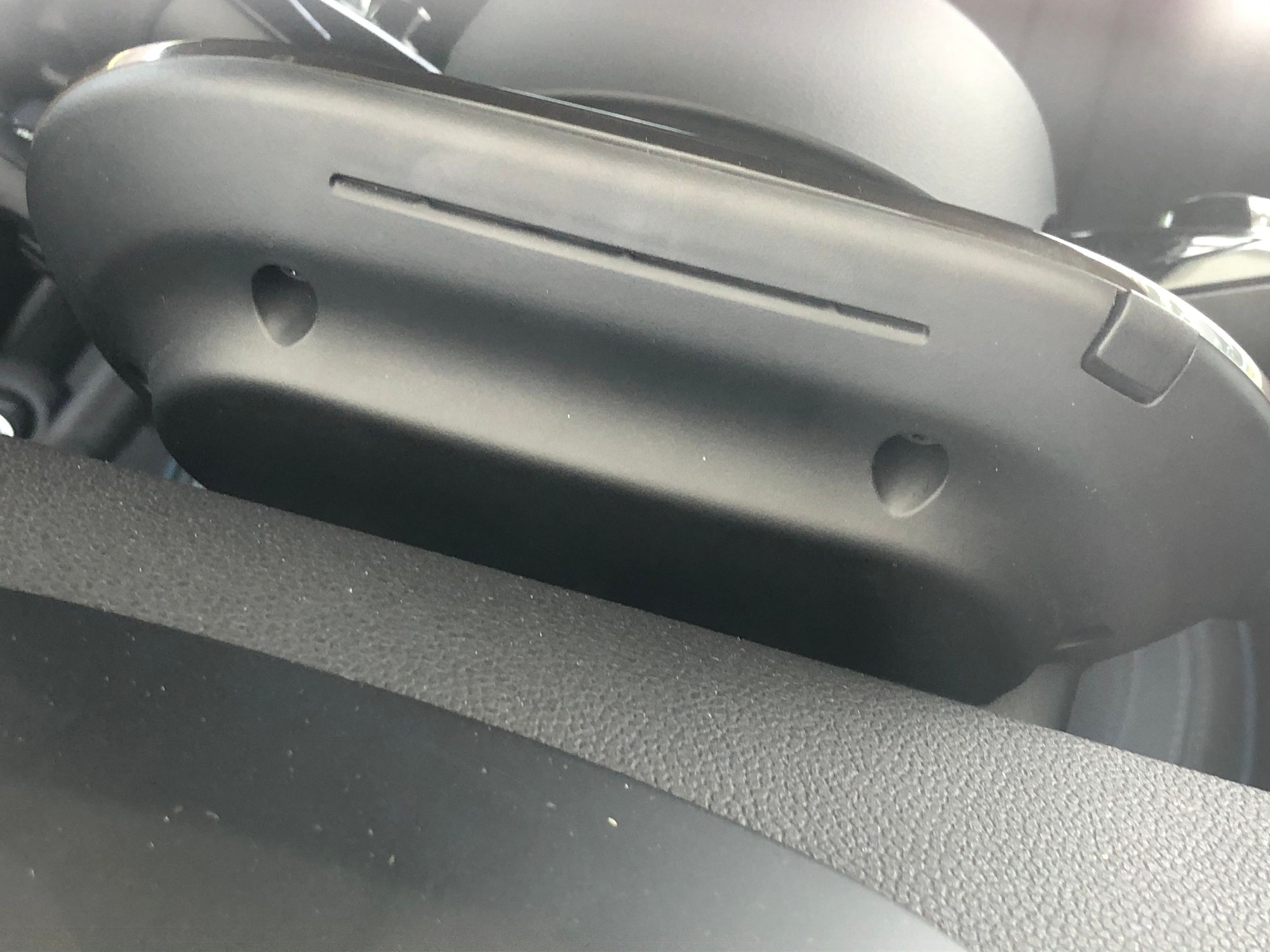

Someone was asking about what the back side of the Dynamic Digital Cluster looks like. I’m at my dealer now for service and they have a few cars with the new cluster out front. Not the greatest pic because the car is locked, but here it is.

From: Dallas, TX
So, I was starting to install my new digital KOMBI. I can get the middle connector off very easily. The other two - not so much. I don't want to break them, so I thought I check and see what the trick is to get the blue one and the one with many different colors wires in it out. The middle one is green and just unplugs like a phone jack.
Last edited by kfmuller; Sep 3, 2020 at 01:51 PM. Reason: got the dropped screw out
