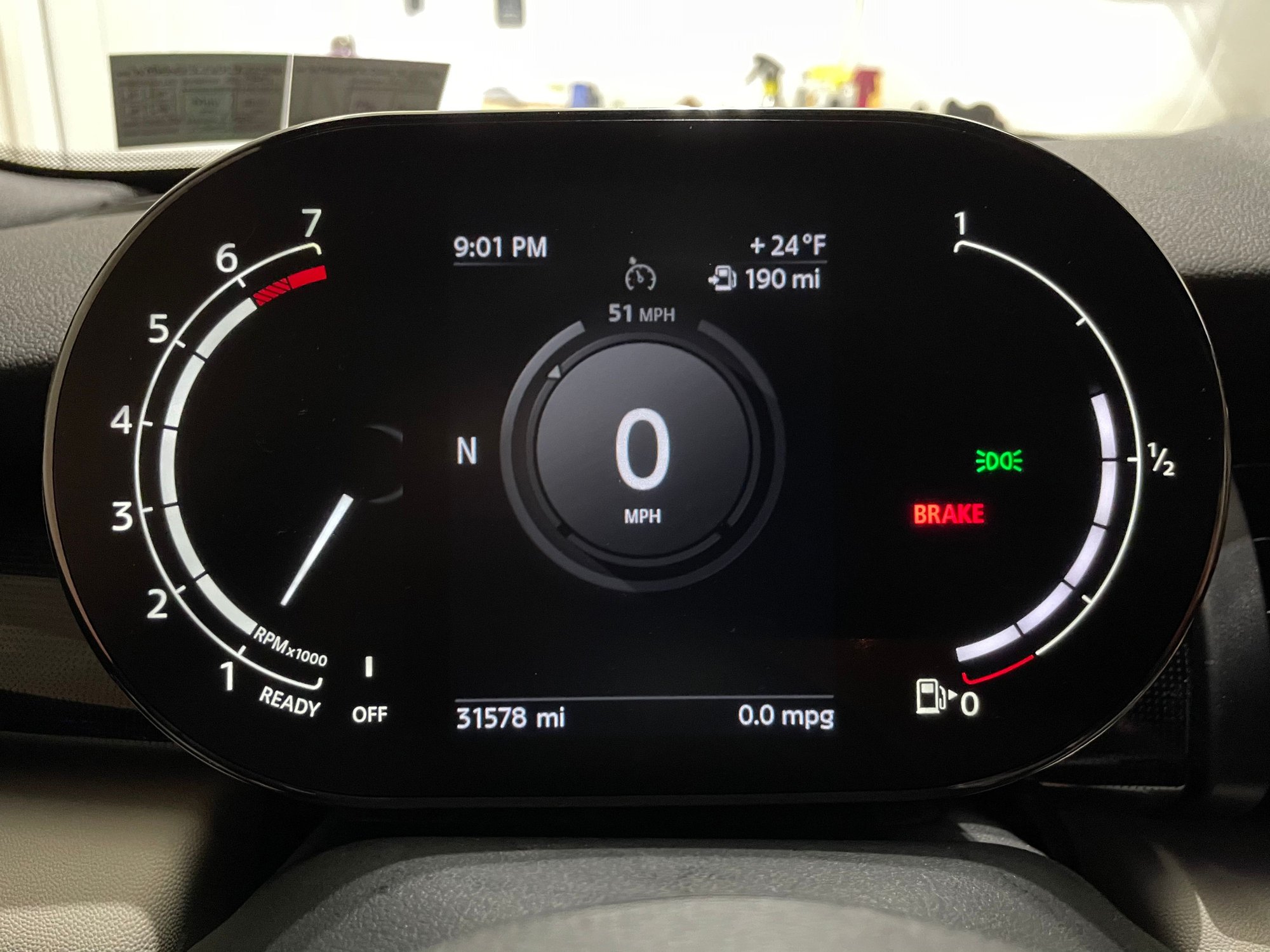

Installed part # 62-10-5-A18-9D5 in my 2019 F57 (w/o HUD) and everything went off without a hitch. Happy with the results!
Much thanks for the report back. It is comforting.
Your pic is the only "after" I remember seeing that does not have the concerning /!\ still displaying.
Not familiar with that warning. I wonder what’s causing it??
Hi Walt - the symbol you’re referencing might just be the symbol for the parking brake outside of the U.S. I’m not aware of anyone having coding issues that cause a warning light to remain on.
