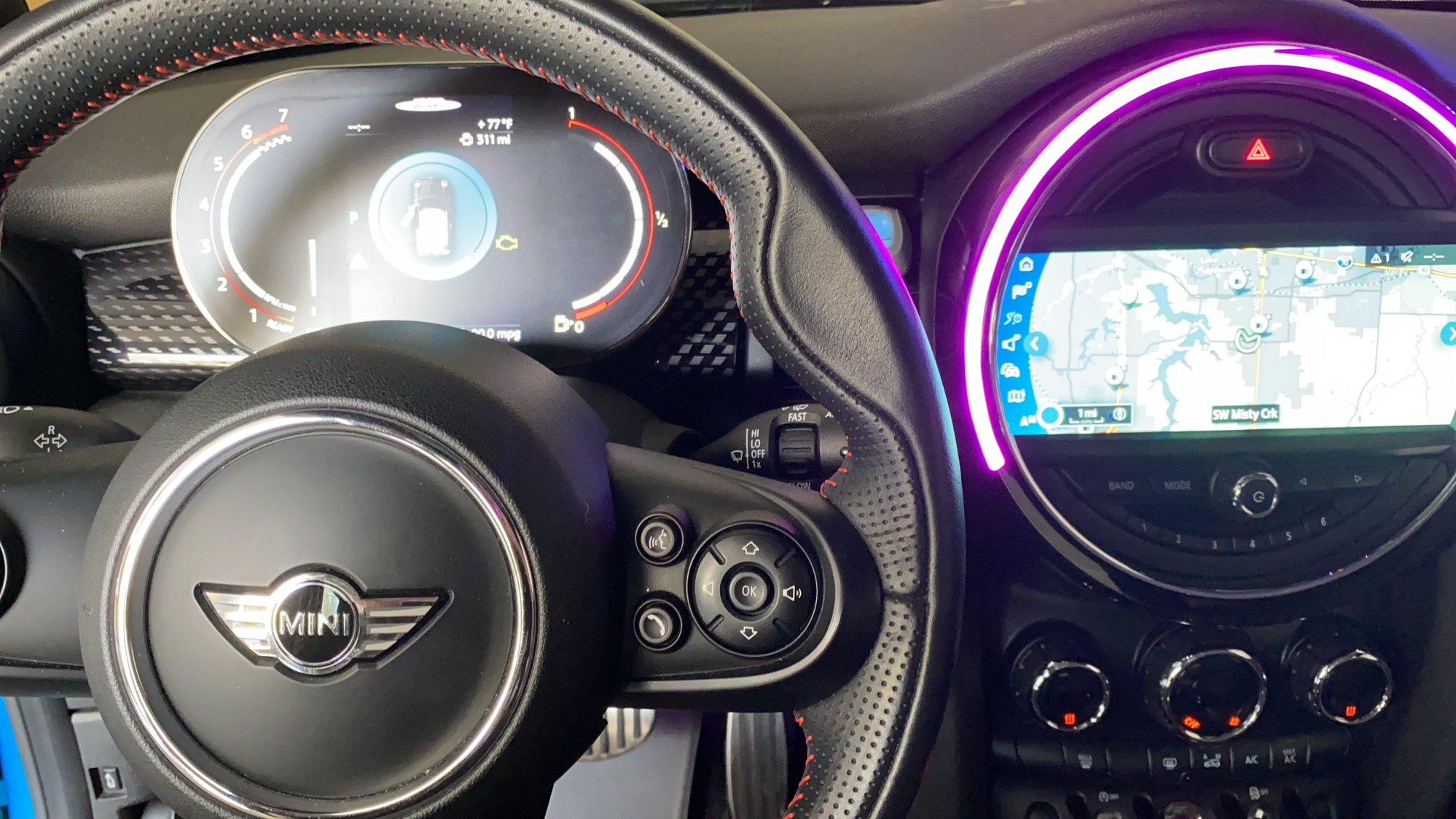

Thanks to ndal we now have a working digital cluster. He is the best. 👍 2016 s
