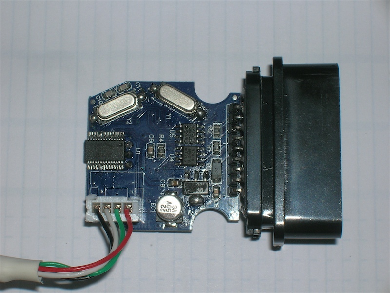

TRIPLE_O
With my R60, mini countryman cooper s all4, 09/22/2012
I checked faulty cable ( pic as cm.d mentioned in post 568, left white one)
Change latency to 2 or 4 , help INPA to read right status of ignition.
If latency = 1, INPA always reports ignition on no matter that is car ignition status
But NCS can not read anything, shows:
vin is faulty ,
COAPI-2020, no answer from ECU
IFH-0009, ECU not connected or doesn't answer
Old Jan 13, 2013 | 01:02 AM
Thanks mikecalgon for checking. Just to confirm, pins 7 & 8 were disconnected from eachother right? I'm trying to see if maybe we can get these faulty cables to work (not recommending people to buy them, but since some have them it is worth a shot).

TRIPLE_O
the faulty cable pin7/8 soldered originally, I disconnected them before the test of change latency. It seems like that the good cable is older version. Could be a software merged into circuits.

D-CAN Cable
Hello,
TRIPLE_O
mikecalgon
cm.d
THETA
kerrys914
great talks on cable.
I own a blue PCB cable that doesn't work. I compared with Hi-res pictures posted here up but I didn't find any macroscopic differences from THETA and cm.d ones.
I REMOVED also the pin 8 from OBD connector because pin 7&8 were shorted together on the back PCB, and when I try to connect the PC with my MC Cooper D 4/1012, Ediabas reports correctly battery and ignition on/off sensing. Although it seems work fine I'm not able to read any ECU's.
The cable's supplier with the cable included also the following programs for setting the cable modes:
D-CAN.exe (windows)
DCAN.exe (dos shell)
OBDSetup.exe (dos shell)
When I launch D-CAN (or DCAN) and I set the "D-CAN" mode the led on cable switch off and after few seconds the software reports an error code.
Have you got any experiences on this setup?
Here I attach the HR picture of my cable.
Originally Posted by esse.erre
Hello guys,
I'm trying to do a coding on my new R60 MY 2012.
I'm having a trouble with the connection between Laptop and car using the INPA cable (just bought) displayed in the picture above attached.
The INPA software looks like to be ok (it recognizes battery and ignition on) but it is not be able to read any Control Unit).
I noted that on the side of the connector, the pin 8 is present and it is electrically connected with the pin 7 (even if on the back side is not soldered with pin 7). I'm wondering if should I remove pin 8 or to do other mods.
Have you got any suggestion?
Thanks a lot,
Silvio.
Thanks a lot for your attention,
Silvio.

I have to say that the only blue PCBs I've seen were in the older blue cables (Pre-K+DCAN).
If this is indeed the case, the hardware, itself, will not allow for DCAN communication.
Good issue THETA.
Since it seems identical, can you help me to compare the blue hardware with both white and green?

Looks like the pins are bridged on the IC chip. I don't know if that's your problem though. I don't know much about how these circuits work.... but I can build them.

Originally Posted by mikecalgon
TRIPLE_O
Thanks for the feedback. It looks like no matter what, drivers, pins, latency, etc that this cable is in fact faulty.
Correct. I have never seen a blue board cable work for a DCAN vehicle. I have seen others order them with no success.
