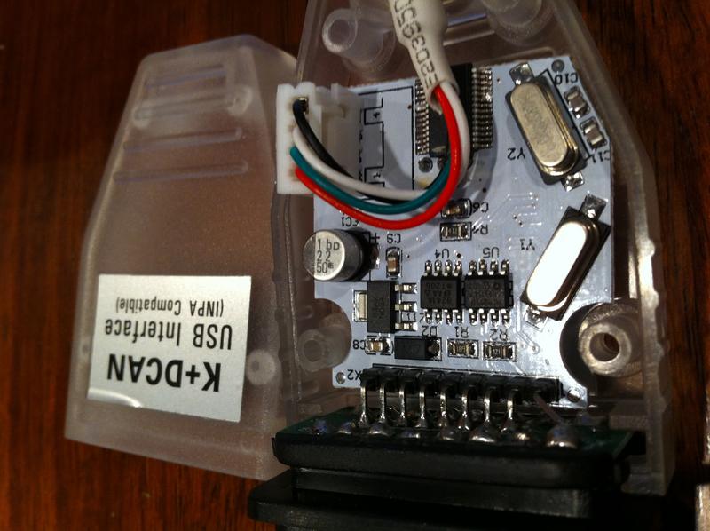

Also, just an FYI - I've been using a white PCB since the beginning for the R52, R53, R55, R56, and R60. Never had any issues.
I'm posting these high-res pics so you can compare chips, etc. The switch is there to either bridge or sever the connection to pins 7/8 and subsequently code either Gen 1 or Gen 2.
Happy coding!

The differences between the board above and the board that people are having problems with are:
Problemed board has a voltage regulator, board above does not. (board above has the space on the circuit board for a voltage regulator though.)
Problemed board has a very thin wire connecting pin 1 to the board, board above looks thick. Looks like a the ground wire. This could be the issue.
And of course, problemed board has 8 and 9 soldered together, not a switch like the above board.
I might be able to get the problemed cables working, but my car is on the boat. It's probably another month before it gets here.

Excellent info! Thanks for the detailed comparison - it will certainly help identify the differences between old/new white boards, and the green boards.
Edit: I should probably add that I put the switch in there to go back and forth between Gen 1 and Gen 2 coding. Didn't want to make it look like it was there originally.

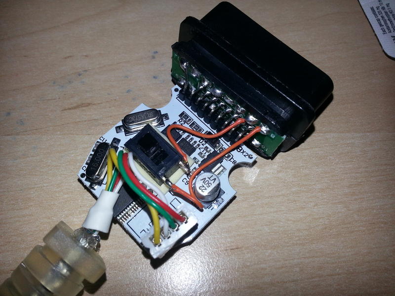

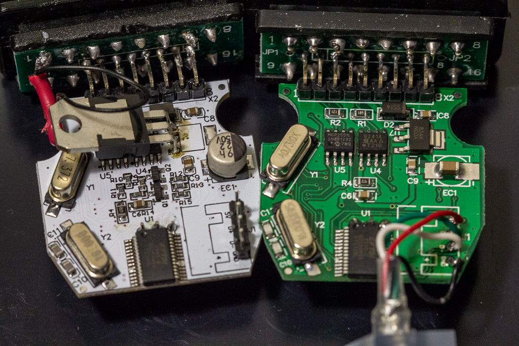

Cables are here. Mini is not! Here are a couple pictures of the cable(s).
Left: Common white board eBay cable that all sellers are selling now, which do NOT work according to this thread.
Picture shows modified pin 1, and unsoldered connected pins. No idea if these mods work.
Right: Green board. Might be the old working version. No mini to test this with.
There are a few differences from Theta's working cable and my green board. Pin 1 is connected differently. Also on the top of the board, it doesn't have a capacitor on the right hand side. If anyone was following my earlier post, I was wrong about the voltage regulator. The working board has a smaller voltage regulator than the non-working, although I don't think this is the issue with the cable not working with the Mini.

Dug mine back out and moved the switch to show what's underneath - here's the issue.
My old white cable has the same structure as the now-green board. Look at the resistor cluster on the top-side - the new white is a jumble. The green is only two. The old white is also two. Well, mystery solved. The older white cables are essentially the green cables now. The new white cables are junk.
