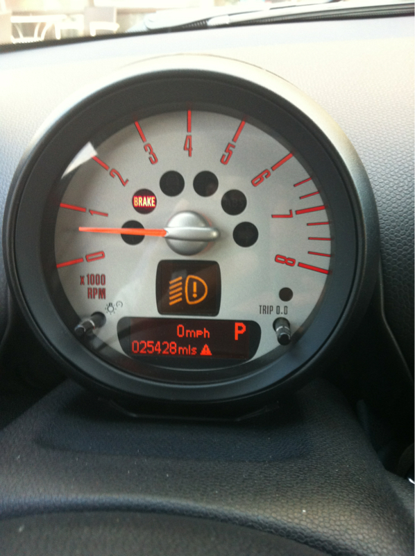

For some reason when I drive for a while at night, stop to run into a store and come back out when the auto headlights come on, the fogs don't and I get the symbol shown in the photo. Funny part is the bulb check for the fog lights is coded out as I am using HID's. It appears by changing the code to have the fogs come on automatically with the headlights, they are activated by the parking lights.

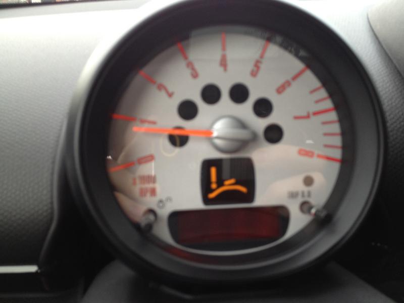

Tried to do the one touch sunroof. It opens and vents ok with the one-touch, but now when I close it, it stops in increments and I have to repush the button repeatedly until it closes completly. I then went and put the original file back in to try and fix it, but it's still doing the same thing.
Wondering if this error has to due with the stopping problem. I believe this started after changing the module for the keydong with open door.

Hmm... I've not seen that error display before. Triple_O, you have any idea what that is?
Try keeping the modified file with the changes loaded to the car, but reverting the Key Gong Disable back to the default setting of:
CC_ZUENDSCHLUESSEL
aktiv
in the KOMBI module.
