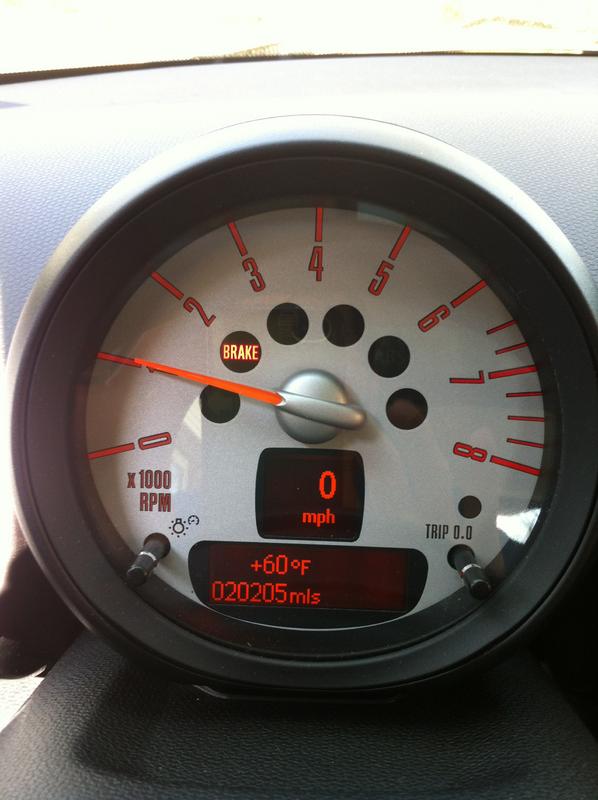

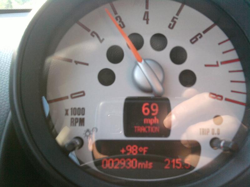

good morning gentlemen,
before firm update 12.20.2011 dash board showed this: scrolled info, odometer and trip mileage
but, after the update it only shows: scrolled info and odometer where trip mileage is in "scrolled".
is there any way to show trip mileage next to the odometer info?
thanks

Old Apr 14, 2012 | 10:56 AM
  #186
Theta's Avatar
Theta
iTrader: (7)
Joined: Feb 2011
Posts: 1,206
Likes: 9
Thank god someone else noticed this...
When I had my R60 in for service, I was driving an R56s and noticed that the gauge was like that. I thought to myself, "Wow, I'm glad mine isn't like that!"
As luck would have it, the latest Datens make every tach look like that. As of yet, I have not found a way around it, or a path back to the old look. If someone else has, please chime in.
I believe they've actually edited the layout in the software that extends beyond what we have the ability to code in/out... Quite sad really.
