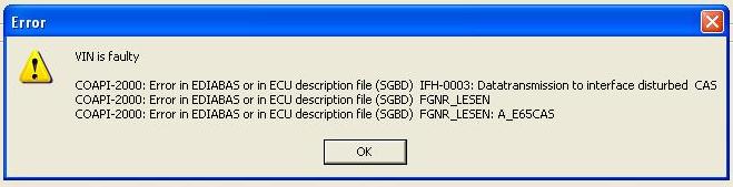

So i rebuilt the whole OS again and just installed Nutsofamily package and ran hit batch file.
Here is the new error I get.
Any ideas?
Old Dec 26, 2013 | 09:21 PM

Old Dec 27, 2013 | 06:46 PM
  #456
bmrguy03's Avatar
bmrguy03
Joined: Oct 2011
Posts: 489
From: Chino, CA
Originally Posted by Wrecks
51.1 files? Can provide a link? or what forums they are on? Mahalos
Sorry I meant 50.2 and here it is
https://www.northamericanmotoring.co...7-post896.html
