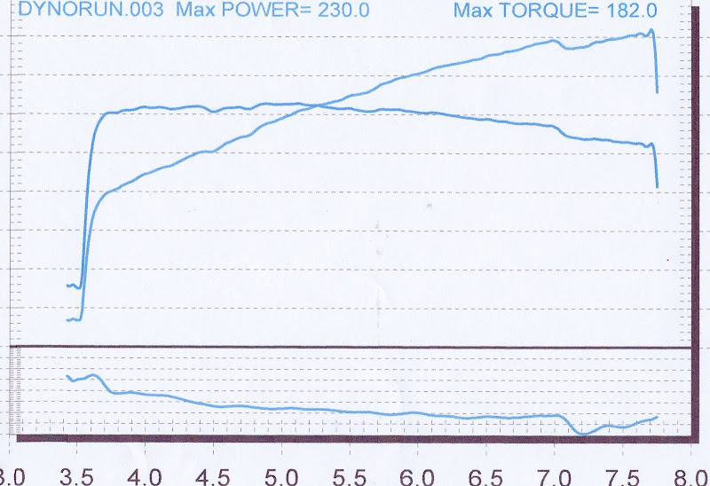

The Type R designation is for Revolution Mini and was said tounge in cheek much like the seperate subforum request.
Now about the Jesus thing....
This is one of the Mini's the is installed on.
So lets get into the fun part...
Owned by a Jew living square in the Bible Belt near one of the largest Baptist Churches in the US.
Car turned 6666 miles on Friday the 13th.
Runs a Jesus Head designed by el dablito.
Since most folks don't believe the power this head opened up...
Drum Roll.....
Stock Cam and ECU, only revlimiter has been raised.
16% Pulley...
Stahl header, Random Cat, 3" back
and the dyno sheets says......

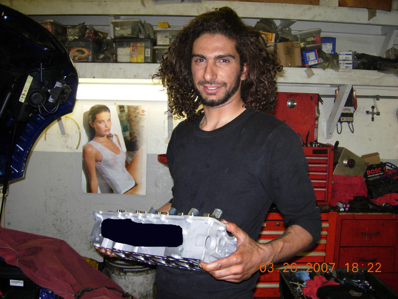

While we get to that...this is a picture of the Tech that put the head on...
Since you waited this long....
See the way curve has issues at 6400RPM due to the stock tuning....Just what till yuo see what we can find with proper tuning.
Good Idea! Not seeing the scale for your air/fuel I would hesitate running your mini on the street at higher RPM. It looks like you go wicked lean at 7200. Good numbers though I would of liked to see a STOCK RPM limiter run. Cheers!
It's running incredibly rich at the upper RPM, in the neighborhood of 10/1. Dumps fuel in as the RPMs reach the upper end of the ECU's tables to protect the engine.
Sorry, Scanner cuts off part of the page.
Look at the dyno sheet in the very first post of this thread. My car had the stock ECU and stock rev limiter.

Ah, Jesus blessing another head before he performs the install.

Originally Posted by RedSkunk
Only pulley and full exhaust? I'm assuming intake? Nothing else power-related?
Have all of these jesus-head dyno pulls been on the same dyno.....
gnatster's sheet he is showing was done some were in Texas. His car has very similar mods to mine.
Yes, there is a CAI, Craven Speed. There were 400cc injectors, pulled before dyno runs, but I kept throwing rich codes so they have been swapped out to stock for now. No more codes, so far.
No they have not. Mine was done in Lewisville TX at Real Performance Motorsports and backed up at the same day with a 229.4 at Dallas Mustang. I went for a 3rd check the next day at ATS Motorsports in Denton TX but they were having issues with the dyno.
The reworked ports must be blacked out to not distract from the picture of the poor girl who spilled water.
sprp85 - That is not him.
