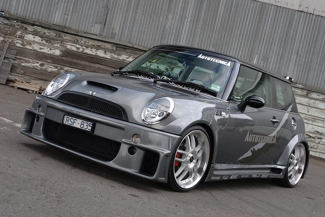

Hi all !! im new to here and from australia , im also going to twincharge my mini . i have priced up an alta kit and to me it is $6000.00 australian dollars , so i then went out to various performance workshops that i am close friends with and showed them all the photos and information that i had and i asked these guys to try and half copy half construct a new kit for me and they did with instructions from me that it all has to look awesome and the turbo be high mounted and i would like a front mount intercooler and oil cooler because the car is a show car i want it to look pretty insane and also a msd ignition set up was put into it . They then came back to me with prices nearly $2000.00 cheaper so i decided to go with this option i have also emailed alta and told them the same thing ! those guys are great !! they still offered to help me out there are a couple of questions i would like to ask : how is it , that all you need to tune the turbo kit is the apexi afc ??? seems to simple to me and not safe for the motor ??? also why do some companys use the gt3071r and others gt28rs ??? how much can the motor handle ???? is it possible to run a nitrous shot with the turbo kit ???
anything else i could find helpfull would be very very greatly appreciated
thank you all very much .......... hope to speak to you soon
josh .............

That's a nice ridedefinitely a show car You would be so happy if running the new M7 DFIC polished intercooler with the TC. That's also a show piece plus great performance too. Contact me if you're interested.
