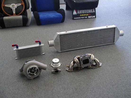

the chrome manifold is of a 200sx its a high mount turbo manifold with a t3 flange and external wastegate pipe im using this because im mounting the turbo up high the same as a high mount would look in a wrx and im also going to front mount the intercooler so i think that will work well ..... as you can see my gt3071r looks a bit different to the normal ones in the kit - only difference is that it has surge slots in the bell mouth , its set up for external gate and has t3 flange instead of t28 flange , so im hoping this wont have changed to much !!! i have an autometer air/fuel gauge is that a wideband ??? i dont think alta are going to sell me there pulley that comes in the turbo kit to decrease boost , will the turbo kit still work ok or will it be straining itself ???? i think i need to get a copy of the TWURBO instructions manual .... !! do you know if anyone has used a front mount intercooler on a twincharge set up ????
once again thank you so much mate !!!

You know that manifold ain't gonna work because the port doesn't match up with the head If you're not careful you might screw up the head too The turbo unit weight a lot.

east side !! i havent even taken the manifold down to the fabricators yet !!! of course it wont fit you can see that in the photo i took with the standard extarctors !! not much modifacation needed thankfully, as you can see only the outside runners need the work !!! hey just thinkin how would i stuff the head up ???? as for the weight of the turbo im gonna make a bracket that goes from the turbo flange to the flange on the head , some of the japanese cars have them on there manifolds thats where i got the idea from !! hey east side what do you think ?? is there maybe a better way to support the turbo ???? oh yeah not sure if i have asked man what do you think of a front mount on twincharge set up ?? has anyone done this before ???
your help is much appreciated thank you !!
