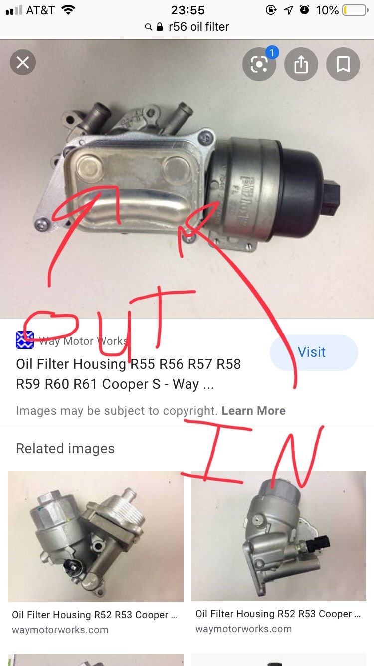

Hi everyone,
I am planning on installing an oil cooler soon, and have been trying to find the direction of flow from the factory oil cooler. I am going to be running the sneed4speed oil cooler plate, a koyorad cooler, and an improved racing 200°F thermostat. I have looked everywhere but can't find a direction of flow within the factory oil cooler. Does the oil flow from the filter to the block or from the block and into the filter housing, if anyone knows please let me know, Thanks!

Thanks for the reply Jason,
But that video doesn't cover what I'm trying to find out. Hopefully this photo helps to see what I'm trying to find out. I want to know which way the oil flows in the stock cooler's "mouth". I think it flows from left to right but I'm not sure as I haven't seen anything online.

Out from the bottom, in to the top. From there it passes through the oil filter before entering the oil galley.

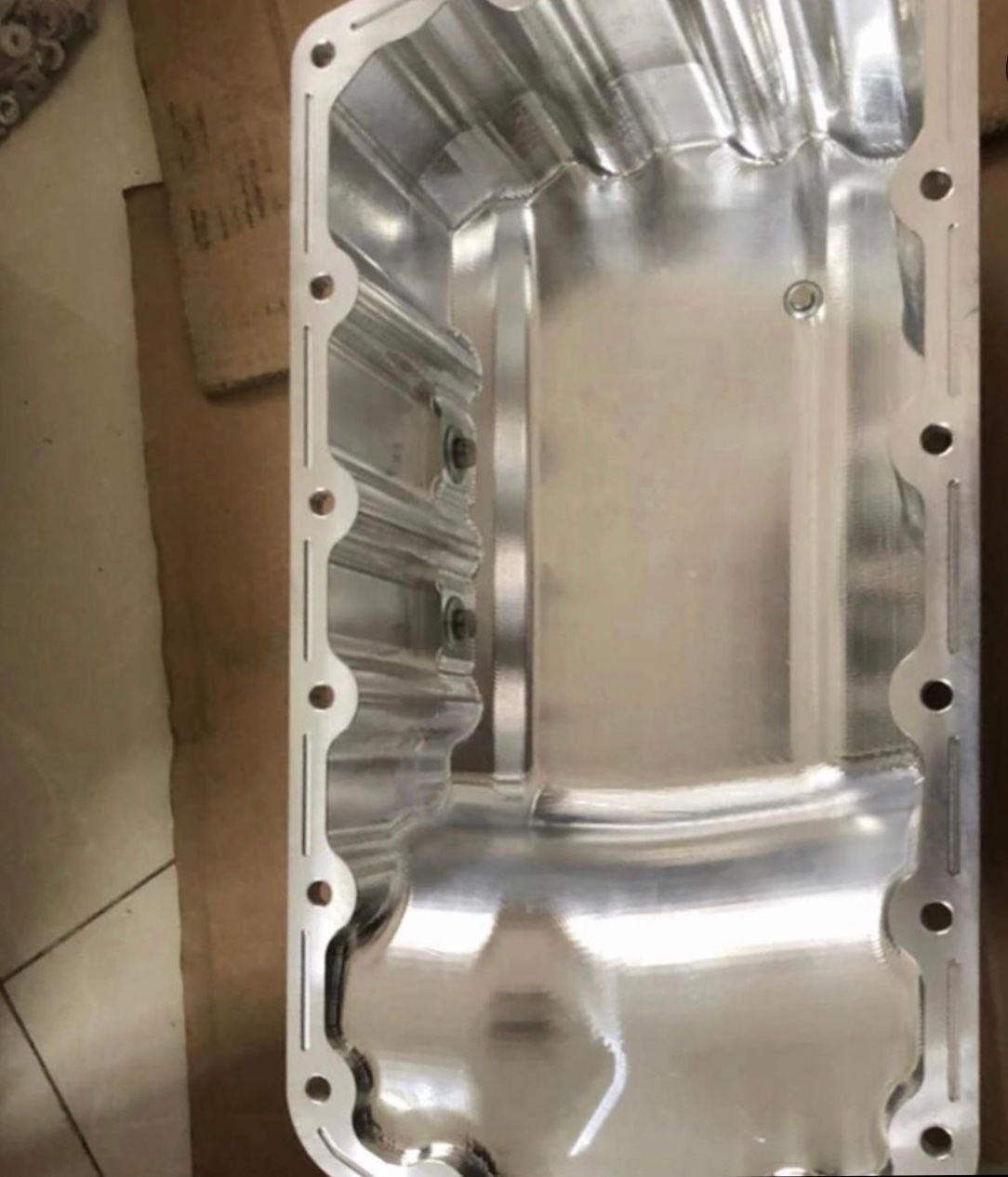

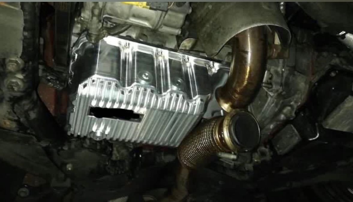

I
I change to a aluminium oil sunk

Originally Posted by Club77
I
did you take any pictures from the inside?,
has this extra capacity, anti surge, will the dipstick read the same?
Old Sep 3, 2020 | 05:42 AM
Club77's Avatar
Club77
Joined: May 2012
Posts: 163
Same capacity with the stock. So far got no issue on the reading.
