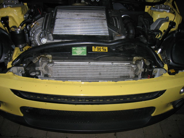

Oil cooler for a track car
All,
Two years ago I went the route of an oil cooler for my 'track prepared' dual purpose MINI. Glad that I have. Am using synthetic motor oil and the oil temperature at the track barely reaches 225 degrees. The oil cooler combined with the synthetic oil and a baffled oil pan gives me increased confidence that my engine will better handle any track abuse. Here is what I did:
Used a Madness oil take off adapter. Very solid and rugged. Recommend sealing all the fittings with Loctite 545 thread sealer (not normal Loctite) because the engine vibration will otherwise loosen the fittings resulting in leaks. (ask me how I know) Converted the stock MINI automatic transmission fluid cooler to AN fittings and use it in the stock location as an air to oil heat exchanger. Used AN-8 fittings and appropriate hose. Had the hoses made up at the local D8 Caterpillar industrial speed shop. ha ha.
The oil pressure seems fine. My "thermostat" is a piece of cardboard box cut to cover the oil cooler during cold weather. On those cold days with the cardboard in place, the oil temp hovers above 190 degrees, close to 200 degrees after a short drive. For the track, just leave the cardboard home. Am attaching a photo of the oil cooler showing 2 years worth of bugs and dirt.
Regards,
John Petrich in Seattle

Good stuff as always John.
How did you run the oil lines?
I see the drivers side disappear instead of running over the top of the cooler and running as a pair back to the adaptor.
Are you running temp and pressure?

Oil lines
Obehave a.k.a. Sid,
Yes on the lines. The hoses are 3000 psi industrial "high flex" (ha) and the fittings are swedged on in a special press. Went this route for maximum durability, but pretty rigid and a bit of a pain to install. Ran each hose thru a hole in the plastic radiator surround, down behind the radiator on the front side of the engine and then along the passenger side subframe rail to the Madness oil take off unit.
A couple of hints: 1) Put the initial 45 degree fitting on one end of an 8' length of hose. Ran the hoses from the oil take off plate to the oil radiator, measured and marked the orientation of the end fitting. Disassembled the whole thing again for the final fitting installation at the shop and reinstalled the completed hoses. 2) Used two 45 degree fittings in series in a couple of places. The extra swivel from two 45 degree fittings sure makes the mating of the male and female fittings much, much easier. 3) Ended up arching one of the oil hoses up over the crank pulley to make clearance for my front brake air duct hoses. Just cannot fit all those hoses in the same spot. Makes a belt change challenging 4) Wasn't careful, and my top fittings didn't clear the under hood sheet metal. Had to dremel some clearance in the underhood sheet metal for the fittings to clear.
Hope this information helps,

Sounds good and tthanks.
