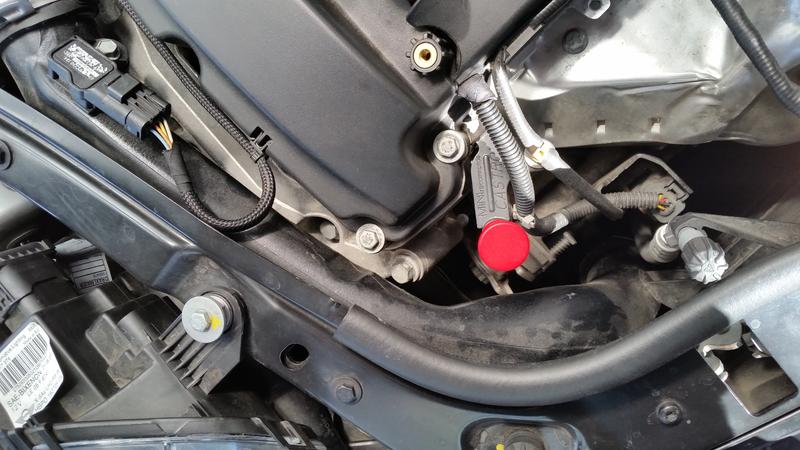

Was looking at this forum again and was wondering , some of you guys talked about moving the location around for the jet. Has anyone come up with a yay or nay on location. I was thinking more towards the radiator myself ???
I have had the kit mounted and ready to test for over 6 mths but have not had the time to set it up since I'm out of town for work.
I might get a 2 week window the end of the month and was going to finish the install.
Any advice on what you have found would be helpful....
Install the injector before the MAP sensor on the hard pipes coming from the intercooler.
Attached Thumbnails Aquamist HFS Methanol Injection Systems-20150103_122119.jpg
