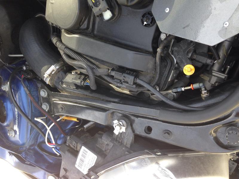

Here's pictures of my FAV install (notice how I tucked the wires over the little plastic divider):

With the countryman, the plastic piece that we attach the FAV to is slightly different. So you went above the plastic piece then down and back towards the passenger side to route through the hole in the firewall by the battery?

Attached Thumbnails Aquamist HFS Methanol Injection Systems-image-731114111.jpg

The routing of the neg battery cable seems to be different also.

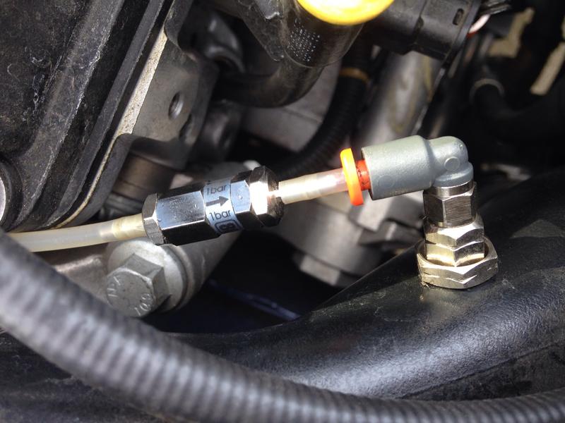

Sorry I am an amateur at this. I bought the HFS-4 kit here on the forums.
Already had the jet and everything hooked up. So I just did a straight install.
Jet says 1 bar on it.

Unless that is the restrictor lol

That's the check valve.

The restrictor would be in the fav if you put it in. They come desperately. Jeff suggested leaving them out as it is just another area that can clog.

Jeff said it was ok like that but I might try and get it horizontal since I need to get the flow sensor wire in a better place.

The jet is in the hard pipe at the end of the elbow. If you take just the jet out, not the threaded adapter, there is a number on the bottom. I am running the 6.
