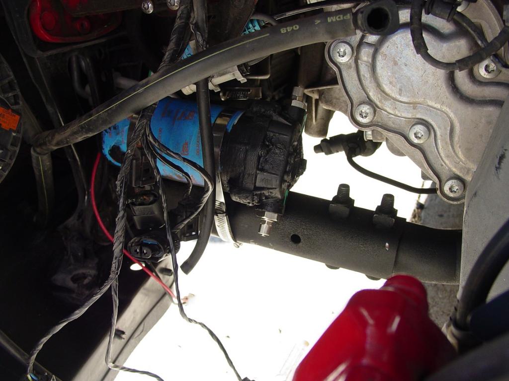

I installed mine on the front of the car. Pump is clamped to the frame rail horizontally by the driver’s front tire. I had to ditch the mount it came with, but put rubber feet between the pump body and frame.
This photo is before I had it clamped down fully, but it shows the location.
The pump was weatherproofed with a good deal of black RTV silicone. After it was installed I used rubberized undercoating as well. There is a ground that was close to this location, so the wiring worked out. The frame is between the pump and the road, so debris should not be an issue. The downside to installing it in this spot is that an explosive blowout on the front wheel might be able to get through the liner to the pump. I have been driving around like this for a bit and the pump seems pretty secure.

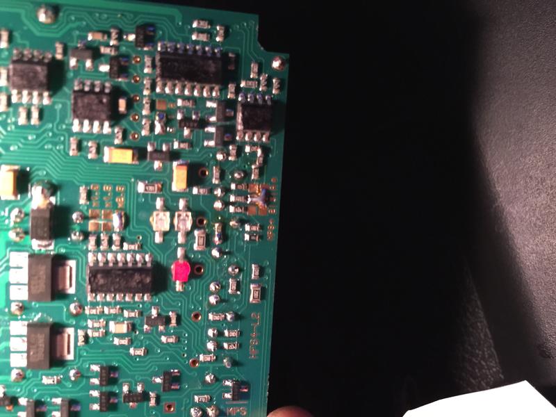

Also I would like to ask if anyone could offer the pics of the backside of the board settings. I need to know if mine is same as yours installed with JB+.

Does anyone have the MPS link in the back soldered on the R56 specific unit?
I am a second hand owner and I saw the soldered link on mine. The owner said it came like that when he ordered it from Howerton. I saw that cerenkov's controller above does not have the soldered link. Any of you R56 specific kits have it? I'm hoping I found the problem to my issues.
Funny if you look above your post I'm asking if anyone is using that configuration.

Does anyone have the MPS link in the back soldered on the R56 specific unit? I am a second hand owner and I saw the soldered link on mine. The owner said it came like that when he ordered it from Howerton. I saw that cerenkov's controller above does not have the soldered link. Any of you R56 specific kits have it? I'm hoping I found the problem to my issues.
There is a dial on the controller board but I believe this only works if the purple wire is connected to a voltage source.
So, tap the purple wire into any other wire that has voltage. If you want this to happen when the lights are on then use something that only comes on when the lights are on such as an interior light. If you want this to happen all the time then use the something like the power outlet (cigarette lighter).
It has to go to the headlight + switch so it is activated when you turn the headlights on.
