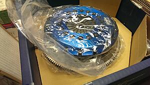

May have gotten a little bit excited....
Clutch and LSD don't even arrive till next thursday...

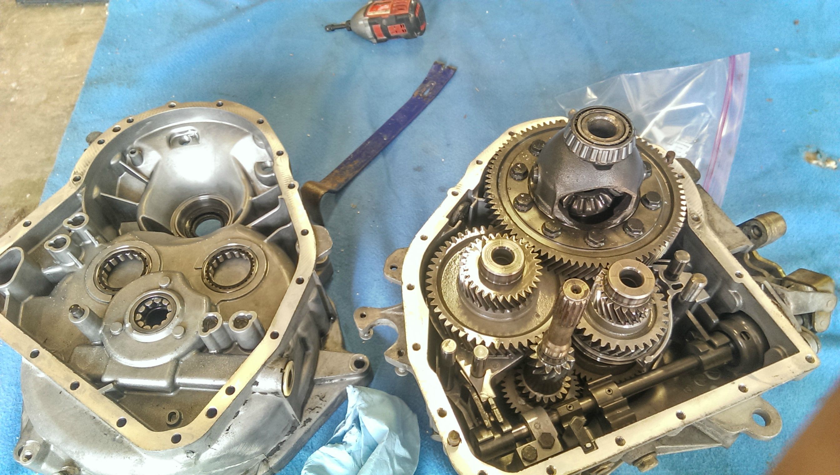

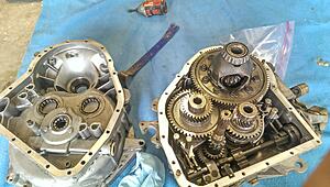

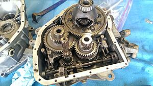

well in preparation for the LSD I decided to clean some things up a little bit (outside of the transmission and the bell housing)
Things were quite filthy, but I got most of the gunk off.
However, to my surprise, the inside of the transmission was spotless!
only metal shavings were in fact on the magnet, and it wasnt that clogged up either!
not too bad for 135K miles!
(of beating the ever living crap out of it )

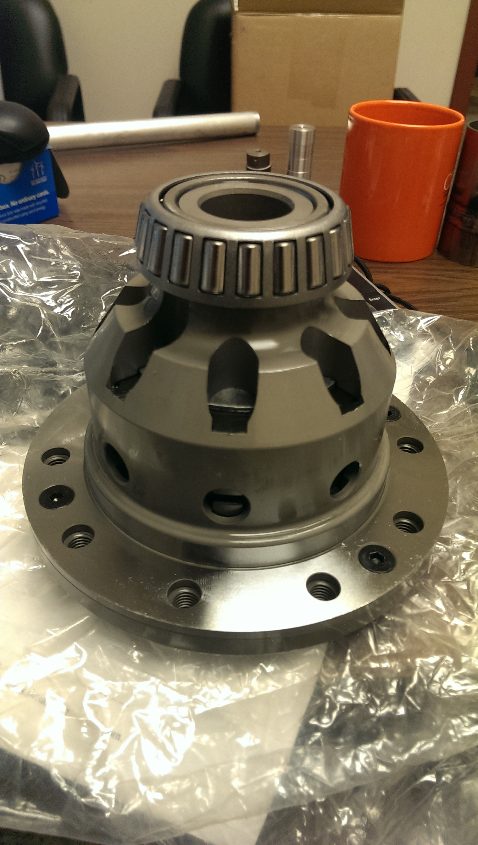

some rather heavy pieces of metal arrived today with "manufactured in japan" stickers on the side of them :3
Pictures later.

haha, no. the wheels are quite german. (BBS CV)
the OS geiken stuff is made in Japan :3

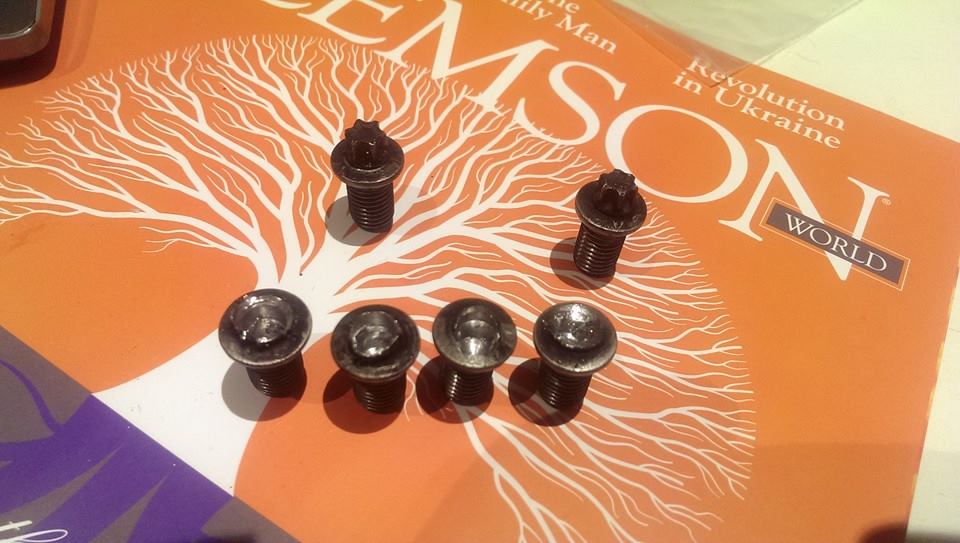

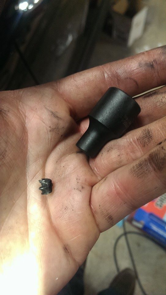

(replaced my clutch last)
looked at the pressure plate today and 2 of the pressure plate bolts already had their heads sheered off.
Just the splines though, so the shoulders were still holding the plate on.
Then two more broke when trying to remove them.
Only was able to get two out in tact.
Everything else I had to drill and use easy outs on... that took a while...

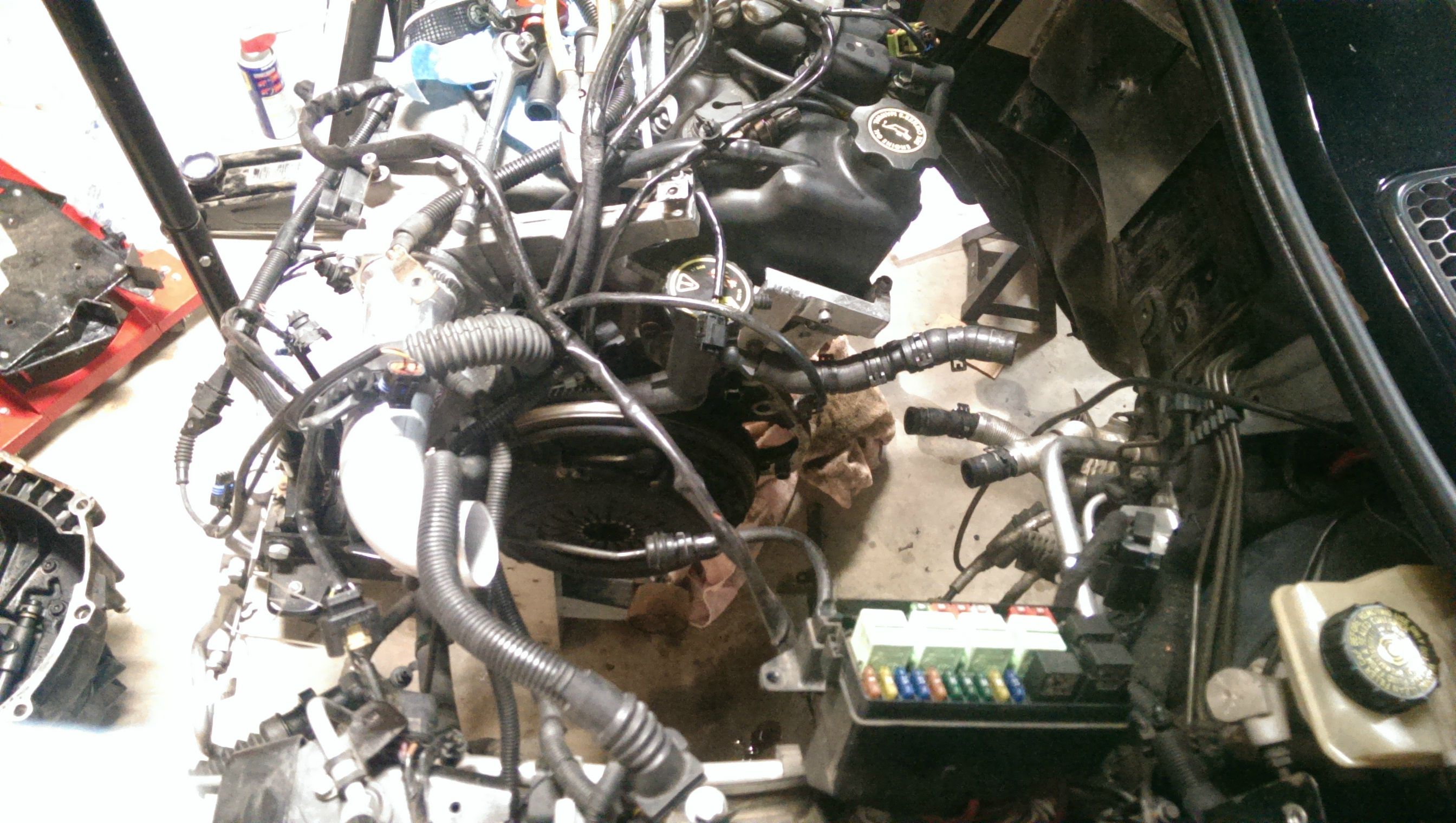

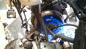

well after that fiasco last night, I got the twin disk clutch mounted this morning (fun fact, the OS geiken does not have the alignment mark on the flywheel so you just sort of put it up and rotate it around until you see all of the bolt holes line up.
Ended up torquing the flywheel bolts by locking the crank by putting a deep socket + breaker bar on the harmonic balancer and having it rest on the frame which kept the pulley from turning as I tightened the flywheel bolts)
Anywho.
Got the tranny on.
(what a mother FN BIT**!!!! wow. like really. no joke. ended up only being able to get the splines to engage just a little, but still had 3/4" left till the bell housing touched the engine block and I had to thread in bolts and tighten them one turn at a time going all the way around to pull the two together.)
after that was done I went through three cans of Gunk brand engine cleaner on the subframe and other parts that had been leaked on and accumulated dirt and grime, and now I have started work on a little something else.
if you know what this is, you should be able to guess what I am about to do.
(knowing the progression of this thread at least, I would hope you could put the two together)

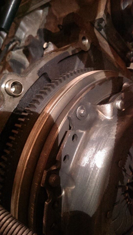

Also got the ring gear on, tranny filled with some Motul, reassembled, and back on the car (what a mother fn PITA! had to use the bolts to slowly pull it on the last 0.4" )
but at least the clutch is pretty... who is all in favor of someone donating a saphire bell housing so that we can see our gears and clutch move/work?!
(aside from the stupid cost that would run and the weight it would add, it would be pretty cool i think...)
