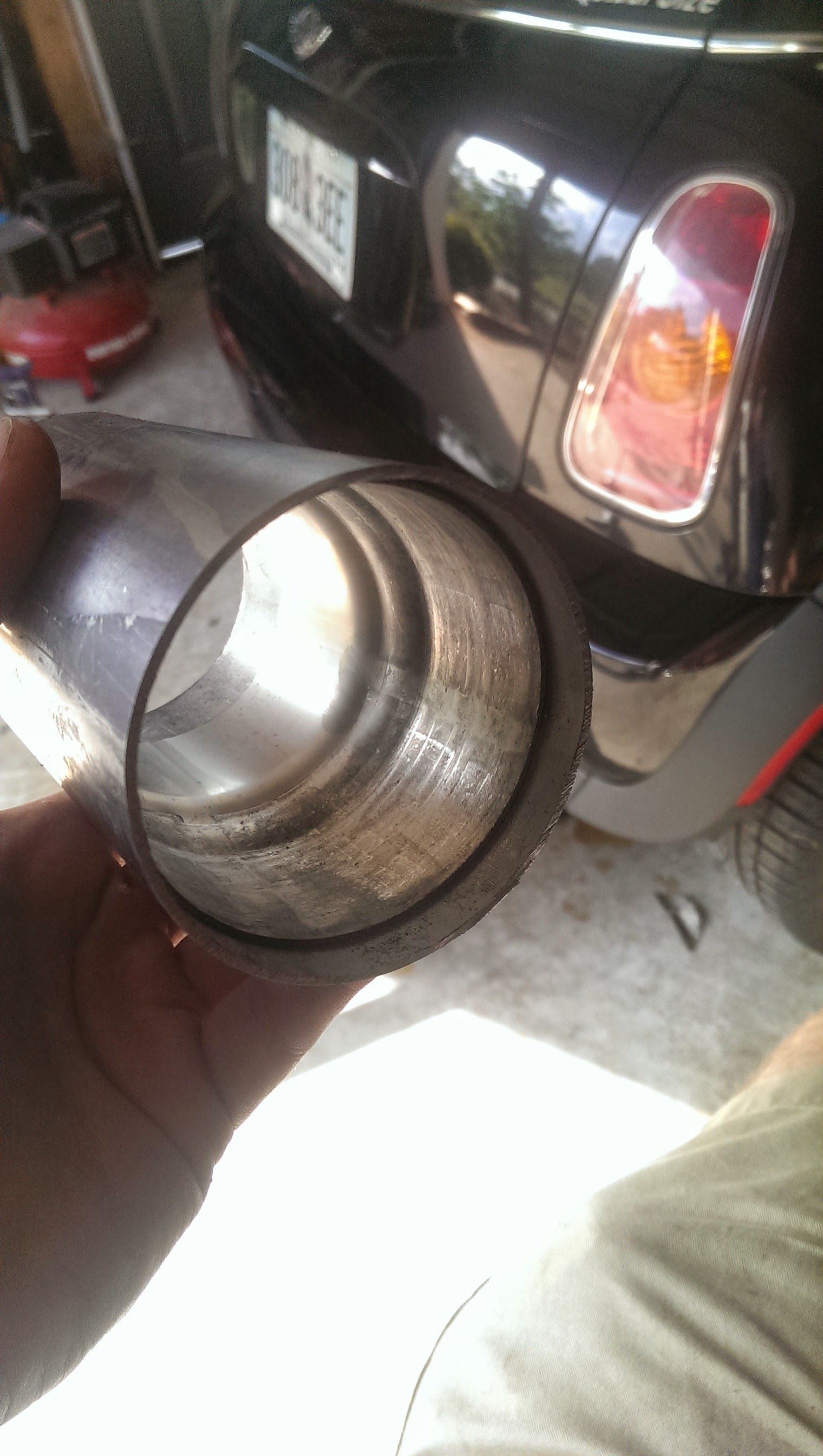

muffler outlet is 2.5" ID (2.5" slip), but I wanted a 3" outlet (I thought, and wanted it to look just like a straight cut section of pipe.)
So to do this I took a small section of 2.5" tubing and expanded part of it so that it transitioned to the ID of a 3" piece of tubing.
Essentially I got the expansion close, expanded the 2.5" to snug up to the inside of the 3", welded the 2.5" piece into the magnaflow, , put the 3" around, and "press fit" them together and stitch welded the 3" to the magnaflow just to eliminate any rattling (and put a few stitches on the inside transition between the 2.5 and 3")

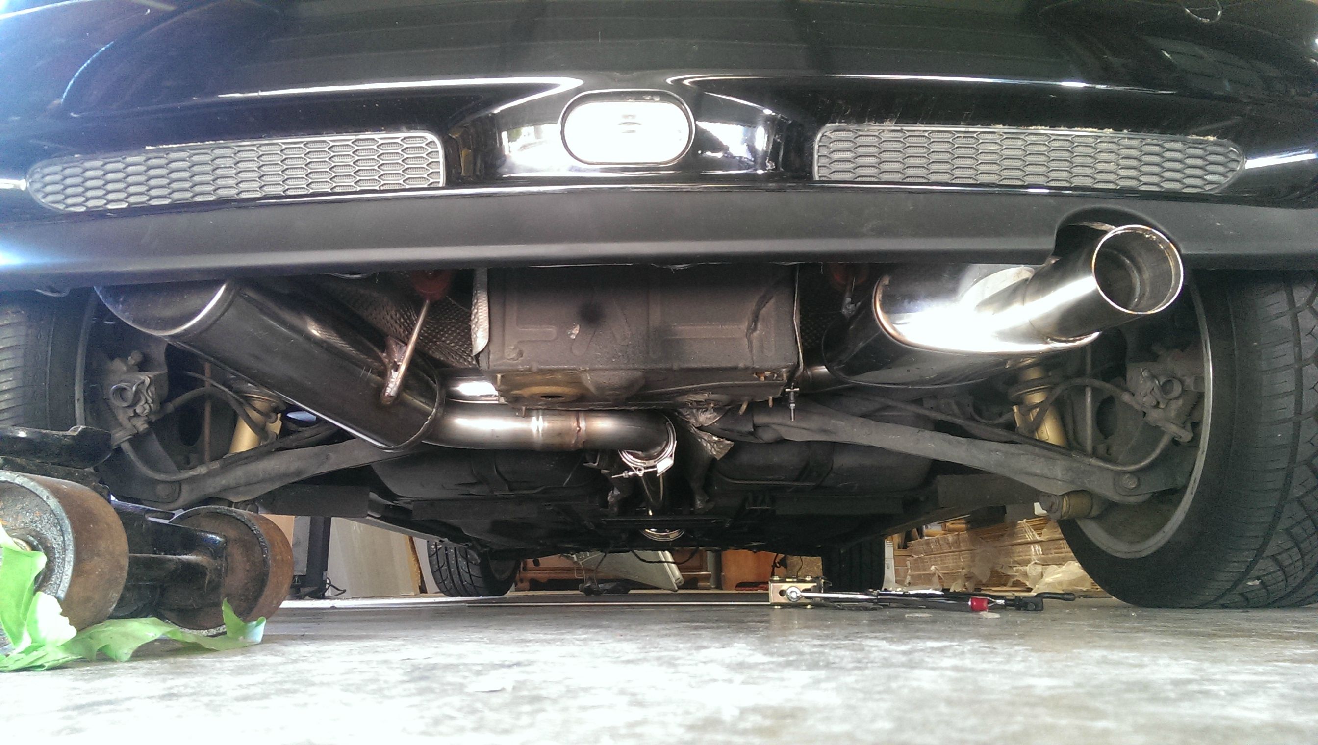

exhaust finished!

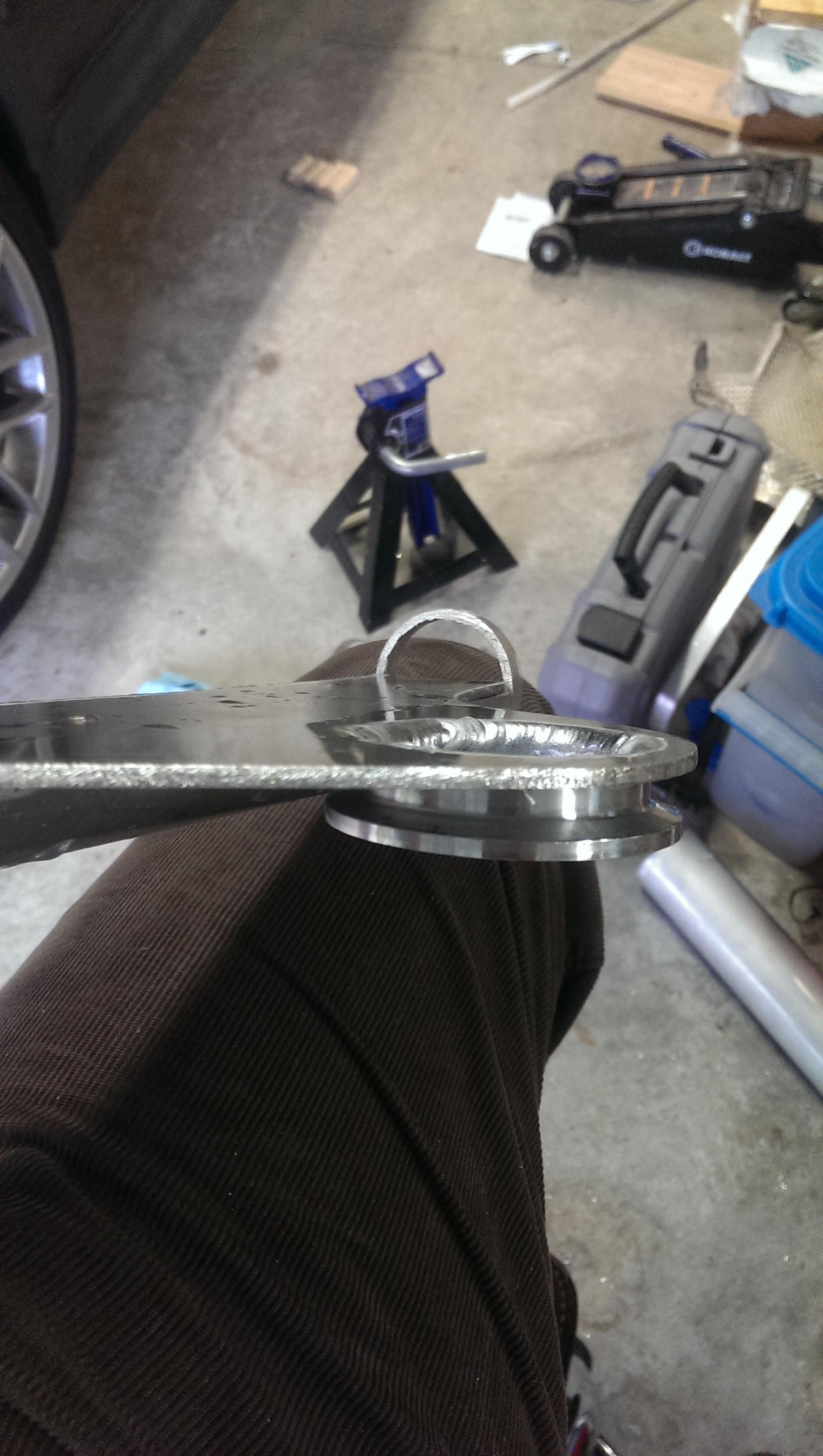

hole cut and aluminum V-band welded on

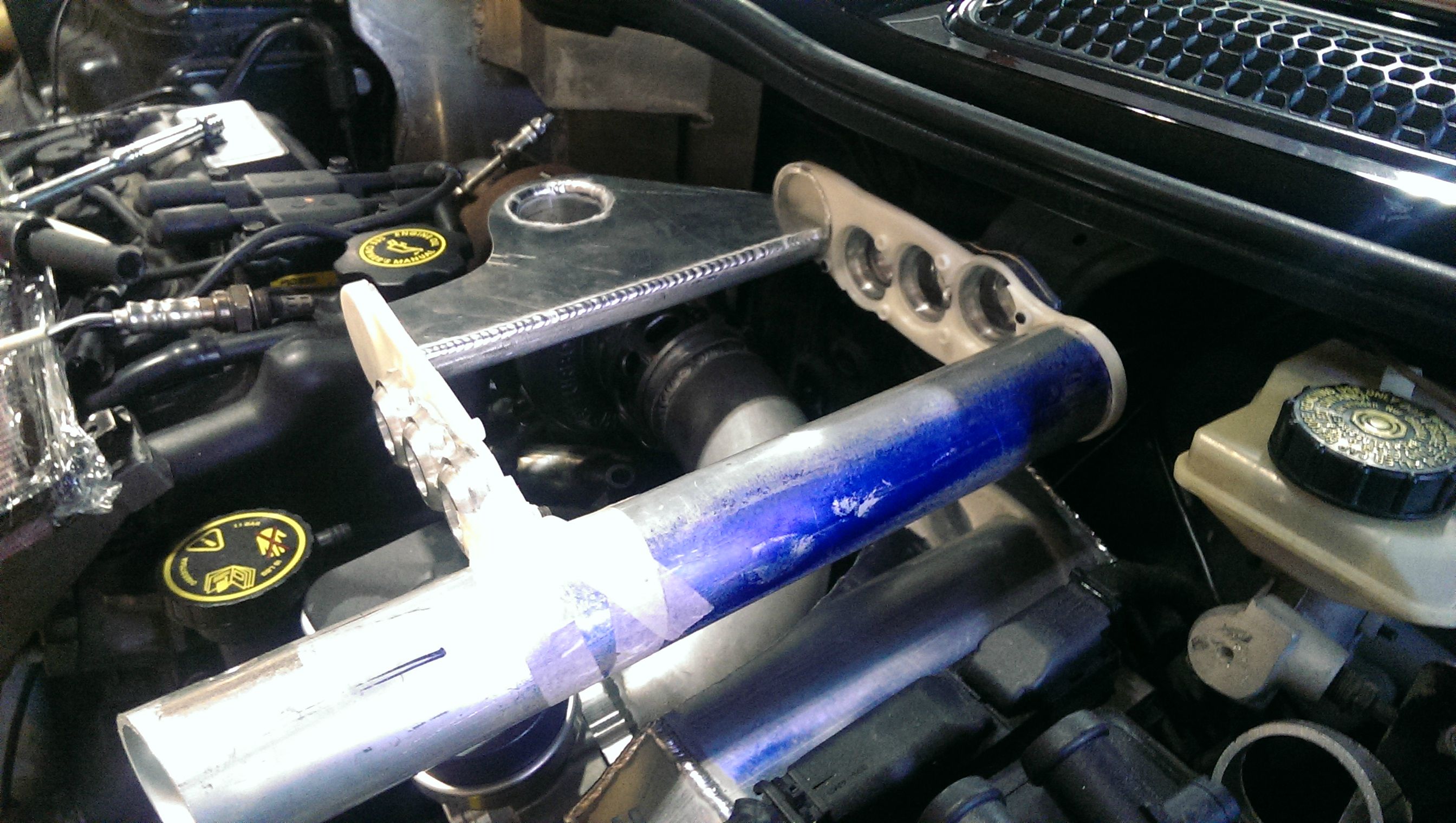

the idea (at least...) mock up with some 3d printed end plates.

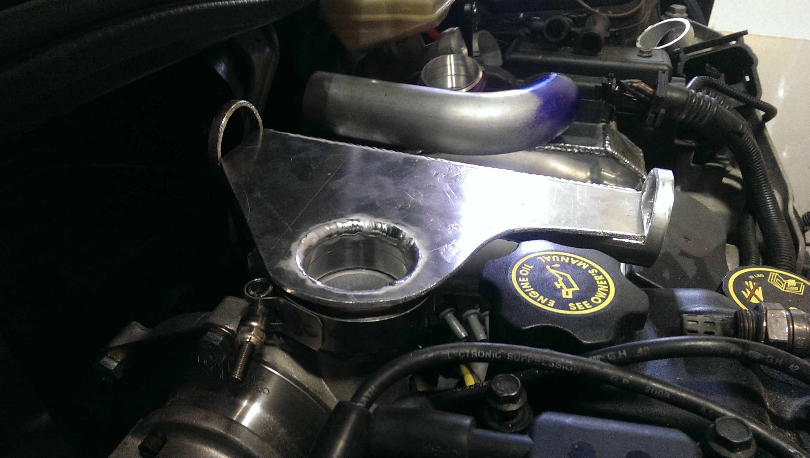

Slow day today, detailing the other mini, etc.
but I did manage to design and make a mount to hold the inlet tube and throttle body in place!
