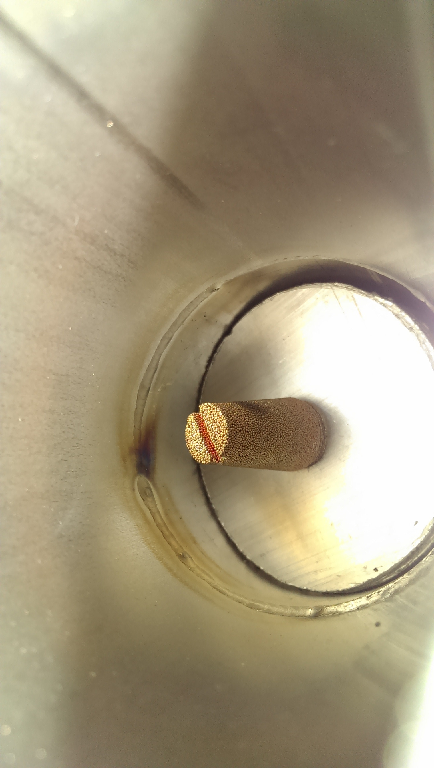

A little stainless welding to start the day off.
Seeing as you all asked for a shot of the inside of one of my welds, I finally got around to remembering to take one of the outside and inside on a full-penetration weld
Enjoy!

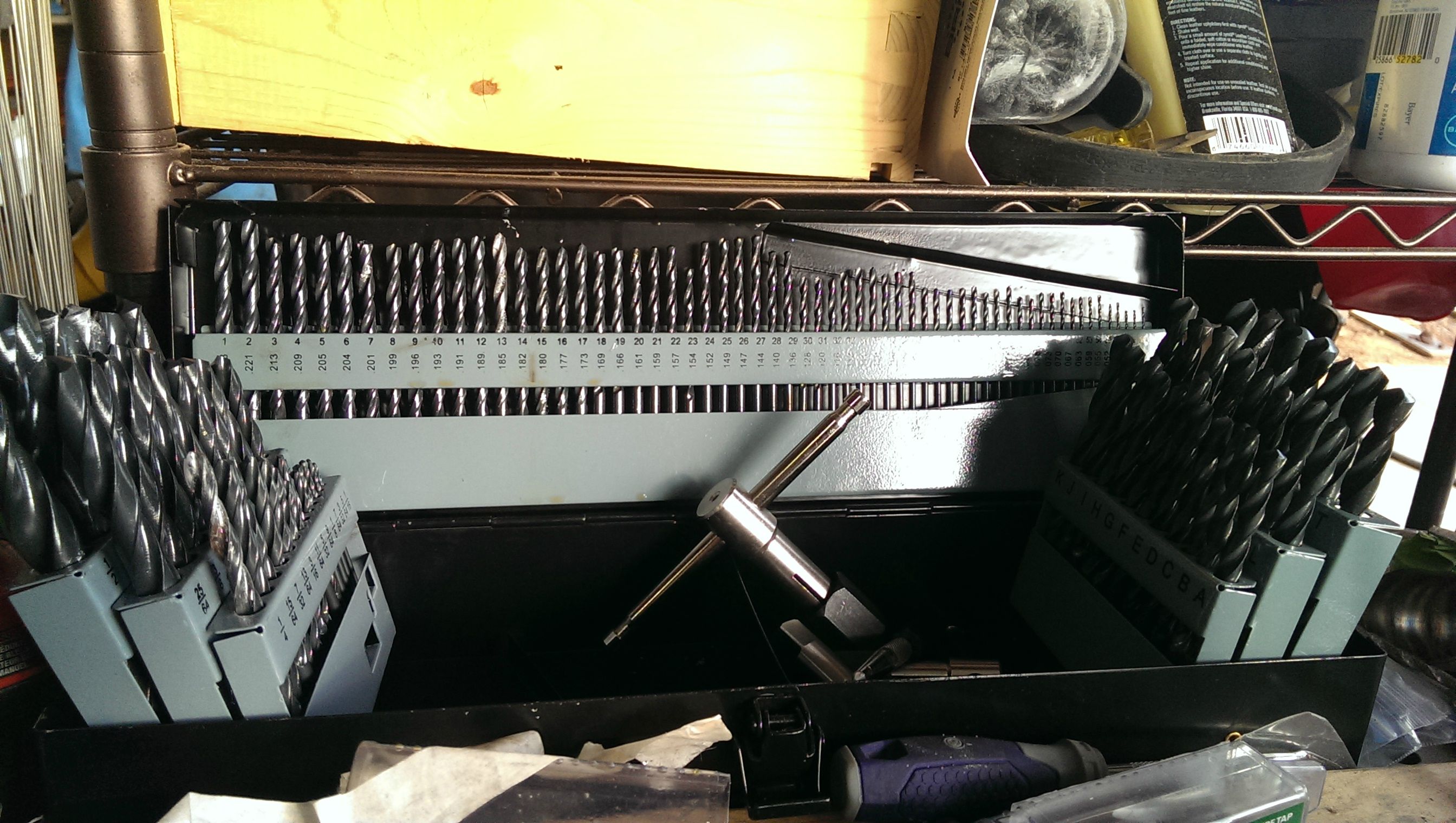

but thought I would show off some of the tools of the trade... or at least the newest addition to my little workbench
Drill index!
This box holds 115 bits, but I have 185 in total with this set (another 60 metric sized bits and 10 large diameter bits going from .5" to 1" )

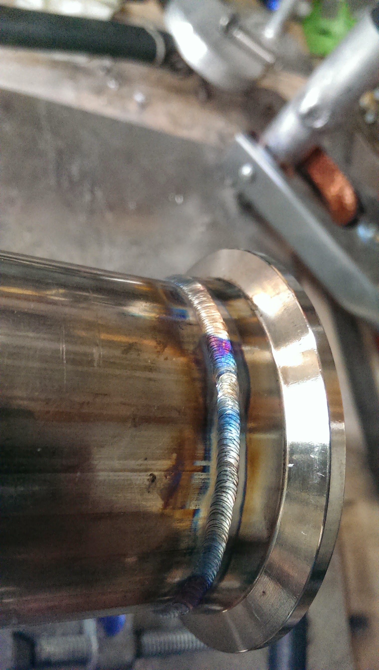

and then back to fab work, ran one of my prettiest welds this evening.
Looks this nice because it was from polished SS to a machined flange and had a supurb fitup. no better structurally than the other welds, but it does turn pretty colors

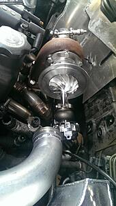

been a few days, and I have been doing a little work here and there, but I am busy making cigar boxes as graduation presents for a few friends.
but anywho.
For those who have never seen a billet compressor wheel from comp, it is a pretty thing.
(had to take off the housing to weld on a different fitting)

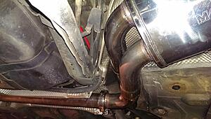

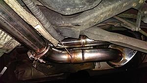

Needed a smooth surface for an O-ring seat on the BPV, so I removed the piston, chucked it up in the mill, centered the mill's "0" in the middle of the BPV and had it make it 40mm OD. Took 5 minutes once it started cutting (its a router, not a real "mill" )
came out well enough though!

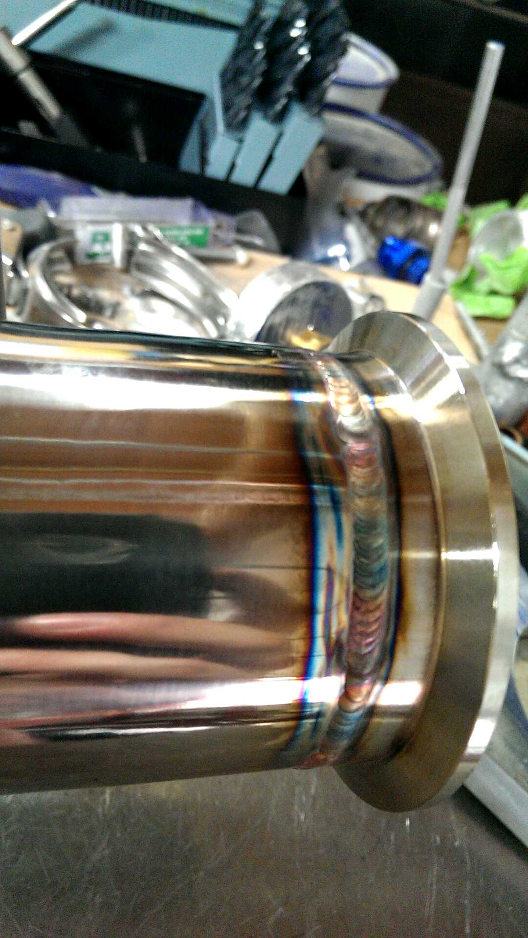

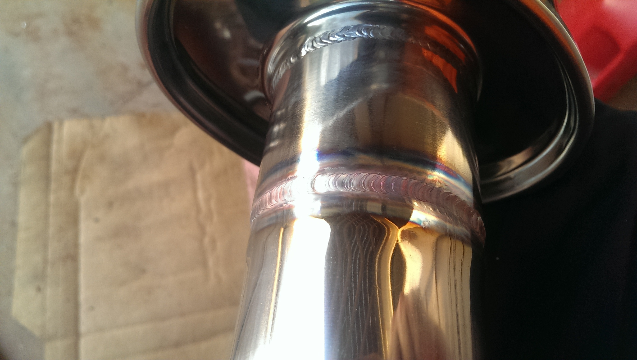

and next up a little welding P0RN
These types of welds are possible when I have clean metal, PERFECT fitup, and it requires a steady hand as you have to keep the torch within ~ .050 of the weld pool

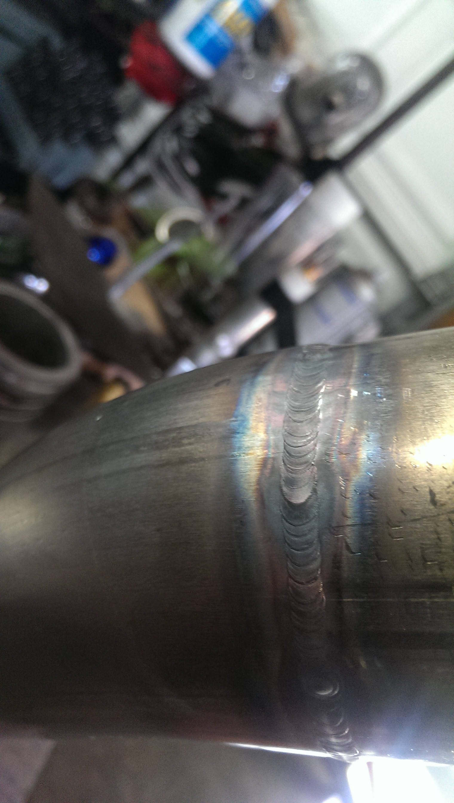

AAAND I am saying that to excuse this piece of crap weld Where the "slip joint" I expanded out I was a bit over zealous on and had to throw a lot of filler in there.
The only "not pretty part" is actually smack dab on the bottom where someone would actually see but at least it is void free and solid.
Speaking of that piece, it is this

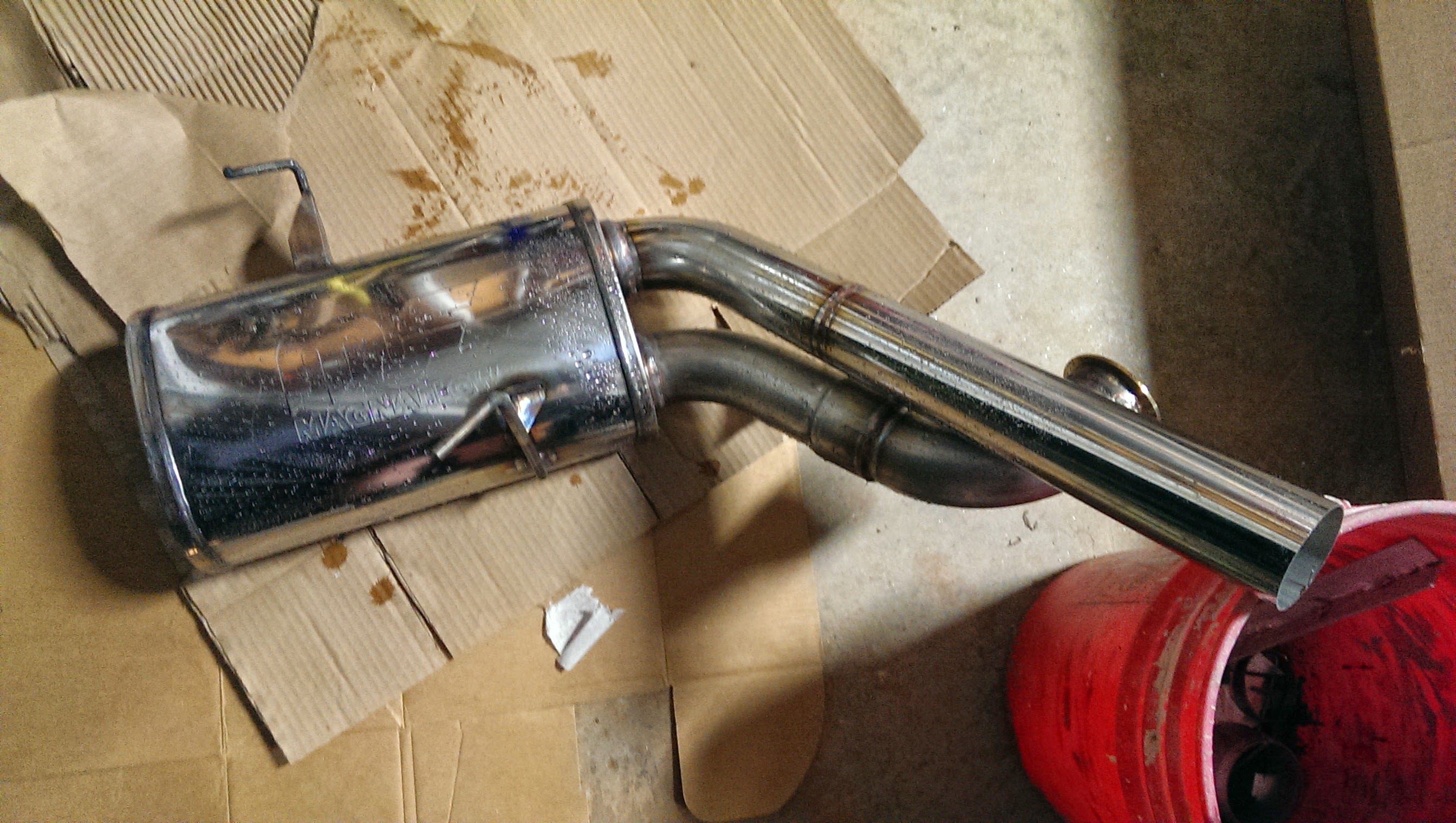

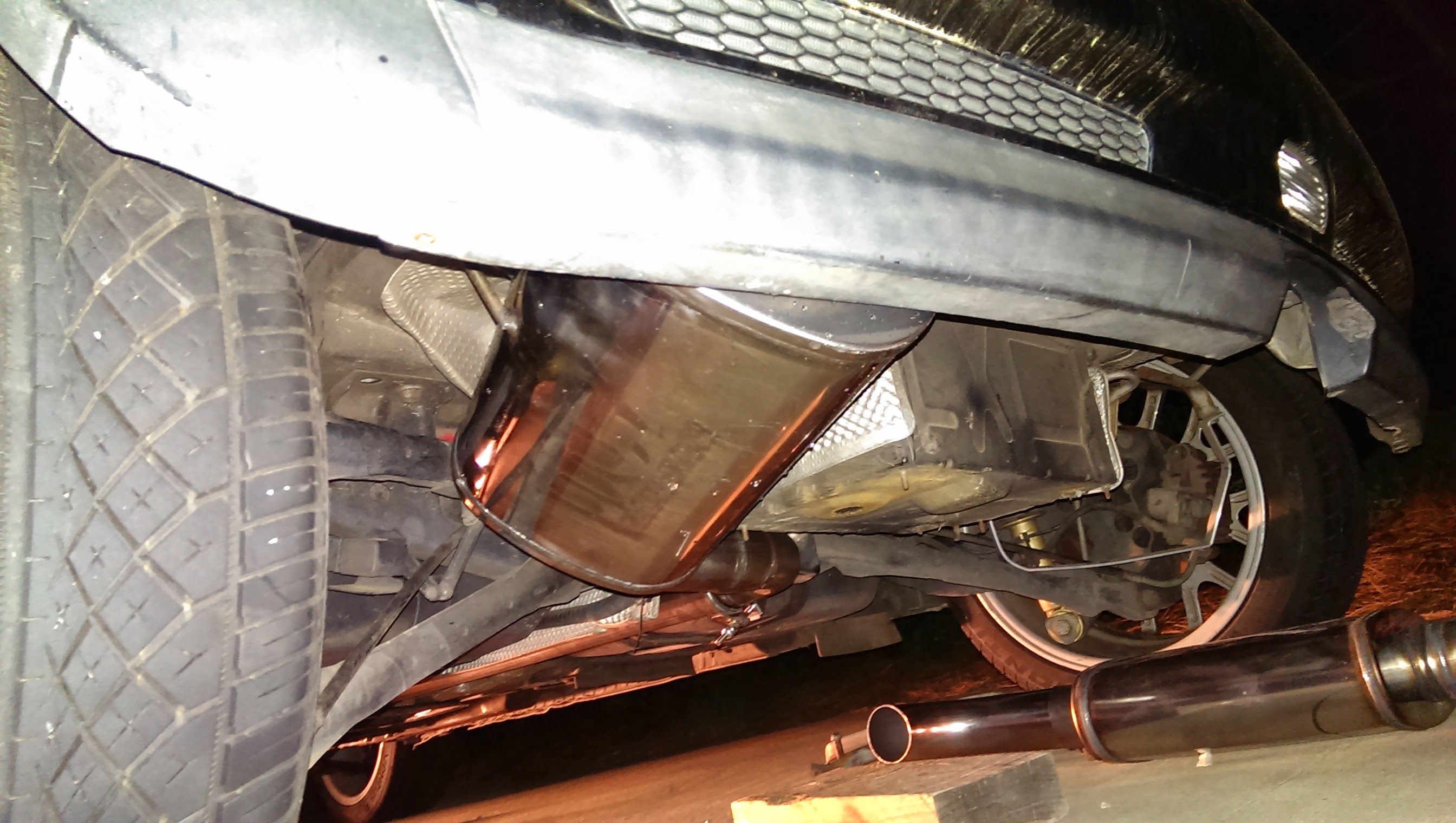

Basically mirroring the stock S exhaust setup except there is a vibrant resonator right after the down pipe and then two magnaflow mufflers.
Everything is 100% straight through perf. tube, so low resistance, and all of it is 2.5"
The other difference is the exhaust will come out in one tip off to the side (think base Cooper)
In fact I may use the base cooper aero bumper if I can find one. haha
(anybody have one in jet black and good condition they want to sell?!)
and yes, it is an extremely tight fit.
Barely even a fingers width in some places.
But I have given it the "vigorous shake test" as I like to call it and it does not contact anywhere, so "phew!"
oh, and there will be another V-band at the back to allow me to take off that loop when I want to and just run a bypass pipe to a single muffler, or even to remove both mufflers and run a straight pipe (should take less than 10 minutes to re-configure as I wish once it is all done)

you should have put the muffler on the passenger side to offset the weight of the driverside
Old May 2, 2014 | 08:21 AM
  #264
soccerbummer1104's Avatar
soccerbummer1104
Posts: 1,100
From: Inman, SC
Look in the last photo. you will see the other muffler on the ground that is going on the passenger side.
Old May 2, 2014 | 08:24 AM
  #265
daonlyillwiz's Avatar
daonlyillwiz
iTrader: (7)
Joined: Feb 2014
Posts: 655
From: Long Island, NY
why two mufflers and not 1?
Old May 2, 2014 | 09:38 AM
  #266
soccerbummer1104
Posts: 1,100
From: Inman, SC
well it will actually have a turbo, a resonator and then two mufflers in series
for its "quiet" "sleeper" mode
If you note the V band however,
The drivers side muffler can be removed and replaced with a extension piece that connects to the "second" (now only) muffler (on the passenger side) for a sportier tone. (I have run this exact combination before and it has some highway drone but not bad. Would not want it for 6 hours + though [long road trips])
this will be "sport" mode
OR you can remove both mufflers and use the third piece of tubing I will be welding up so the exhaust just has the resonator at the downpipe outlet, then is a straight shot out the back.
This will be "hooliganism mode"
Old May 2, 2014 | 10:22 AM

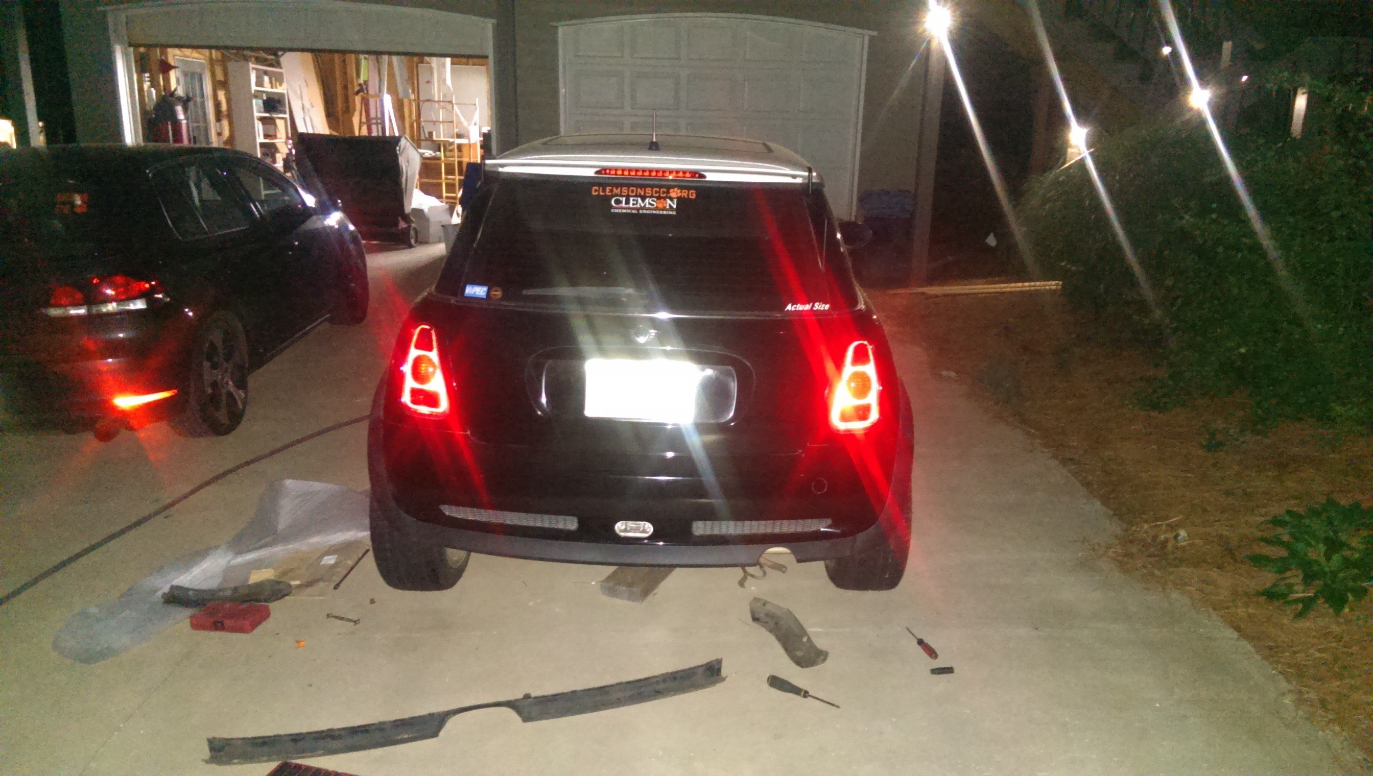

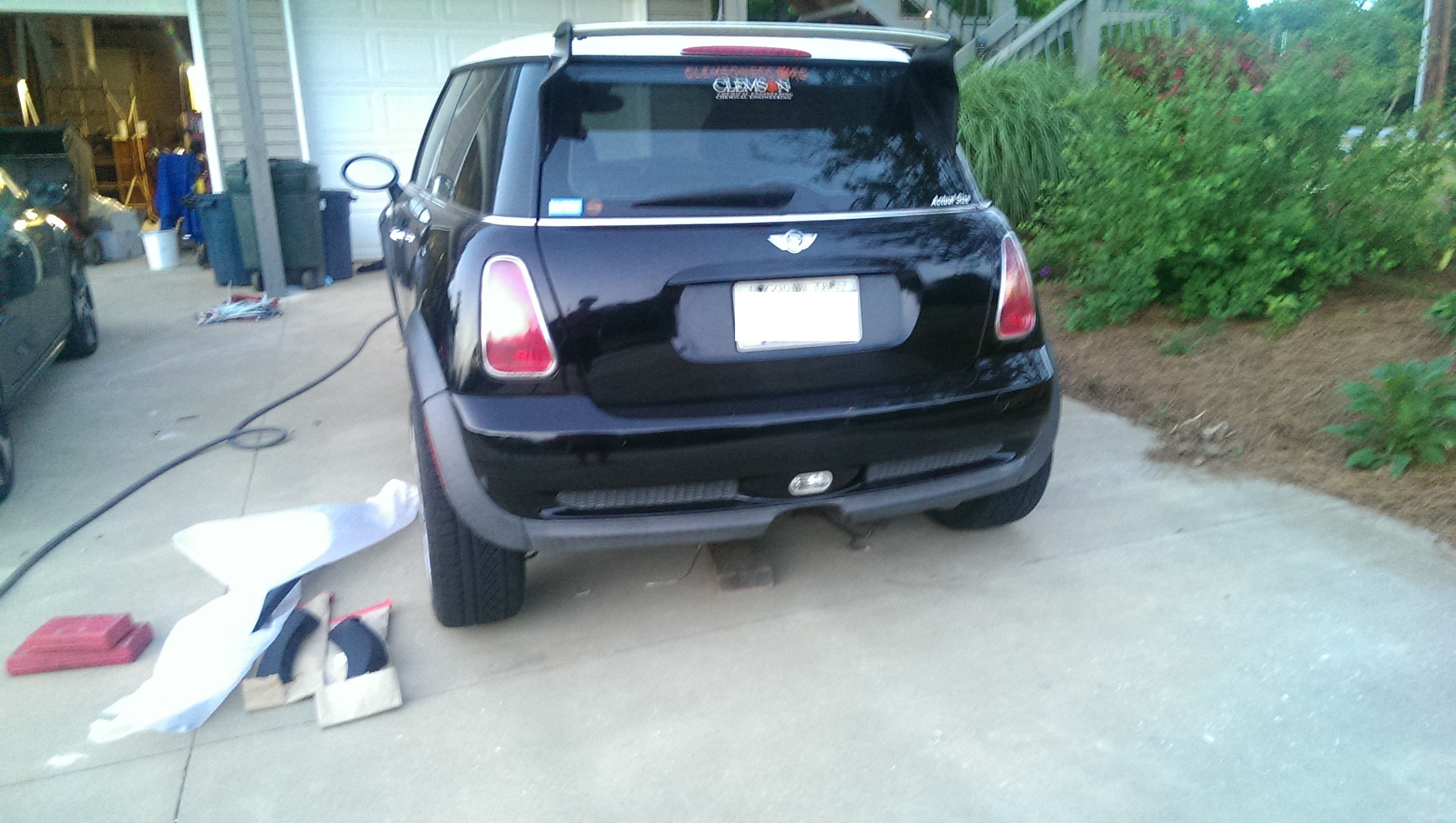

the new rear valence came in today (Cooper, non-S), so I got that installed, and can now work on finishing the exhaust (needed to know where the tip was going to end up before I did any more welding )
so I guess I can provide a micro update ?
(pardon the dirt)
before:
after:
Broke the left side reflector when attempting to remove it from the old trim piece , but its okay. new one on order. haha. Was just old and brittle. happens

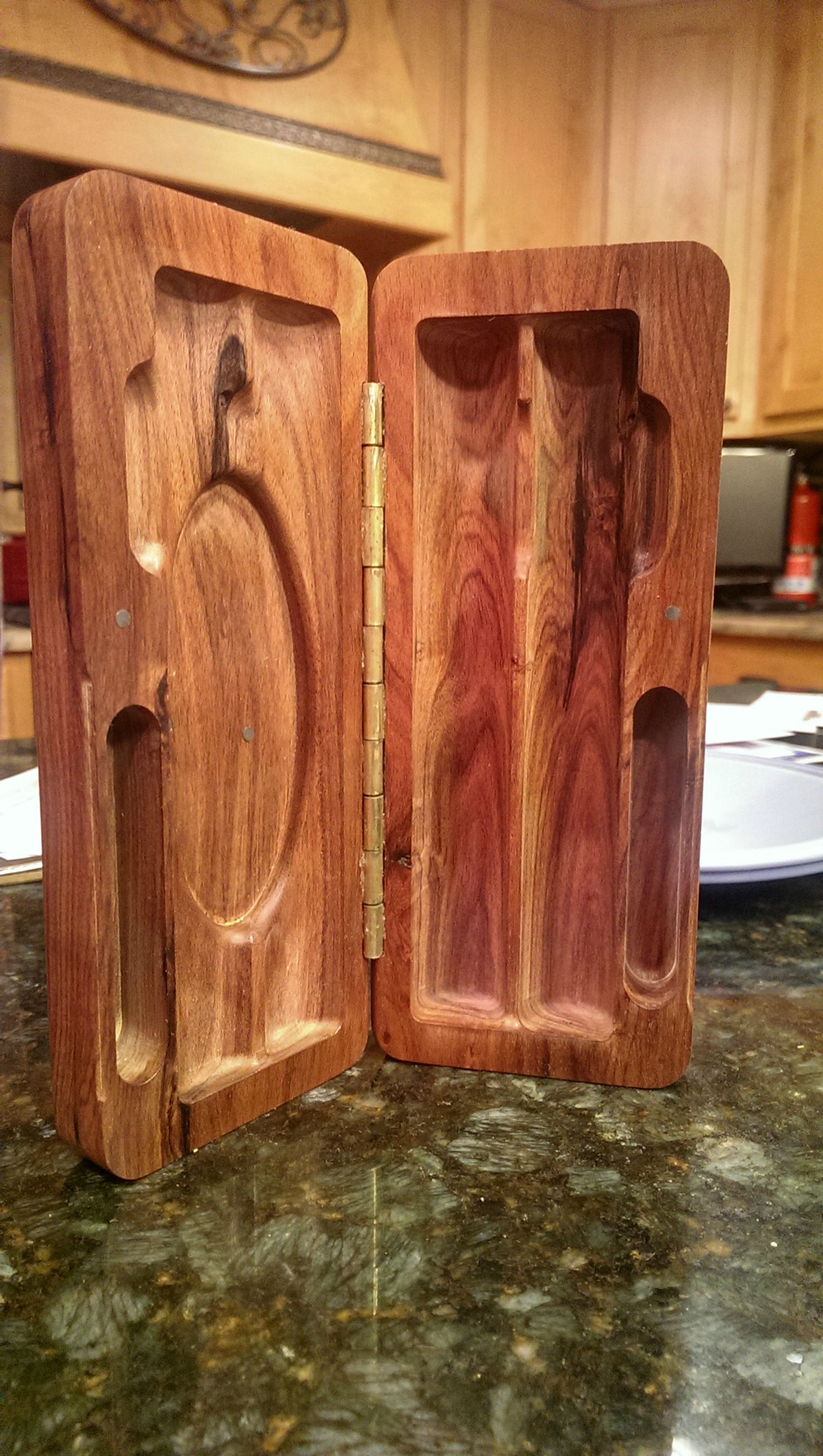

This one is from a single piece of bolivian rosewood that I cut in half and then routed out the two sides.
Just finished polishing and waxing it tonight and put the hinges and magnets in.
Turned out well I think.
Magnets are a tad weak unfortunately though :/
good thought, will know better next time (to use larger ones)
