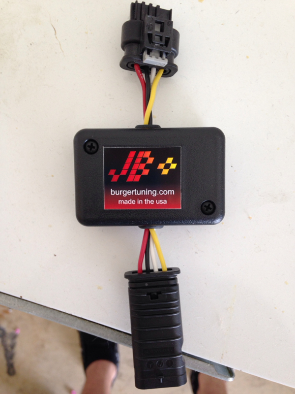

Well I just installed it and I got a good 5 minute drive in before pouring rain came. ALREADY felt it climbing the rpms a little quicker. Can't wait for the full break in!
Old Jul 2, 2014 | 11:02 AM
  #2213
ptguy0618's Avatar
ptguy0618
Joined: Oct 2013
Posts: 208
From: Fort Myers Florida
