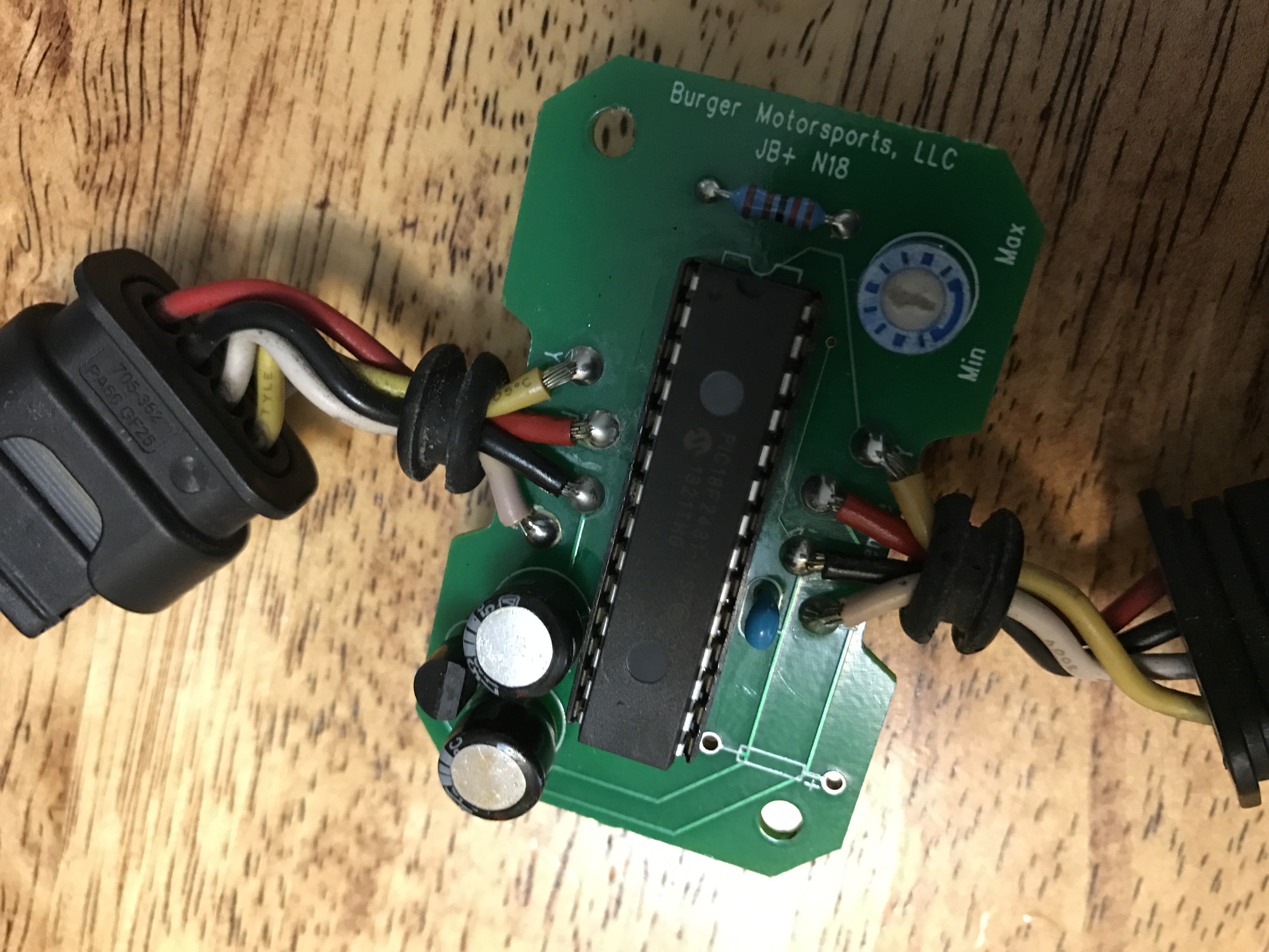

Sorry if it's been asked but i'm buying a used JB+ and i want to set the settings correctly. How do i know if it's the old version or the new version?
I'm have a GP2 all stock with just a drop in AFE dry air filter. I have 93 octane all around me to use. What setting should i set it one old vs new

as the post stated i'm buying it used. You can actually open the jb+ up and there is a dial on there for adjusments

Afaik the newer ones have a CARB sticker. The new one is also detuned compared to the original so full on is about 50% compared to the old one. Mariokart a vendor here reported that fake ones exist as well, so beware.
With all that in mind hard to say what settings will work. I had the original one and left it midway as received.

attached is the photo that i have of it opened, i didnt see any carb sticker on it

That's probably the original one set at factory level. There is a thread somewhere on NAM with a photo of one without those rubber grommets which was the fake one as I recall.
