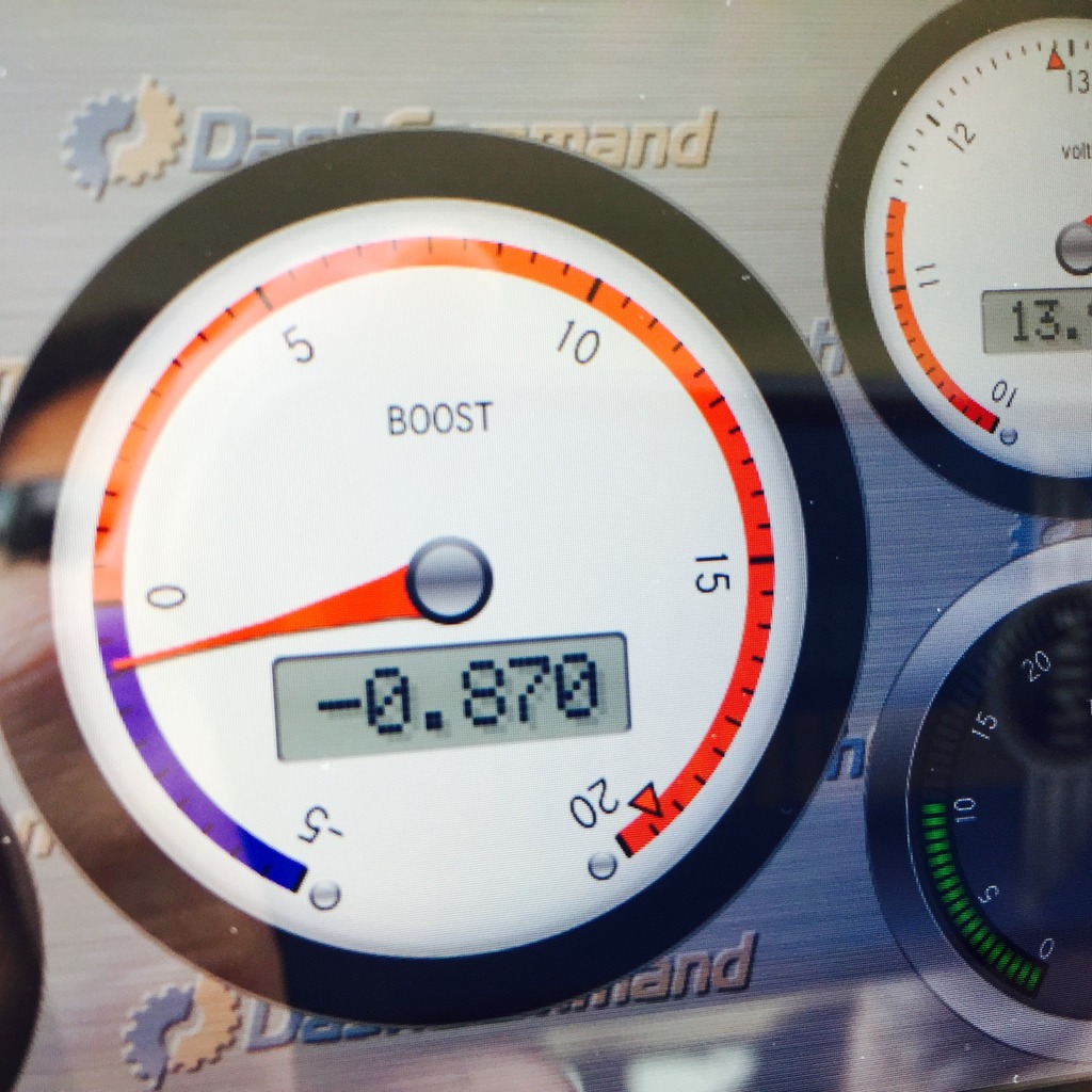

Guess all is well as 19.5 pounds at 78f @ 101mph
