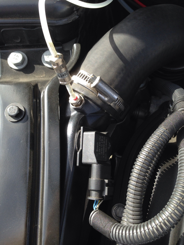

Be sure to install the meth nozzle before the IAT sensor. Helps create the coolest possible air charge before hitting the sensor, then going into the motor.
Otherwise the car won't pick up on the cooler temperatures, which will not allow the ECU to advance timing.

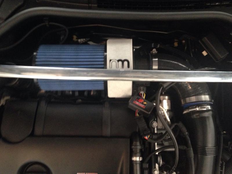

Last Meth was from Terry Burger Tuning on my 335i, I will double check on the exact placement for the nozzle. Any suggestion on nozzle size, also a picture of nozzle location?

Here's where mine is currently at.
This is further down the same pipe. Closest to the intercooler would be best. Gives the injection mixture some time to absorb the heat before hitting the temp sensor
I'll be moving mine somewhere down there soon.
Although I don't know how tough it would be to remove that entire pipe, will have to take a look at that today.
Speaking with Jeff from Howerton Engineering, he said these cars ECU's do a fantastic job of adjusting fuel trims. So you can throw meth at it and it will adjust accordingly.
80% meth mixtures or higher, .8mm
50/50, you're good with a .6
Might even be able to use .7mm with 80% if you'd like. The beauty is it's all up to the user, no matter what meth kit you go with. So many combinations!
