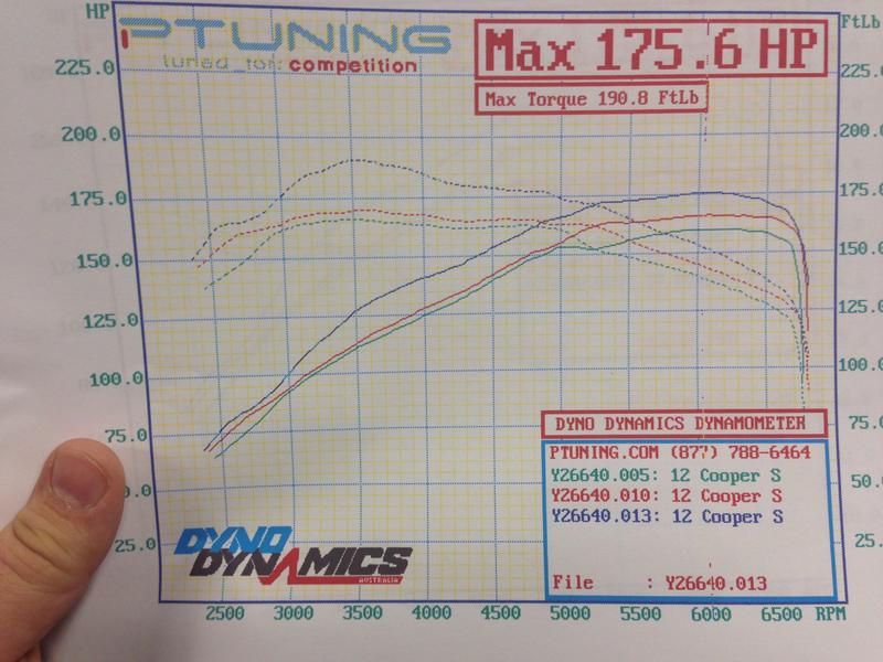

Another dyno result
Not that we need another but I've invested the dyno time as I modded my car so I know what my car's performance is.
Green is car with just CAI.
Red is car with larger Intercooler and exhaust
Blue is with the above mods plus the JB+

Hmmm. The photo link is not working.

Image fixed

That doesn't seem like a lot of power output. Only 175? Or am I missing something?

They tell me their dyno reads low

The N18 is rated for 181 hp SAE NET - which is NOT at the drive wheels but at the flywheel.
So are the dyno numbers at the wheels or flywheel?
Nevertheless the important numbers are the difference between the runs. So it looks like you gained about 10 hp.

Dyno is reading at the Wheel (WHP) and the torque gain is felt for sure when driving.

Yeah, it looks like you gained 20 ft-lbs. I assume that you have the JB+ at 50%.

All dynos read differently except dynojets, which are relatively uniform anywhere they are used, so only dynojet numbers are useful for internet comparisons. But delta looks great!

Set at what it comes at and very happy

They are right, the type of dyno you were on are very very conservative. The smart thing you did was going back to the exact same dyno. The only thing that matters is the difference between the mods. Of course, our egos would love to see huge numbers, but with so many different dynos and operators is makes it tough to compare one to another.
To give you an example my BMW M6 V10 was about 570hp at the crank and my friend dyno numbers on a Dyno Jet were 495whp and I did the Dynamatic (like yours) and I was at 390whp. On the street our cars were dead even.
Now, turn up the dial and get some E85 or race gas in your car and get a downpipe

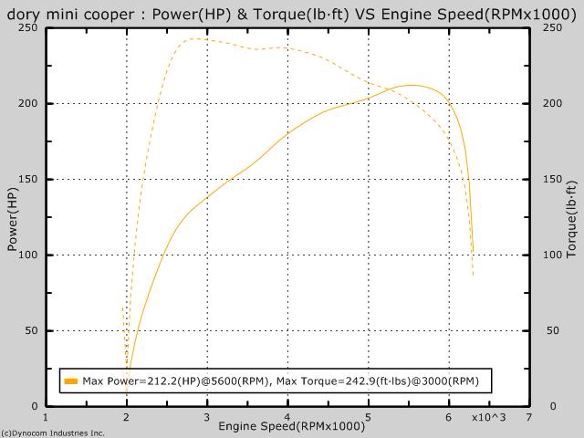

Burger Motorsports (BMS) Tune(s)-image-1034551926.jpg My last dyno including the jb+ I loove my new toy)) Gain 10 hp On the wheels Total jb+ and all my tunes I ended up with : 234 bhp and 360 nm ! Not bad for Mini Cooper s
