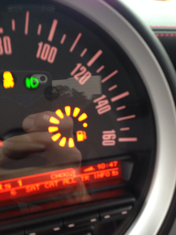

Originally Posted by Go-Cart
Hey Mario How many degrees of timing do you see on a WOT pull? Mine is usually 6 degrees going up to 9 degrees by redline.
Using CAN tool and fuel gauge as timing, I see 9 and it dips to 7 for a spilt second and then back up to 9
Sent from my iPhone Office

Seems like no one likes me, but you can read timing off of the CAN tool? If i do go MAX on the JB what should i look for? I am used to looking at a live A/F gauge i had on the evo and it need to be around 11, 12 would be too lean.

you're looking for the engine to not pull timing during WOT pulls. in other words, you wanna see timing progressing upwards, and to not come back down until you let off the throttle. if halfway thru your pull your timing drops (by 3degs, for example), that's not a good situation.
Ahh gotca, so it not do drop 3 tear drops via fuel gauge right?

A dip here and there is OK. But lots of repeated dips mean you need more octane or less boost.
